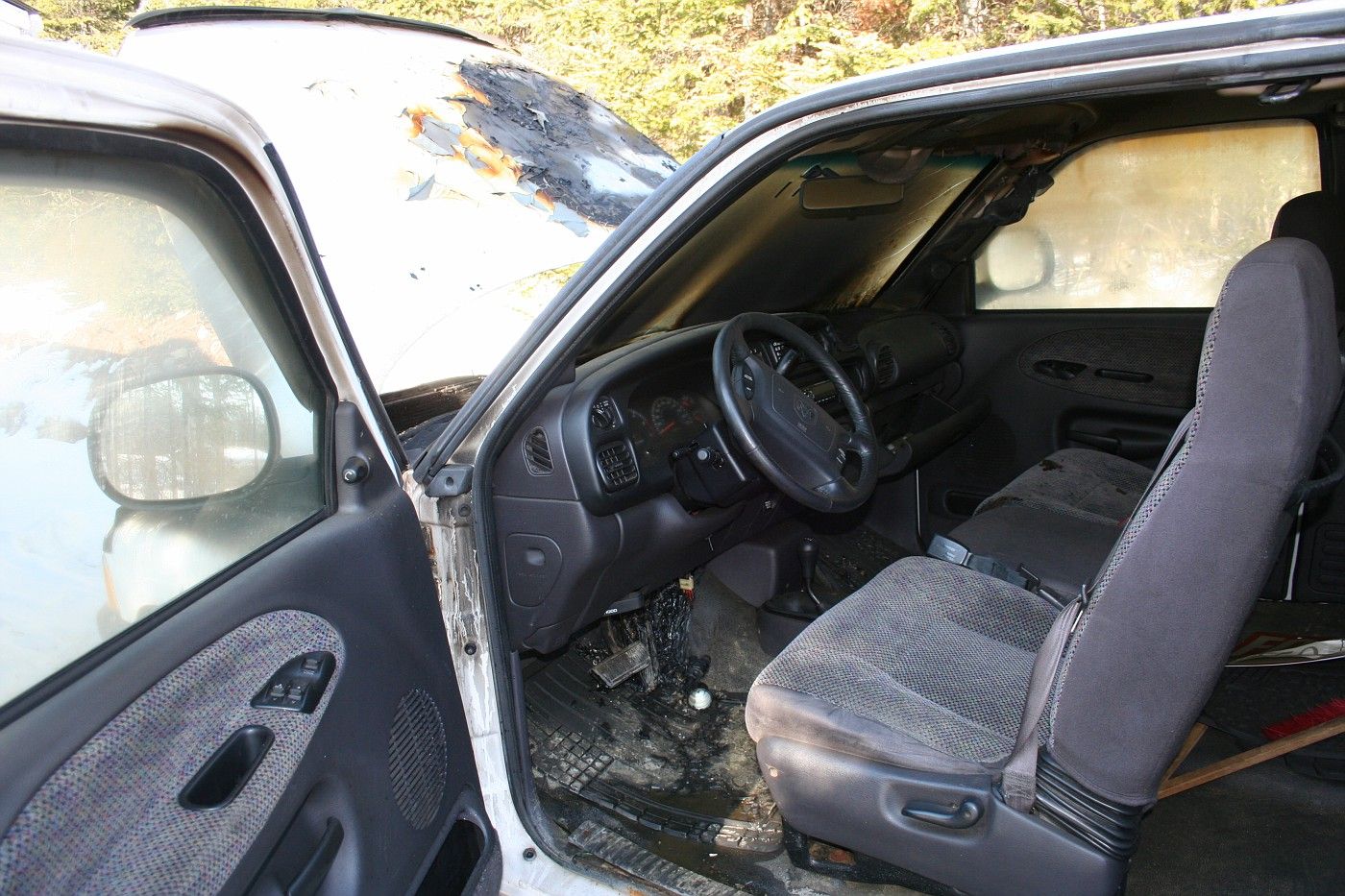

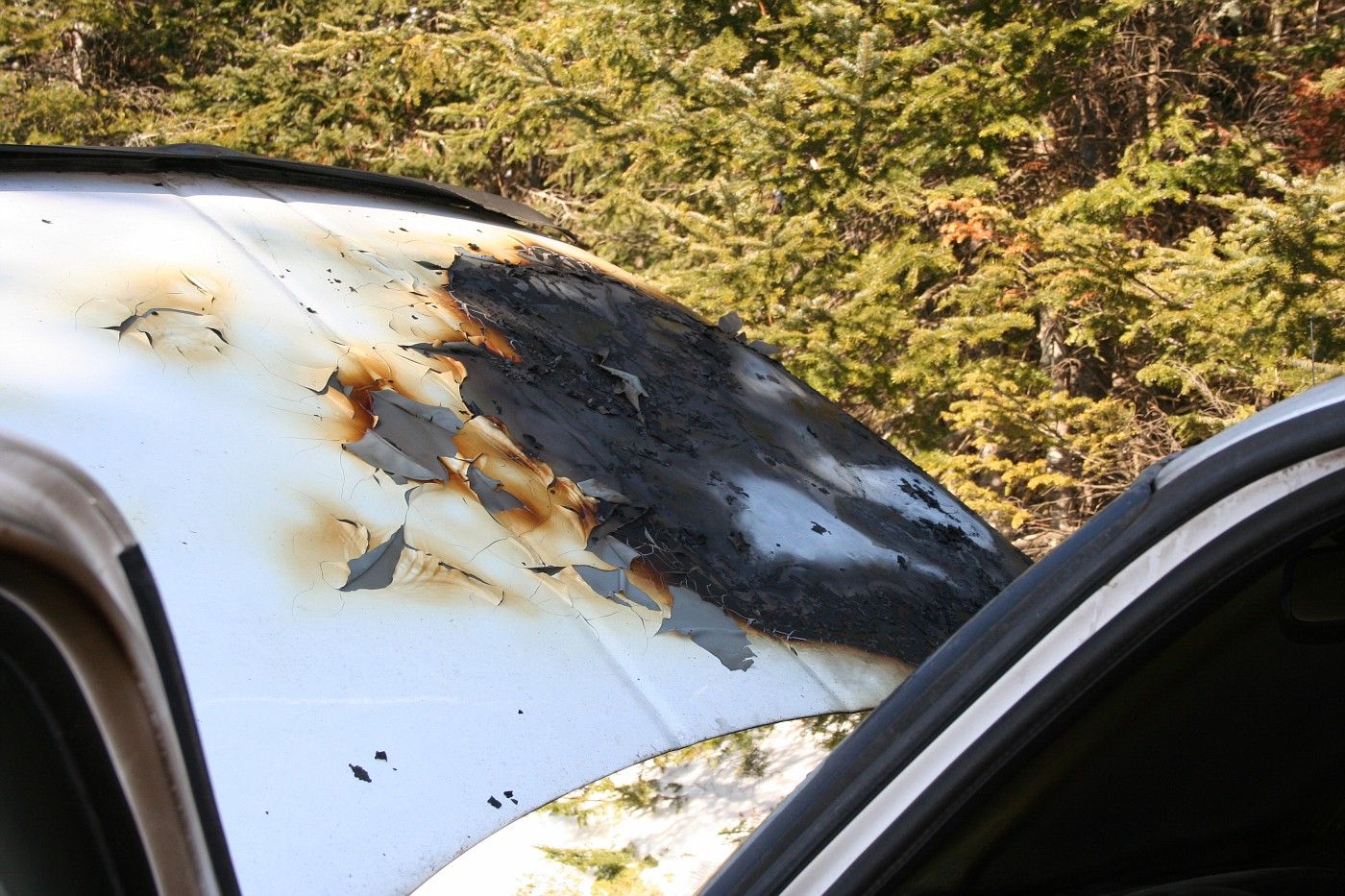

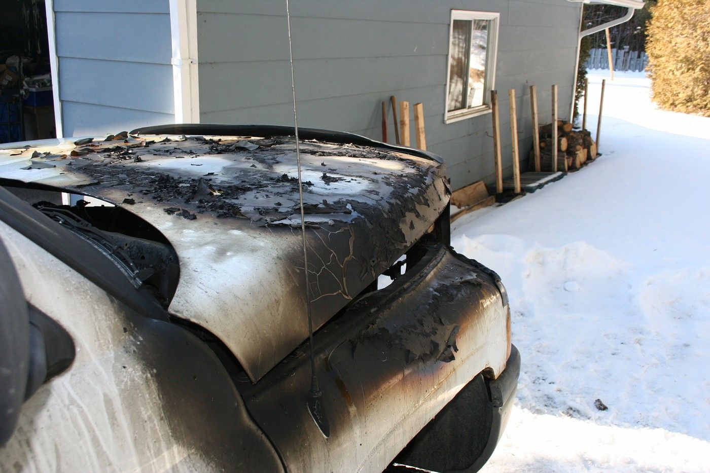

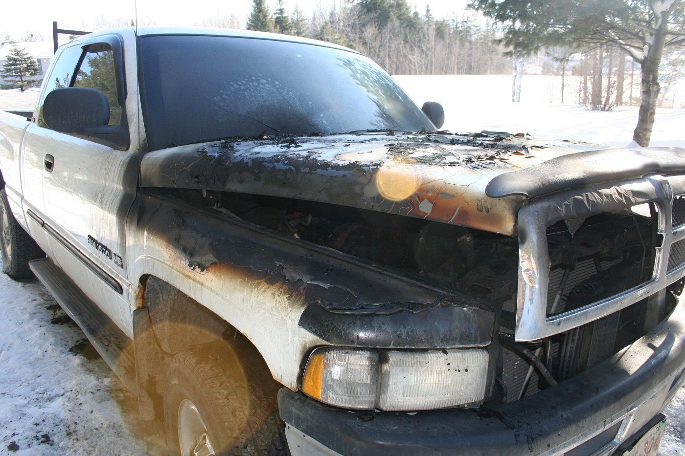

Close to the house, but thankfully didn't catch it on fire, between me closing the hood back up and playing fire bucket brigade to keep the flames down while waiting for the fire dept. to arrive (15mins later), no one was hurt (although my lungs are screwed for the next day or so), and no other damage.
On the bright side...I have excellent reference photos if I want to do a burned out vehicle!! LOL

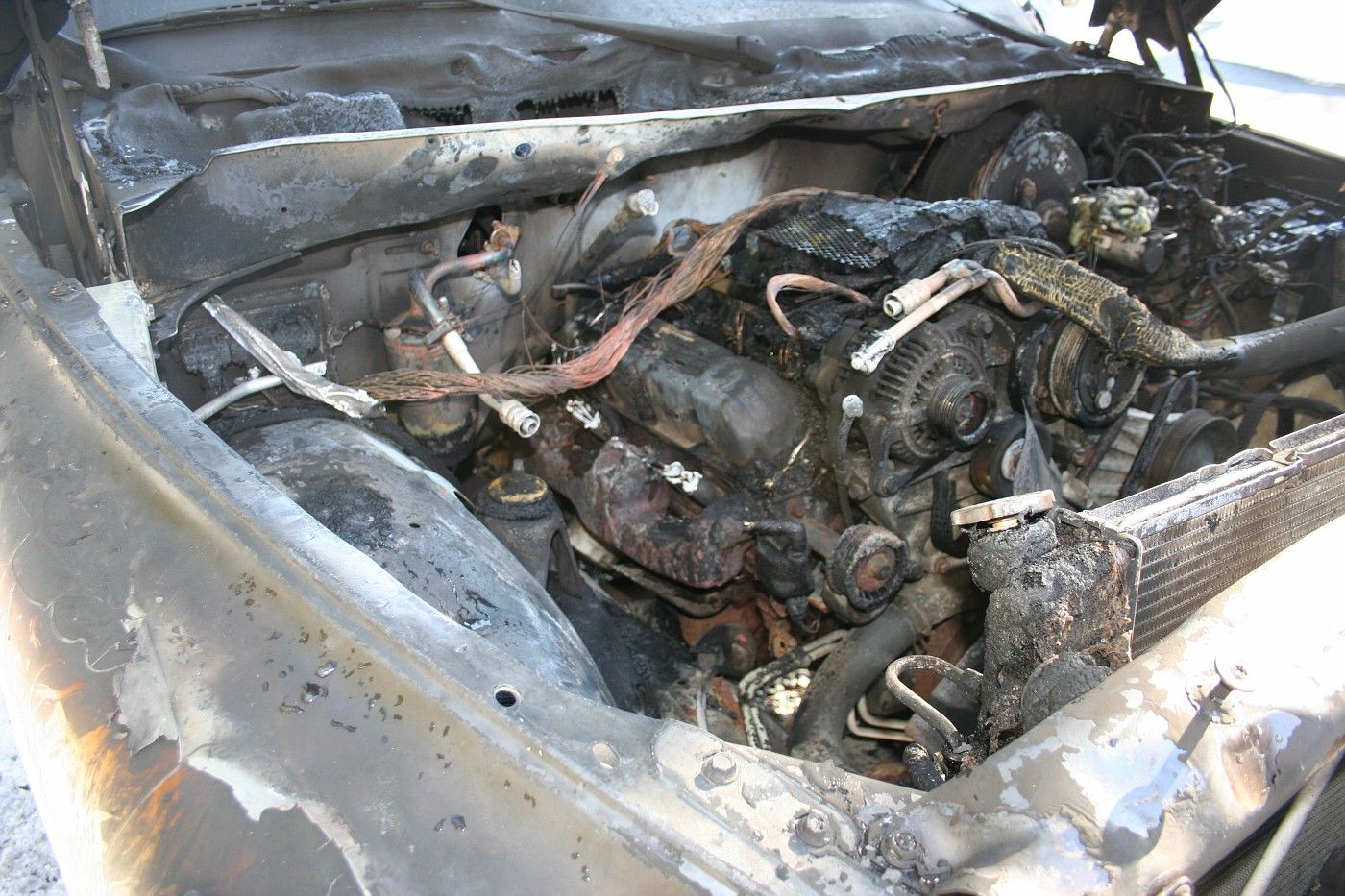

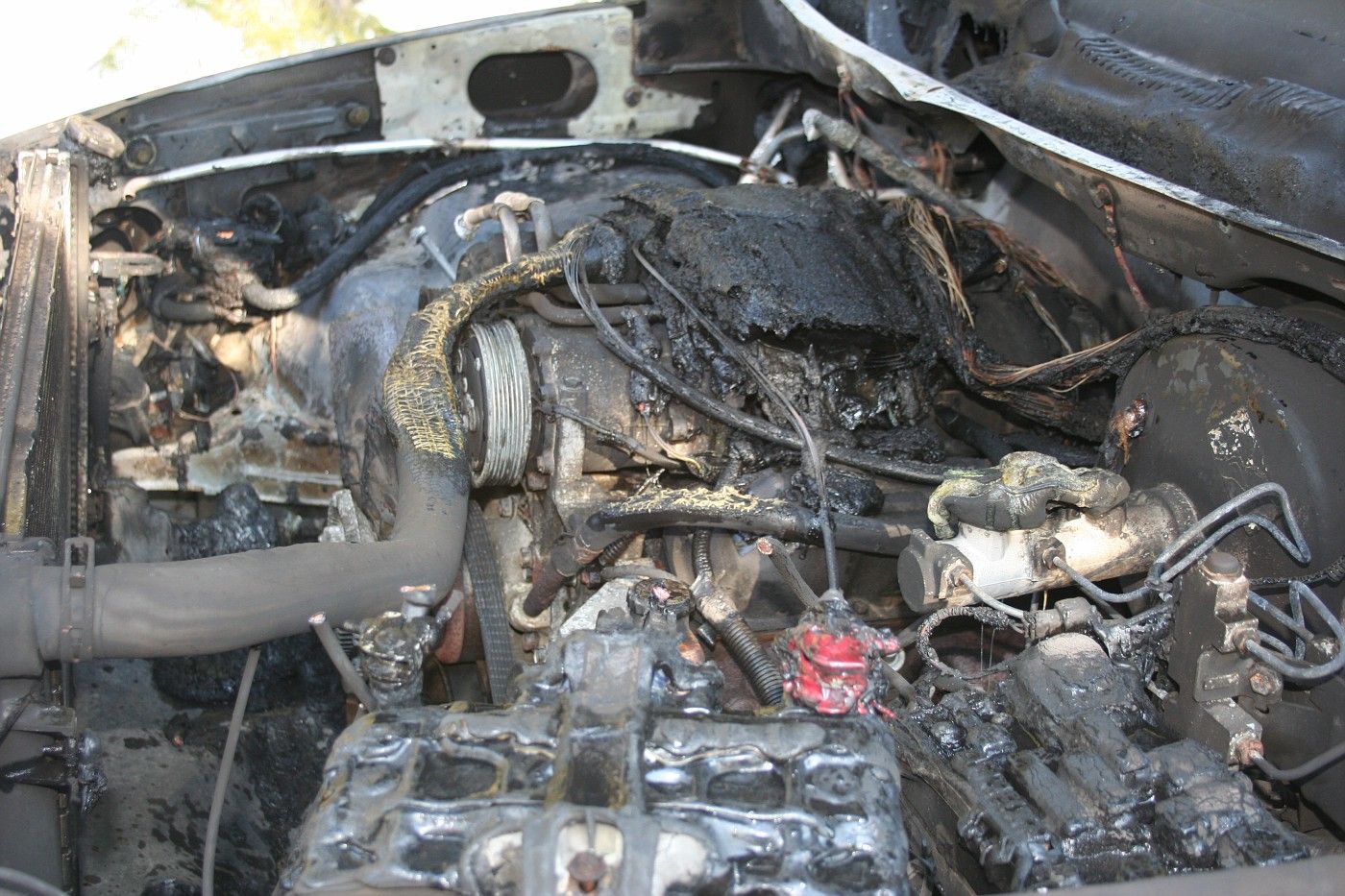

No idea what cause it...had to be a fuel leak up front somewhere, as when I first saw smoke, I popped the hood and it was all on fire between the back of the engine and the firewall, and I smelled gas just before I saw the smoke.
Thing is....the engine was cold, so even with a fuel leak, it would need an ignition source....so not sure how it ignited.

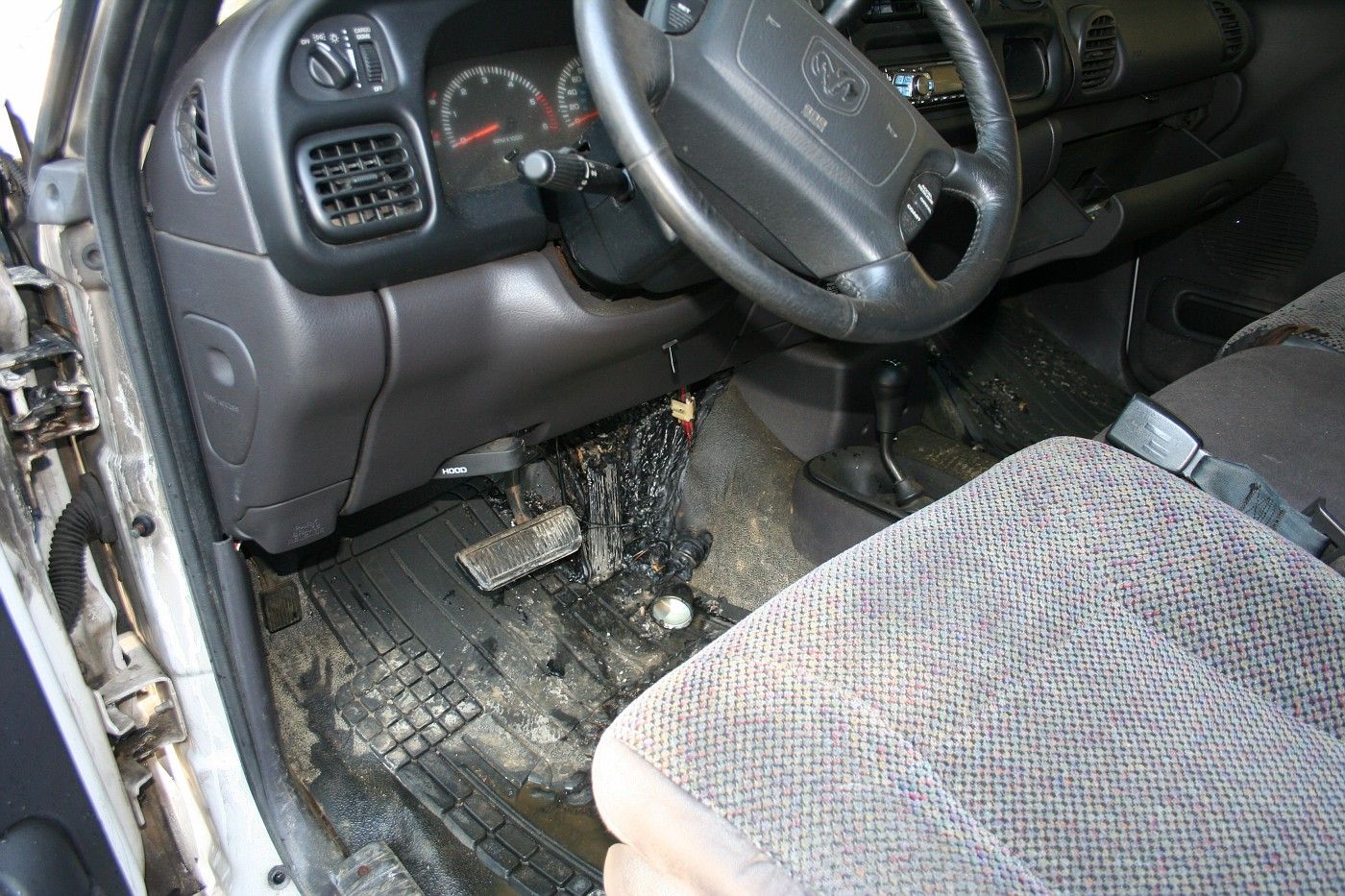

Nah....had to be a gas leak....yeah wiring can burn, but wouldn't flare up like it did, like we are talking 6ft raging flames between the back of the engine and the firewall when I opened the hood. Which btw, a firewall....yeah...that is a misnomer, I had a look today and the whole top of the dash from the passenger side over to the center of the driver's side is just gone where the fire came back through the interior.
And, I smelled gas just before I saw the smoke from under the hood. Thing I can't figure out is how the gas ignited, as the engine was stone cold.
As well, when I first started it, it ran for a second and quit, started it again, ran for a second and quit, and when I turned the key again, it sounded like it wasn't getting any fuel, so I have a feeling the fuel line broke, but still doesn't explain how it got ignited...unless some of the fuel got into the ignition system, and when I tried to start it the last time it ignited the fuel.
Either way....insurance appraiser was here today, so I should find out in a couple of days the status, and while they can't tell you on the spot, he indicated that it would likely be a right off.

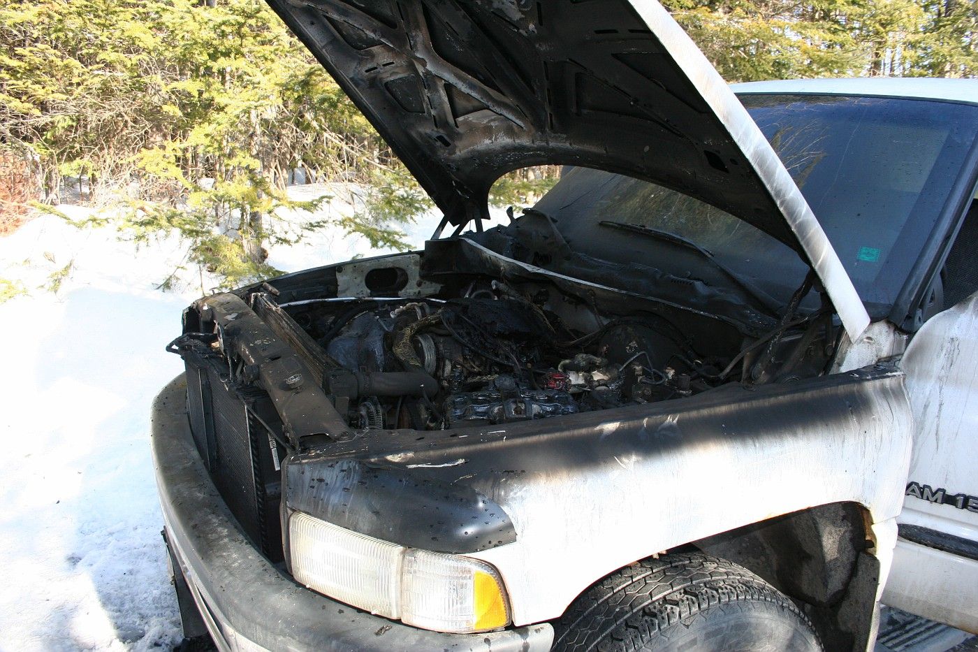

Holy S&*T!!! :-X Gotta love those pics brotha', for reference purposes alone!!! Flaking paint and melted wires...soot on the fender even with some streaking!!! You know it, I would love to find a nice plastic Dodge to wreck like that!!! Those pics are tremendous!!! LOL...I have that Chrysler 300 in the stash, that would make one heck of a melted mess!! Must be strong!!

Scott ,if the fuel line broke somewhere near the engine ,its quite possible that the alternater sparked the fire ,I've seen that before ..a few times ,the fuel squirts into the alt you turn the engine over ..bang fuel ignites !!!
Chris.
I agree with Chris, about the Alternator... now the question is how did a fuel line broke? due to cold?
Now we already gave T, an Idea ;D
No idea....but it wasn't that cold yesterday when I went out...right around freezing, I have been out in it before when it was much colder and started with no problem.
Only thing I could think is if the fuel line was old and weak. And under the pressure from the fuel pump it just burst.
Its possible about the alternator....never thought of that...basically an open electric motor, the fumes at least (which would what would have ignited) could have gotten in there, and it flashed back to the fuel leak.
