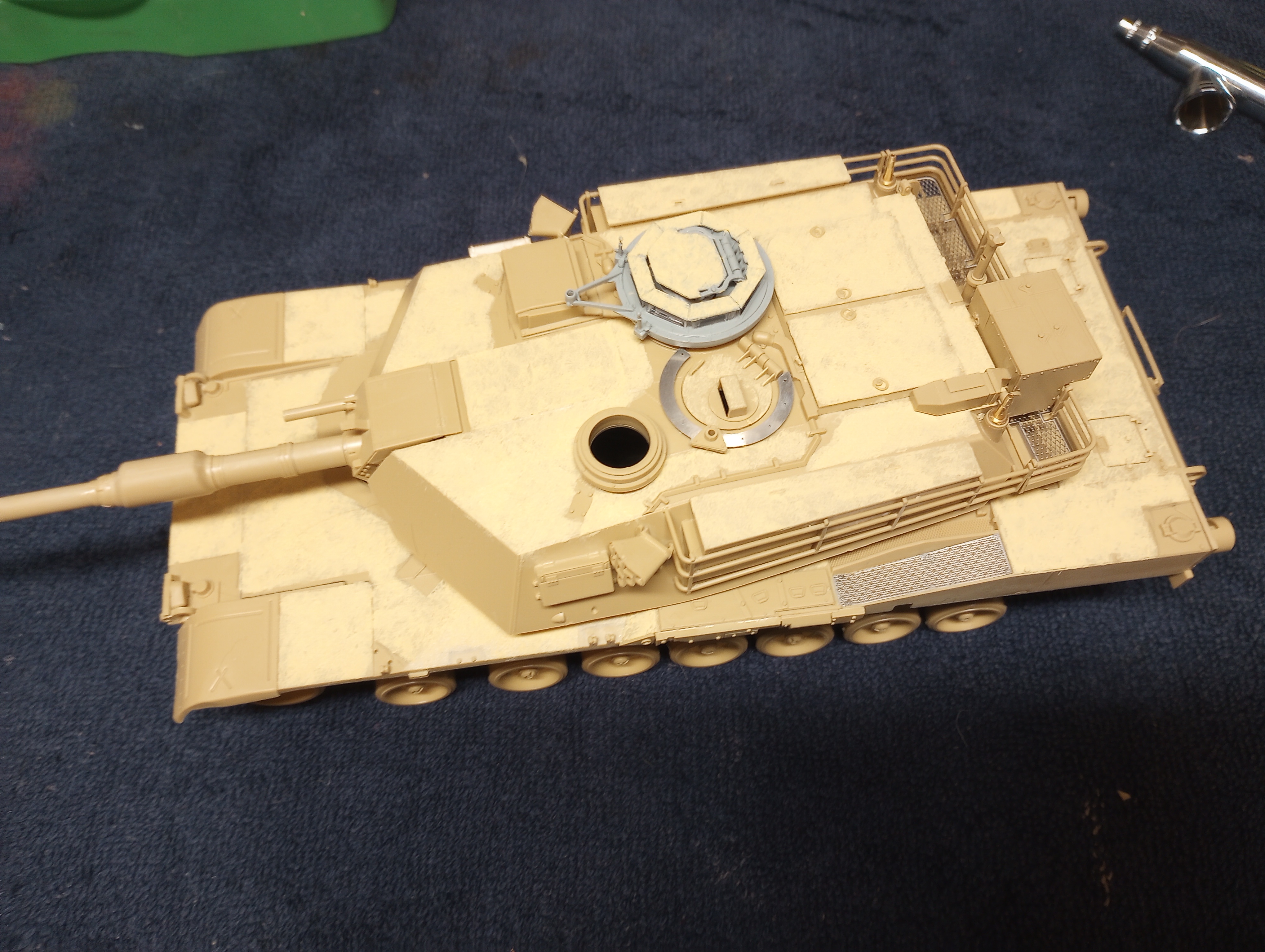

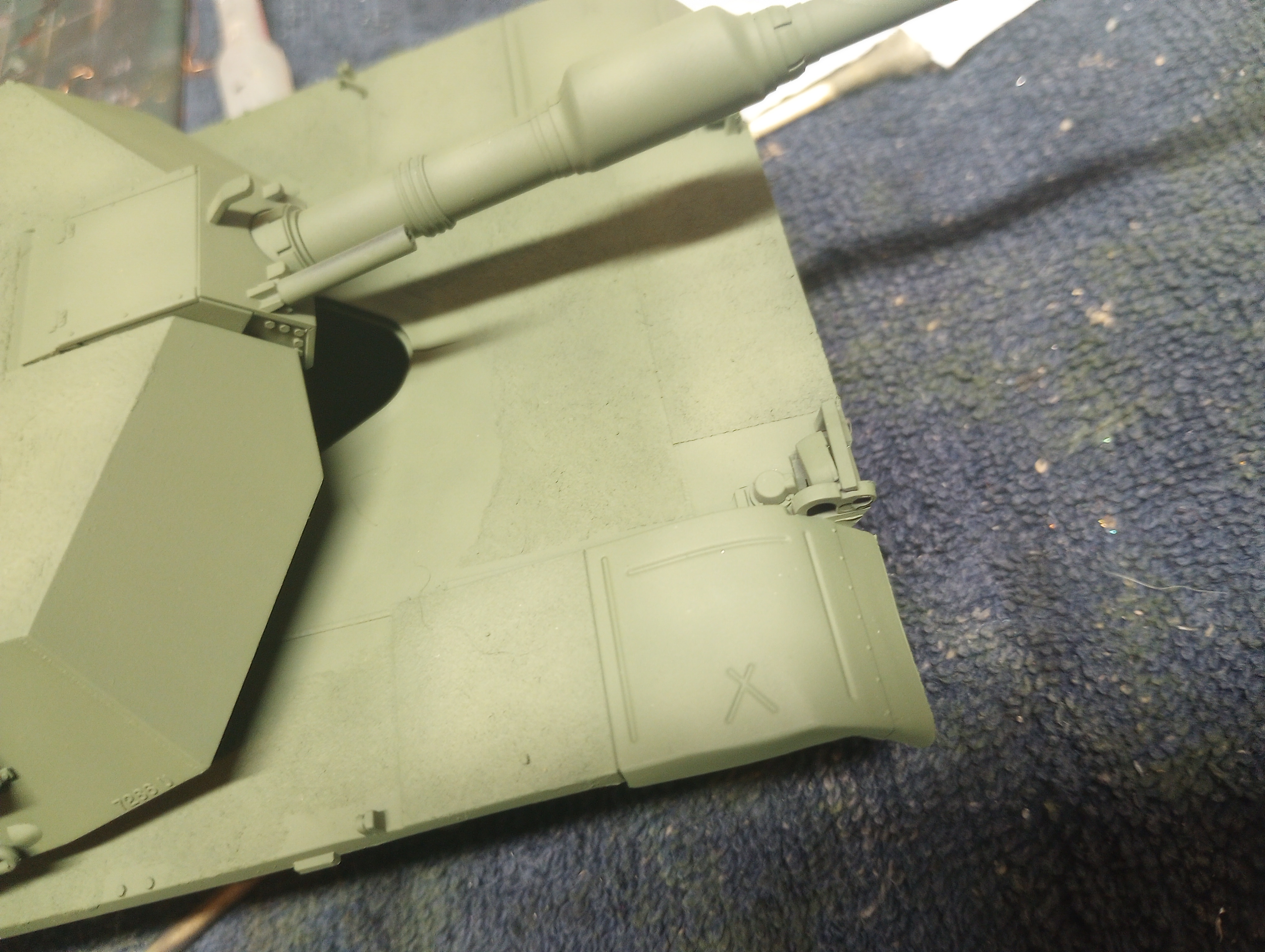

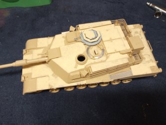

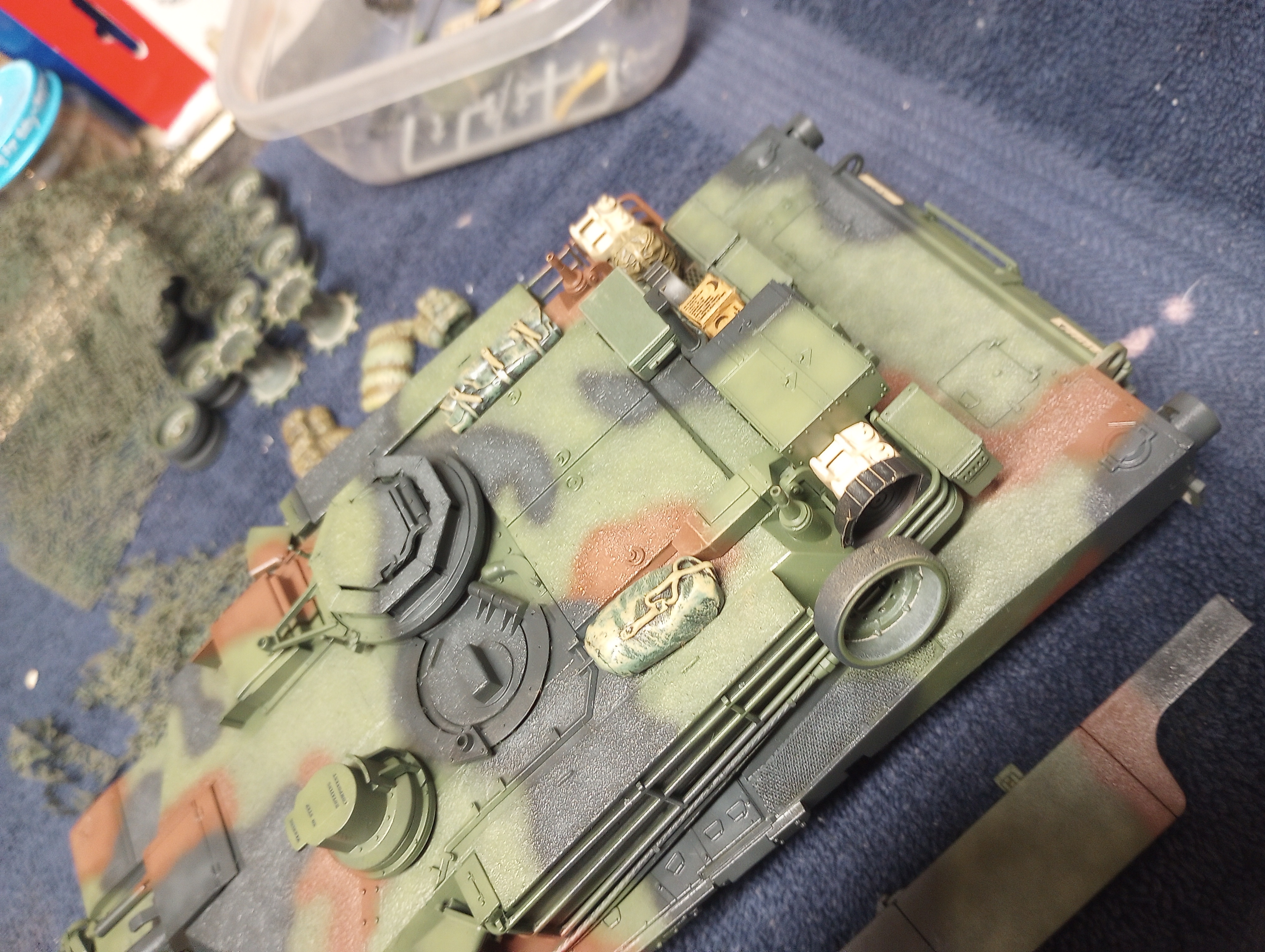

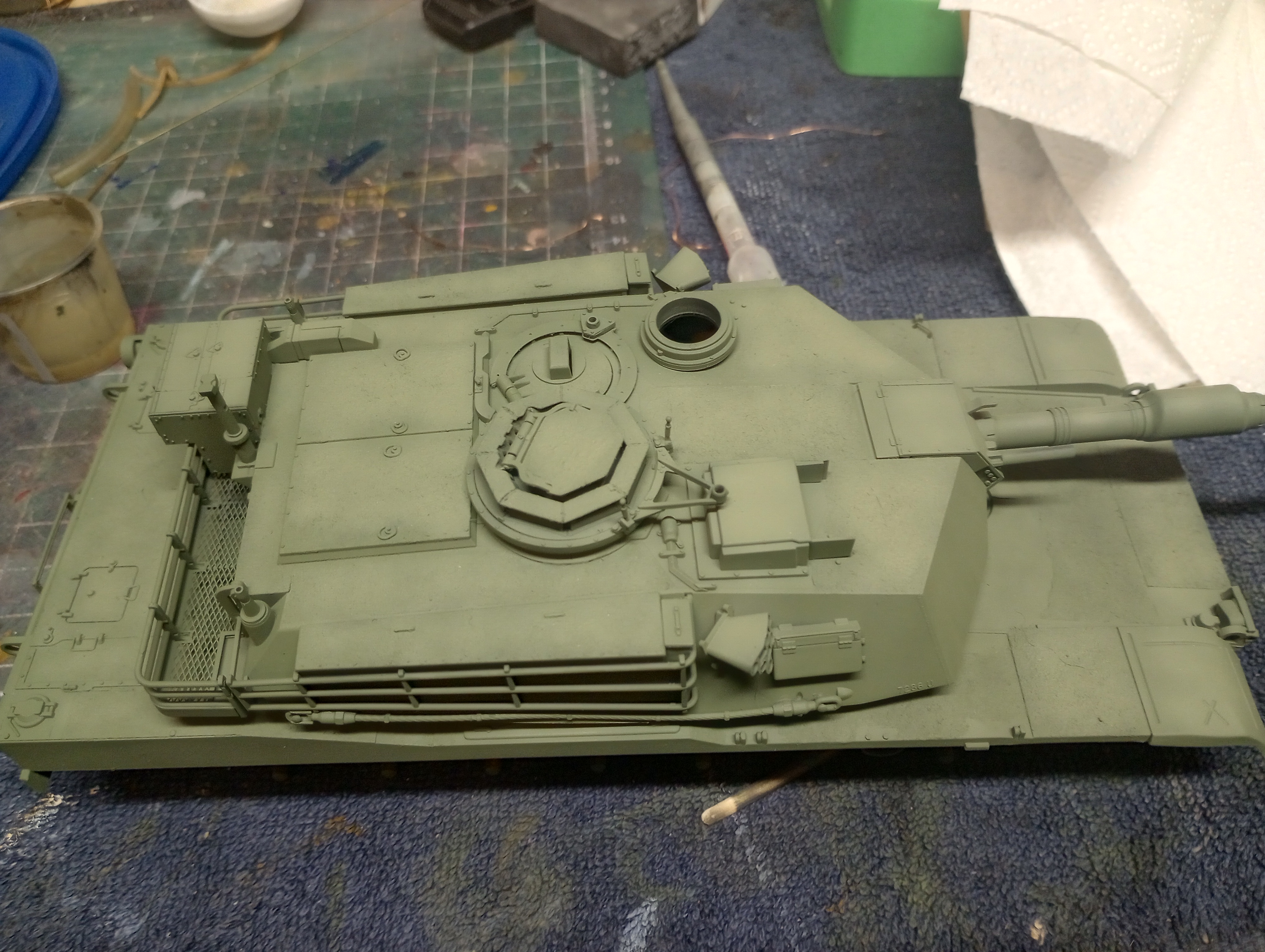

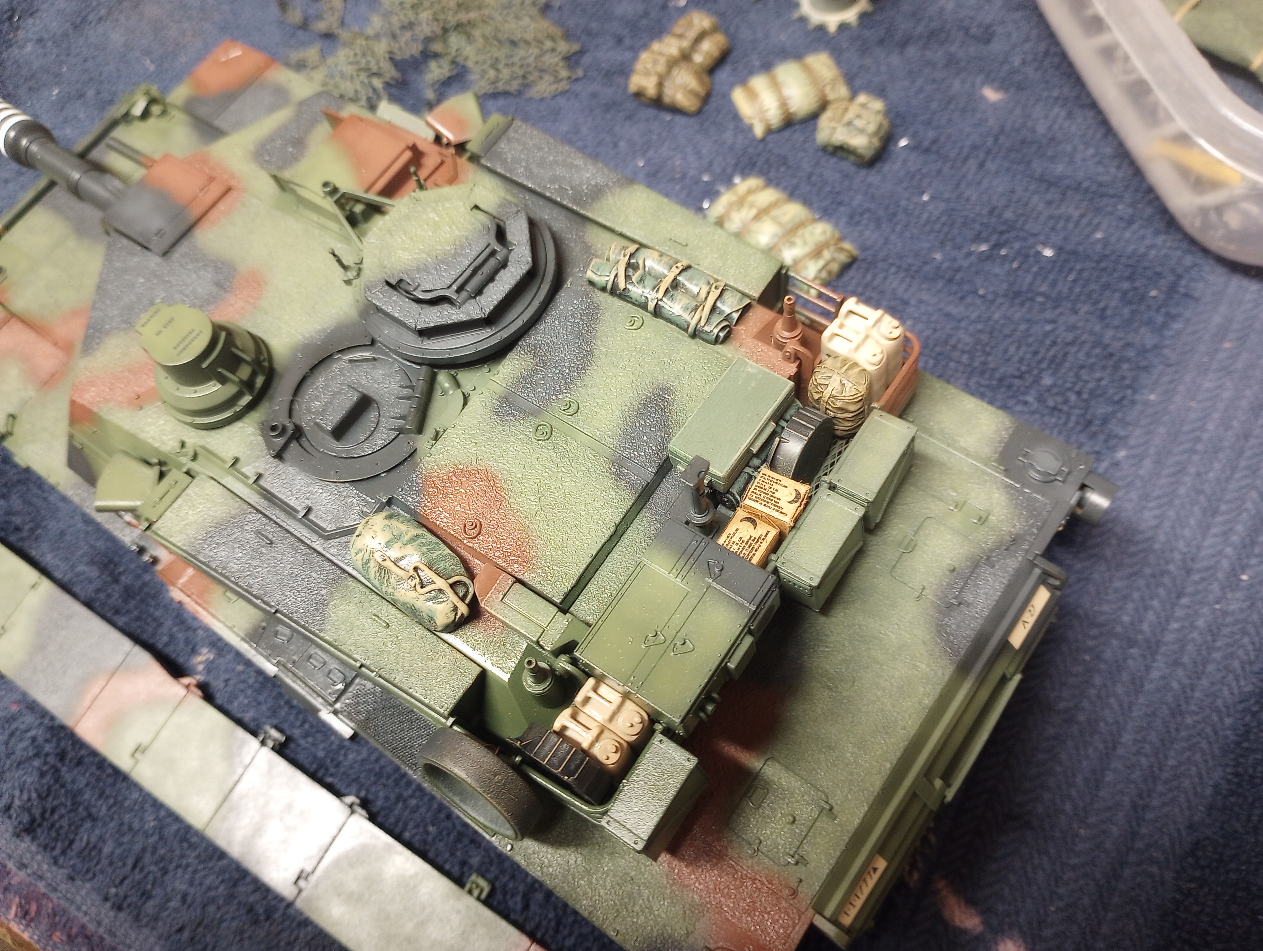

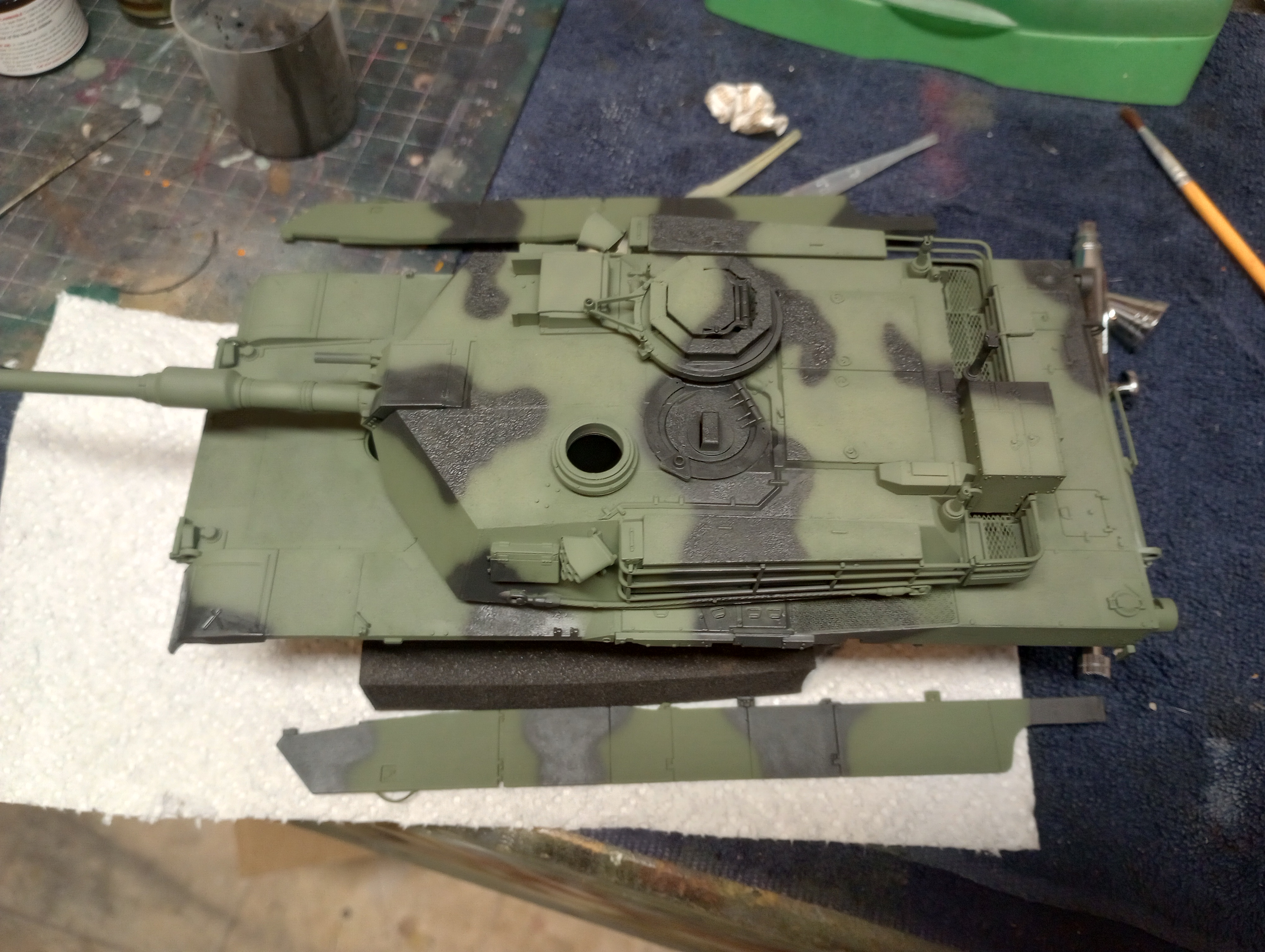

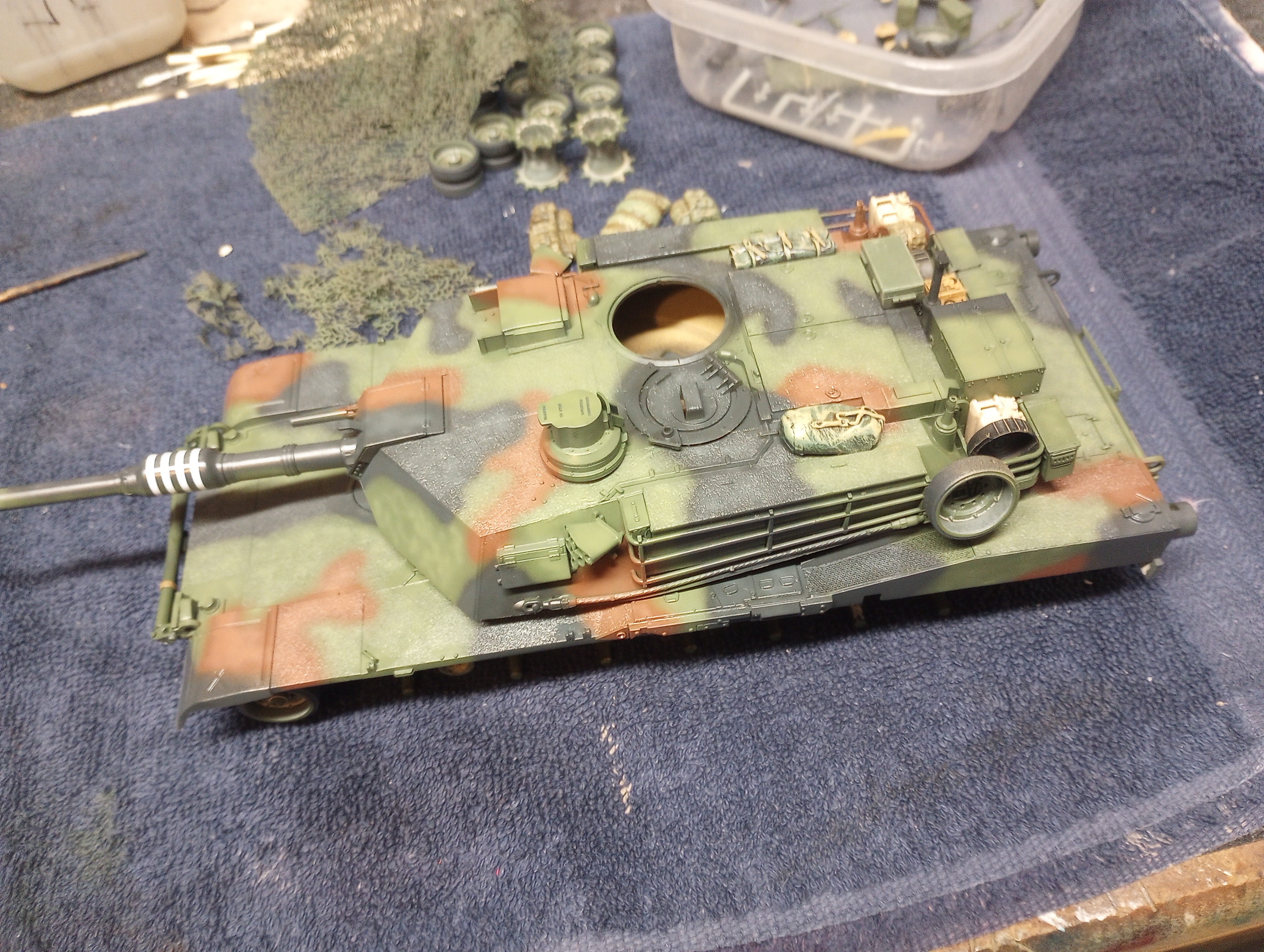

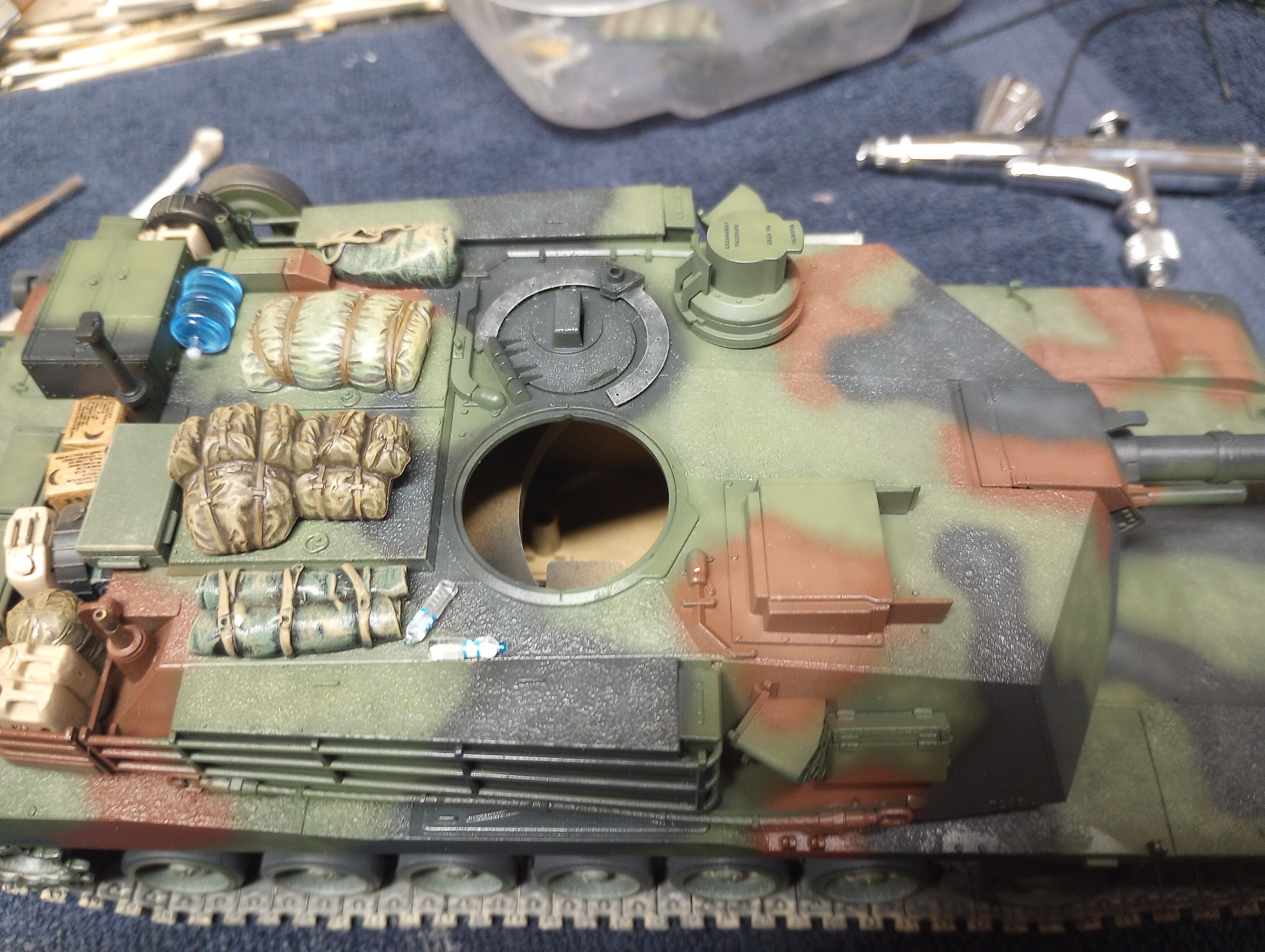

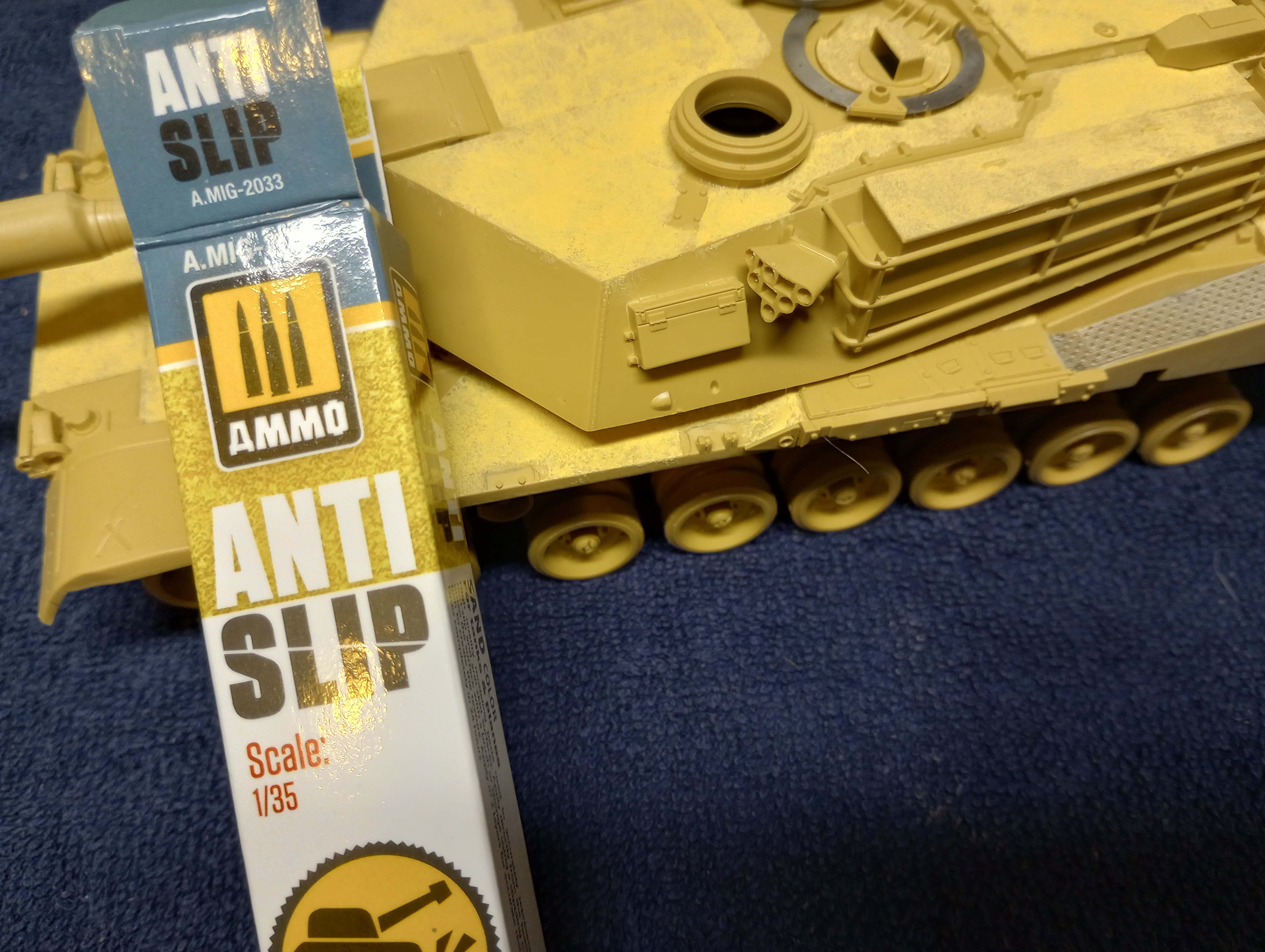

Dunno about the Ammo... The stuff I've used has been either textured decal, PE or stamped brass sheets you glue on.That is interesting!
The Ammo anti slip texture you can apply with a sponge or q tip or a brush. I used a brush and it reccomends to apply it twice, looks legit too. A lot easier than masking the entire thing and using something like the Rustoleum spray texture paint, which is what I used on my M2A0 Bradley.That is interesting! Do you have to cut up cellophane and glue on, or is it a paint you apply?
I did a Merkava about a year ago and the anti-slip texture was molded in, but I saw advanced modelers were applying their own.
I guess that makes it officially awesome!Army technical manual

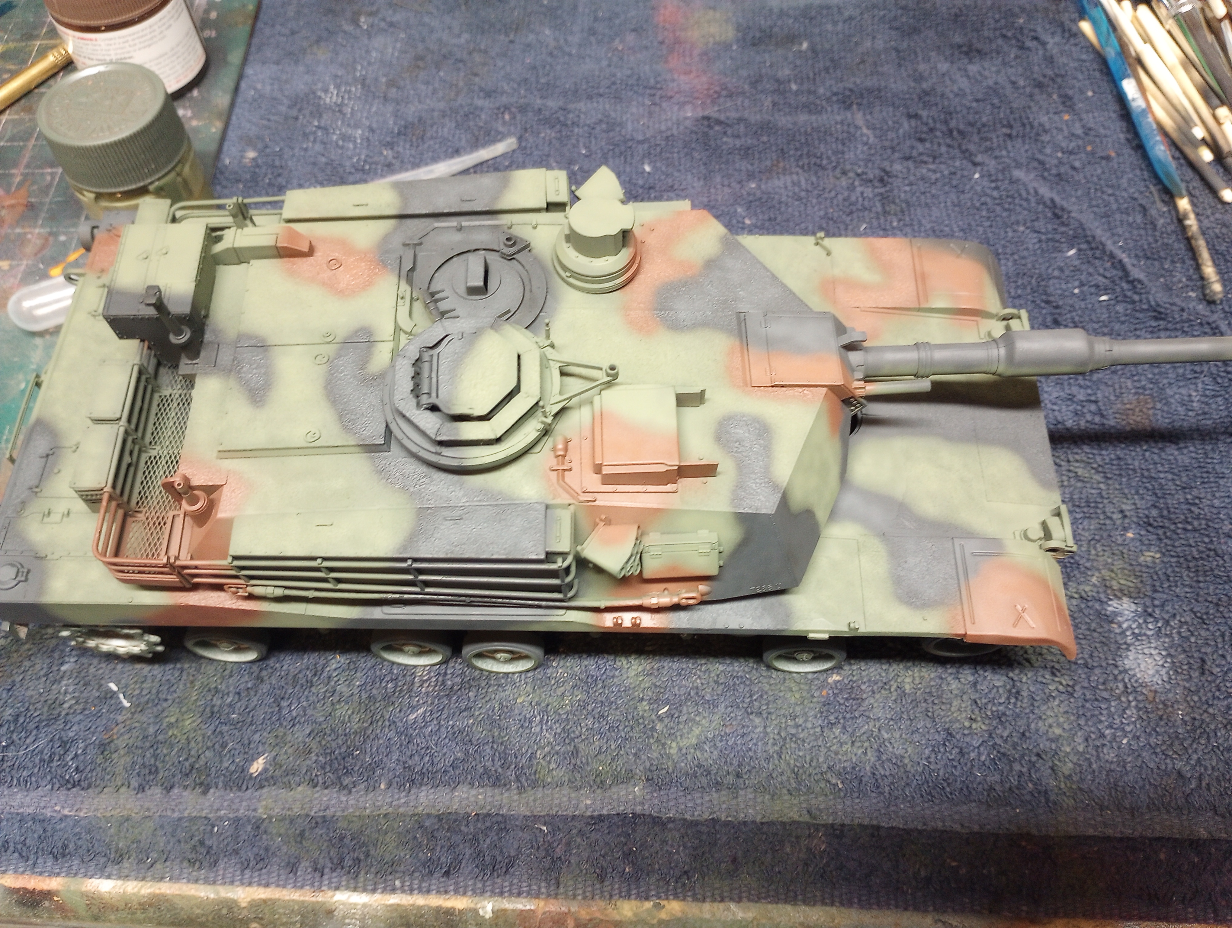

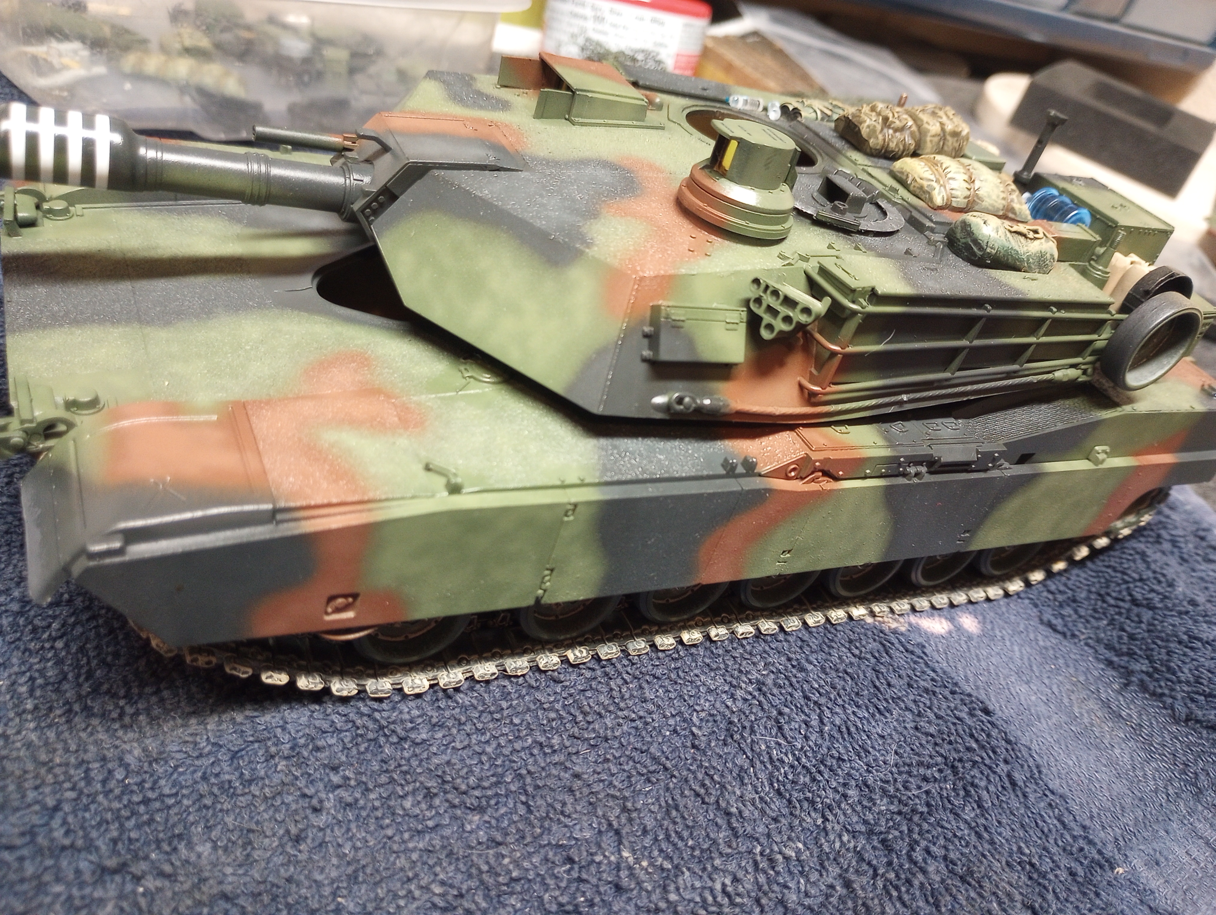

Best thing to do, IMHO. Why base yourself on a kit manufacturer's interpretation of (probably) photos when you can just go straight to the source?I'm using painting reference directly from an Army technical manual.
When I was in the Army, all of our Bradleys got repainted, and I was on the detail for the contractors doing the work. They'd paint, I'd move the Bradleys in and out of the booth. I worked 24 hours on followed by 48 hours off, not a bad detail. Anyway, at the time, they'd come in with some drawings and chalk, and draw out the pattern on the freshly painted green, like a paint by numbers thing. Nowadays, it's done by computer controlled sprayers.Best thing to do, IMHO. Why base yourself on a kit manufacturer's interpretation of (probably) photos when you can just go straight to the source?
(I've got a number of US Army painting manuals, as well as a German one, from the 1970s through the 1990s. Too bad I don't build many vehicles from this timeframe anymore.)

Since returning to the hobby in 2024 I found out that camo patters were not random, at least usually. That said yes, RTFM is always good advice!Why base yourself on a kit manufacturer's interpretation of (probably) photos when you can just go straight to the source?
For camouflage-painting Leopard 2s in the 1990s, the Dutch Army used an overhead projector with transparencies of the pattern for the sides, front and rear, so they could trace it in chalk on the tank. Only the top was done from a drawing.Anyway, at the time, they'd come in with some drawings and chalk, and draw out the pattern on the freshly painted green, like a paint by numbers thing. Nowadays, it's done by computer controlled sprayers.
