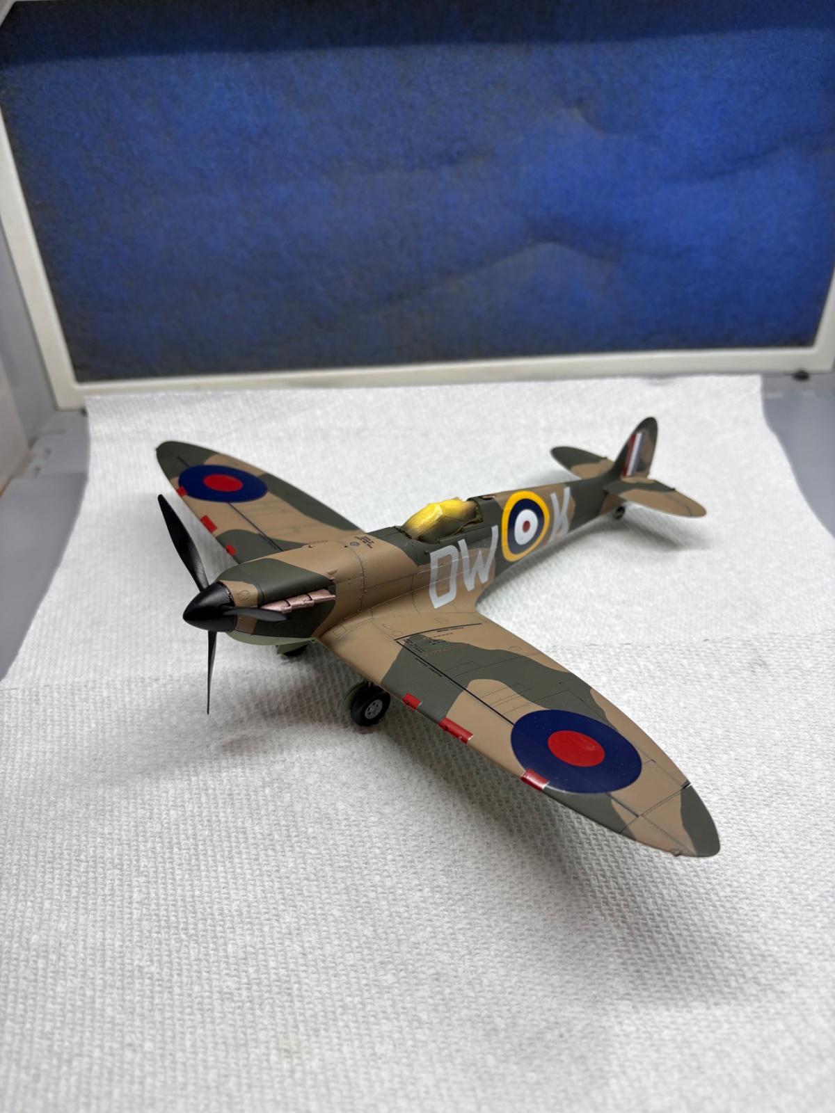

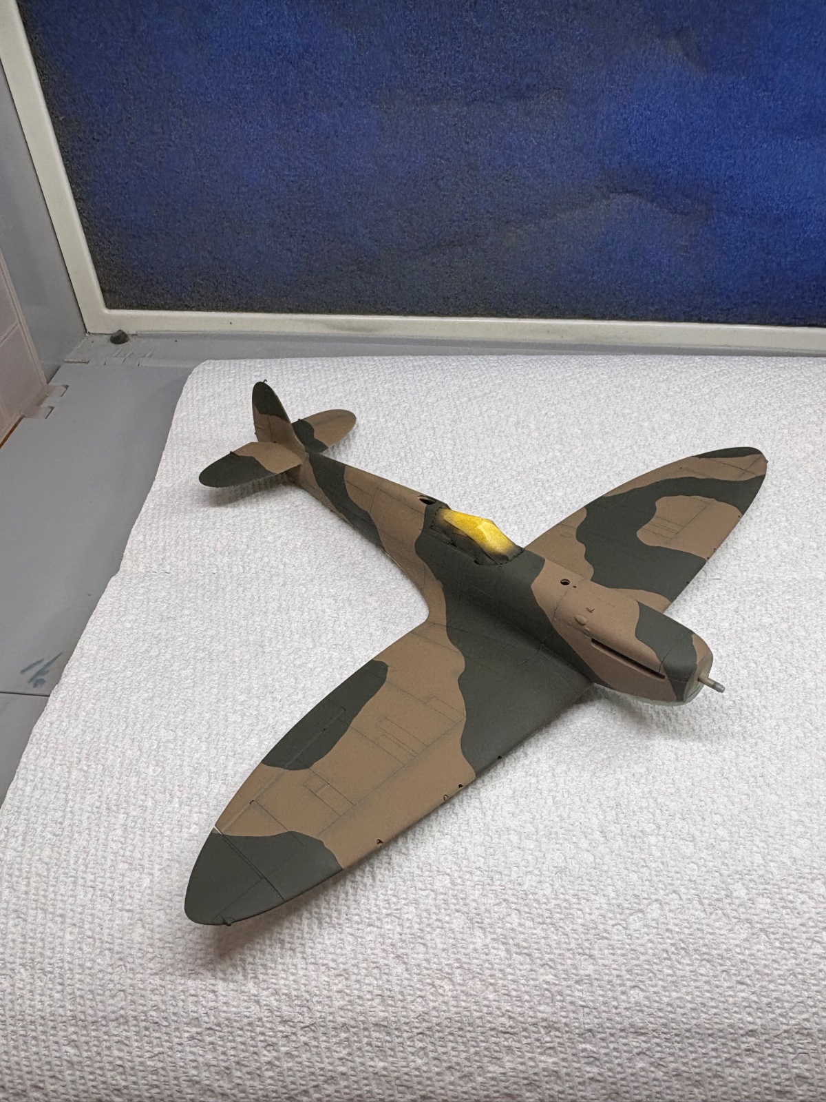

Finished
The chipping came out great. My only suggestion would be to add some chipping on the wing root and near the door, areas that get most of the traffic from pilots and mechanics.
I use a sponge and Tamiya flat aluminum on aircraft. Ive tried doing them with a brush and I've tried pencils but I get the best results with a sponge.
Thanks. I did add some there but went light. I'm afraid I'll do too much and it will look silly. One guy I like on YouTube always says don't get carried away with the weathering on aircraft because any good pilot isn't going to get into a plane that looks like it's about to fall apart.
Could probably put some by the door. And some more a little further up to the engine.
The edges around the door are a good place, but not the door itself: since a Spitfire door folded down, pilots and ground crew getting into the cockpit would eventually wear the paint off the fuselage but not off the outside of the door itself. Even then, it would only be very little, I'd say, like in this photo:
Most of the wear is on the upper edge of the inside of the door, because of course that's where everybody puts their feet.
Oh I seem to have missed that top down photo showing the chipping on the wing root. That looks great, no need to do more there. Yes I agree too much weathering is simply that … too much !
