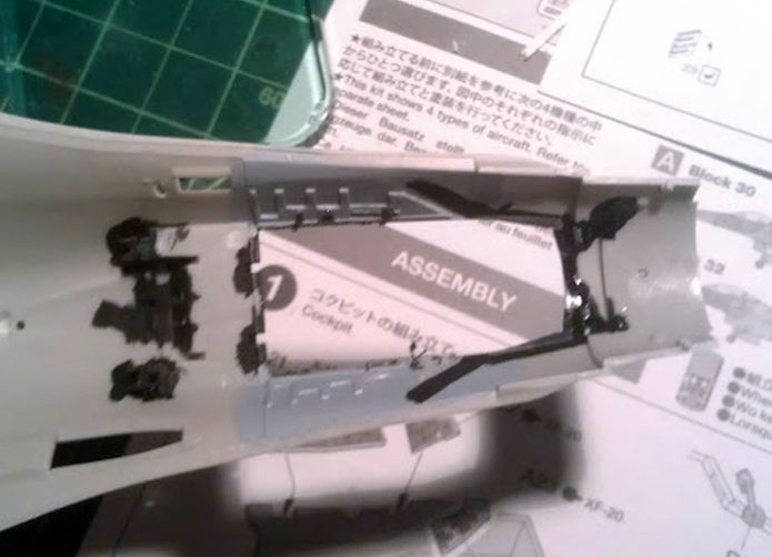

As with any aircraft, the starting point is the cockpit. While the detailing on the kits parts is really nice, it had to be removed to make room for the Eduard PE, which has far better detailing when taking my hand painting out of the equation! I found that Testors Acryl Haze Gray 1/2 is a 90% match to the color of the PE parts so the tub and the fuselage interior was painted with that.
The exterior rim that the canopy will sit on is black. I also figured I’d paint up the seat and dashboard before adding the other PE bits…the unfinished bits add a nice little touch of variation for me. Being able to see the details is important at this scale!

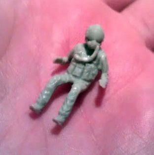

The pilot was also slightly modified to fit in the seat with hands actually IN USE! The armpits were sanded at angles so the hands could rest on the controls and the gaps were filled with Elmer’s. The air hose also had to be heated and bent to match the angle of the turned head.

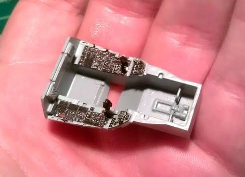

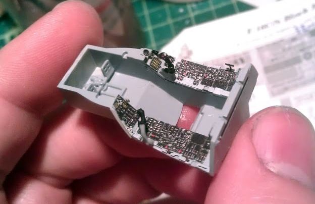

I had a nice quiet night last night hunched over my bench finishing up the details on the cockpit. The instrument panel and hood were completed and the Eduard set was utilized to it’s fullest extent.
There was a little trouble with the panels little side “hooks” not fitting properly in the bucket so some filing was needed. Other than that it went together beautifully.
I even added a little drop of clear green the HUD and Future coated the reflector so the green reflects!

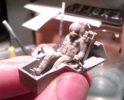

The ejector seat was also finished up with all the color PE bits and pieces, which were added after the main painting was done. A wash of MiG’s dark and a coat of flat were the last touches.
I even got a little bit further on the pilot. Yes, he looks a little glossy now but he’ll get a flat coat and some wash, too. I might have to heat the legs and push them a little closer because otherwise he has a tough time being added into the cockpit once the seat is there (I want him to be removable).

with the cockpit there are a few different techniques. the main one is that i'm using eduard's color photo-etch set. that has all the dials and knobs etc pre-painted and its really a good bit of detail that i couldnt do by hand. otherwise when i need to paint detail, i use a very thin, round tip brush. masking things always helps, too.
