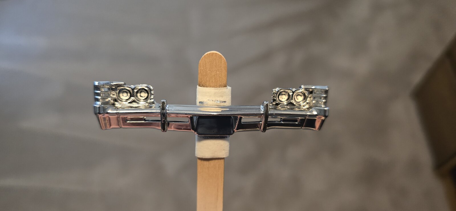

Aside from using BMF, which I still struggle with getting clean cuts, I found this on Amazon recently and wanted to give it a try. Fusion Firm Chrome
Wow, this stuff is even better than Molotow (imo) and is VERY easy to apply, right out of the bottle with minimal prep.

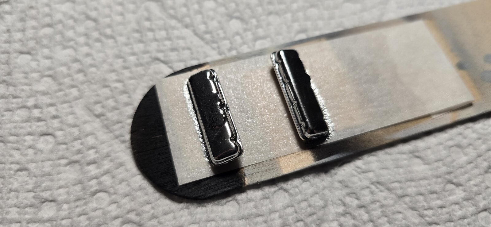

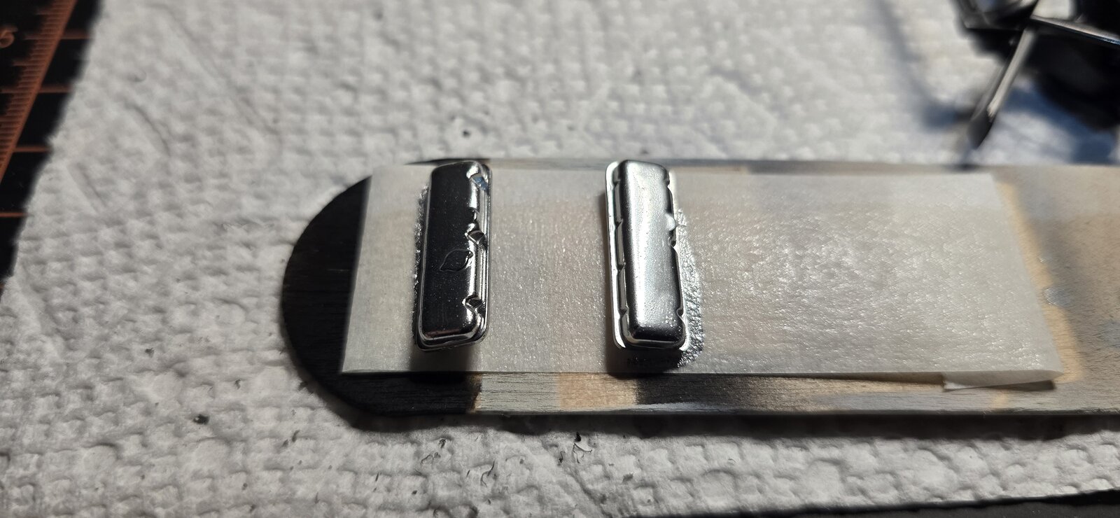

It comes with an applicator brush inside and I put a single coat onto the bare plastic valve covers. The finish is impressive and I think I should've ensured the parts were completely clean, but for a brush chrome, this works very well.

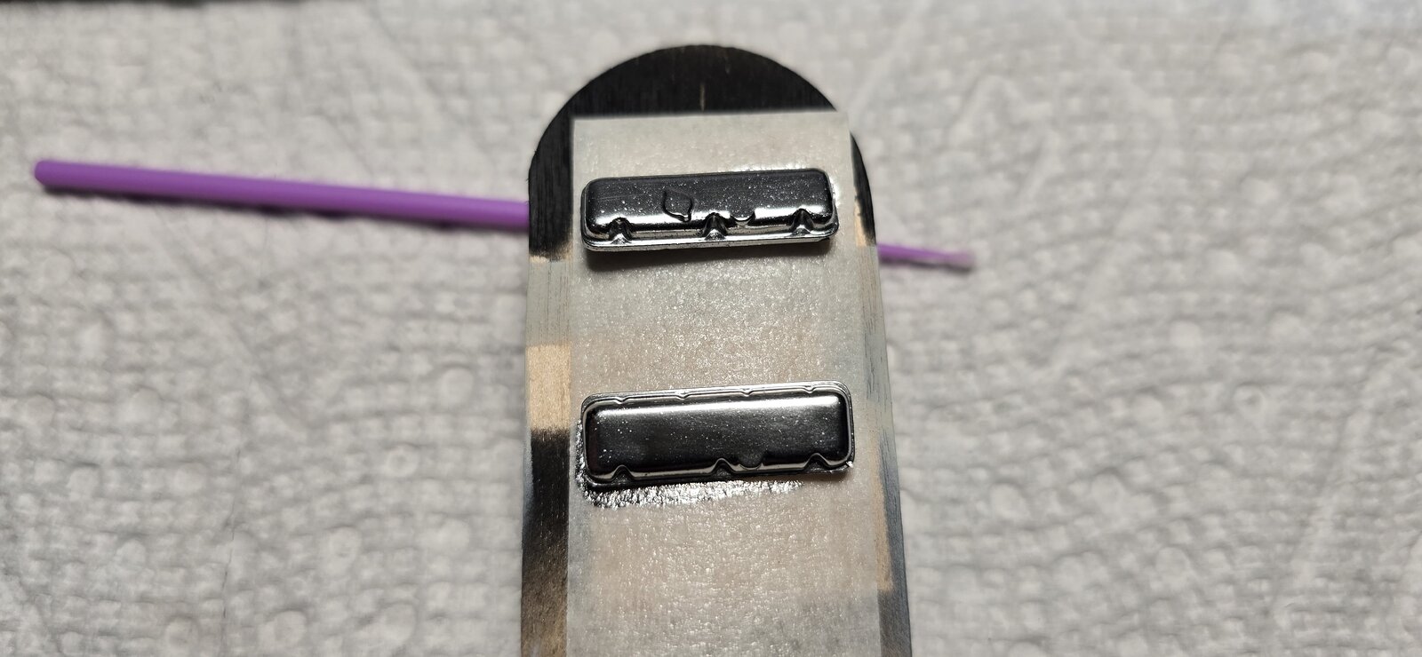

The instructions say to apply, let set, apply additional coats if desired and allow 72 hours to dry, then apply the included lacquer. I applied a single coat this morning to the 1/25th scale 427 Valve covers, (which were cast in black) and will follow up with photos of the lacquer application, but this worked great.
Added the lacquer, it did dull the shine a bit. Not sure how durable it is without the lacquer, may try it without and see how it holds up.

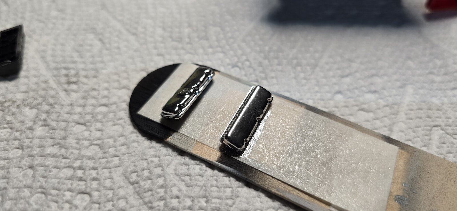

I posted this in another thread, but to add to the abilities of FusionFirm;
This is FusionFirm, right out of the bottle, with the brush over factory chrome, (not stripped).
I initially just wanted to see if it would cover nicely, and it did not disappoint, 2 coats, over 24 hours.
This is pre-lacquer.

That's a nice finish- It's probably even a bit better than Green Stuff. I wonder what prep (if any) was used, and how it was applied. The FusionFirm is so easy, right out of the bottle with the brush, and required no prep. I painted that bumper right over the existing chrome finish. May have to do the plastic spoon thing to see how it does.
