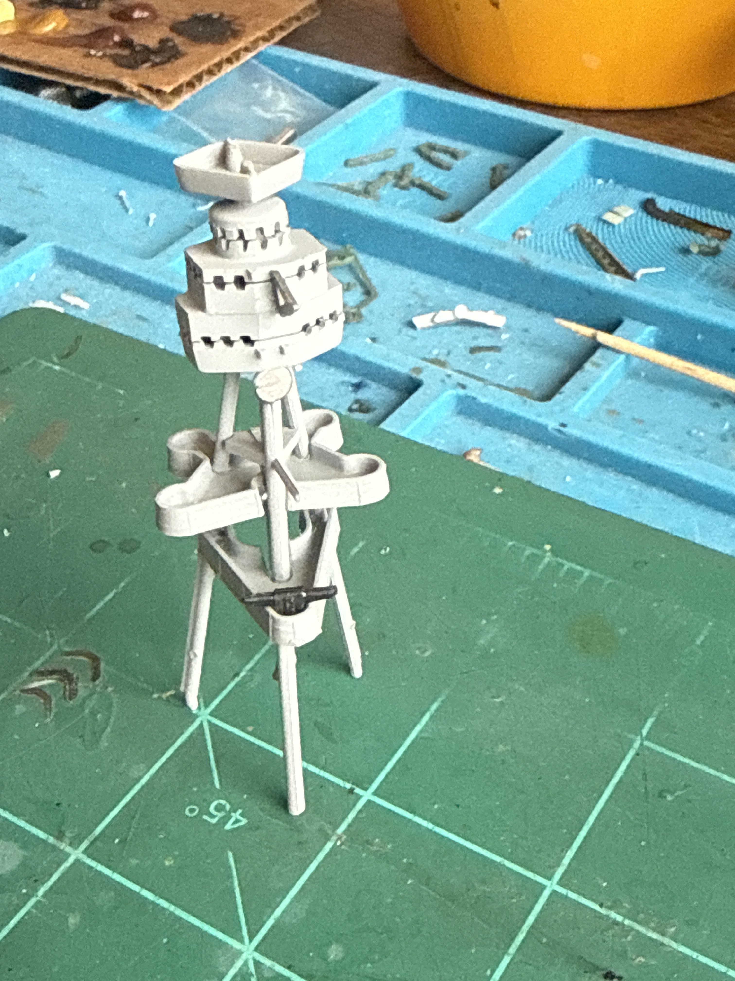

And the other tower

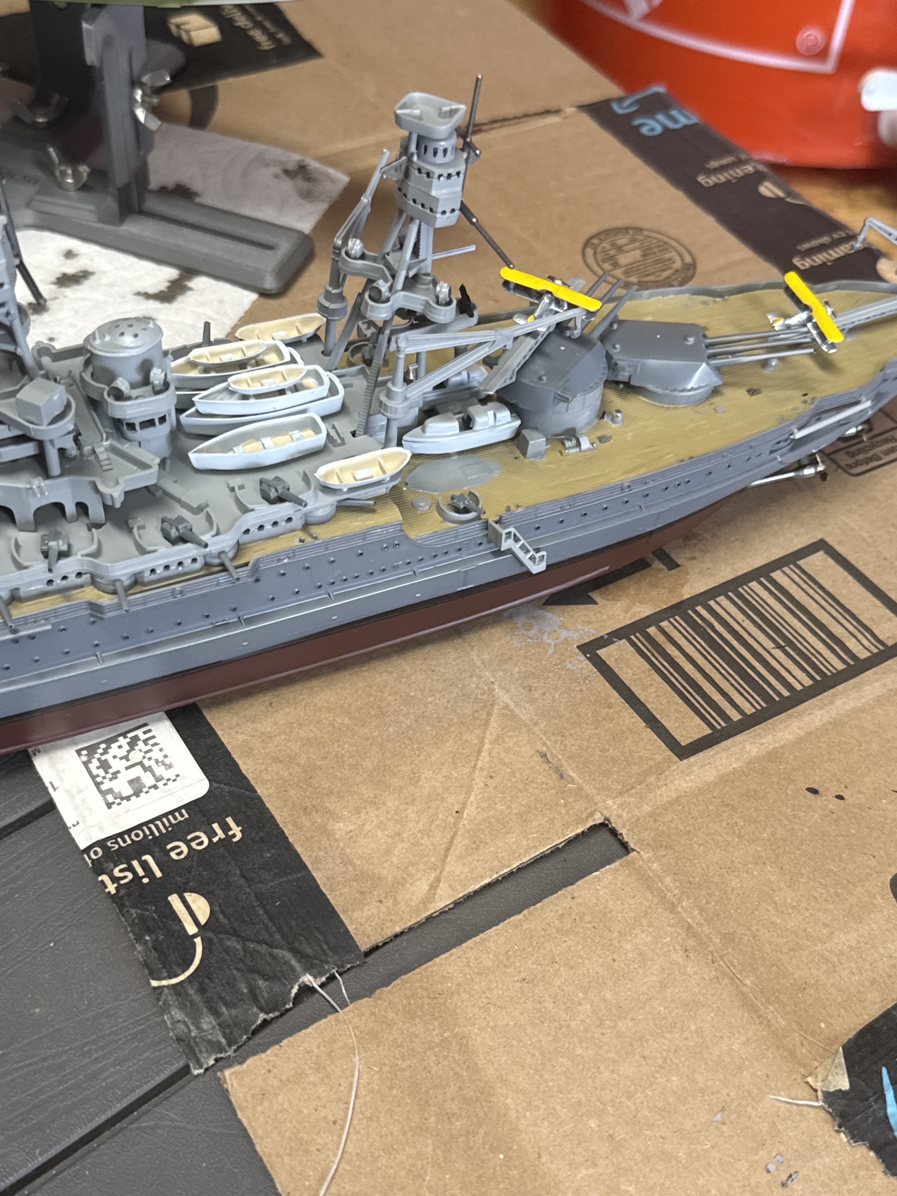

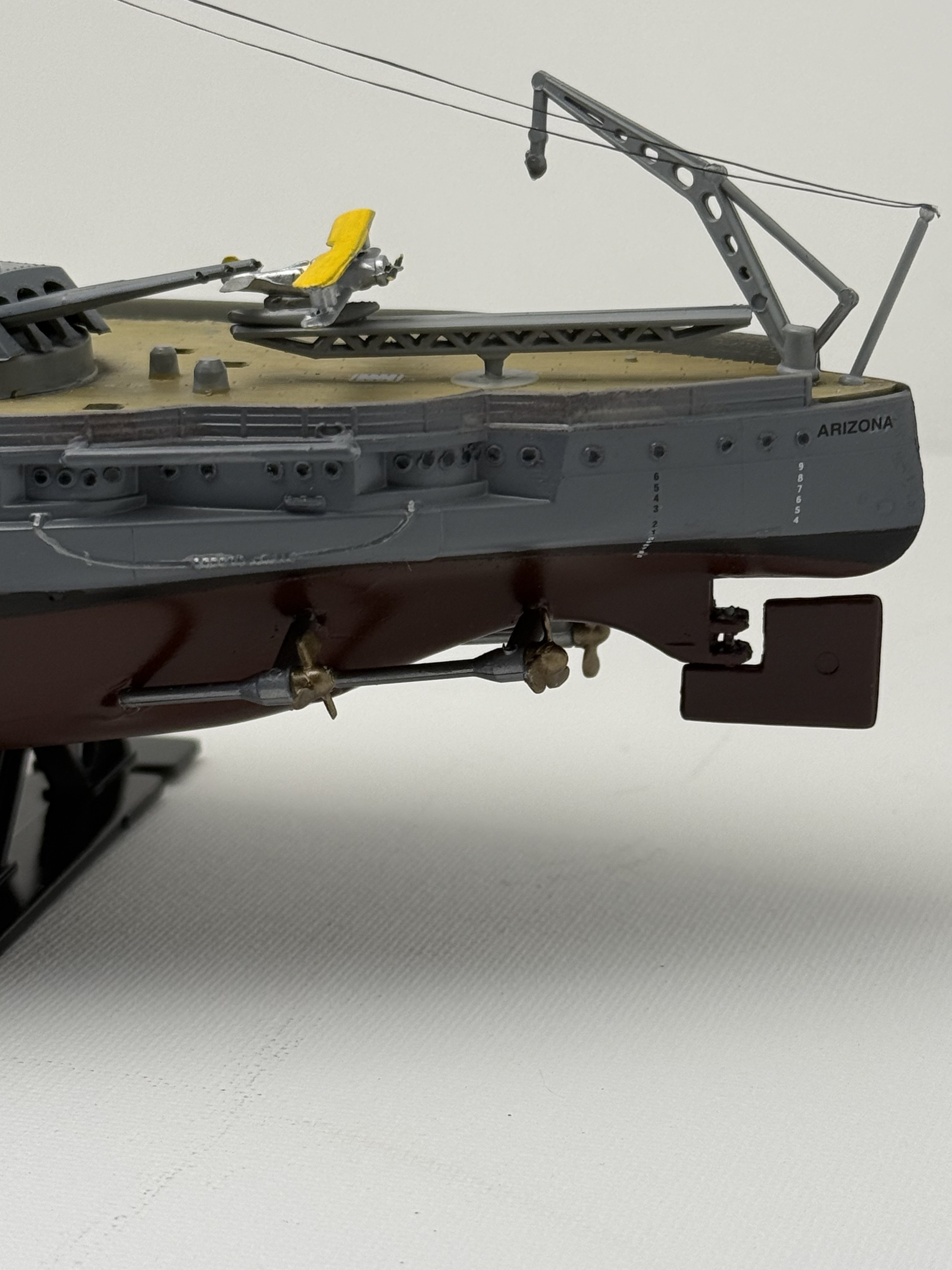

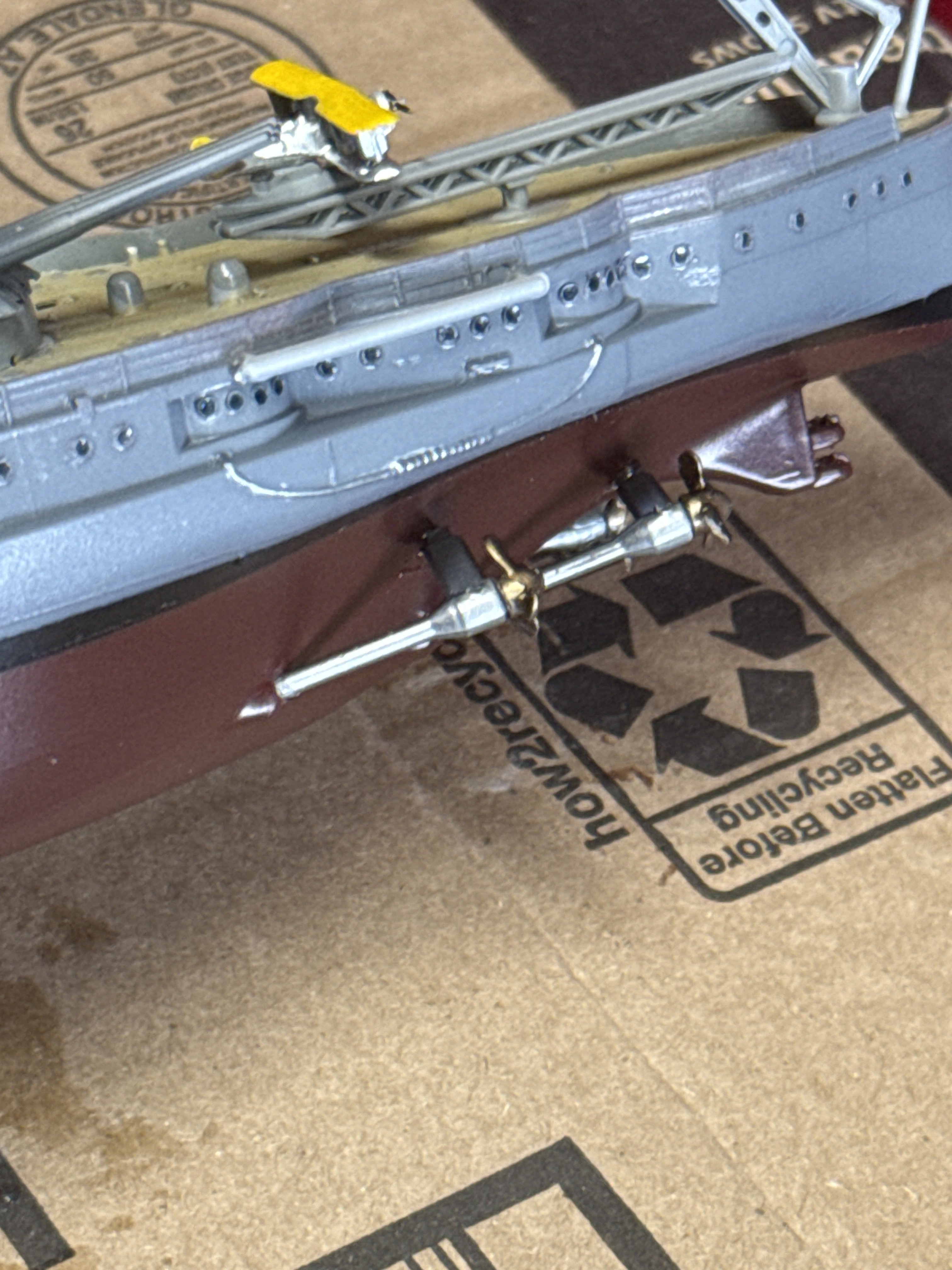

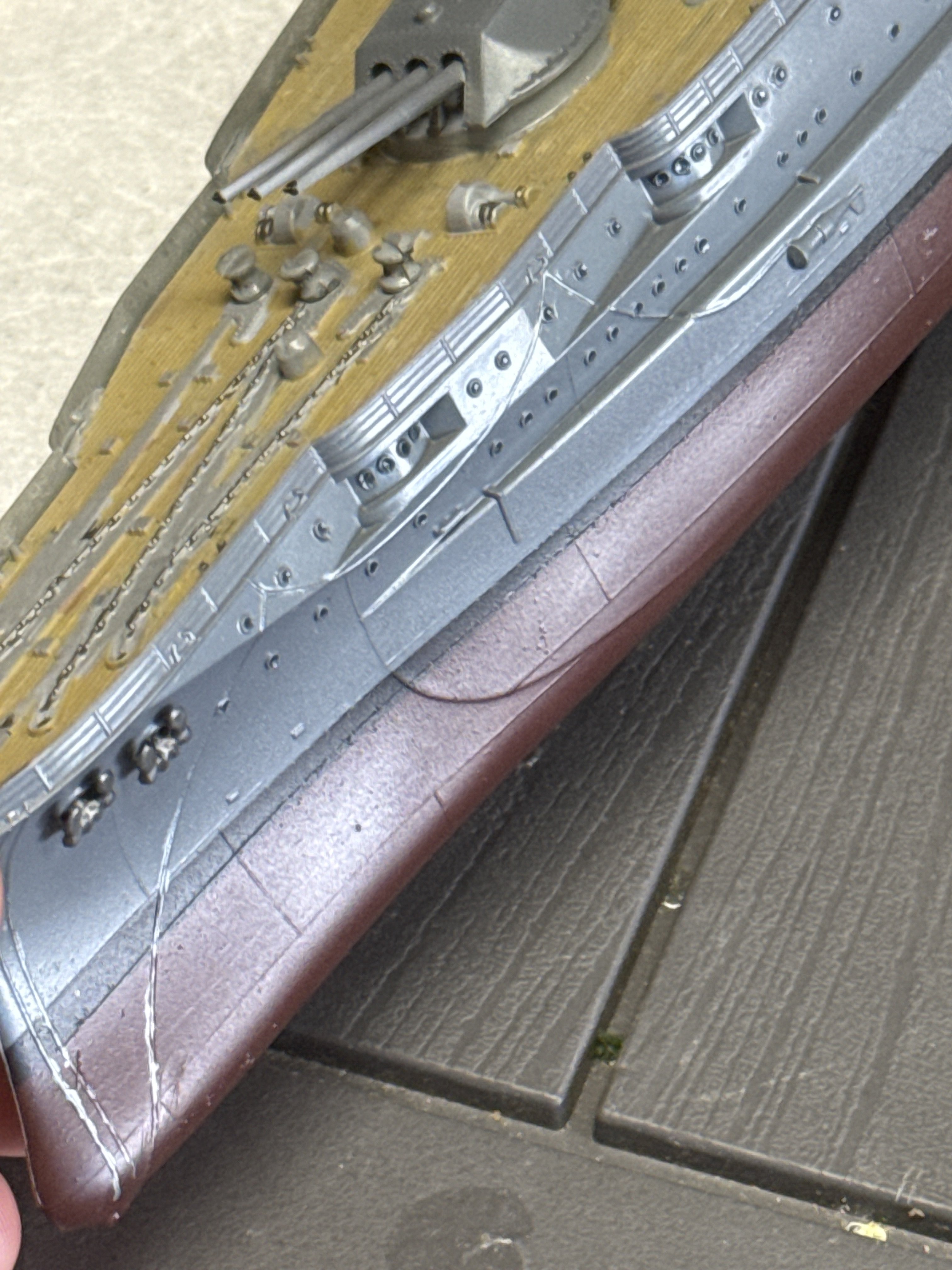

A few more details. Cranes, shafts, propellers and a thingy on the side. Need to paint up top wings on the misrepresented planes. I was going to leave the stairs the same deck steel color but I may paint those same color as hull. Need to highlight the cables on the side and paint up life boat insides. Also need to figure out how these antennas on. I'm starting to dig doing these ships.

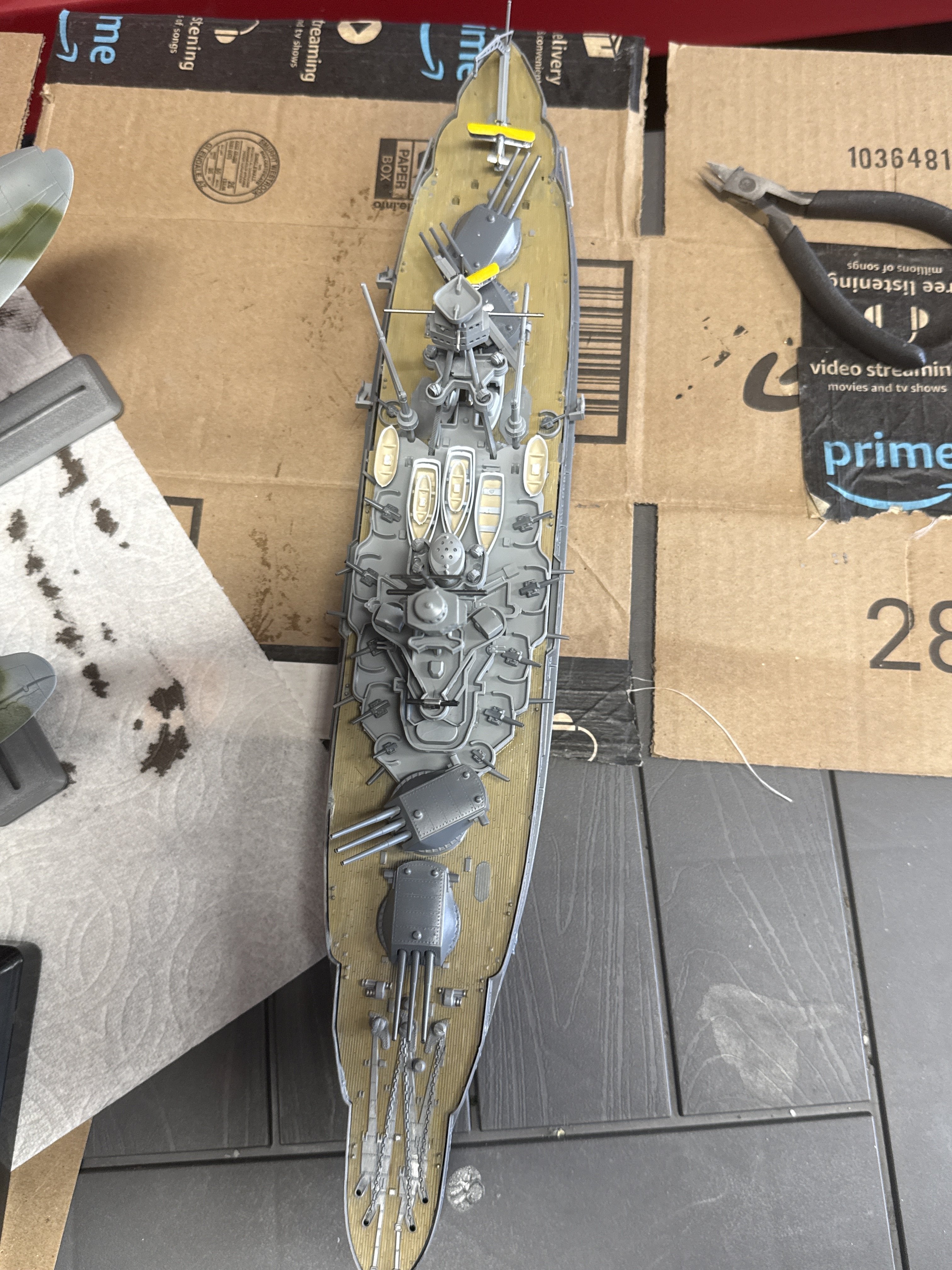

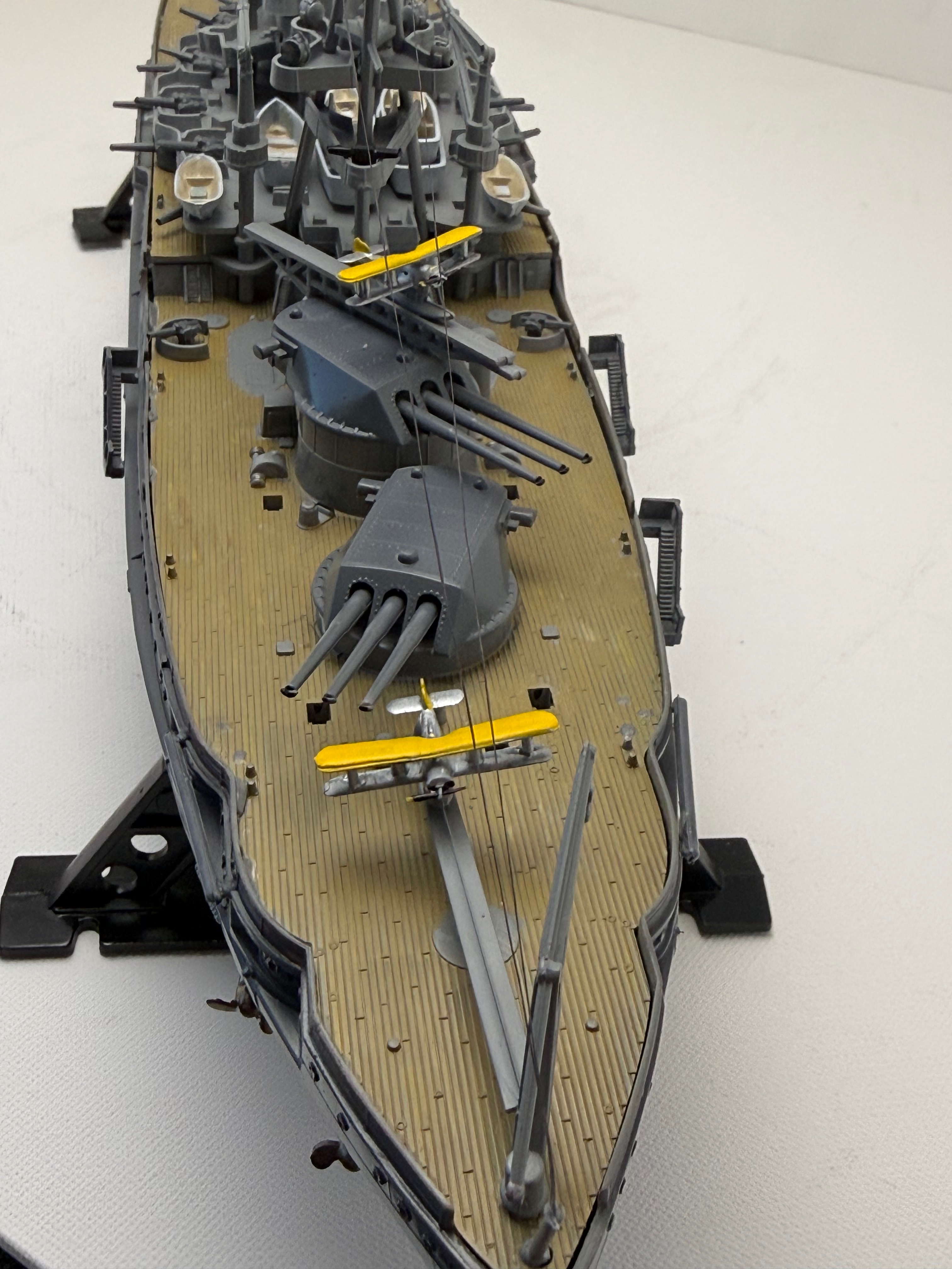

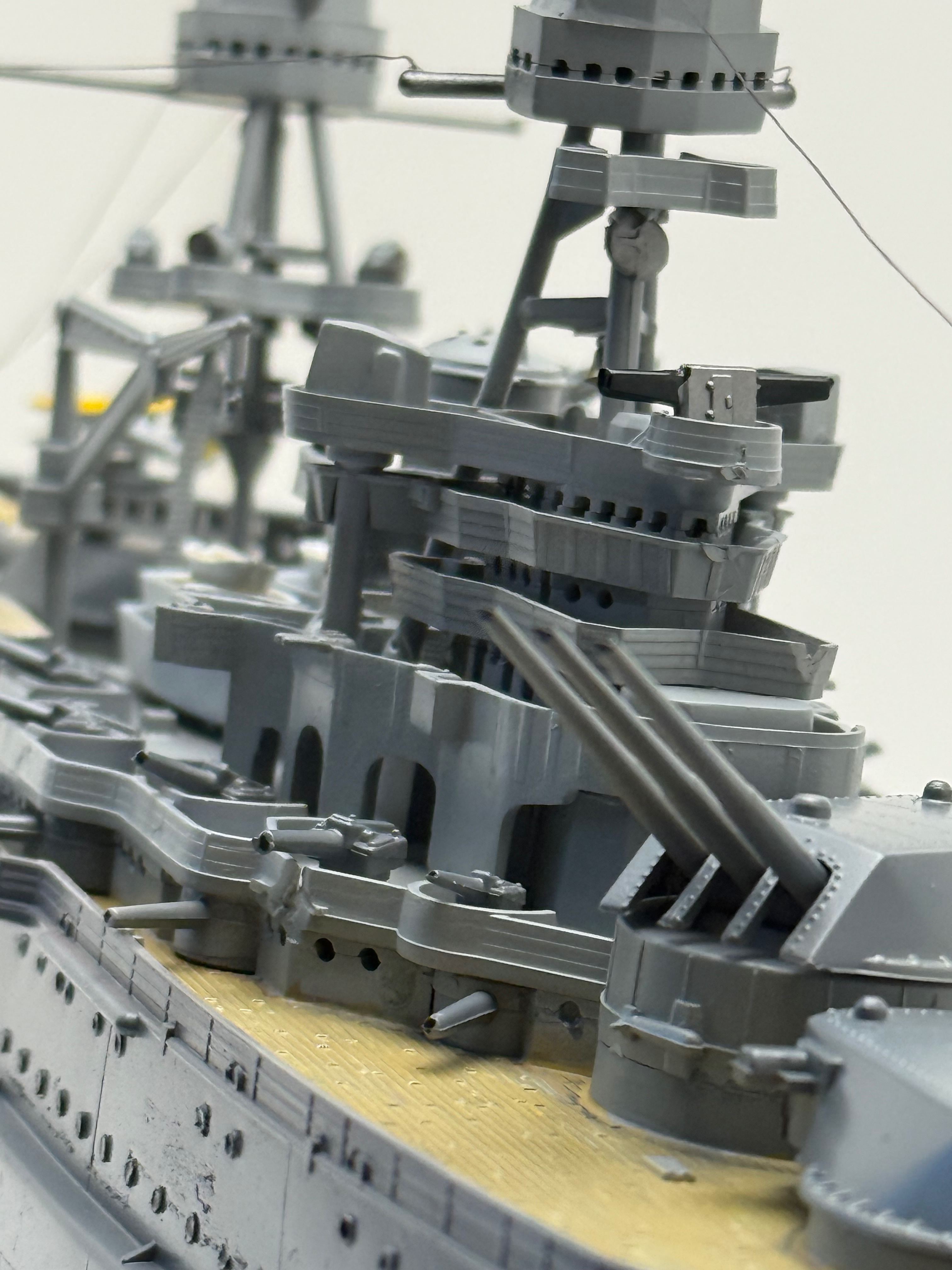

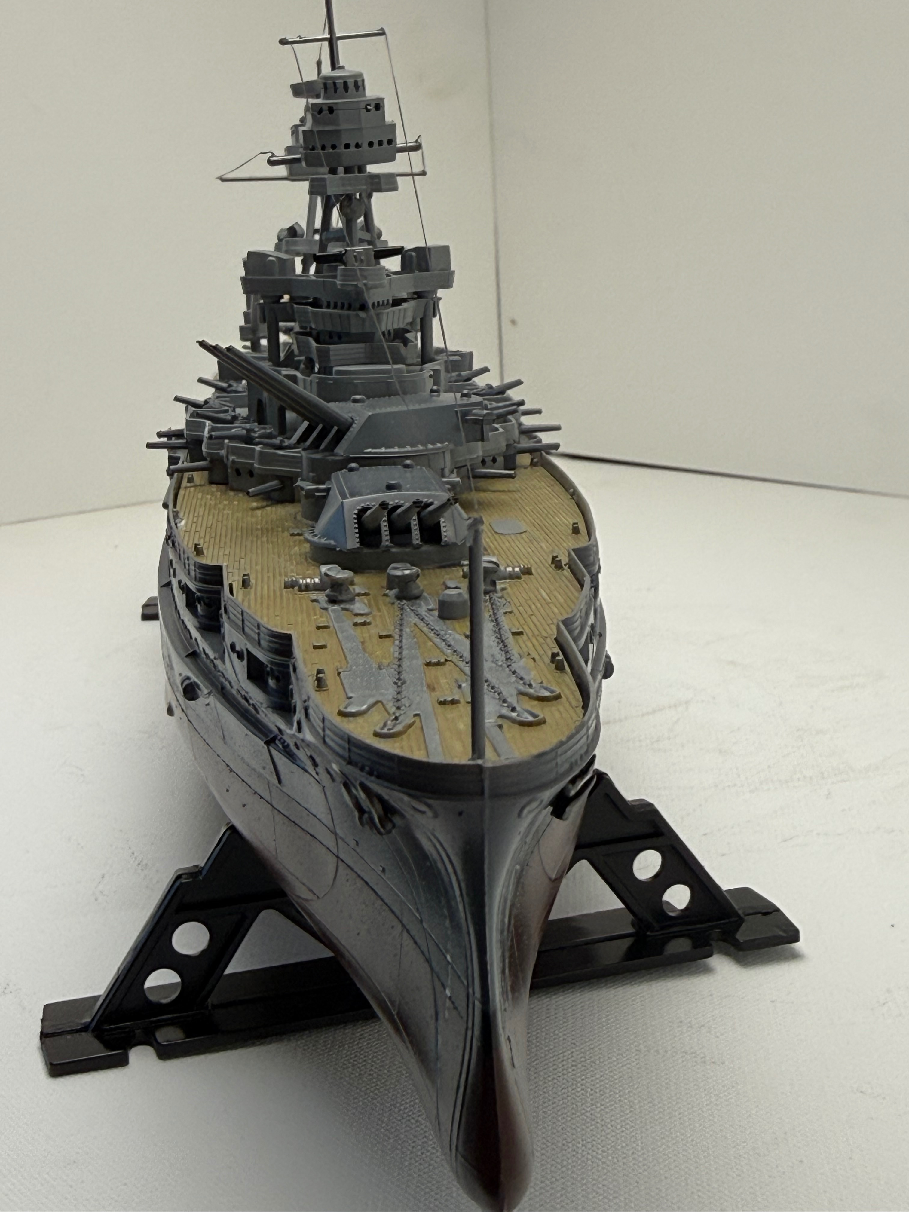

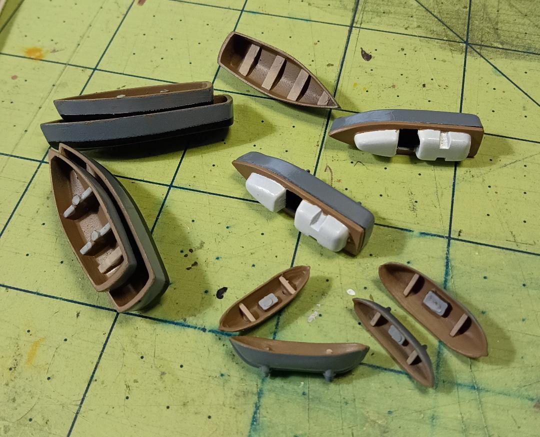

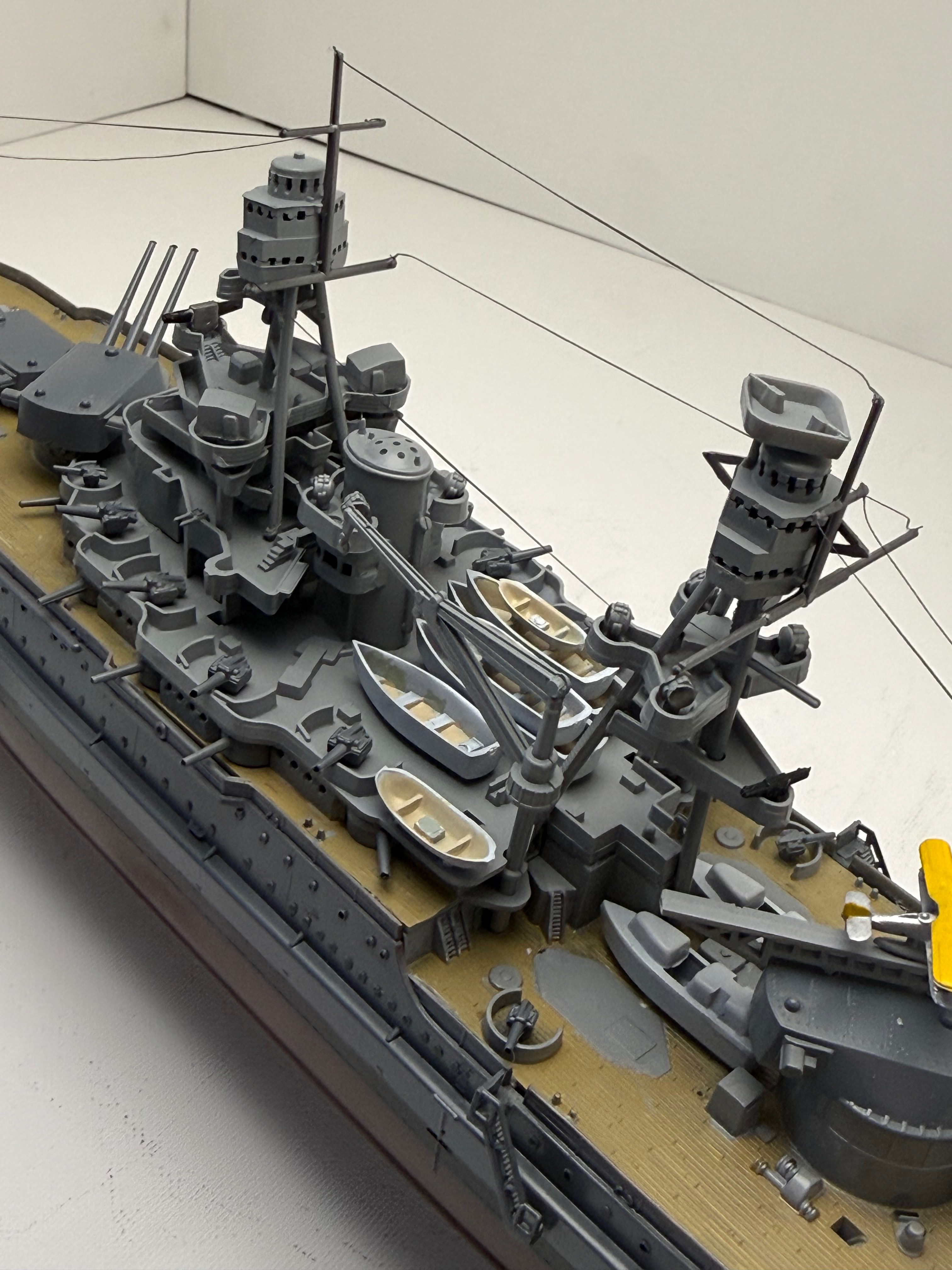

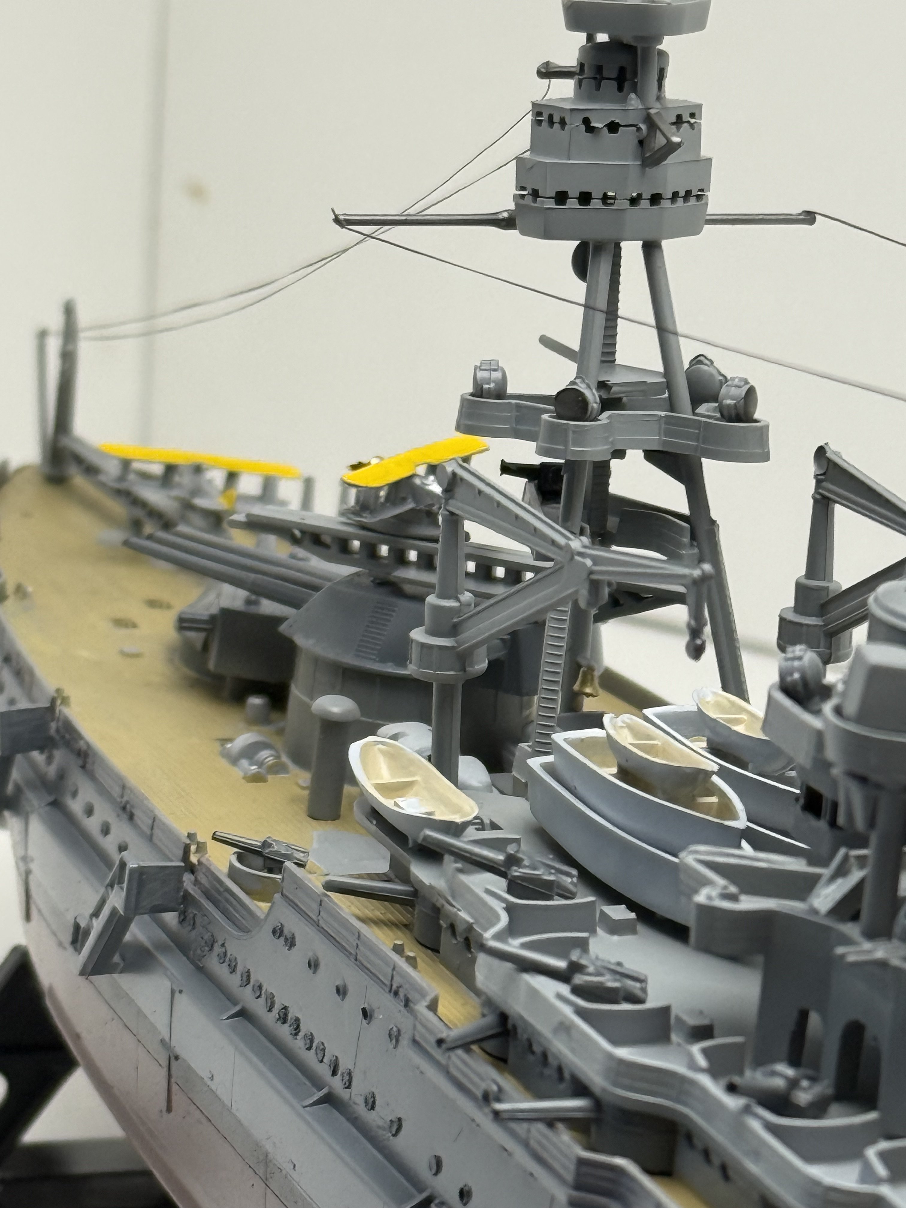

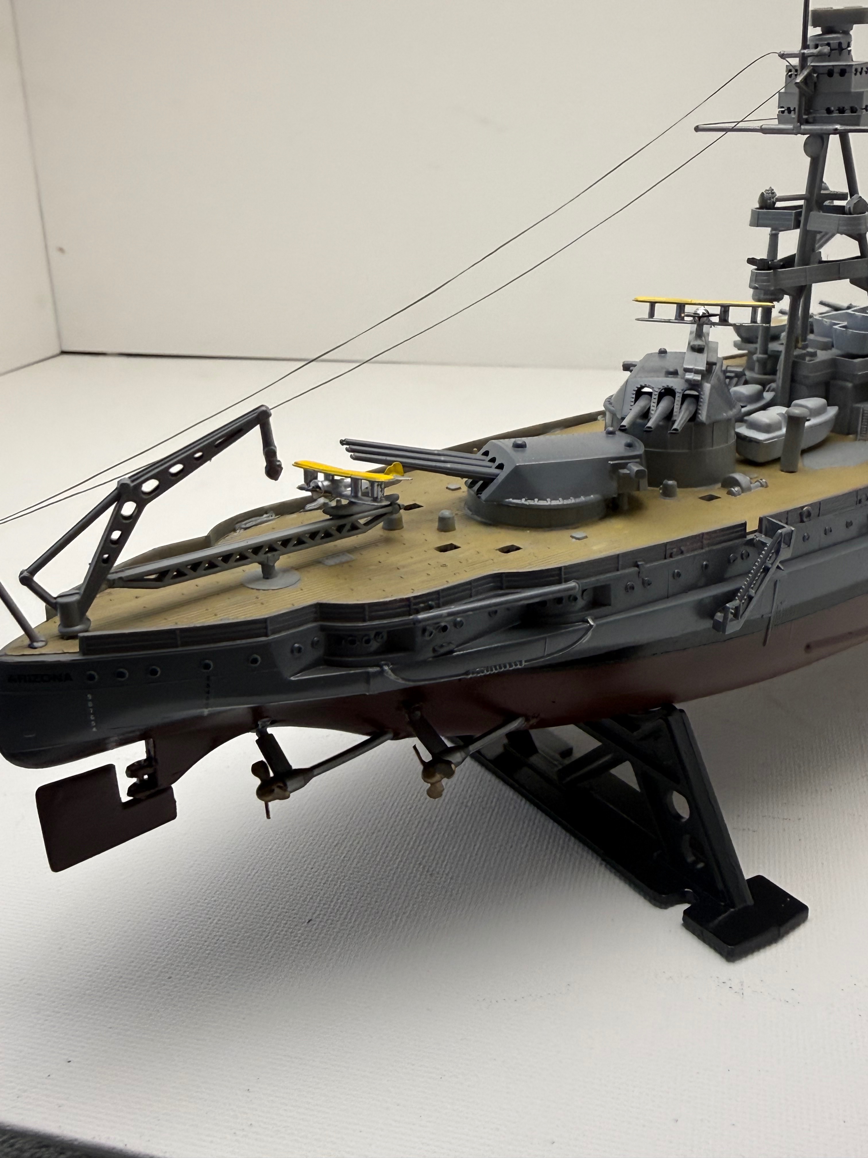

Added life boats, planes and did some small details. I think I'm going to order another boat to do but also looked in my stash and I have a trumpeter Uss Forrest Sherman in 1/350 which apparently is a great kit so I'll probably do that next. Anywhoo, tonight will touch up the exterior stairs and the bar thingy on the side. Then decals and rigging. Not really going to weather this.

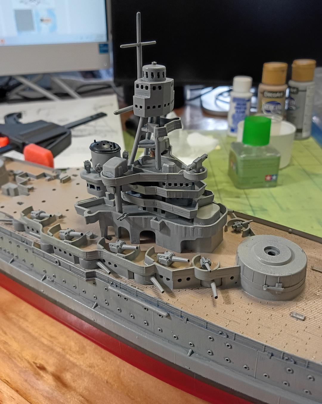

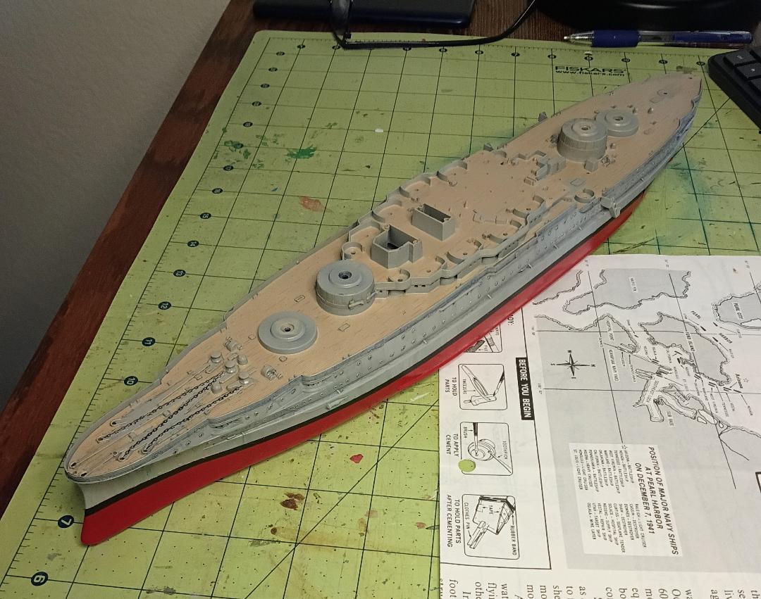

Well, Ron has inspired me to bust out my 1/426 Arizona which I started in 2023 and then shelved. I'll be starting with this:

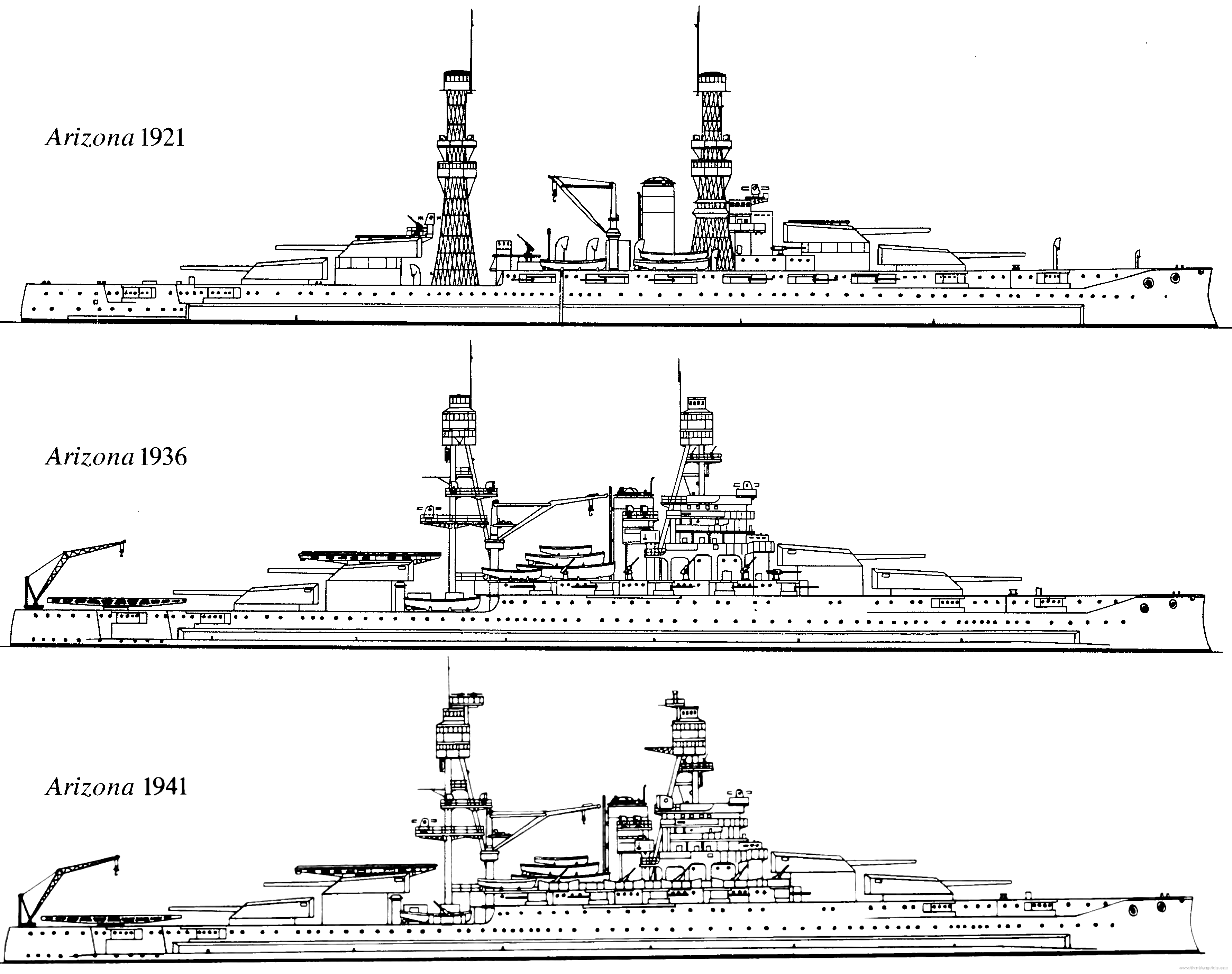

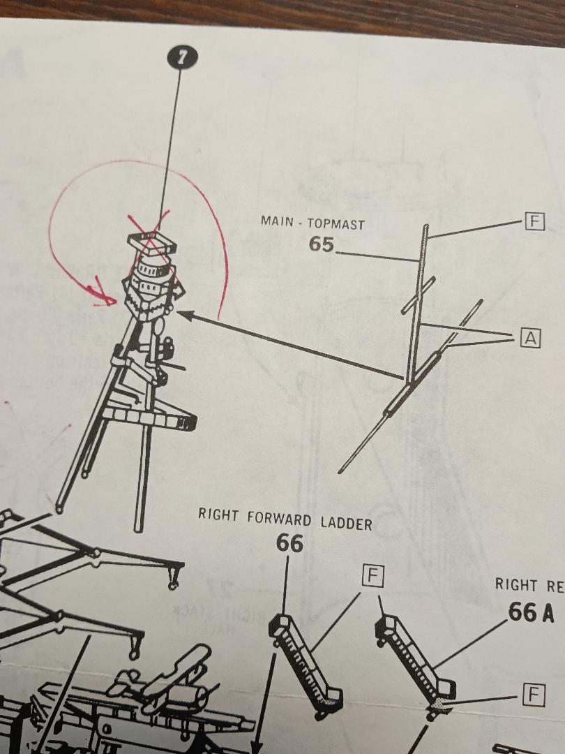

The deck is not attached to the hull yet, as I need to do a base and find a couple stands for it. The kit comes as a mix of modifications which are incorrect for the Pearl Harbor attack (the biplane scouts and fore topmast) but correct for the Pearl Harbor timeframe (the machine gun nest on the aft tower).
I'll be building mine closer to 1936:
which means I use the biplanes, no machine gun nest, and the fore and main topmast with the main topmast mounted on the fore side of the tower:
I might also leave off the two gun directors, but I have to do more research on that.

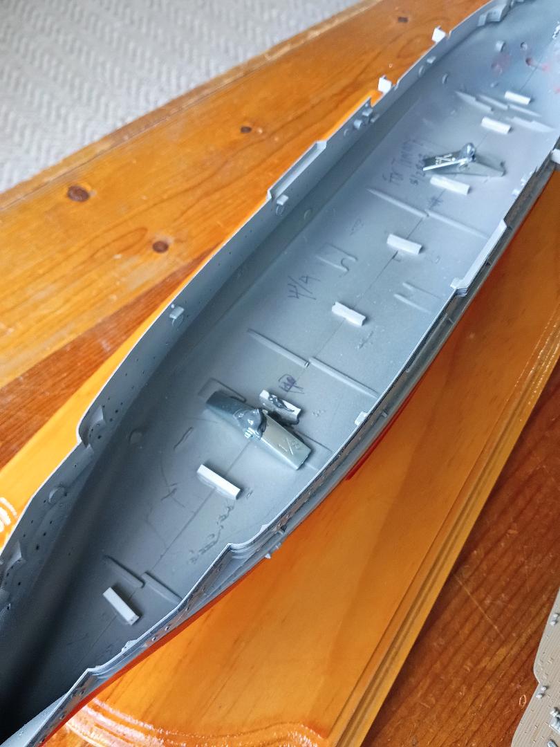

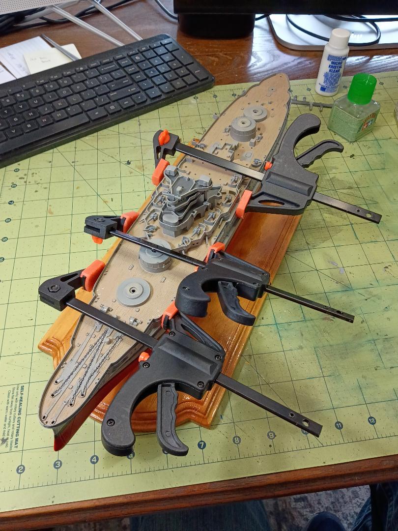

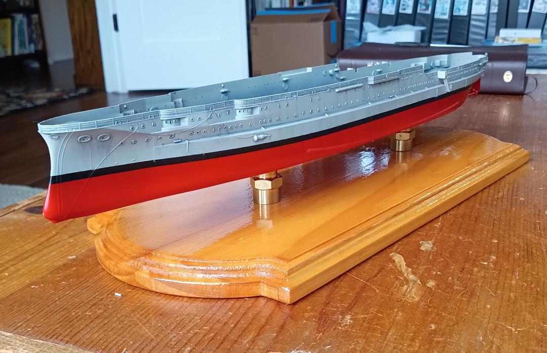

Got her mounted to the base. Cheap base from Hobby Lobby, stained and then coated with clear polyurethane. I use couplings from the local hardware store for mounts, and toggle bolts hold it all together locked in with some JB Quik.
I'll have to do that for my next build. Well, my next, next build since I threw the hull together today for a Revell Uss MO. Looks good! Way better than the plastic mount I used!

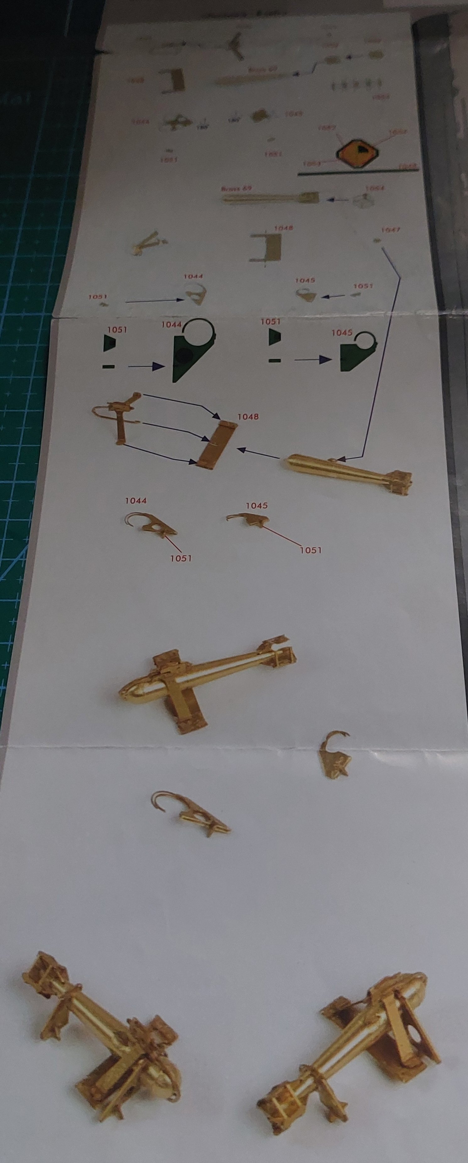

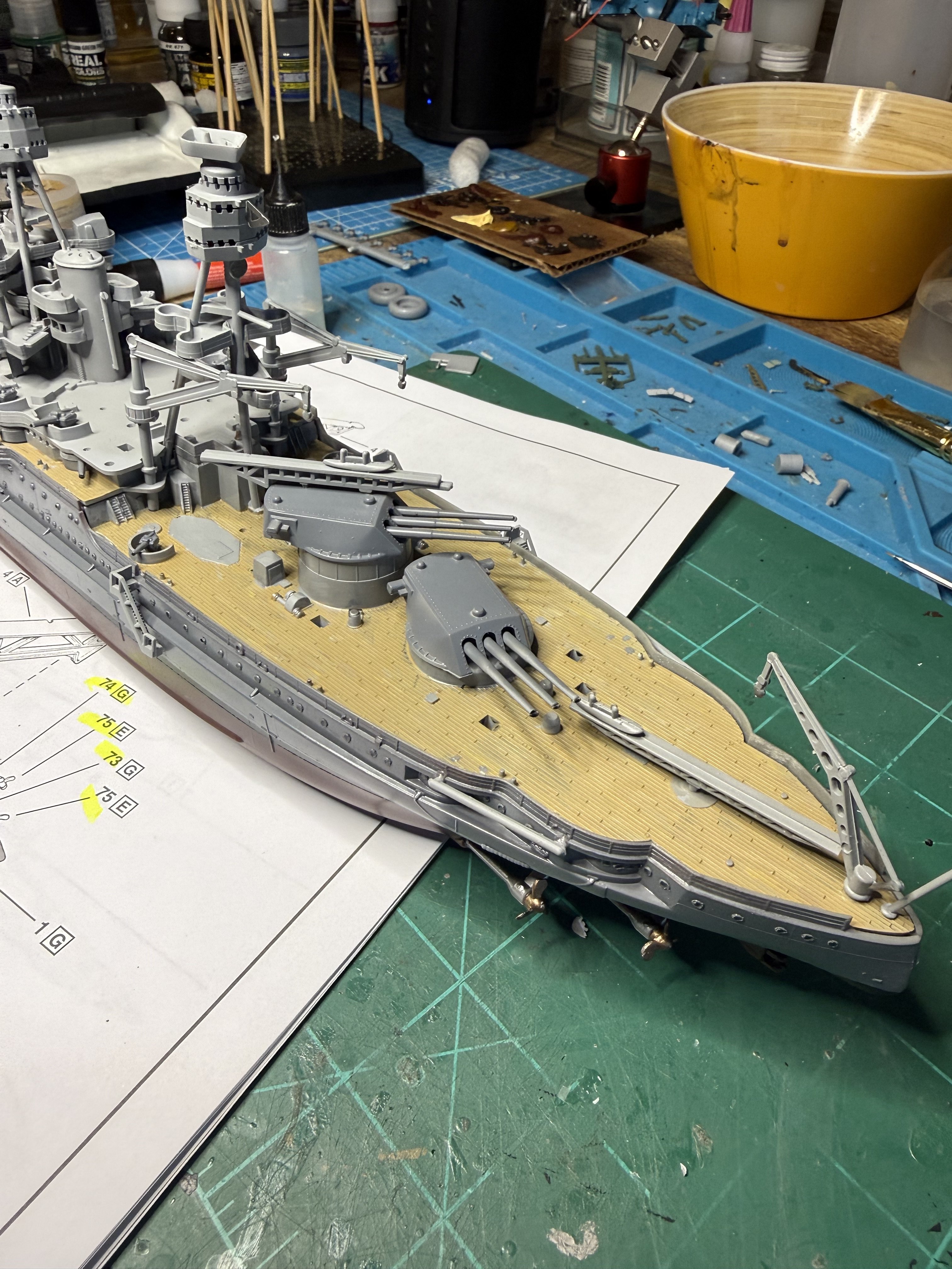

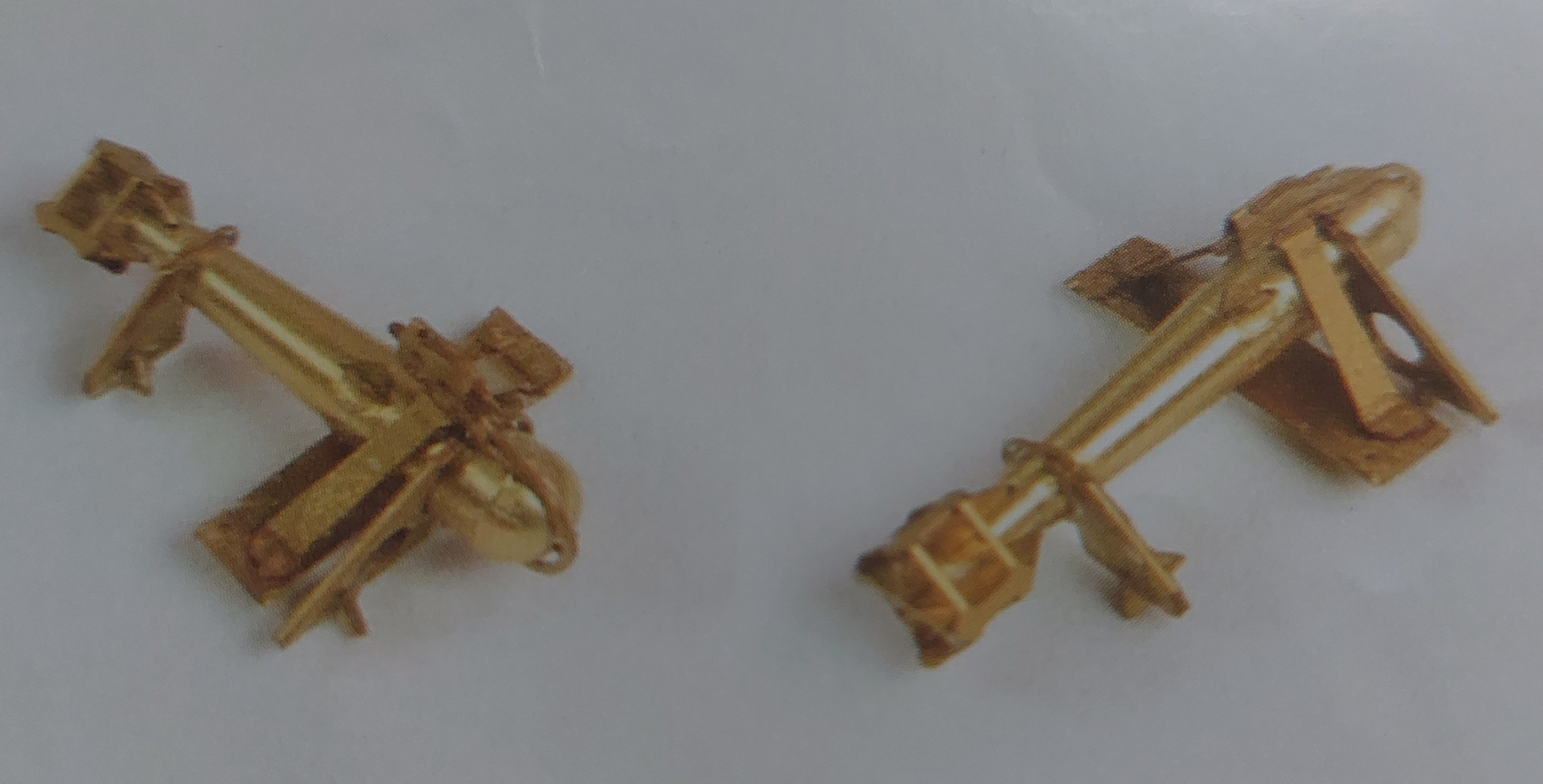

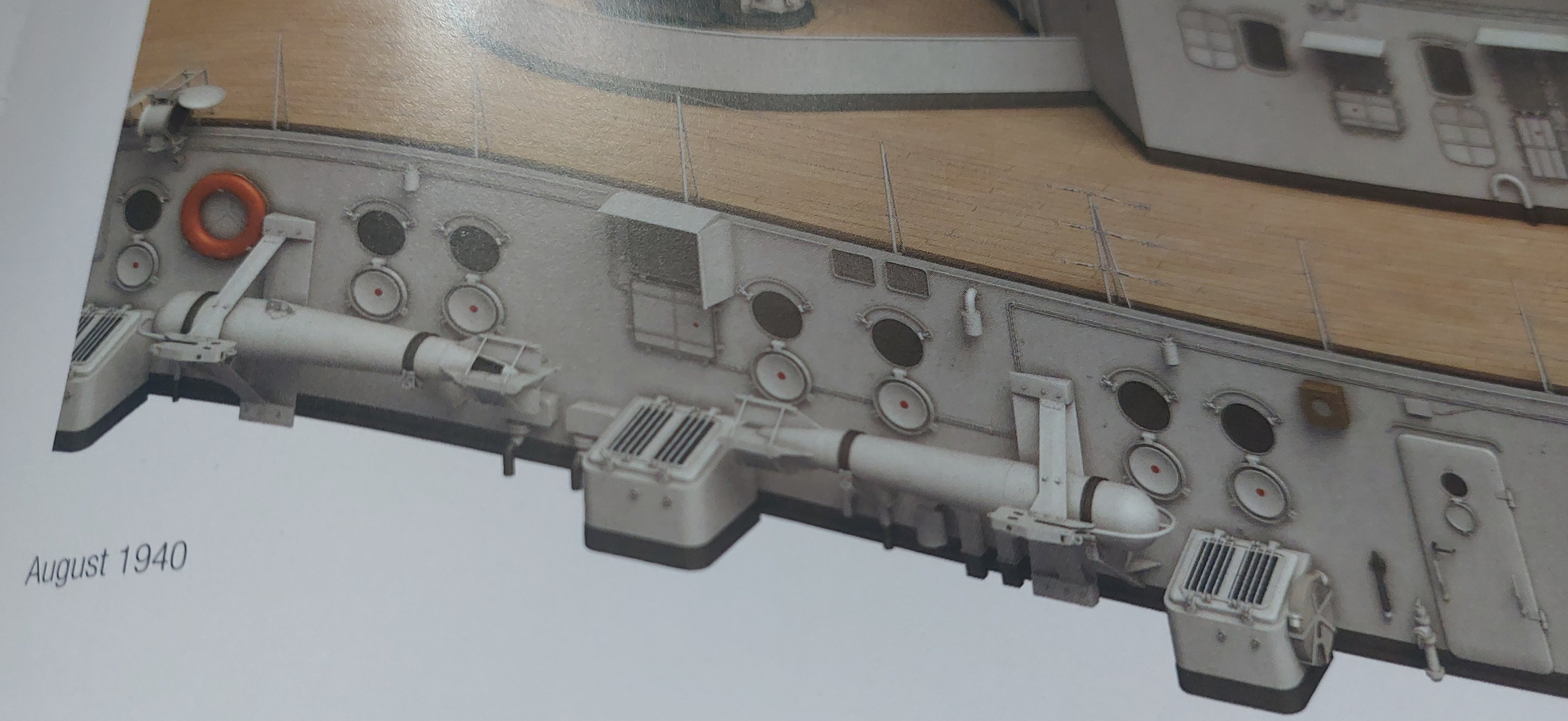

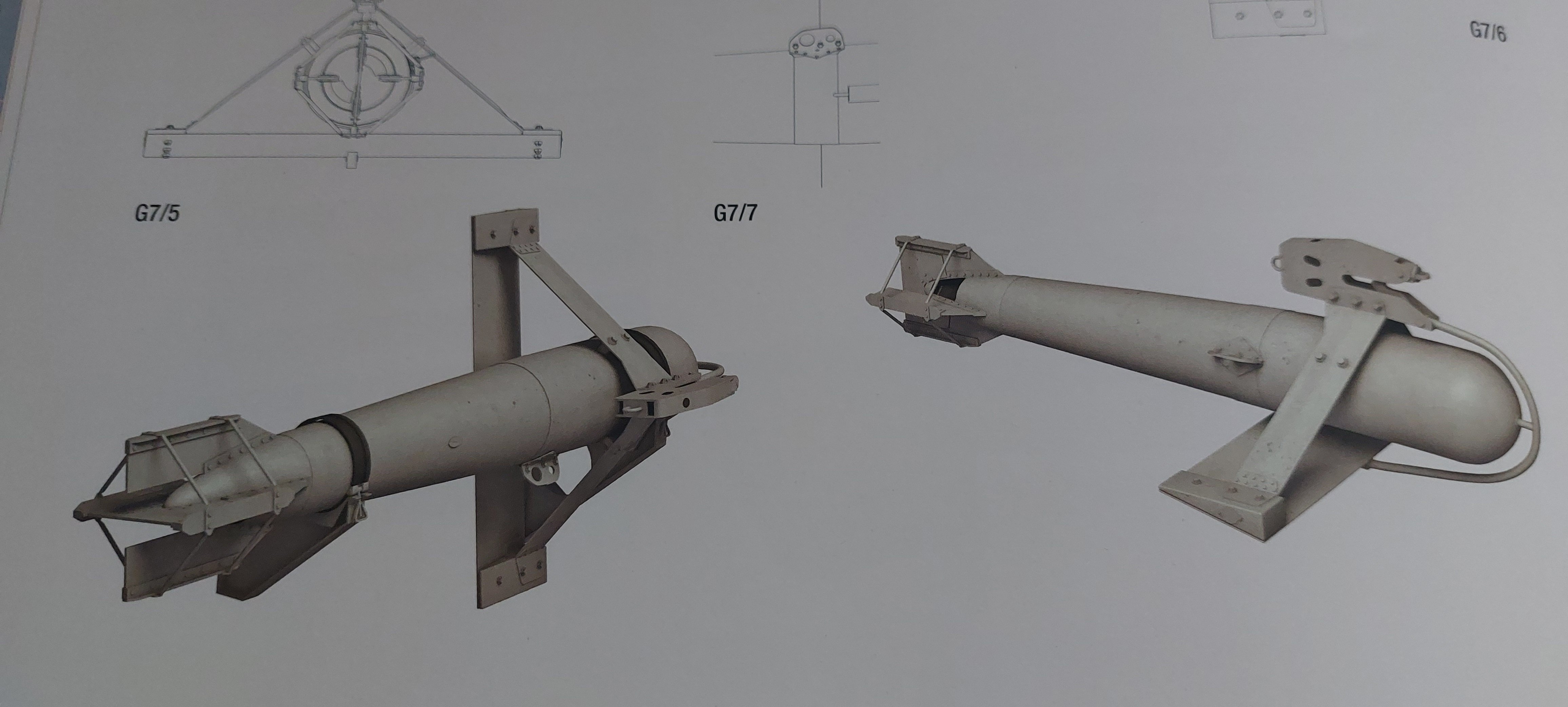

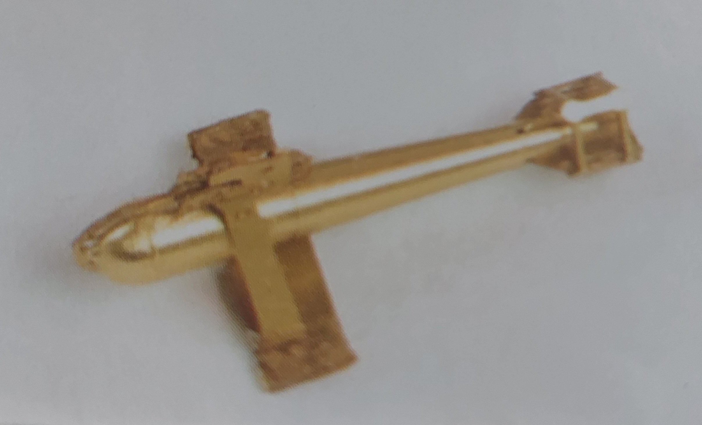

I found out on my USS IOWA build they had them on board, along with a chain that ran from the top of the bow to below the waterline for paravane deployment. My reference book only showed them on board during WWII, I don't know if IOWA used them or not.
I don't even know what a paravane is!
There's two on the port side as well.
You need to watch "The Caine Mutiny" 😁
A paravane is a float that is attached to a wire and is used for minesweeping. The ship deploys one or two, one on each side, the paravane floats on the surface, and the wire is supposed to cut the anchor cable of any mine it encounters. The mine floats to the surface, where it can be collected or otherwise destroyed. But we have specialized ships for that job, and I was surprised to see a paravane on a battleship.
I'm sure the Navy drilled on using them, but I wonder if any of our battleships ever deployed them for actual minesweeping operations.
I'm reminded now of the torpedo tubes that were installed on the "super-Dreadnaught" classes, like the Pennsylvania, the Nevadas, the New Yorks, and others, but which were removed only a few years after each ship was launched. Tactics were changing rapidly, battleships weren't going to use torpedoes, and they took up space and displacement.
