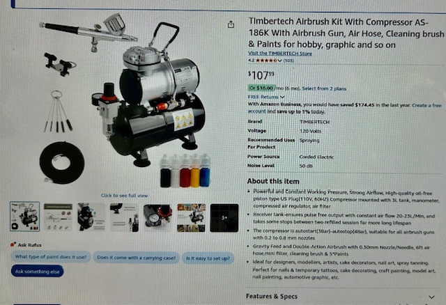

Airbrushing changed my appreciation for modeling again. I suggest Acrylics due to ease of cleaning and toxicity, ventilation, etc. I also picked up a very quiet air compressor that was inexpensive, a TimberTech AS186. Please consider airbrushing to enhance your retirement!

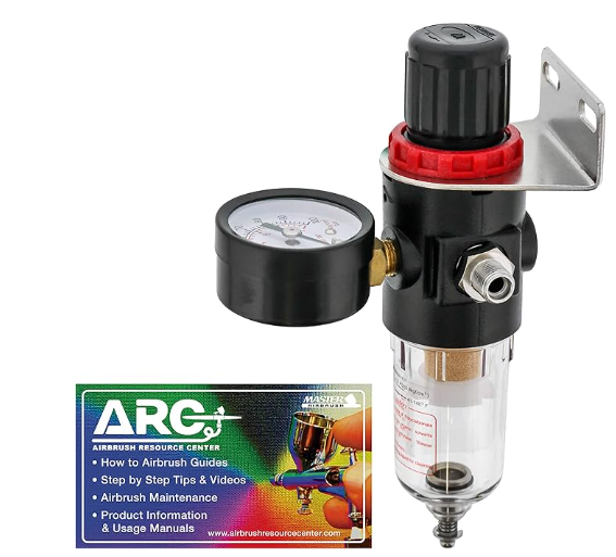

You also want a decent air pump. The canned air route will get expensive quick if you are going to ever be doing more than one or 2 projects, or larger scale stuff
Ideally you will want a compressor that has a psi regulator. If not, you should at least invest in one that you can attach like this
