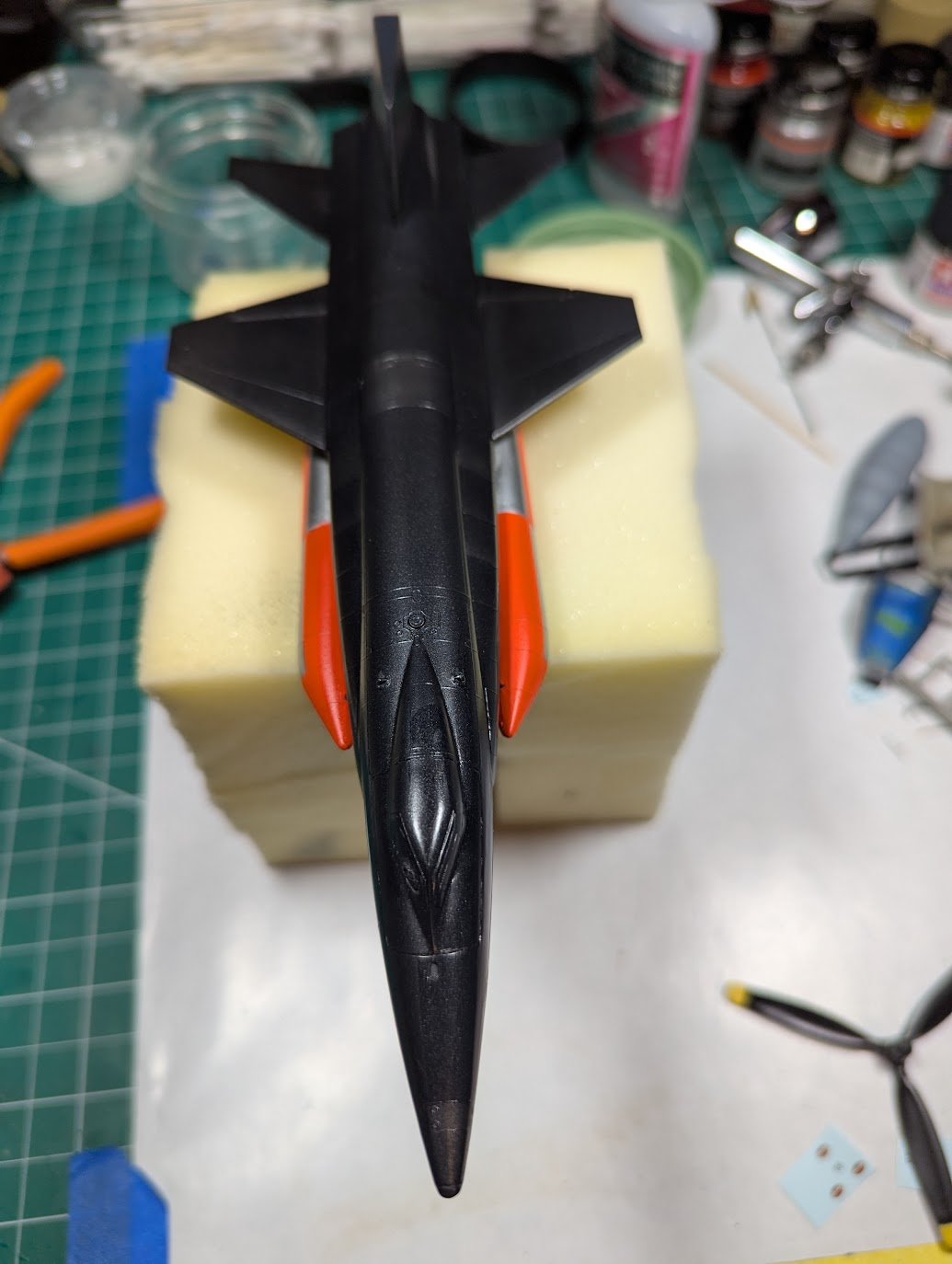

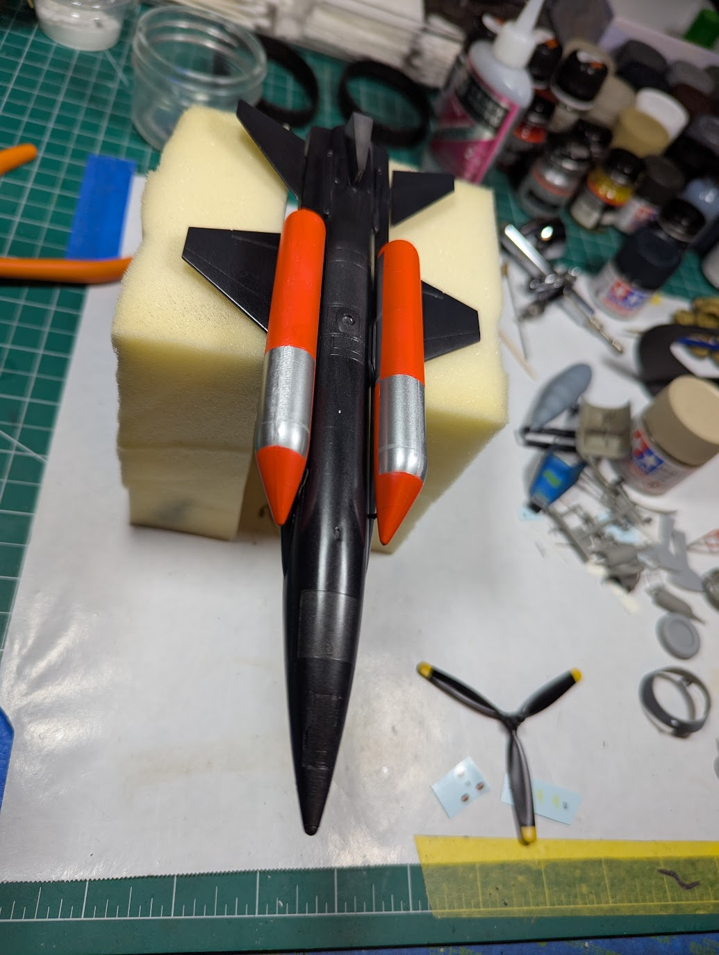

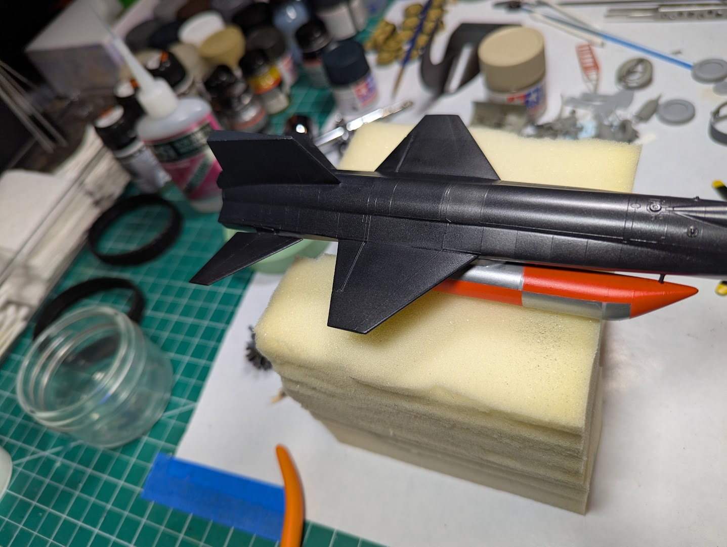

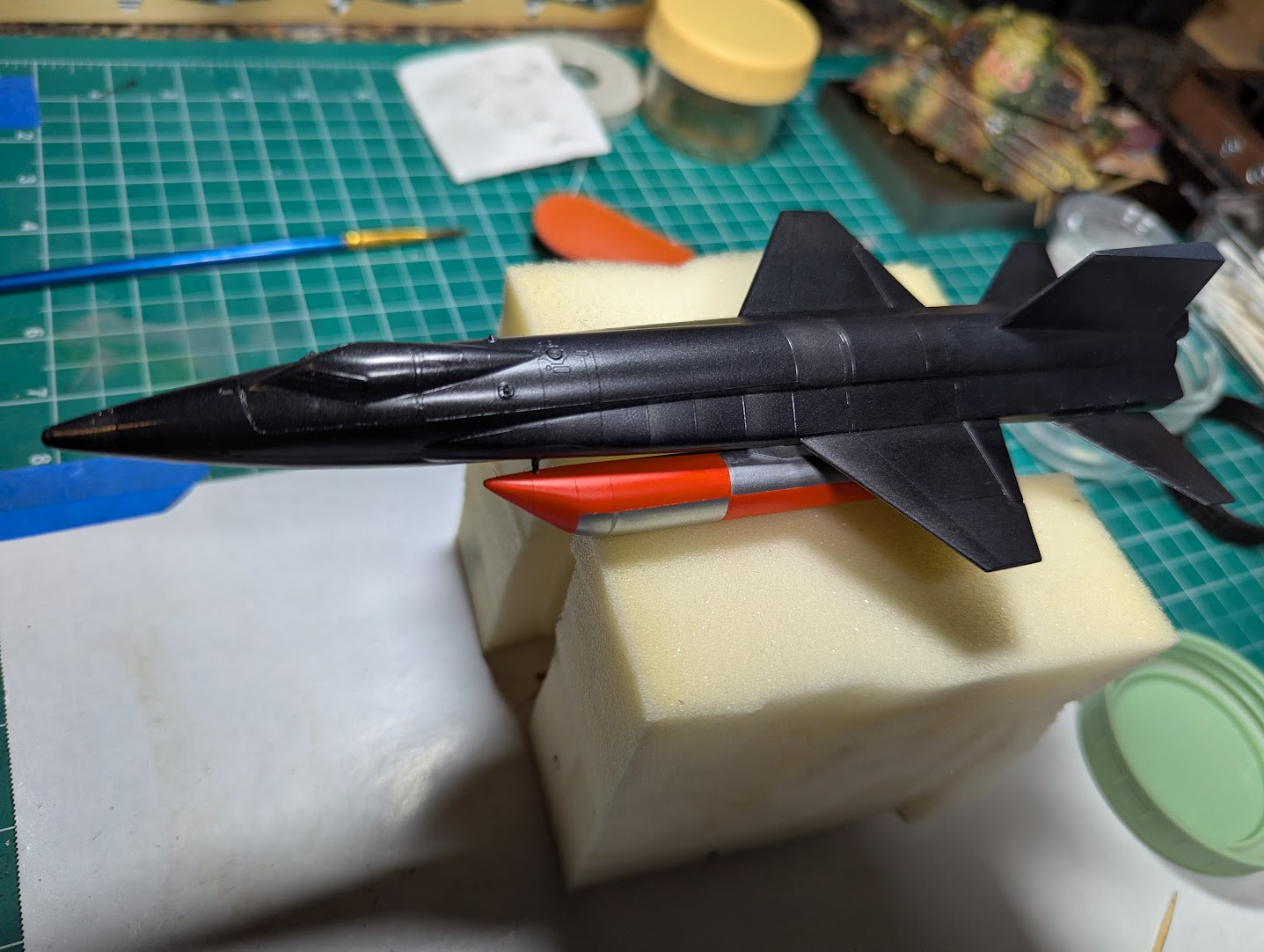

So I am making an X-15. Have had it painted with Surfacer-1500 (black) but have been afraid to put any color on it yet.
Been watching footage where I can, and lots of still shots. The surface is a strange metallic mixture of black/blue/metal/gray/silver and a bit of everything.
My thought is the base coat should be a super-dark blue, one very durable that I'll need to cover mostly, as well as polish like with a T-shirt. Thinking that indicates a lacquer, am I on the right track?
If so, the options are myriad, so I'm looking for recommendations or ideas.

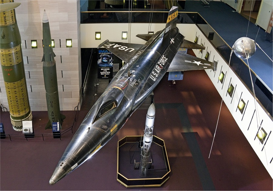

(a shot from the world's greatest museum to show what I mean)

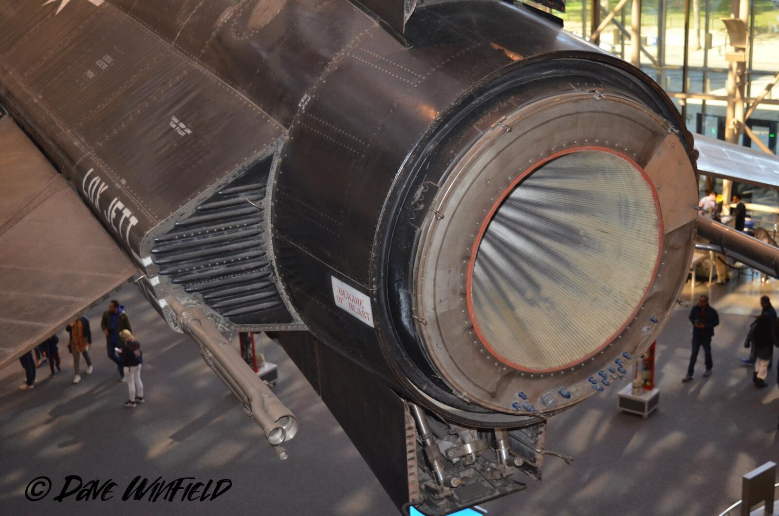

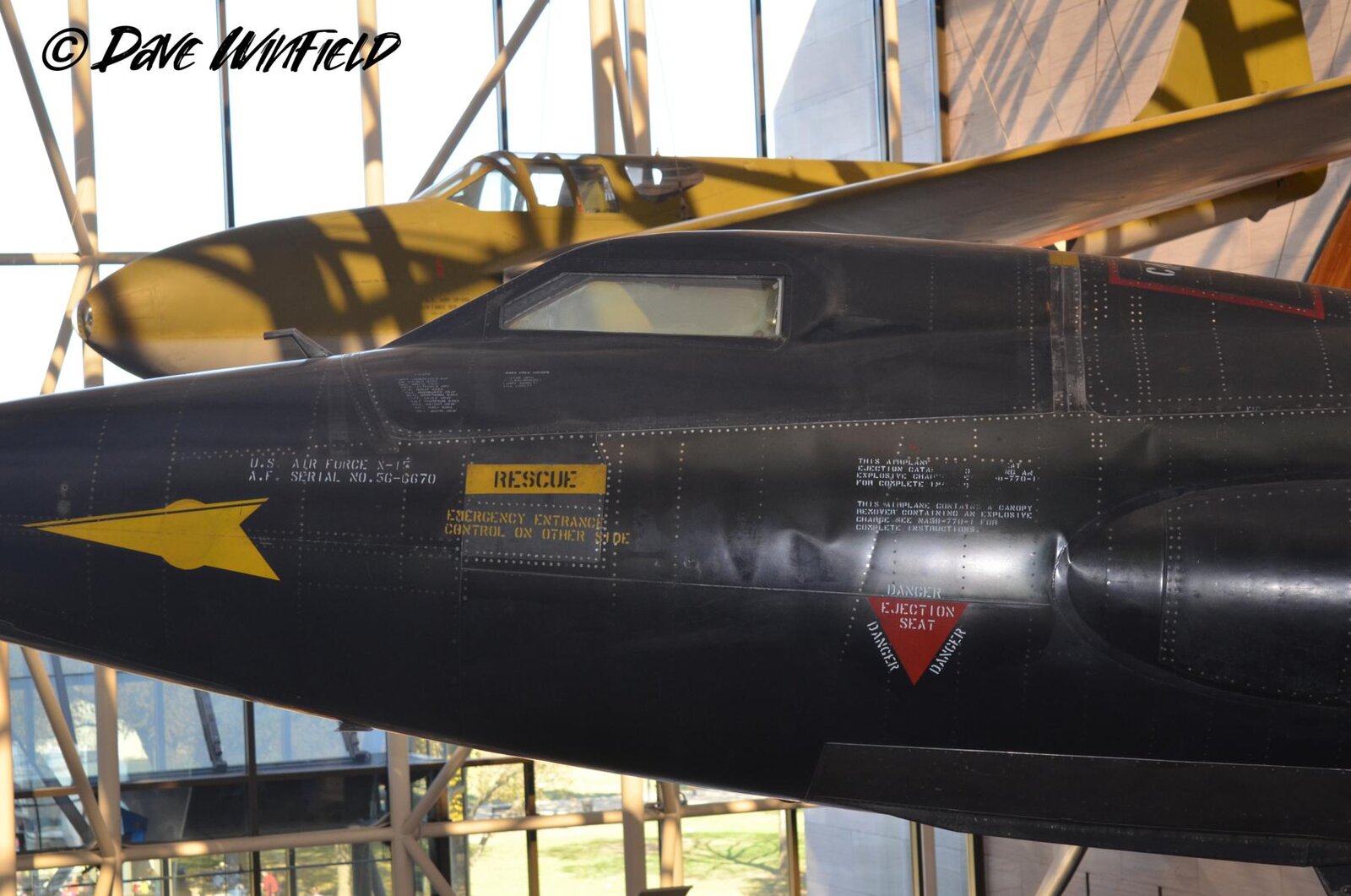

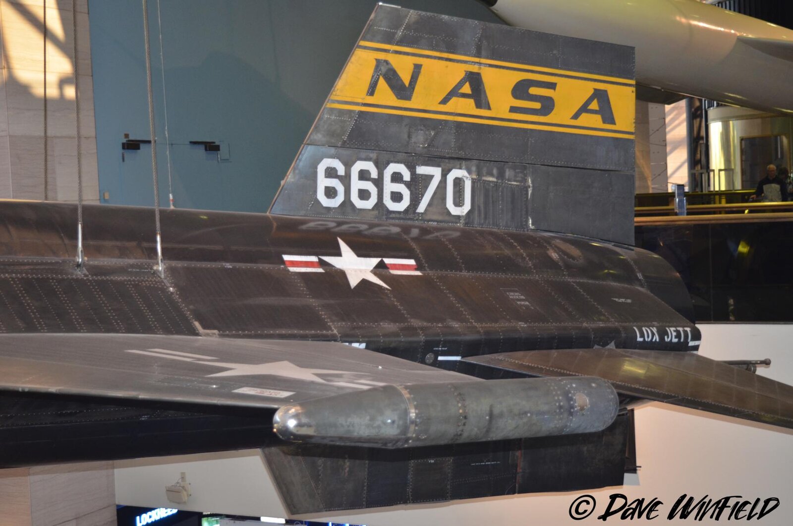

I got up close to the X-15 in Washington Air & Space Museum and took these photos.
The X-15 is most definitely black...straight black...but with a lot of weathered gray effect.
And that weathered effect is probably mostly the burned off and stripped ablated coating.
Sure, there is probably a lot of repainting and touch-up, but the Museums tend to use the exact same colours and paint
(since they have access to original codes and supplies that still exist)

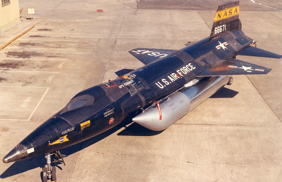

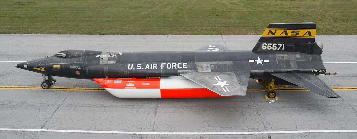

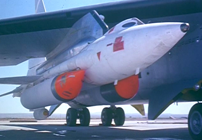

After a few flights and definitely after many, the black was nearly gone in some areas, burnt off to resemble more of a stain than anything. You last picture show what I mean. But here's an operational picture that shows the surface color in worn condition. Perhaps the bright sunshine is exaggerating it some versus the indoor lighting.
Another shot of 66671 this time in overcast, and I do not see much brown/rust/magnesium color here as on others, but the wear is greater than the 1st pic of the same aircraft. I am totally gonna put the high-vis orange on my tanks.

The thing is: in real life, items that are "painted black" still reflect some light. As in the photo you posted, the hull is mostly a very dark grey with the darkest shades in the shadows and on the edges of reflections. I would do a very dark blue-grey that would be close to black, but not there. I might also suggest perhaps a slight "sheen" of ground-up graphite pencil on the worn areas to simulate where the paint had abraded/ worn away. And even lighter shade of the base or perhaps just graphite pencil could serve to highlight the panel lines (they seem lighter in this pic).
Before you commit though: test it out on something painted straight black and then see if it works for you.
I think the problem is that there are no shadows, as well as highlight in the wrong places for sunlight.What you have here is a semigloss to glossy to almost flat "hole in the air." Most of the pictures I've see of the X-15, there was some difference, if only due to the angle of light. Later, there was wear on the surface due to heating and abrasion. (At Mach speeds, air is abrasive.)
