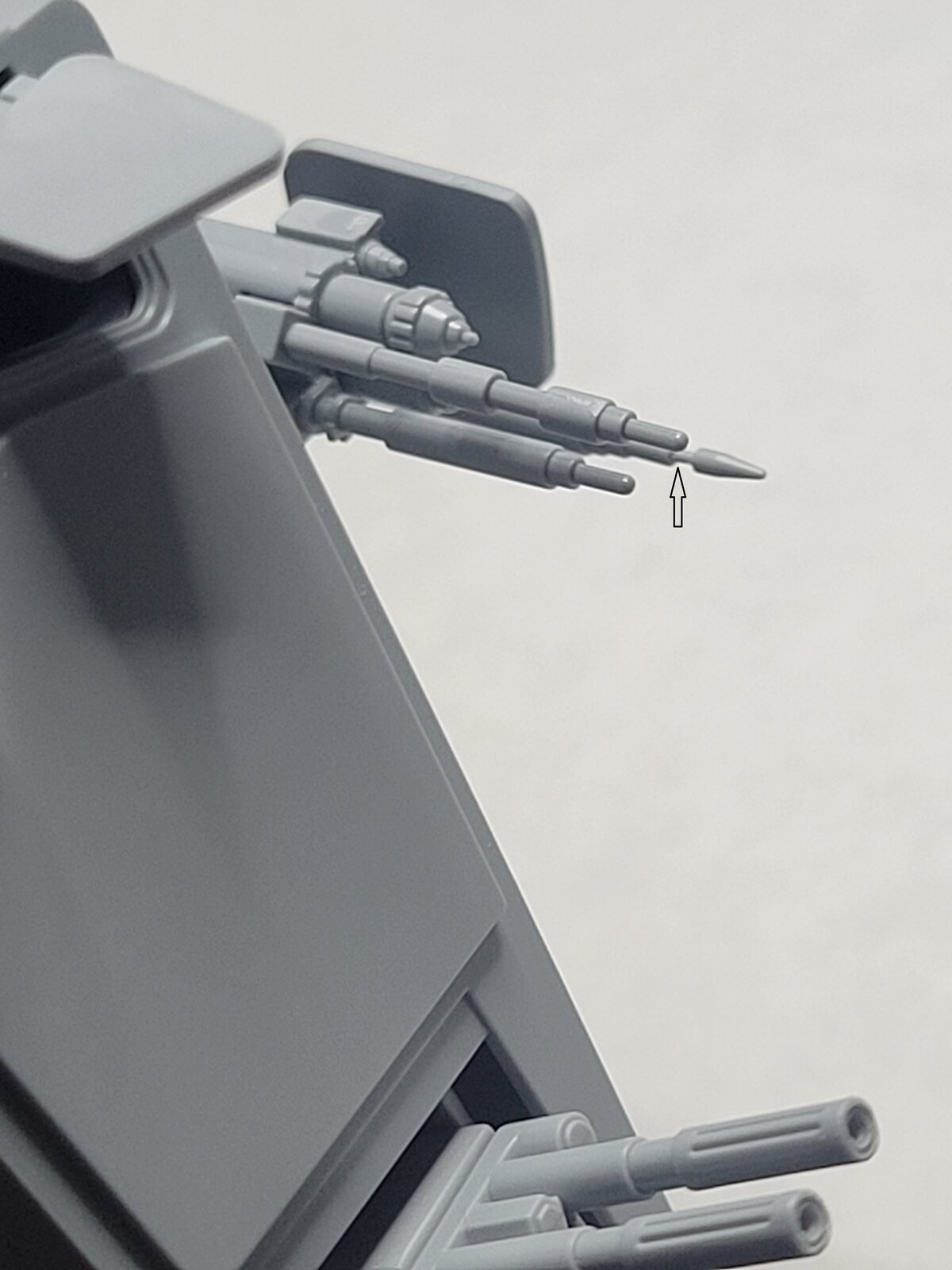

Hello, this is my first post. I'm new to this hobby and have completed building a Star Wars 1/44 scale AT-ST. One of the guns on the side is rather delicate and has partially broken. Is there a proven, reliable way to reinforce it so that it won't break off at the slightest bump? Please see the attached photo; the arrow is pointing at the spot where it's partially detached. Any chance the eventual varnish coat will reinforce it? I've brushed some extra thin cement onto it but it is still moving at the slightest touch.

HI THERE well thats what i do if possible like eagle1 says if its not to thin to drill into to fit a tiny steel pin then thats your best course of action as i may have this problem when im fittin my 4 bilgle keels on my hornet good luck
to you
chrisb
I would drill it and insert a metal pin.
You beat me to it :) The part pointed to by the arrow is just asking to break, really — a glued joint is not going to be as strong as before it (partially) broke, so the only real way to make it durable is to cut it off, drill out both ends and replace the thin plastic by metal. You could even get different sizes of tubing that neatly fit inside each other and rebuild the whole thing — I'm betting that's exactly how the original was made, too.

One thing you can try is applying a very thin coating of cyano super glue over the junction and surrounding area.
I've used very "runny" cyano super glue to apply a thin coat to "encase" the joint to reinforce it.
This is fairly easy to do using a small drop of glue on the tip of a toothpick or wire end or with a super glue applicator.
Touch the tip of the drop to the part and the glue should flow onto the part through capillary action.
You may need to do this in a few other areas depending on large the part junction is to get full coverage.
Allow the glue to air dry using no accelerator in order to preserve the smooth surface of the original part.
The goal is to create a very thin "layer" of cured glue to encase the joint to provide a reinforcing "sleeve" around the part joint/junction.
Cured (dried) cyano super glue is rigid and forms a thin reinforcing casing/sleeve around parts and their joints to make them more rugged.
I do this around the roots of propellers at the hub junction during the assembly process to make props more rugged and less prone to breaking off.

I have tried all of the above suggestions, single pin, pin in tube, CA glazing. Each have their use for sure!
In this situation, where the unsuported part could be subject to sideways leverage with a glancing blow, I'd be less confident about the CA, which though strong as a protective coating, I suspect would be susceptible to shear at the base.
Dunno about your experience level with sort of thing, so will assume first time.
If you decide on the drill and pin, brass rod from your HLS is relatively cheap, easy to work with and resilient. Make sure to measure the plastic you are replacing, to get the right size.
...and practice a few drill holes on similar sized sprues if you've never done it before. Sanding the tip surface flat and scoring a small, centered divet might make it easier to drill without skating away. Slowly, with progressively larger bits does it, avoiding splitting and bursting the part you are drilling.

I blew it. Quite literally, as the end of the part broke off and I was in the middle of fixing it:
I was micro-drilling into the part, and as I was cleaning my work area, I blew the part off of my desk, never to be seen again.
I also broke two micro drill bits in the process.
You live and learn! It's provided me an opportunity to try out Bandai's free replacement parts program. I have two other parts that I need to replace in this kit anyway. Another part broke, and I also used resin to craft another part, but if I can get a replacement, I will.
How about not FIXING the skinny part, but replacing it?
Cut off the pointy end, cut off the skinny shaft, drill into the thicker barrel section and the pointy bit, and put everything back together. Use a metal rod instead of plastic.
You might end up with that being the only thing that survives the fall from a shelf.
That, or just make new out of polyrazzmatazz.
When you get the replacement part, replace the thin shaft with hypodermic tubing.
