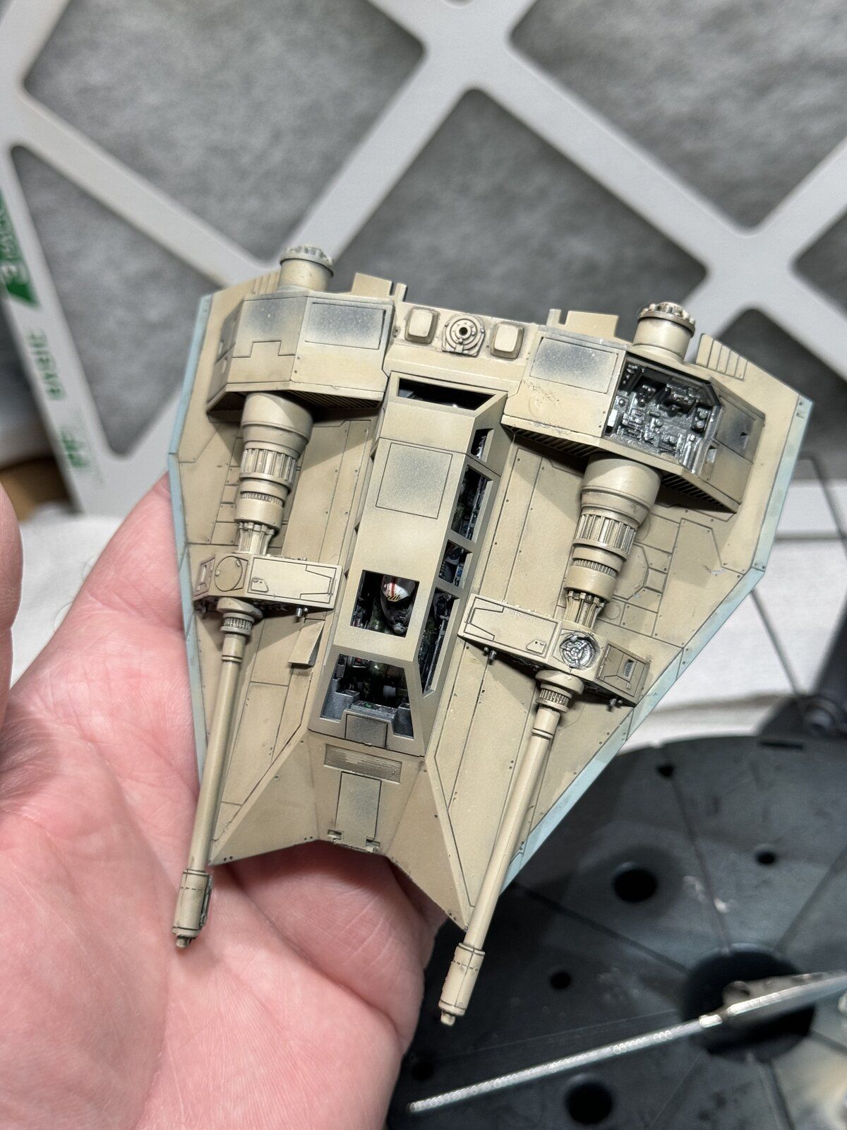

I have been trying to figure out Tamiya panel liner for years. First, I switch to Mona Lisa odorless thinner. If you are in the the USA you can buy a big bottle at Michael’s. Second, I wait about 20 minutes. I remove the excess by dipping a Q-tip in the thinner and then removing excess thinner with a paper towel so the q-tip is just damp. Third, that Tamiya panel liner will eat through Bandai plastic. I had trouble with testors thinner eating through my varnish, which is why I switched to Mona Lisa . And the thing my local hobby store owner taught me was… if you are using acrylic paint, you can put the Tamiya liner right on the paint with no varnish if you let it cure properly. Like 24 hours. Ok. That is more than you asked for so forgive me, but I ruined several models to learn the above. I hope it helps. This is a Bandai kit with no varnish and panel liner applied as described above. IMG_3962.jpeg

I have been trying to figure out Tamiya panel liner for years. First, I switch to Mona Lisa odorless thinner. If you are in the the USA you can buy a big bottle at Michael’s. Second, I wait about 20 minutes. I remove the excess by dipping a Q-tip in the thinner and then removing excess thinner with a paper towel so the q-tip is just damp. Third, that Tamiya panel liner will eat through Bandai plastic. I had trouble with testors thinner eating through my varnish, which is why I switched to Mona Lisa . And the thing my local hobby store owner taught me was… if you are using acrylic paint, you can put the Tamiya liner right on the paint with no varnish if you let it cure properly. Like 24 hours. Ok. That is more than you asked for so forgive me, but I ruined several models to learn the above. I hope it helps. This is a Bandai kit with no varnish and panel liner applied as described above. View attachment 107541
That looks awesome and no problems. I am going to do the gloss clear coat, let it dry and cure for at least 24 hours, apply the panel liner (to a small portion of the model), let it dry for about 20 minutes, and then do the clean up using Q-Tips and odorless AK Enamel Thinner. It sounds like everything else model making wise, each has their own procedure that works for them. I was just trying to get a feel for what the best of the forum members does. I appreciate all the answers. Thanks All! I will let you all know how it turns out. Thanks again all!
