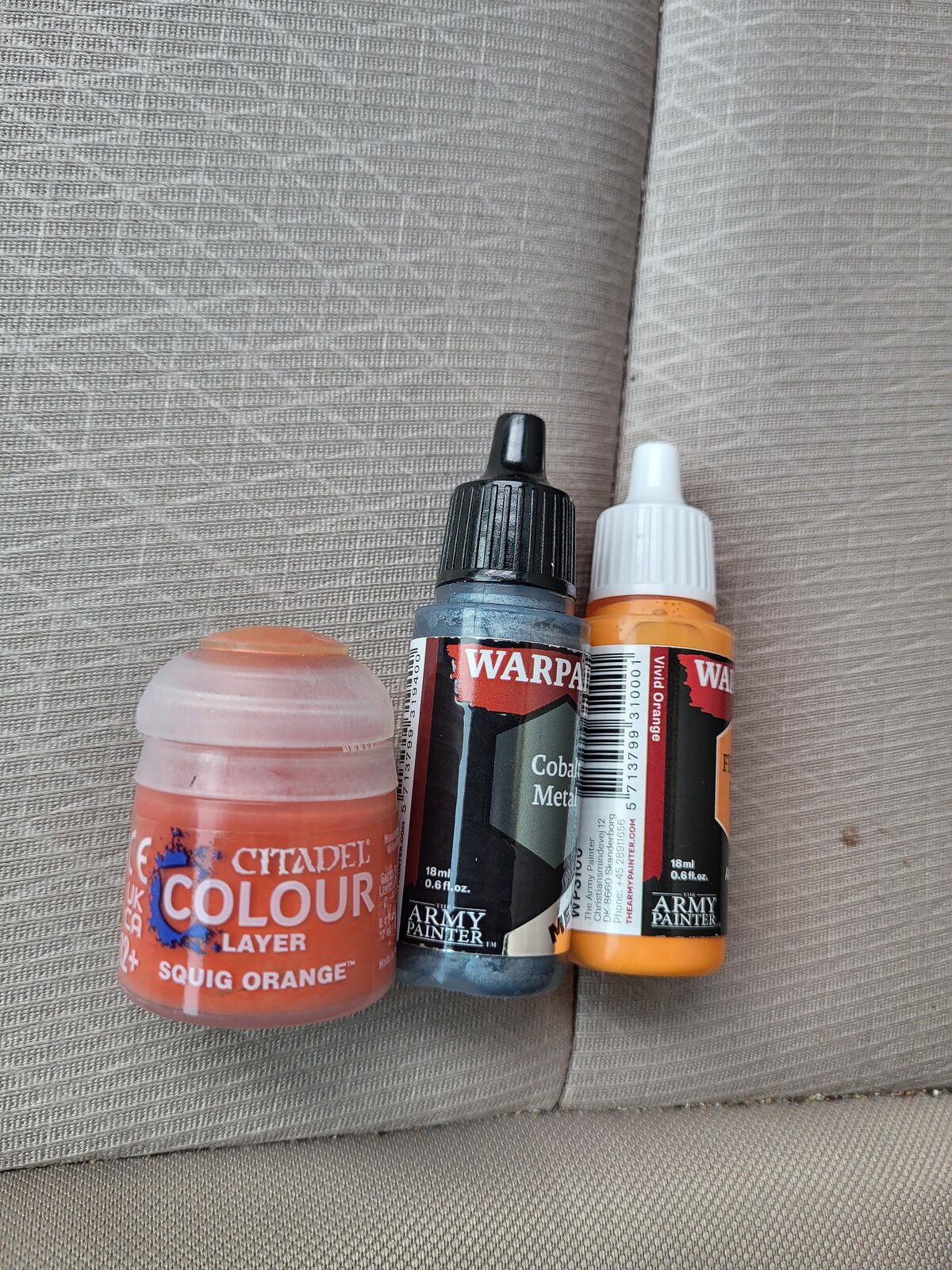

I've had good results with these two brands for miscellaneous colors., go to paint is usually Vallejo and Tamiya.
...My Scotch upbringing says I won't be trying some of the more expensive options, tho.
