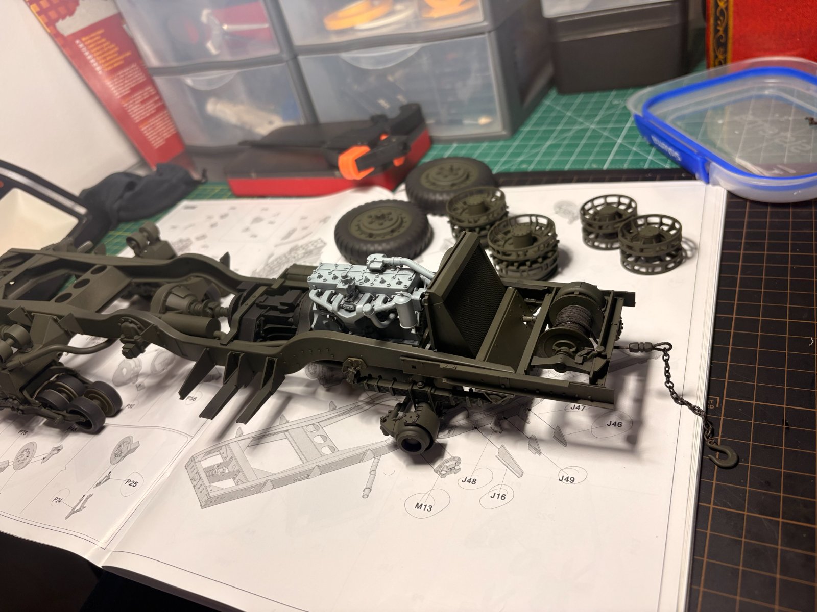

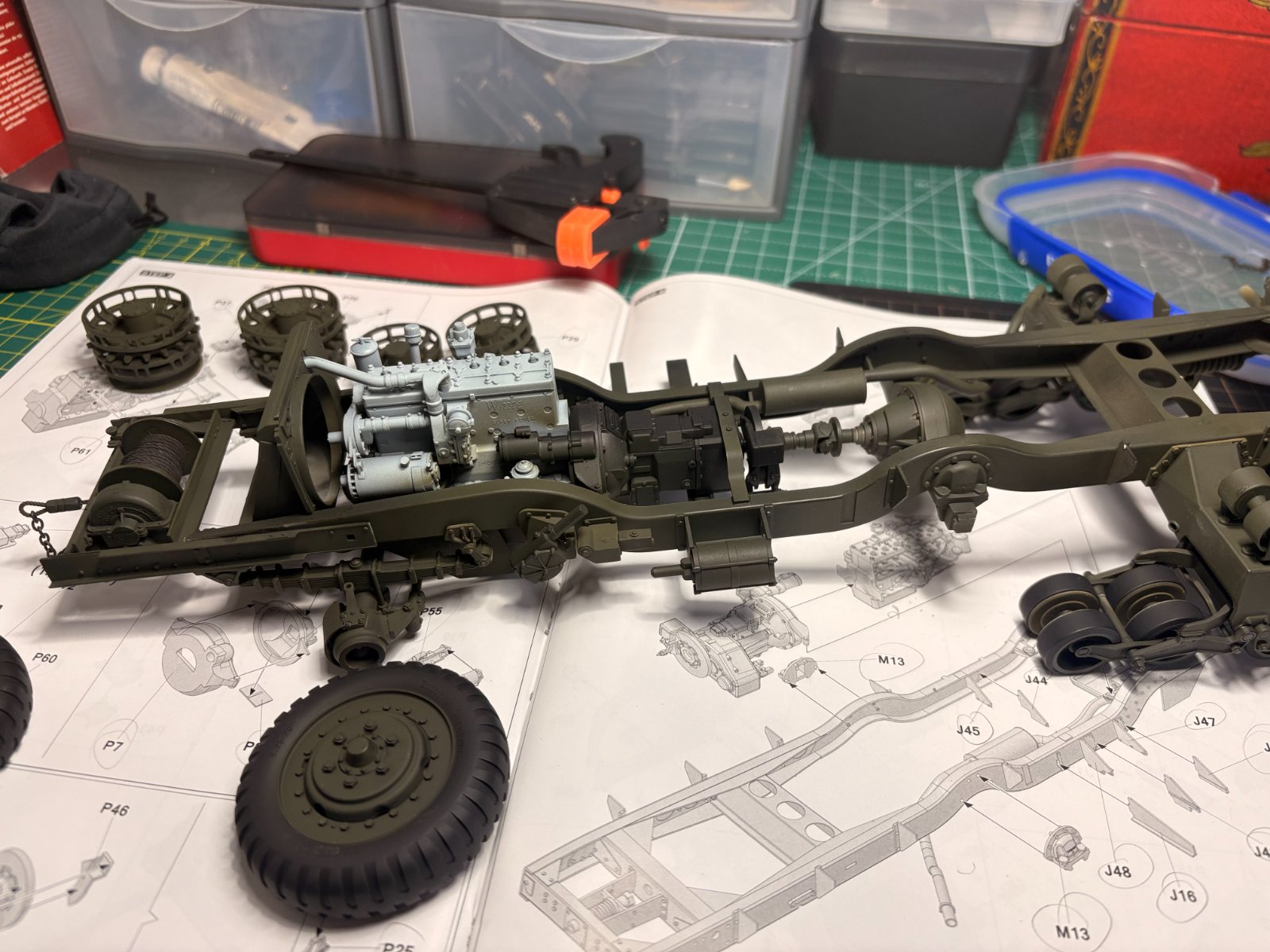

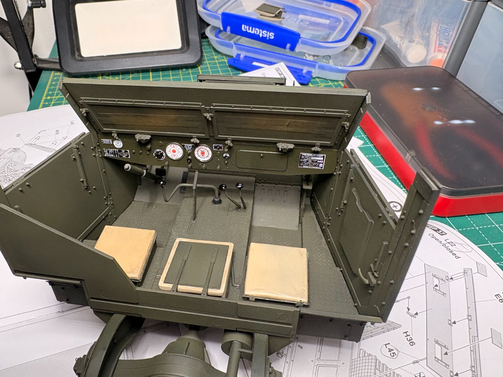

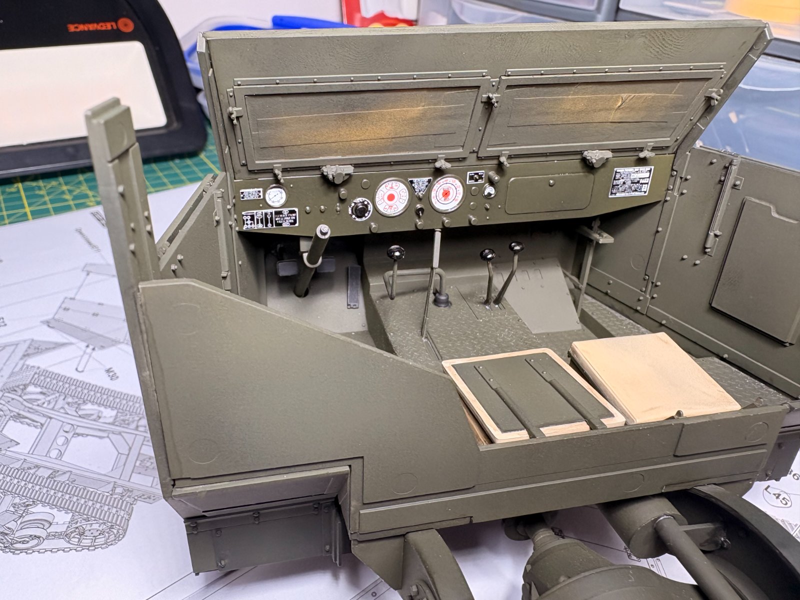

Kept working on it.... but did an error that I cannot fix now! Hopefully not too obvious
On the real halftracks, these tracks were single-piece affairs. Not separate links, but rubber that was vulcanised around a skeleton of steel cables and connecting pieces. It makes sense for a model to not replicate that with separate parts, IMHO (even though that's what Takom does do in their 1:35 M29 Weasel kits, which have a similar style of track).
Good info!
If you've built the kit, it's probably obvious, but despite looking at pictures of real halftrack components I don't see anything clearly wrong.
Never built a half track and am not familiar. Plus I don't have the focus to go over the pics.
Overspray on the engine?
Exhaust/muffler is green?
Steering linkage is missing but that's not a mistake.
At first I thought the radiator was mounted vertically not leaning back at the top, but then I saw the shroud.
I'll look again later.

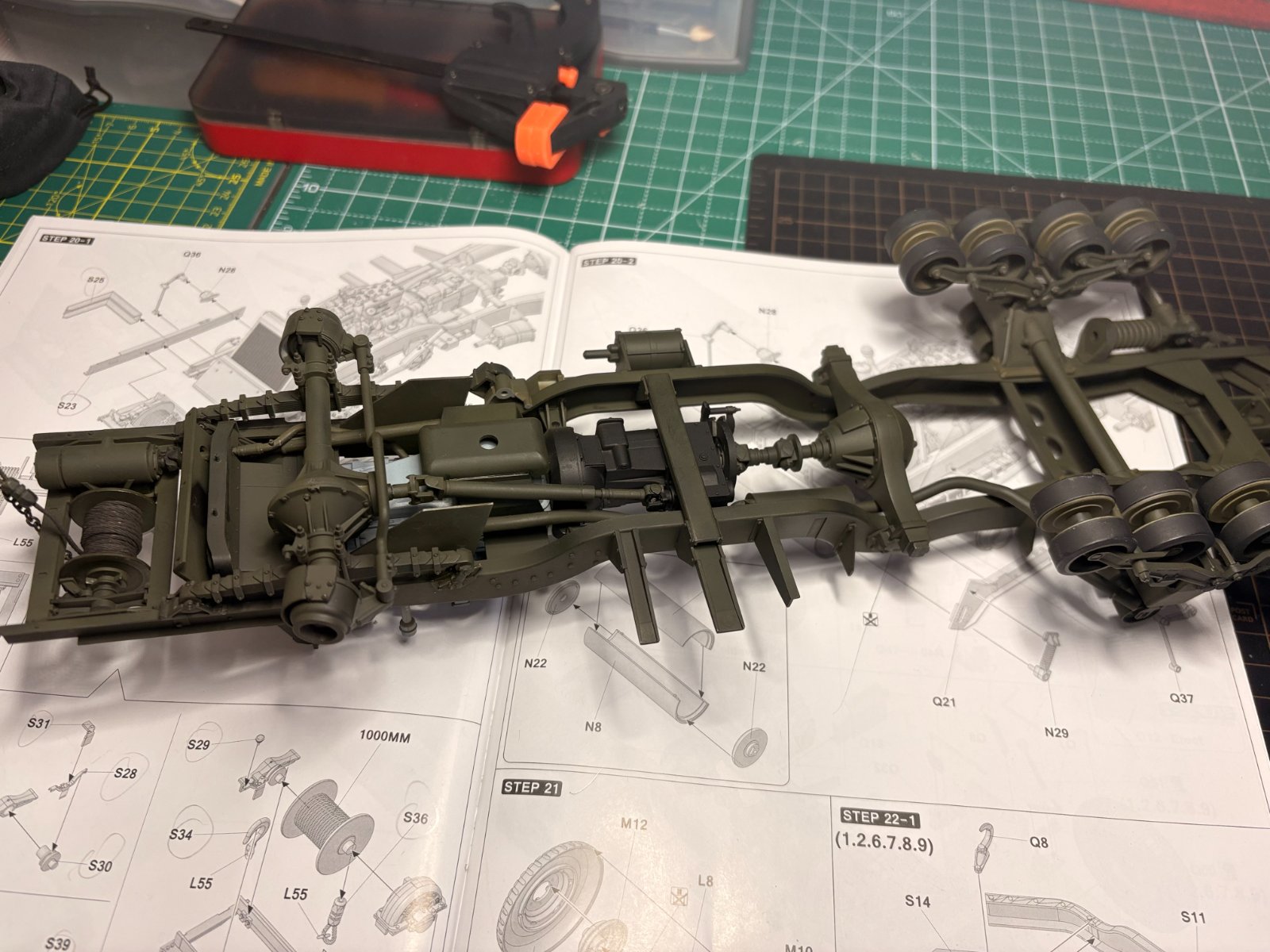

Great.. the mistake I did, was to wind the cable on the winch drum the wrong way. As it is now, the cable would "rub" the frame if used.
But if no one sees it, I guess good enough for me.
Ah! That's a pretty subtle mistake, and I think you could probably fix it by taking the outer layer of the cable off, cutting it off and winding it back on the other way …?
