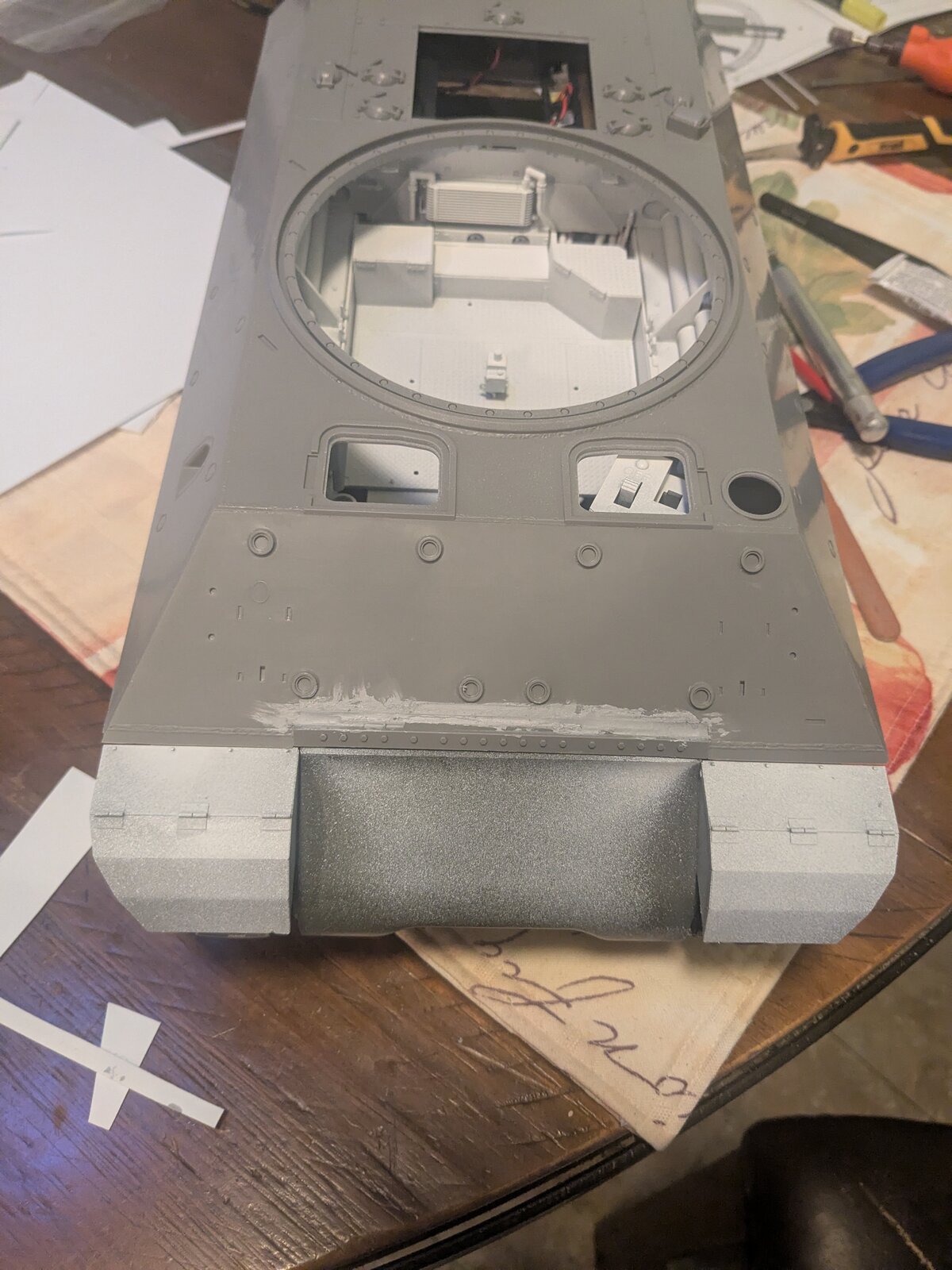

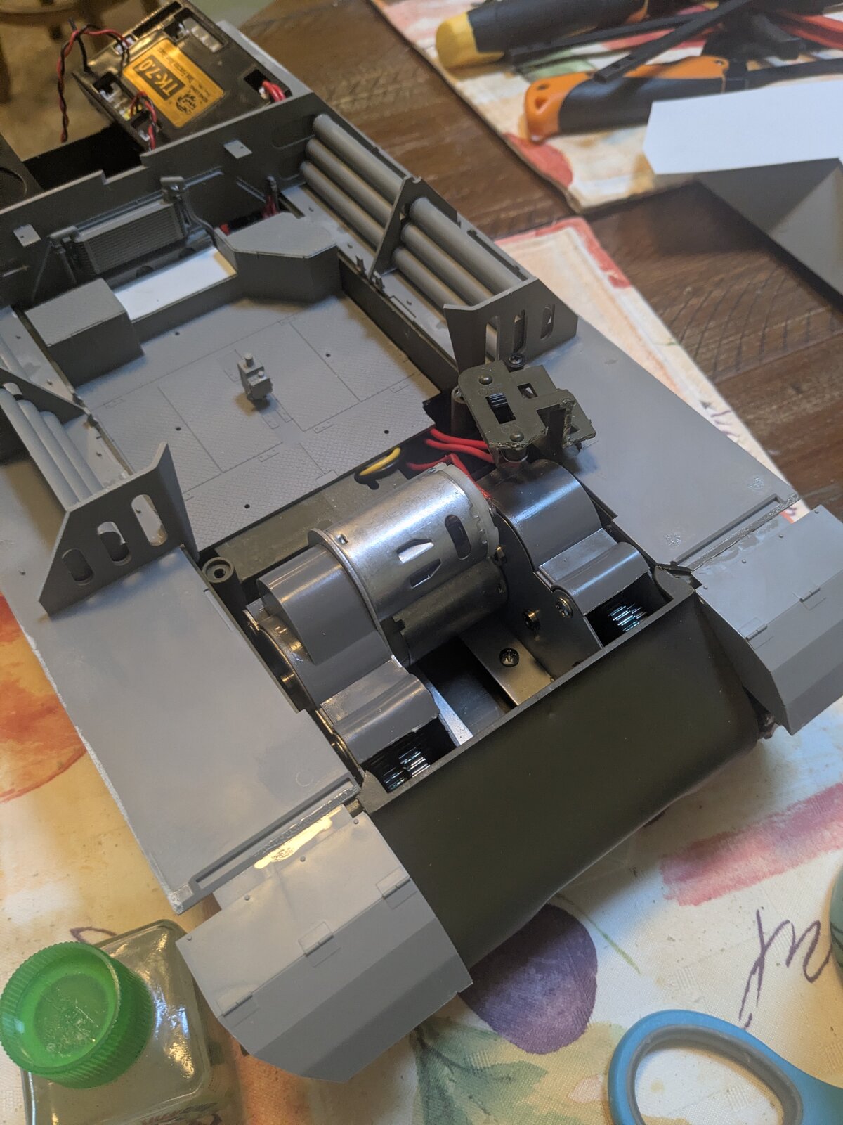

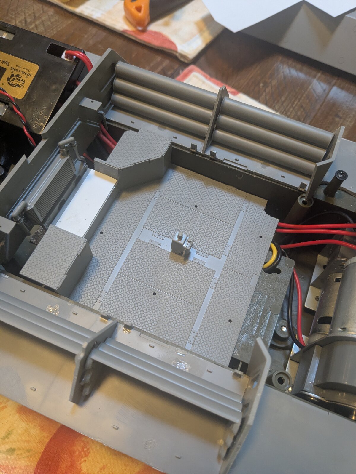

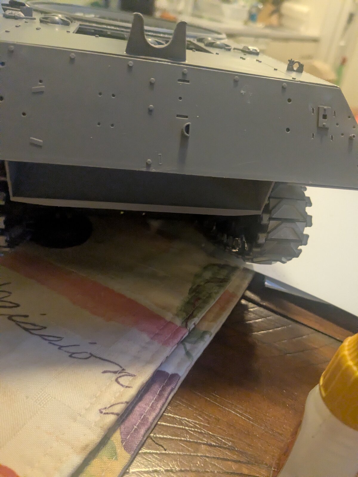

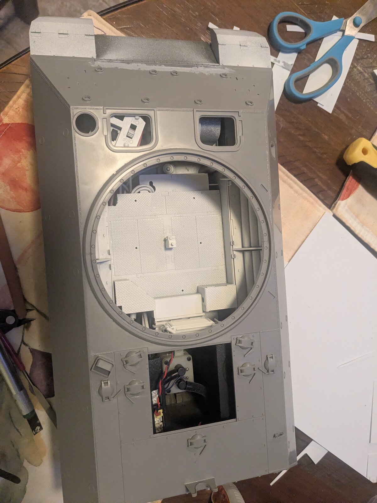

So I have a spare Sherman hull lower setup with the controller and such .. I am going to try an RC lower with an Andy's m10 upper hull. I will try to make it all working except main gun ... However the turret will rotate and it will have all sounds .... I will also try to have the interior on this conversion.
So far I have condensed the rc section of it somewhat ... I am trying to gauge interest.

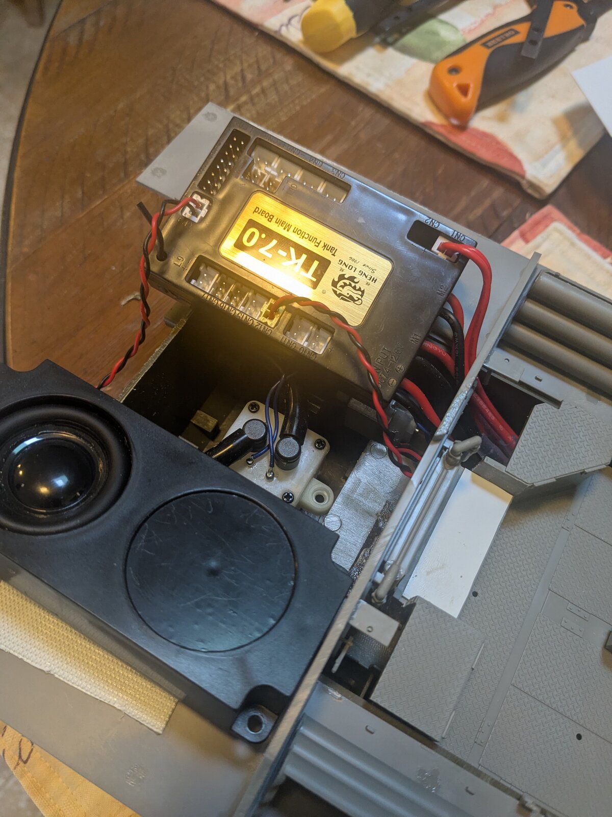

I had to add wire to lengthen it so the main control board and speaker are located in the rear of the vehicle. Part of the reason for this is so I could place the interior... There was also some modifications done to the Sherman base to get it all to mount together. A lot of things relocated but looking like I can do this now...
