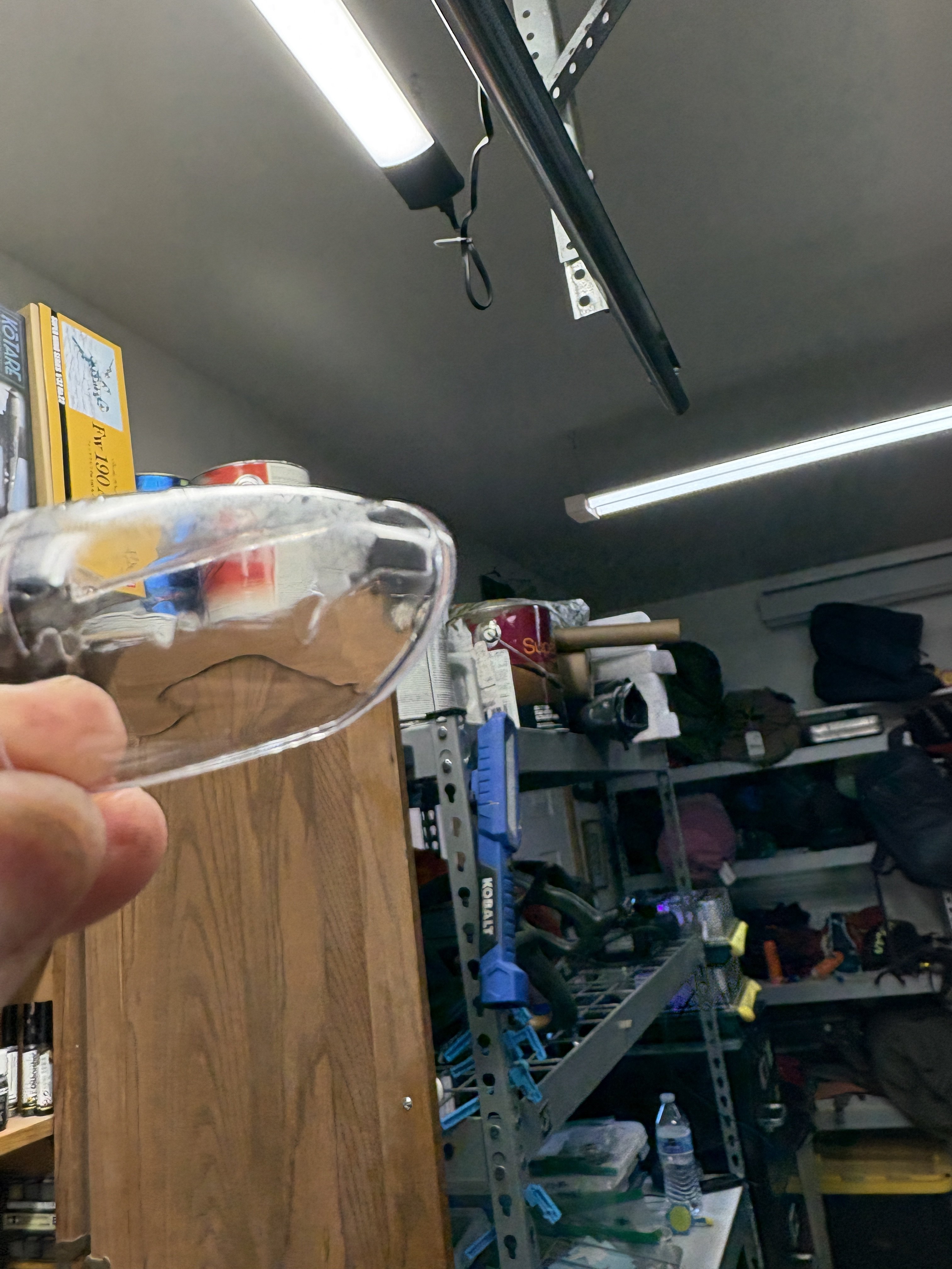

Yeah here is the sad result of my test. I let it dry 48 hours, put on a strip of Tamiya tape, let sit for 24 hours, pulled tape and it left very obvious mark. Worthless product beware!
Will see if soaking it in water can remove it all or will have to try and buy replacement from Trumpeter.
