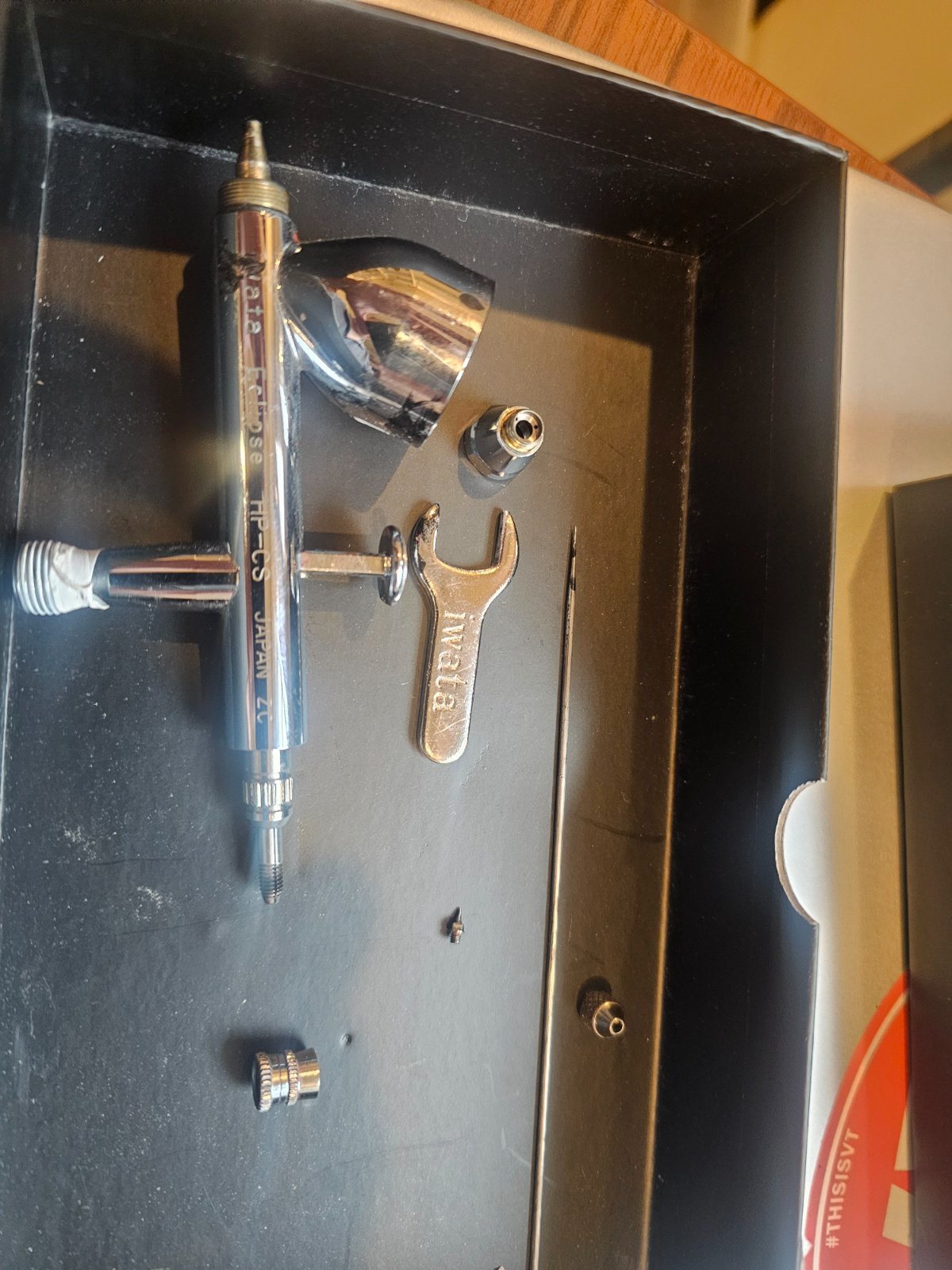

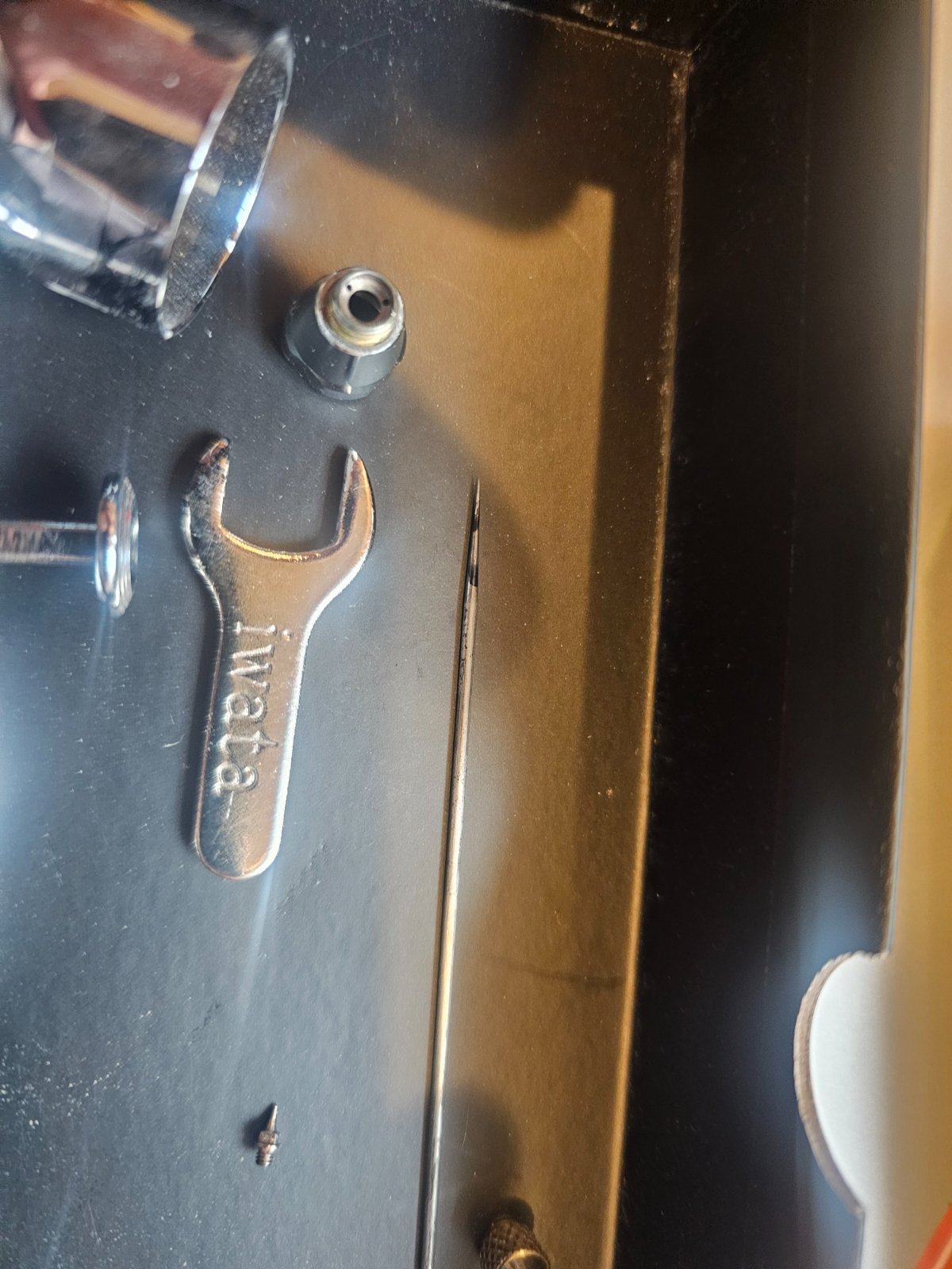

The airbrush is a new Iwata eclipse HP-CS That's just a few months old with a No-Name (the brand) air compressor by Spraygunner.
The issue that I'm having is that my air flow seems to be stuttering. Like going...THH...TTH...TTH ..TTH...ETC and there's an issue where, if I push the button down for air only, I'm getting some bubbles blowing back into the cup as well as when I'm pulling the button back. I don't know if that's what should be happening but it doesn't seem like it should be.
Note: I'm not getting any fluid to come out if I'm only pressing for air so I don't think there's any issue with the needle seating at the nozzle.
I have, however, noticed that if the cup is empty I can no longer hear it stuttering nor can I feel any pulsing on my hand when I spray at my palm. The minute though that I try to run anything through the brush, I can then hear it "breathing" again and I can SEE the pulsations in the spray mist. Getting even, consistent coverage at this point is next to impossible.
I'm also getting really quick tip dry even after putting in retarder and thinner to a good consistency. I'm using Vallejo model Air, Tamiya acrylics, and Alclad ll lacquers. They all exhibit the same issues. I've had no issues until the last three or four spray sessions. I've disassembled the brush completely and scrubbed and cleaned it twice with lacquer thinner but it's still doing it. The only thing I didn't take out was the needle valve seat and seal because I didn't want to tear that far into disassembly when I didn't see how that would affect the air flow since the air is entering past the valve.

If it blows bubbles in the paint cup, there's air flowing back from the nozzle, meaning it's obstructed. Do you have an ultrasonic cleaner? That will get stuff out of an airbrush that's very hard to clean out otherwise.

Could it be the air jets themselves that may be obstructed then? I used a nozzle reamer on the nozzle. And no, I don't have an ultrasonic cleaner.
I took off the nozzle guard and sure enough, two out of the three air jets were plugged with a film of gloss varnish I'd used a week or two ago! I used the nozzle reamer to clear them out and everything is back to normal. THANK YOU!!
