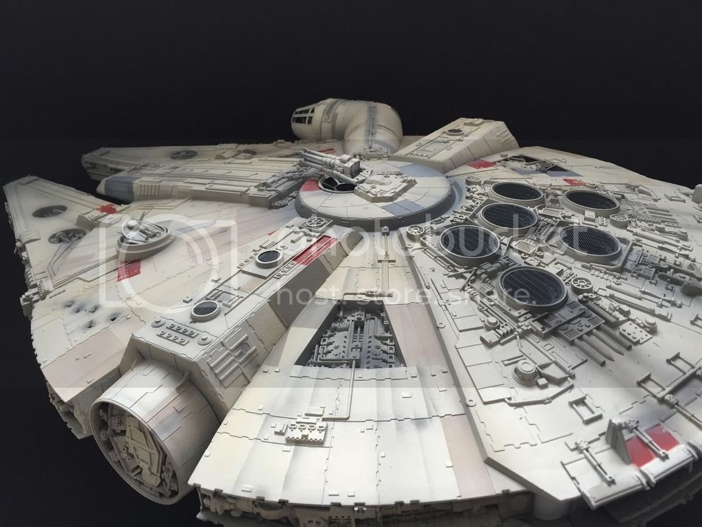

Lol guys! Right I feel I've turned a corner now and I think this may well beat the deadline....
Got the shadow markings on with using only the airbrush:
Next update will be the proper streaking and weathering using vallejo for the streaks by hand with a brush and filters and grime with AK and Wilder enamels ;)

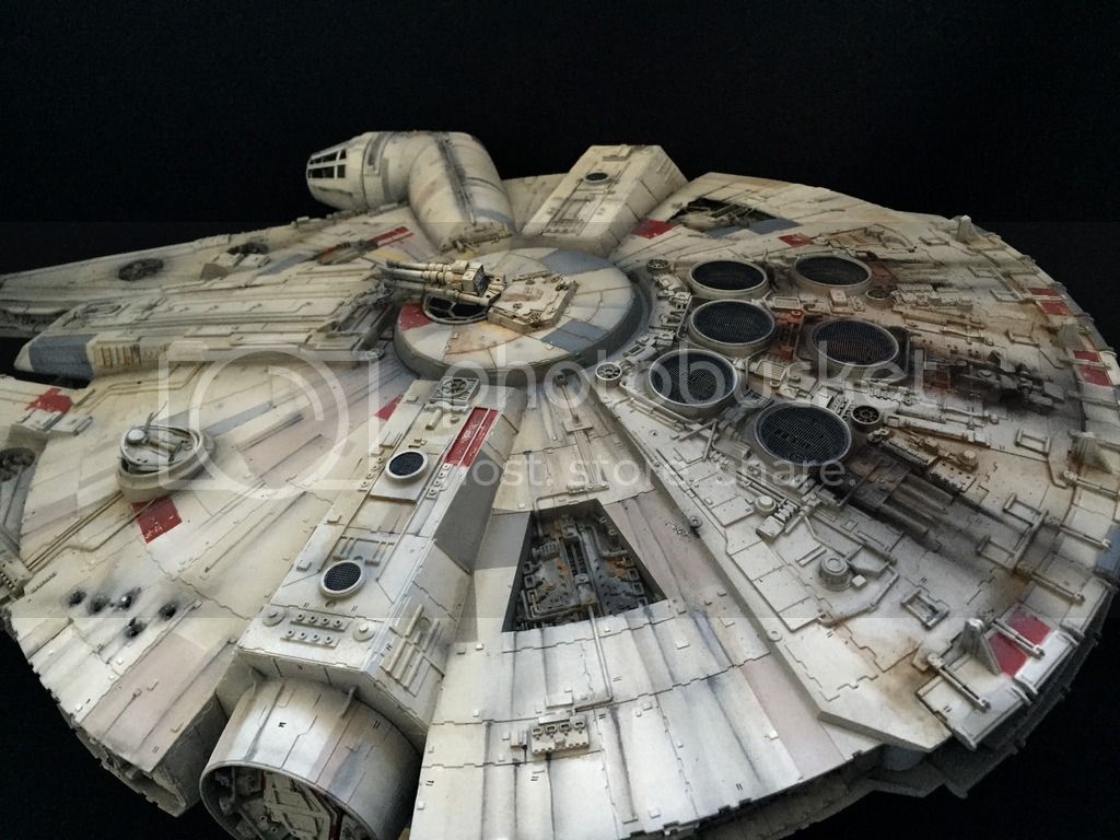

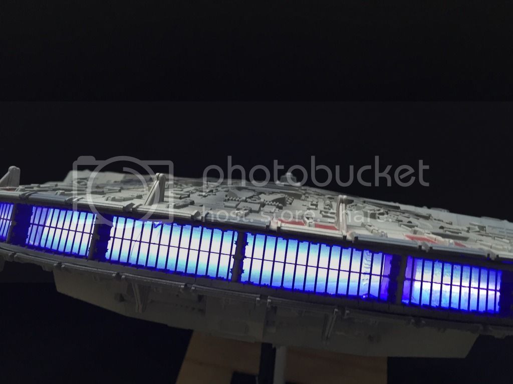

Man that looks amazing. The lit engines are fantastic, and the whole thing is just...well...magnificent.

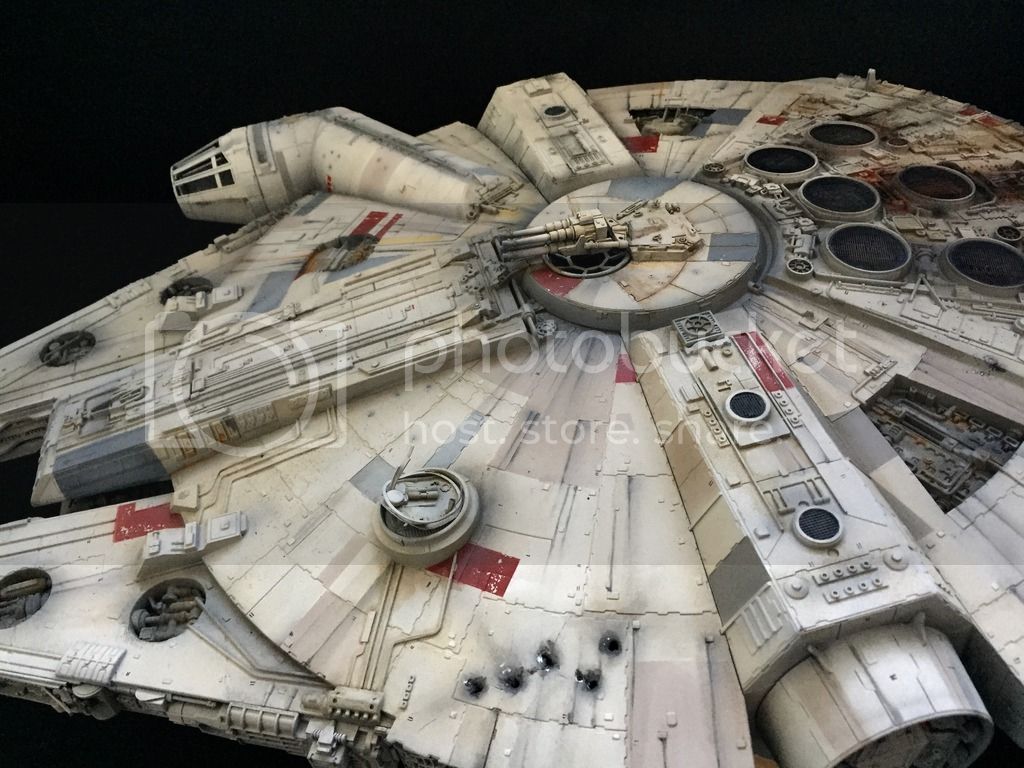

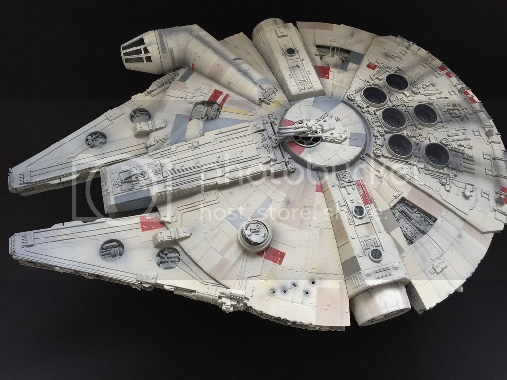

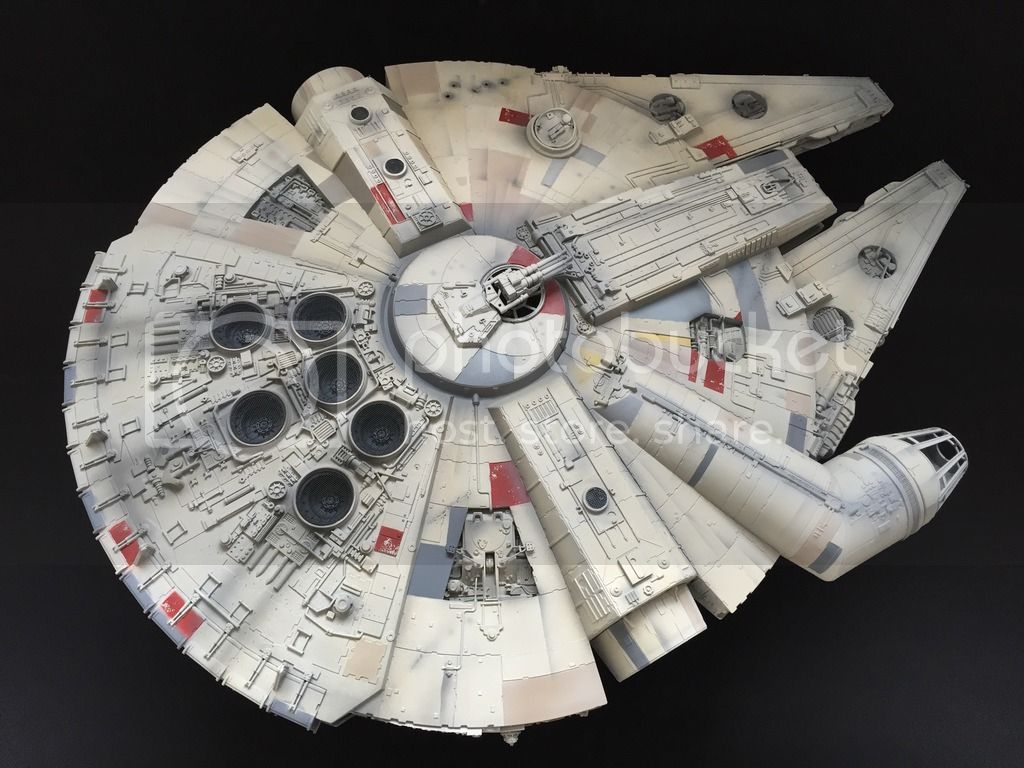

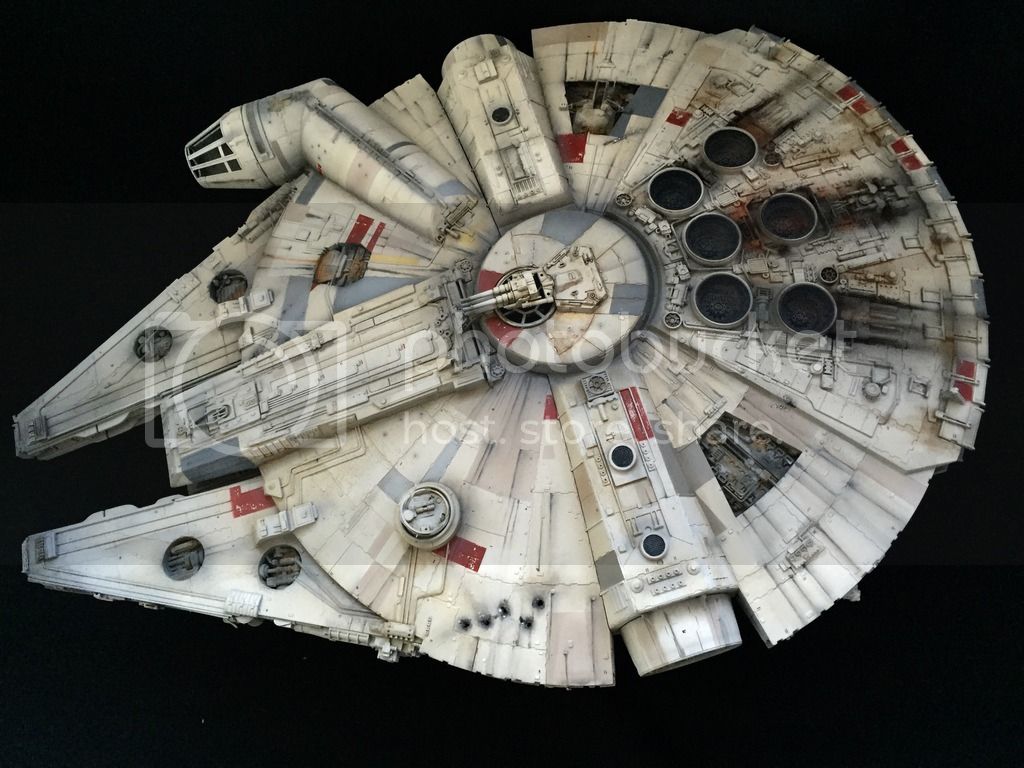

Thanks guys, yeah plenty of splatter :P Ok well the top is done, I didn't like the bold streaking that I had done by hand with the Vallejo Air German Grey so I removed them (cotton bud damp with vallejo airbrush cleaner) and re painted them with Humbrol Blue Grey, this way I could easily feather them out with a flat brush damp with enamel thinners, still got to weather the bottom and install

What technique did you do for the spatter? I find that it's tough at small scales
(I paint a lot of stage scenery which is always incredibly large
I imagine that you did less brush work at this scale, am I right?
More airbrush/spatter/ pigments, less oil washes
Yeah but there was still plenty of washes, filters, pigments and streaking with the brush.

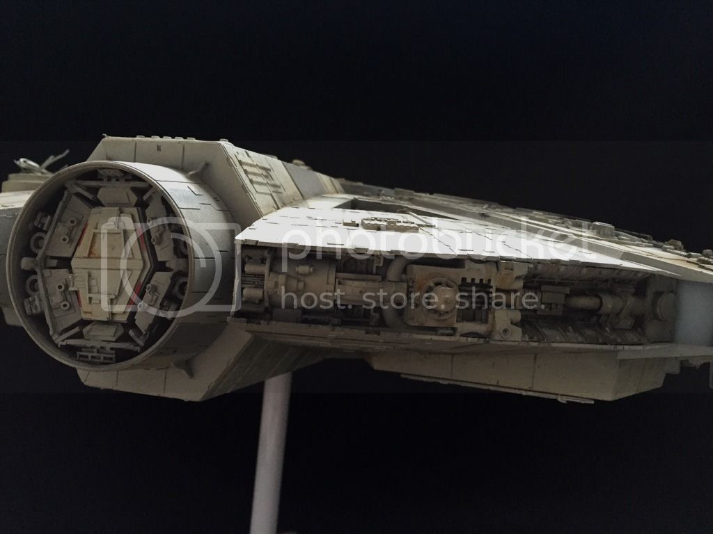

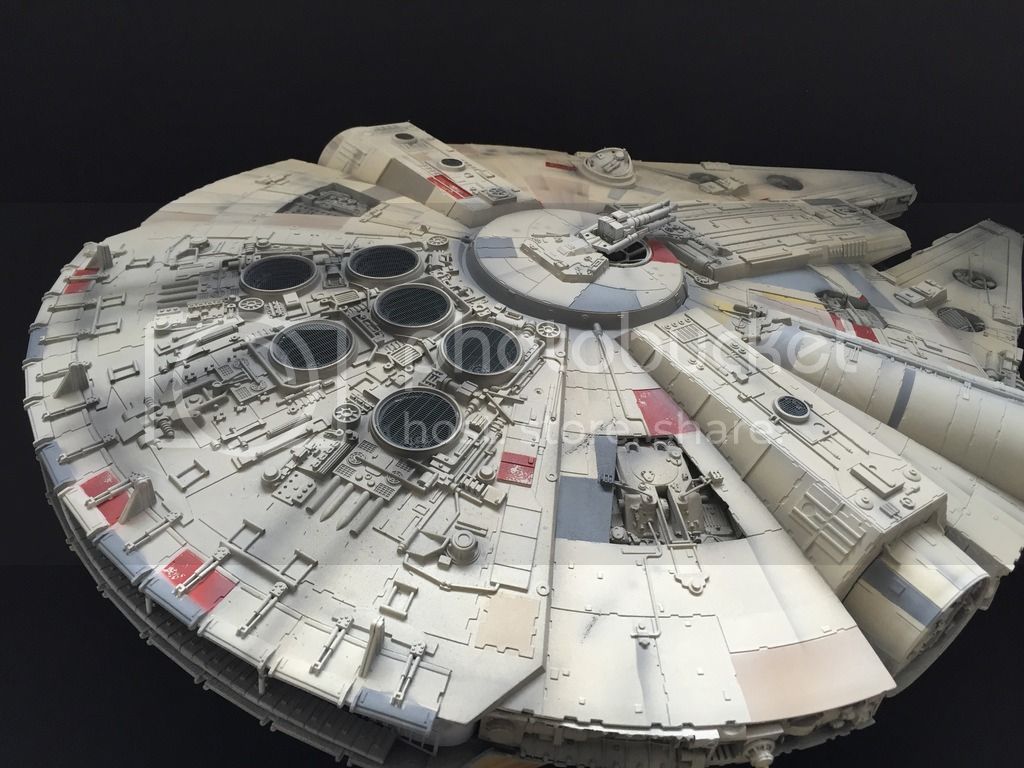

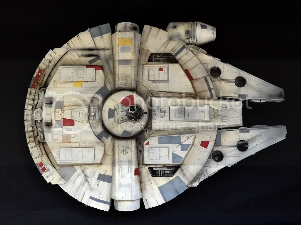

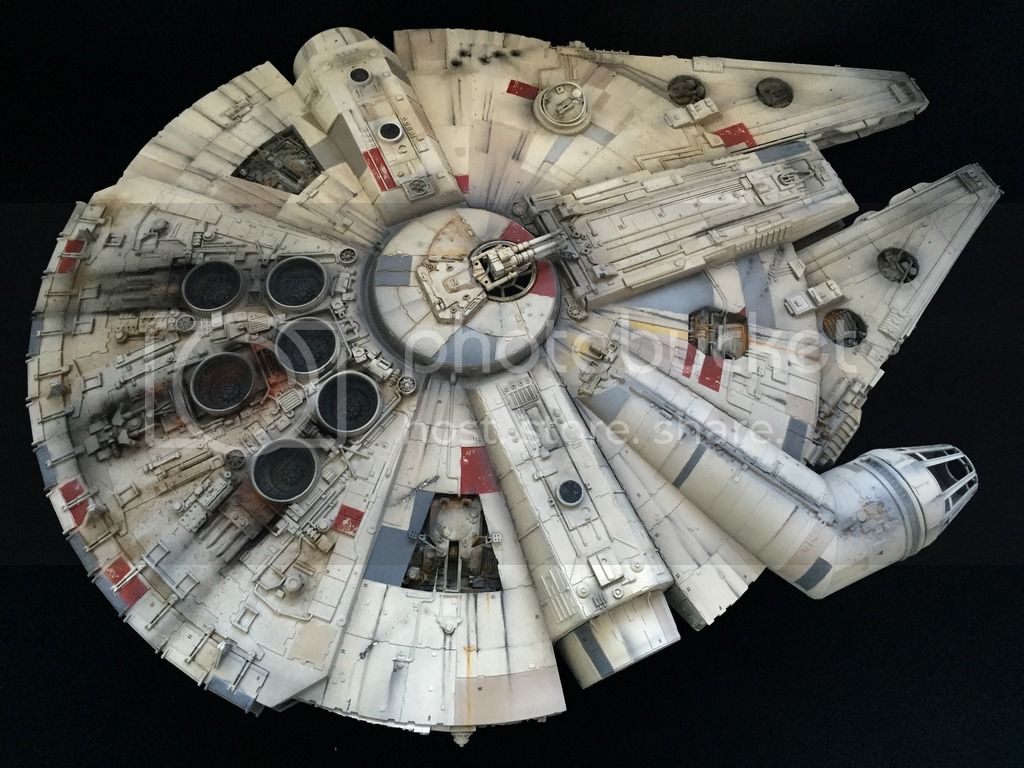

Thanks again for the kind words guys, it's pretty much finished apart from the cockpit, there's nothing in it at the moment. So here's the bottom:

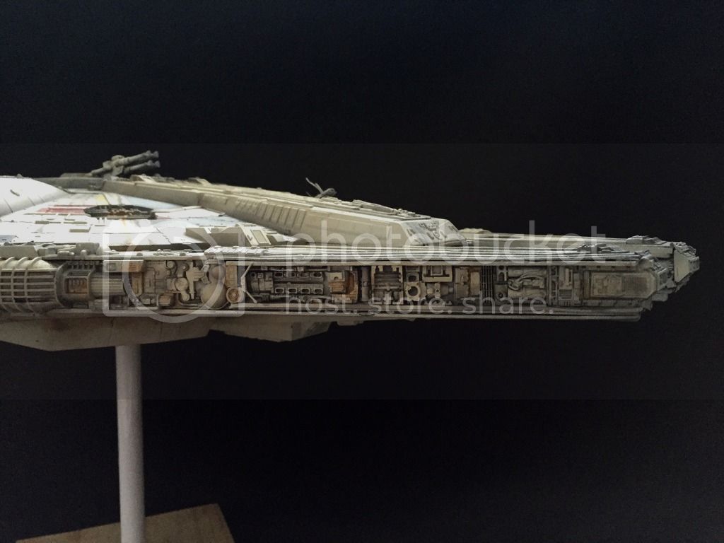

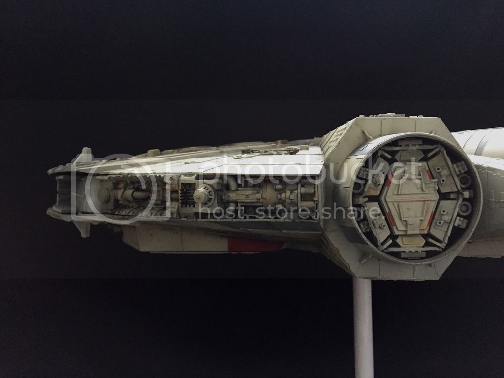

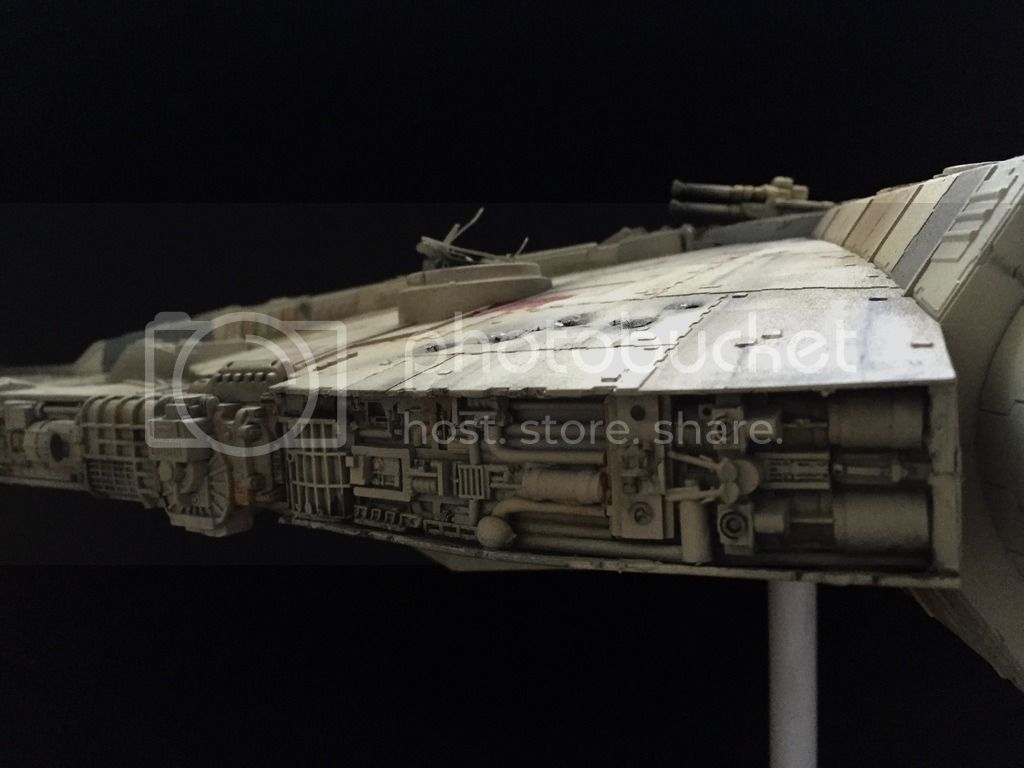

And the resin sidewalls from Randy Cooper:

What is in your cockpit? I don't know if I missed that in the thread.
What did you do about the stock piping? Did you add brass in a couple of places?
Did you replace the inside of all your mechanical wells? (I think you said that jatea supplied some resin casts)
Hey man, the cockpit is empty at the moment. The figs need to be re sculpted and positioned correctly, no pipes added, the only well that was replaced was J's awesome upgrade.
