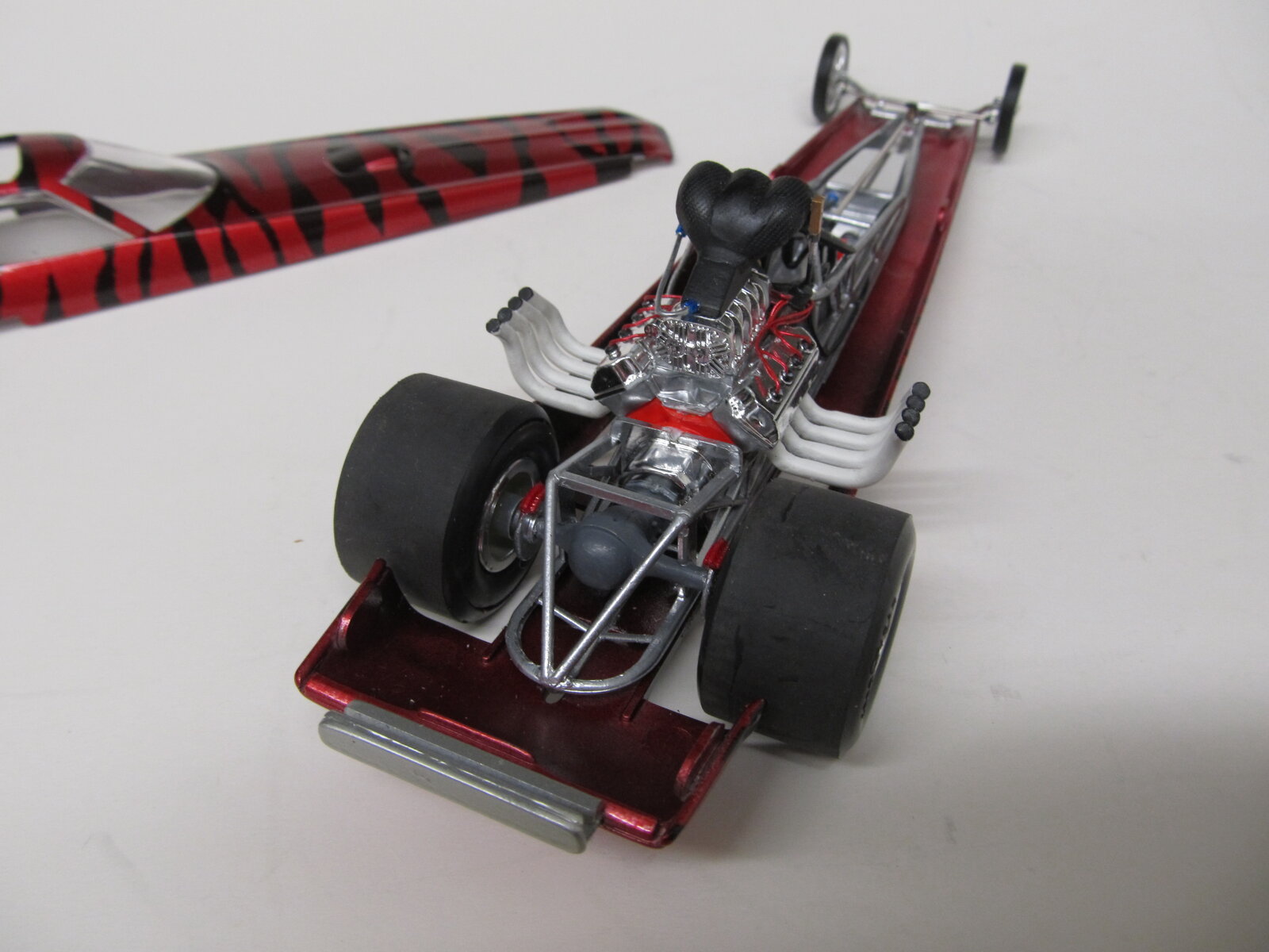

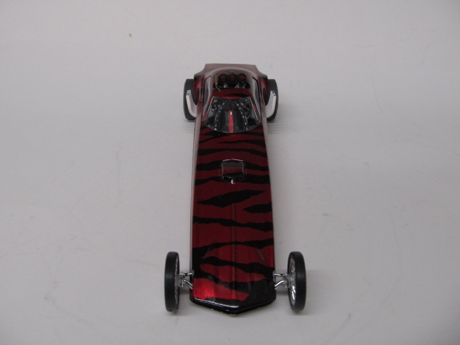

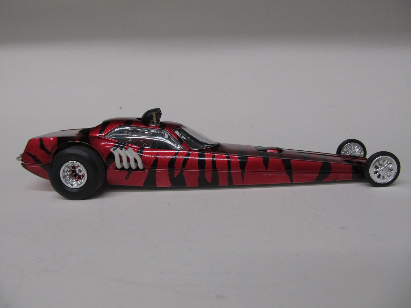

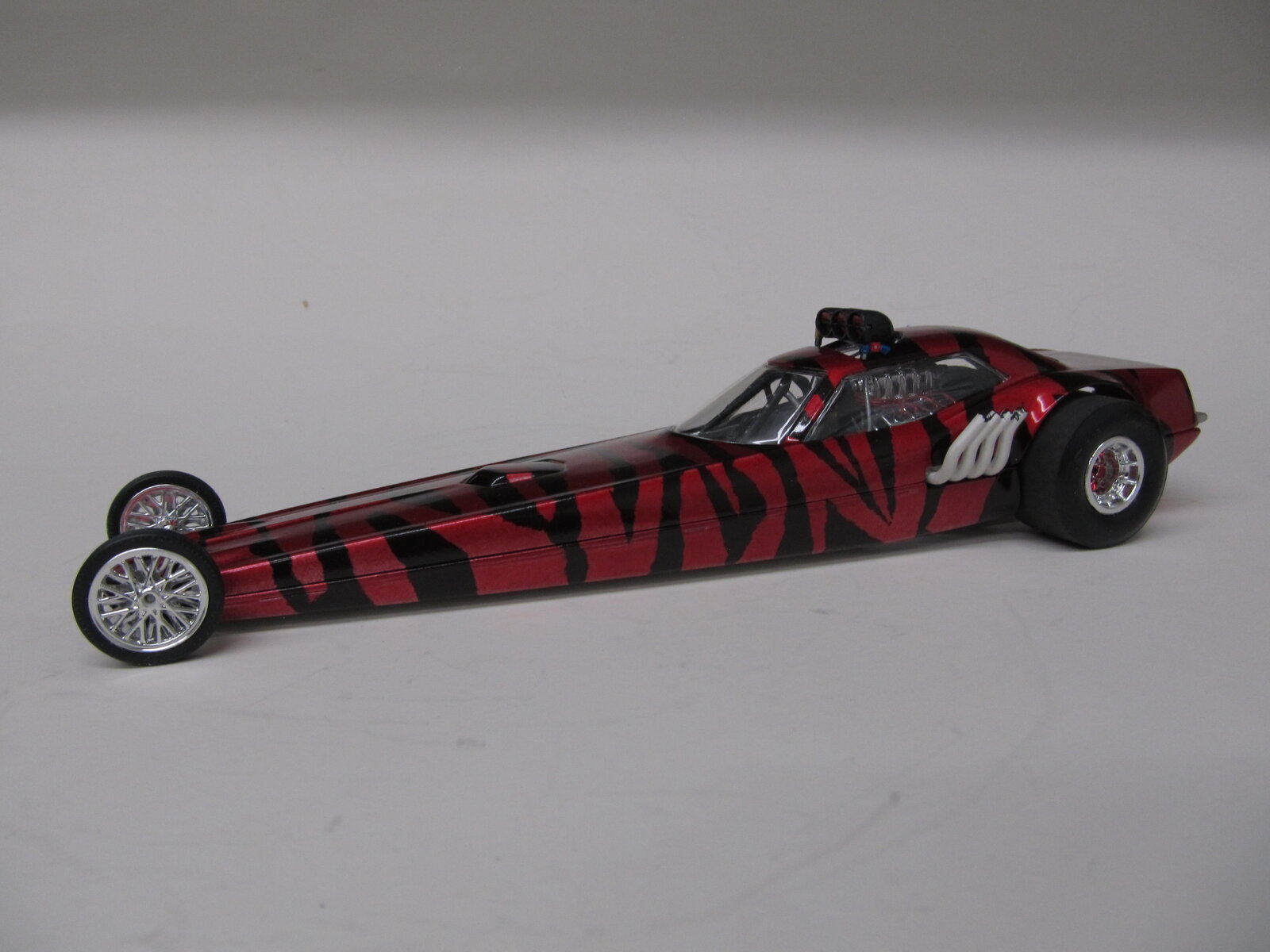

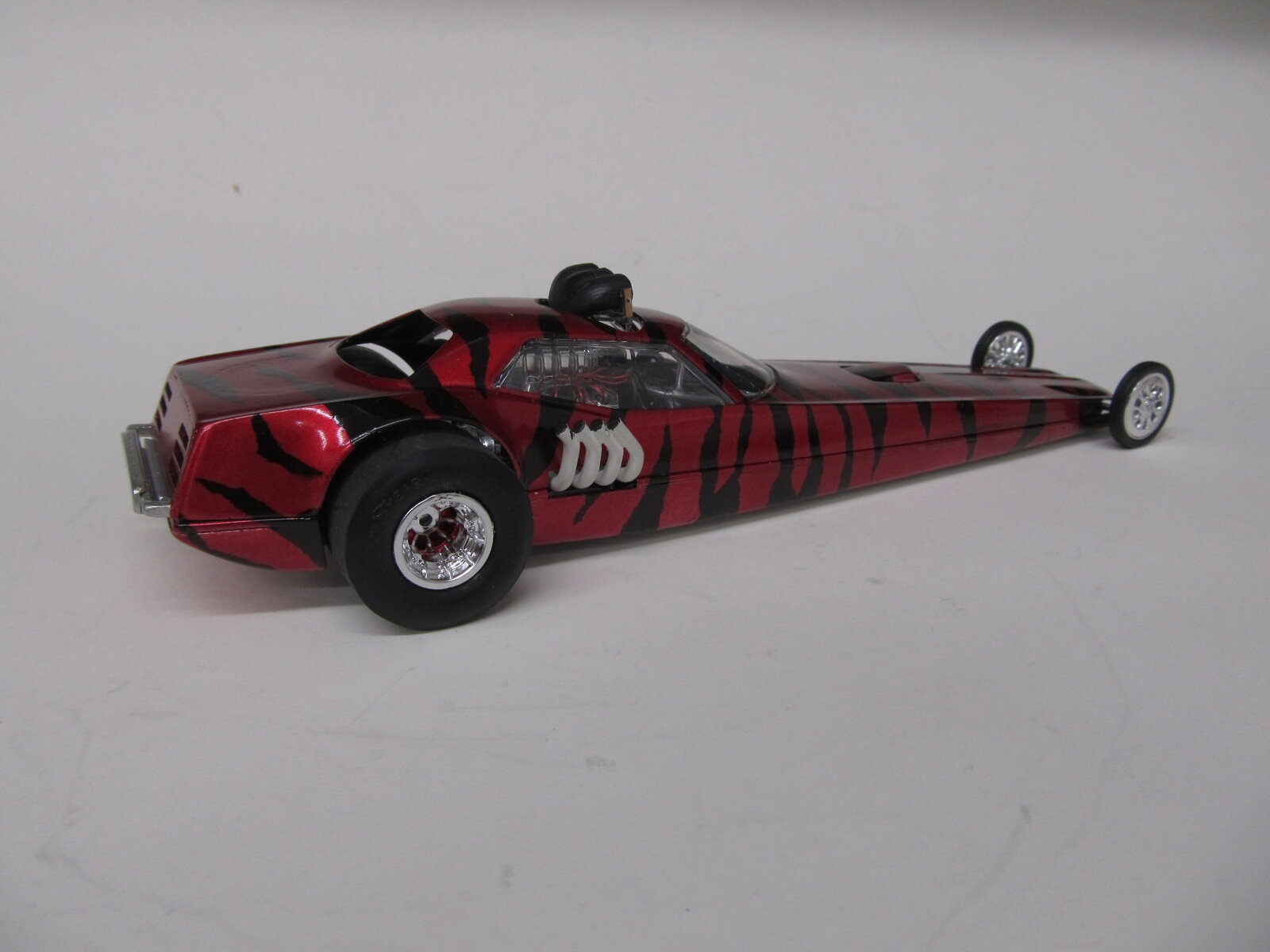

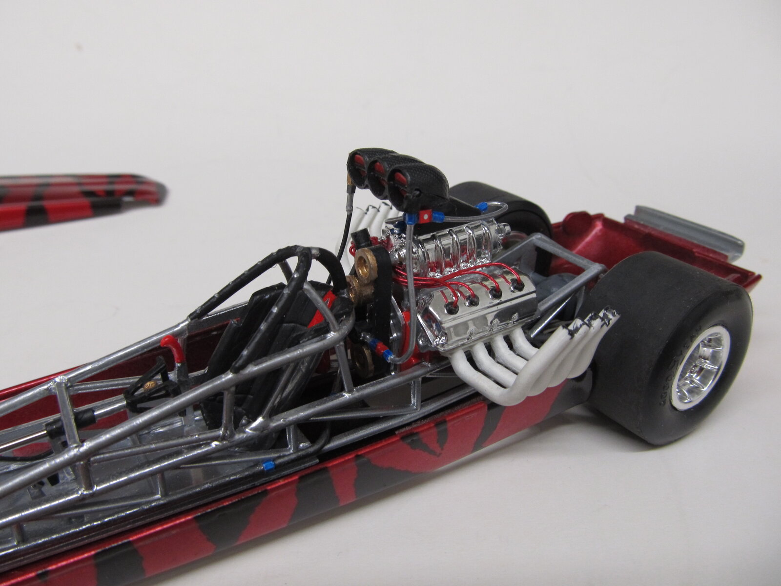

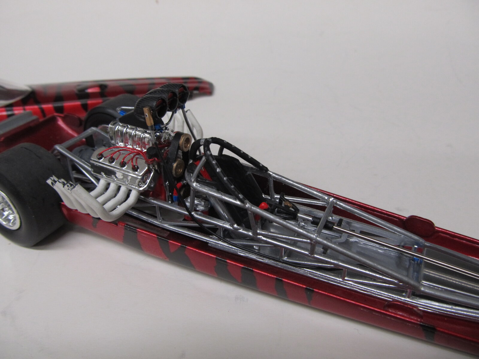

Here is another semi classic kit from AMT, it shares its chassis and accessories with the Hippie Hemi, meaning you get a really detailed kit with clear oil pan and windows in 3 colors, chrome crank, blower that has its rotors and a rubber drive belt, a front end that will steer if you want to take the time but it will just leave the wheels flopping all over the place. Im not much on the driver being in the trunk so like most of my box kits i swapped everything around to make it rear engine and gave it a modern intake and some nice detailing.
That's an amazing paint job! Love the details.
The tiger stripe paint is kind of easy, shoot the black or white base first then just tear tape and start from an edge so the points of the torn tape end up on the body surface then shoot the color you want, let it dry peal and clear coat.
