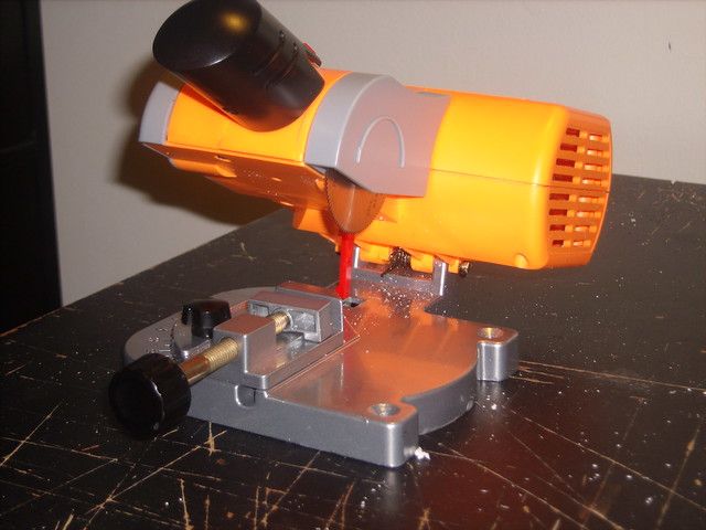

I use a small chop saw I purchased at Harbor Freight tools. Works pretty well, and it will let you adjust the angle of the cut.
Grendels - you mean this one?
http://www.harborfreight.com/bench-top-cut-off-saw-42307.html

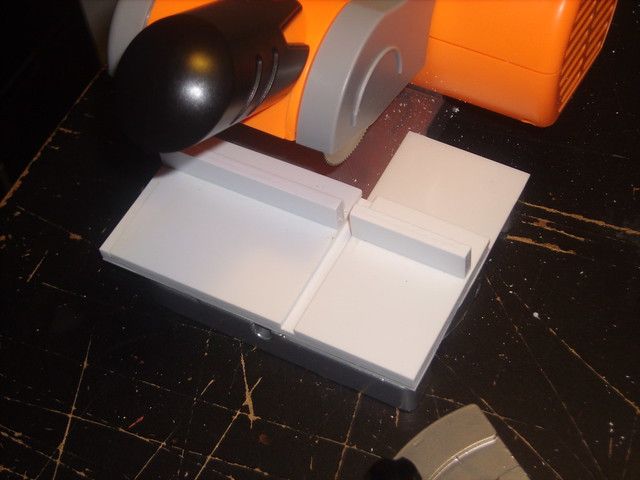

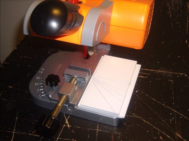

I made a couple of accessories for mine. One for double checking the correct angle as the holder it comes with isn't exactly perfect...
And another one for doing straight cuts of larger stock...
Made from heavy styrene sheet - about 1/8" or so - with pegs below made of bits of sprue in the right places to fit into the holes in the chop saw's base.
