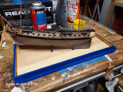

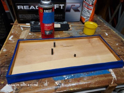

Hey everyone, hope everyone is doing well.

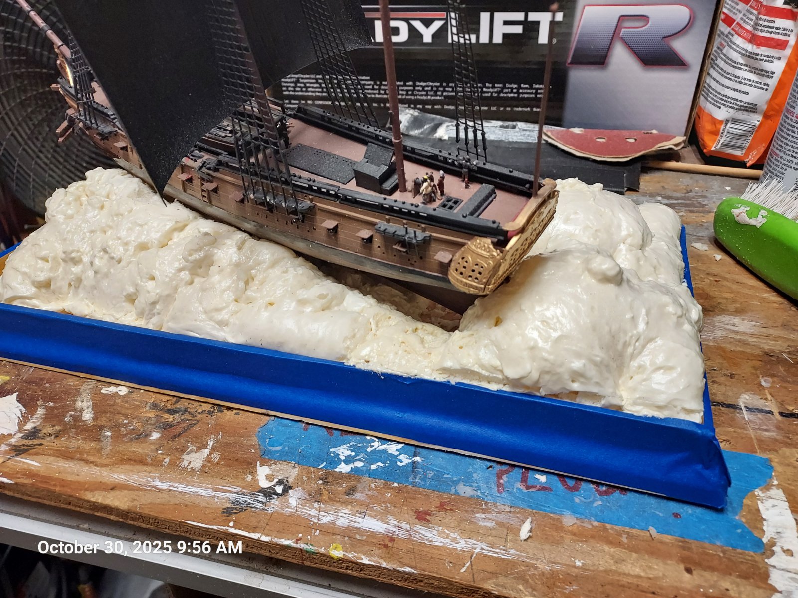

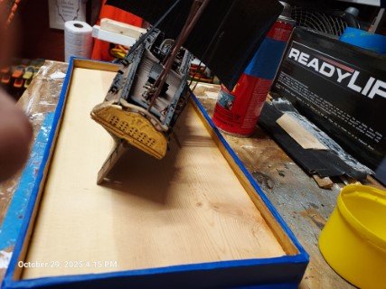

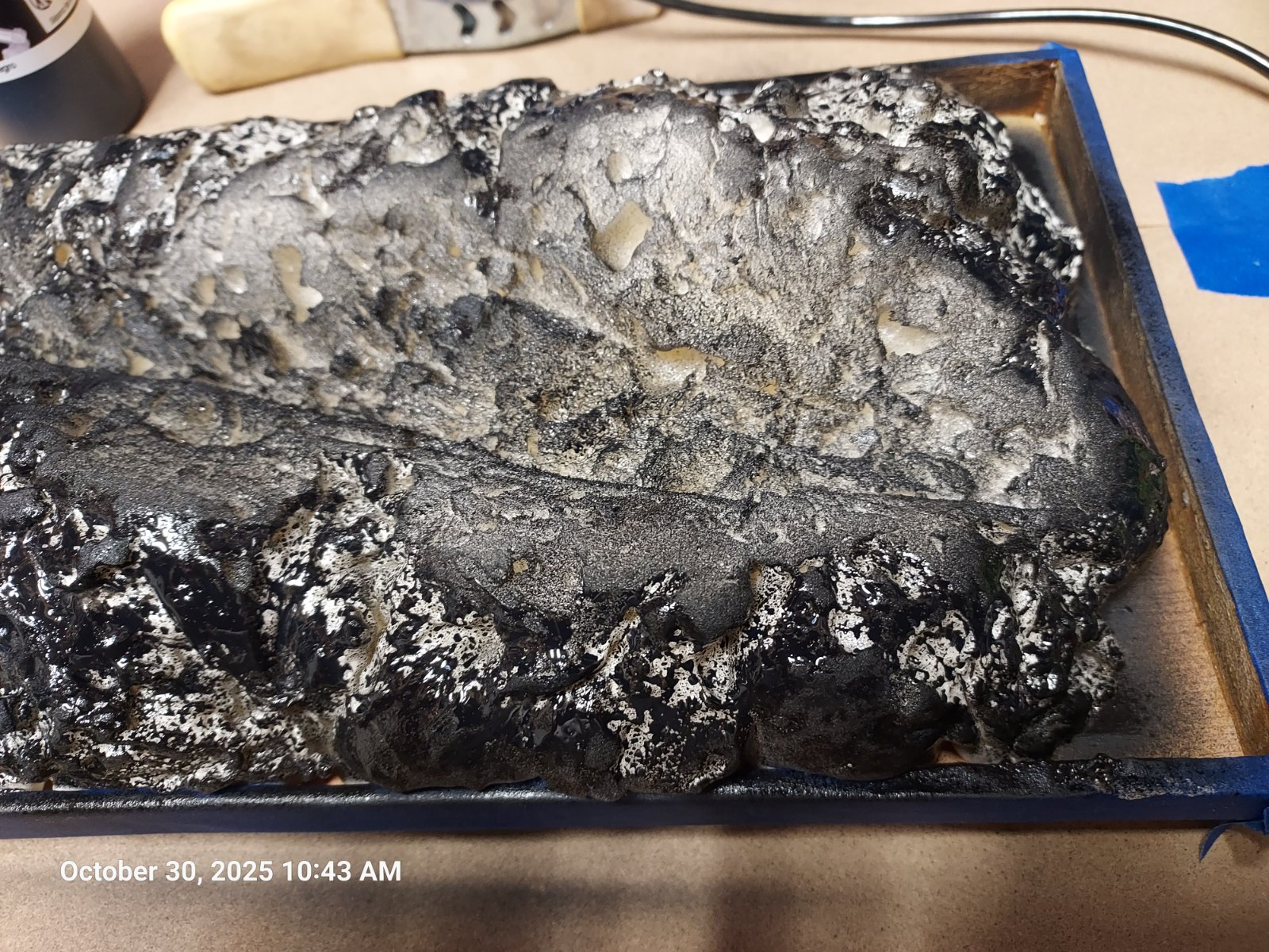

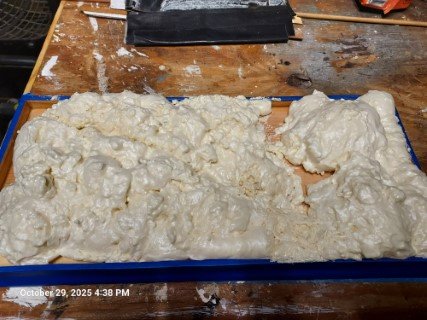

Well i dropped my pirate ship on the floor by mistake and it broke some stuff so i thought i would just make it a positive and make a beached ship Diorama out of it. I have the base drying now, see pic.
My idea is to use some expandable spray foam from the hardware store to make the beach mounds and then cover the foam with pva glue and sprinkle fine sand on top of that, then set the ship between the mounds and place the parts in the sand around it.
Fine modeling sand is so expensive. I have read i can use hamster sand from the pet store or play sand from the hardware store (this one is the least expensive and you get more of it).
Questions:
Is play sand a wortly alternative to fine modeling sand?
Will pva glue stick to spray foam?
Thanks

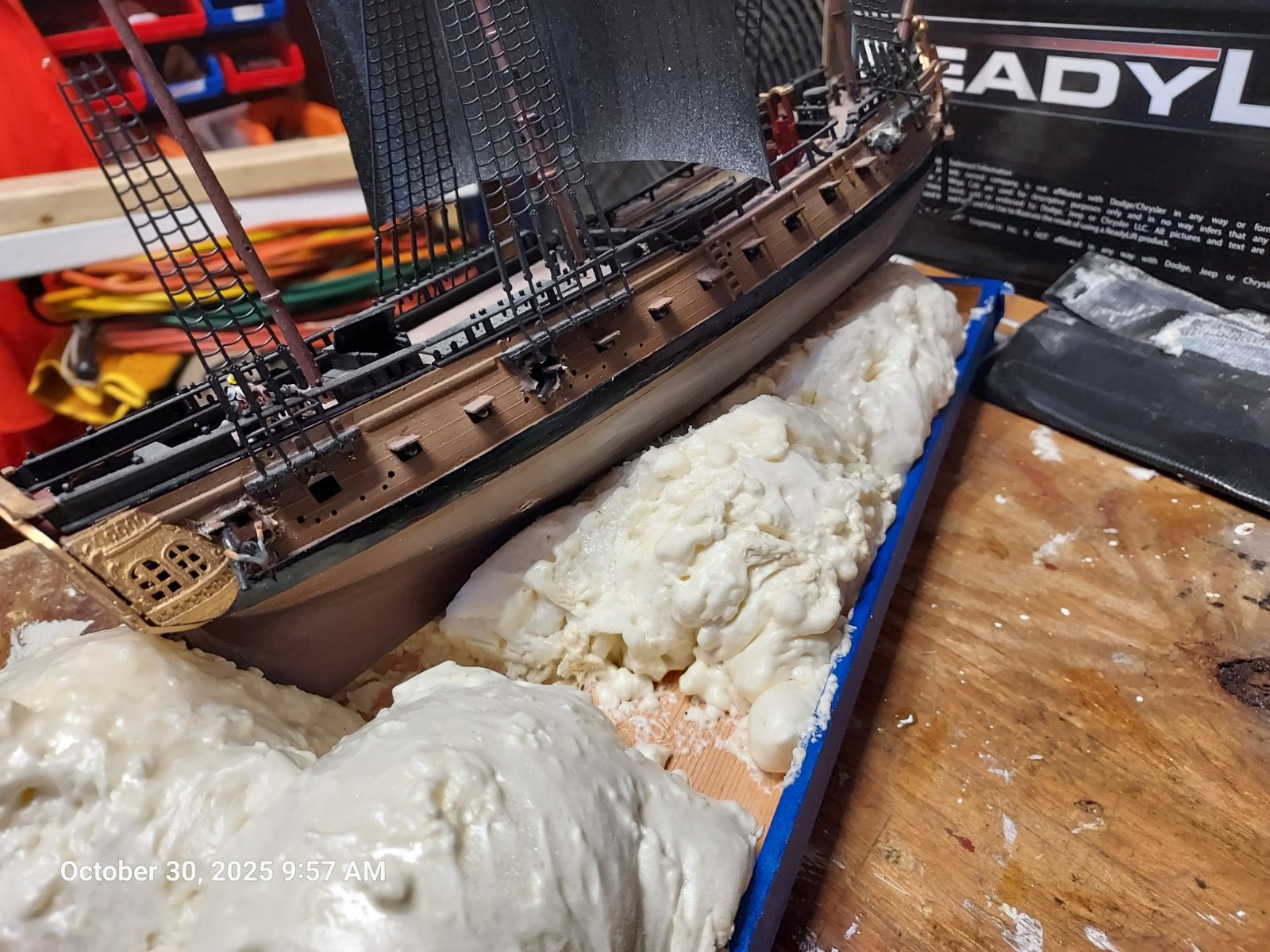

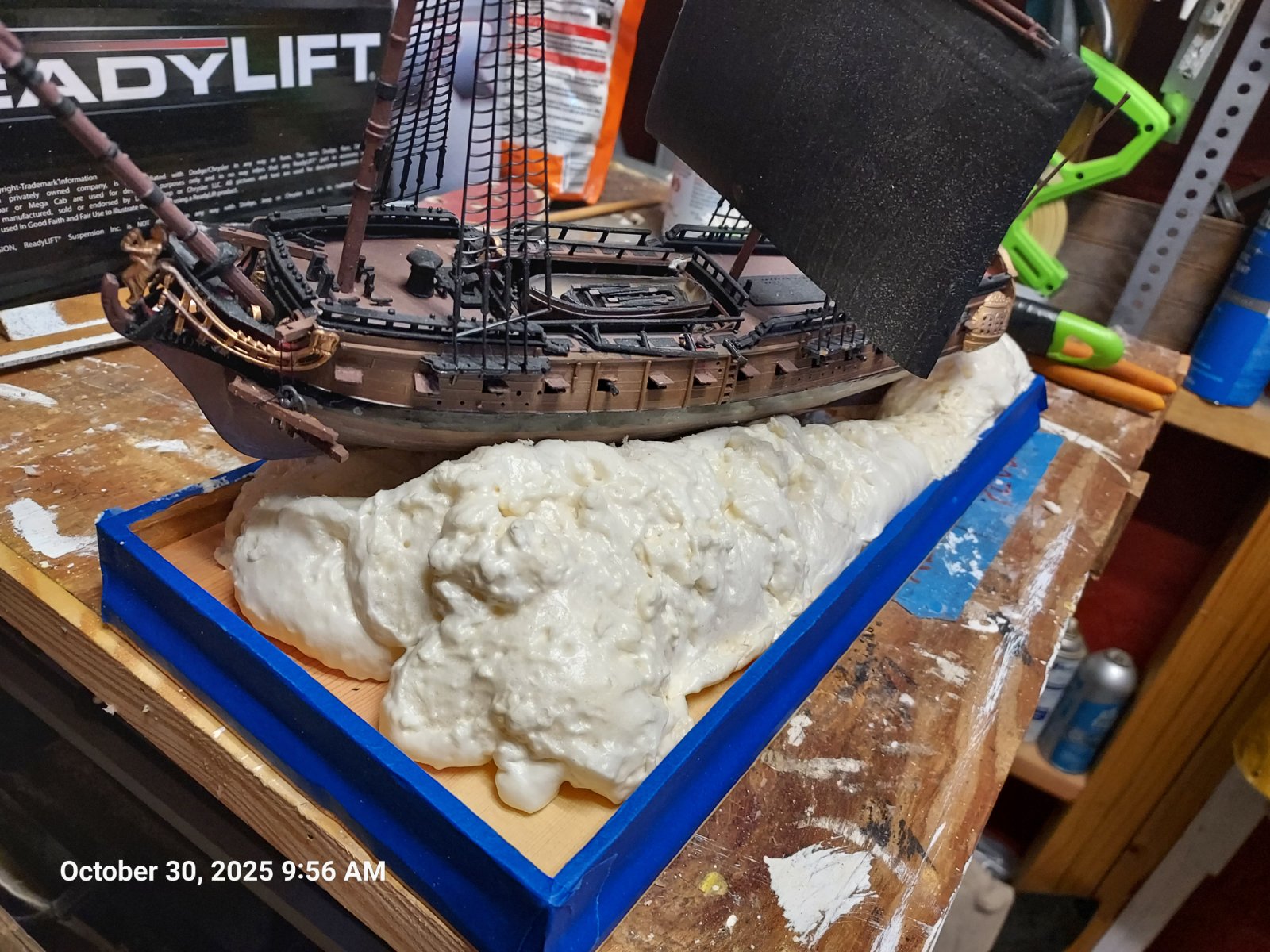

Well i got the ship supports inserted and the foam sprayed, will sand it and shape it better after it cures. If the foam does not work i can just break if off, sand the bottom and im back to a good surface.

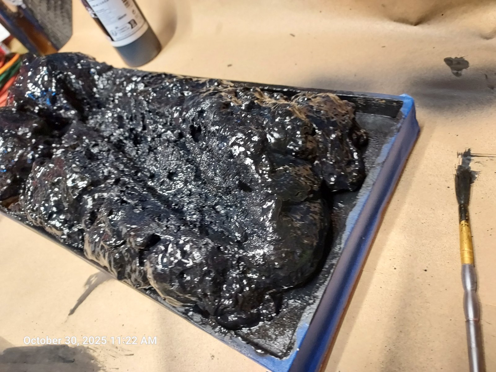

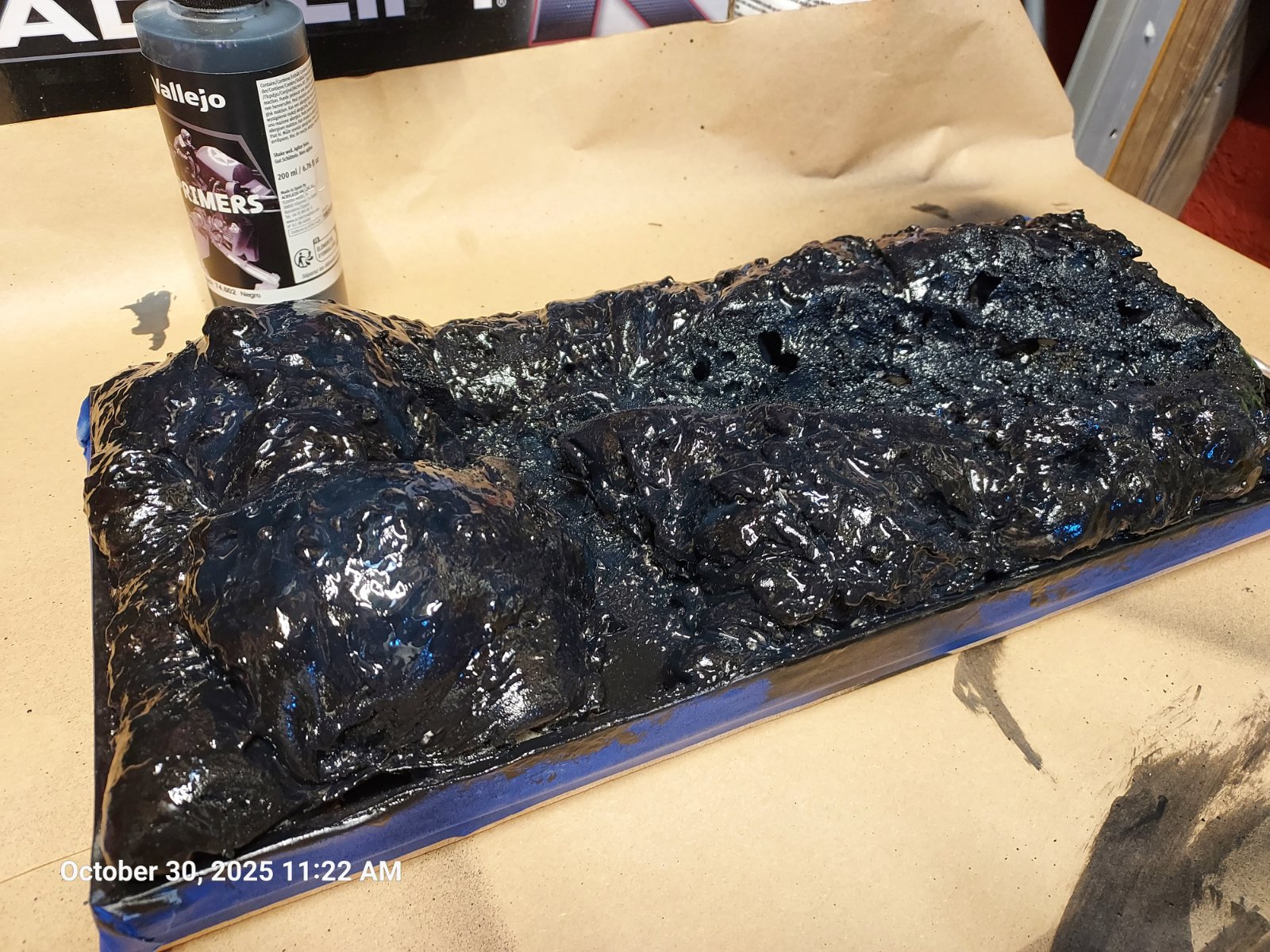

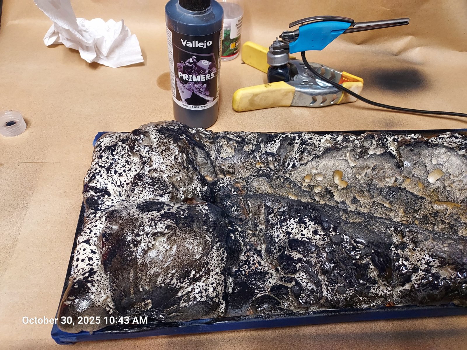

well i sprayed it with primer and i had to thin it slightly to get it to spray. It reacts with the foam is spotty. I assume the thinner and not the paint is doing this. Maybe i need to do thinner coats and wait 30 min between coats, i dont know.
The idea is to mix sand and have bolders and rocks around, with ferns under the ship and a few palms. So the black rock is fine because it looks like lava rock.
I wonder if i should blow a heat gun lightly over it to evap the thinner after each coat, or just use a brush.

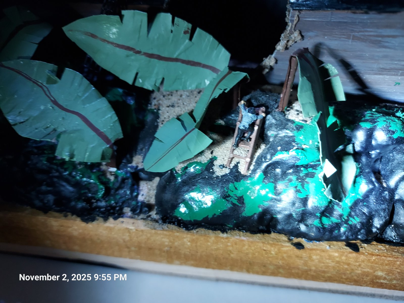

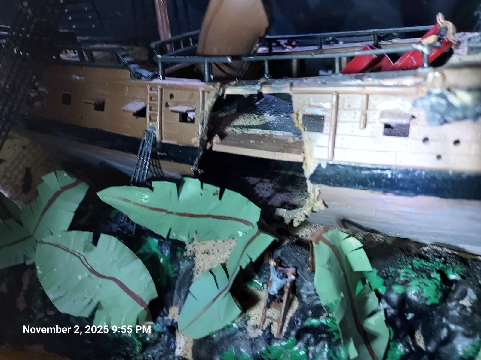

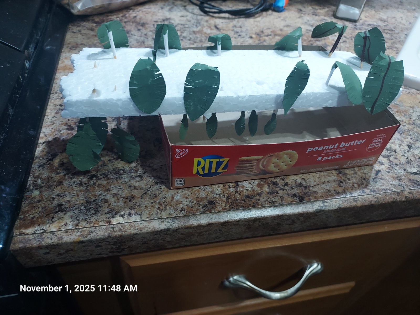

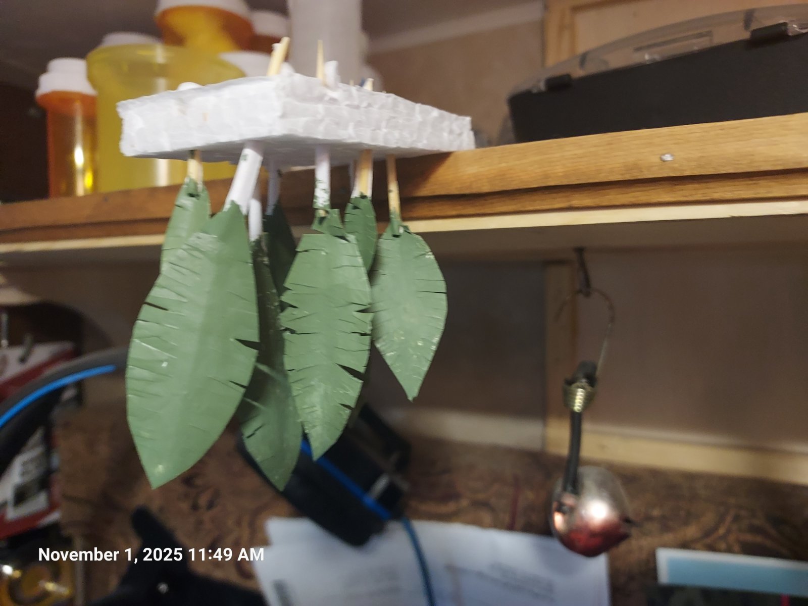

Here are the ferns so far. Cut them out of paper. I still need to fluff the edges and figure out leaf vein color i have seen brown and yellow. But not sure if i like brown or not.
One trick i taught myself is that the leaves droop once wet w paint, so for some of them i mixed the paint w pva glue and then hung them upside down. When they dry they stand up.

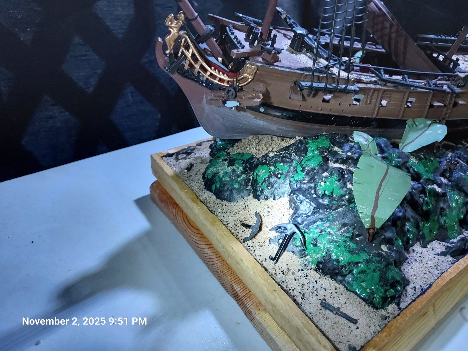

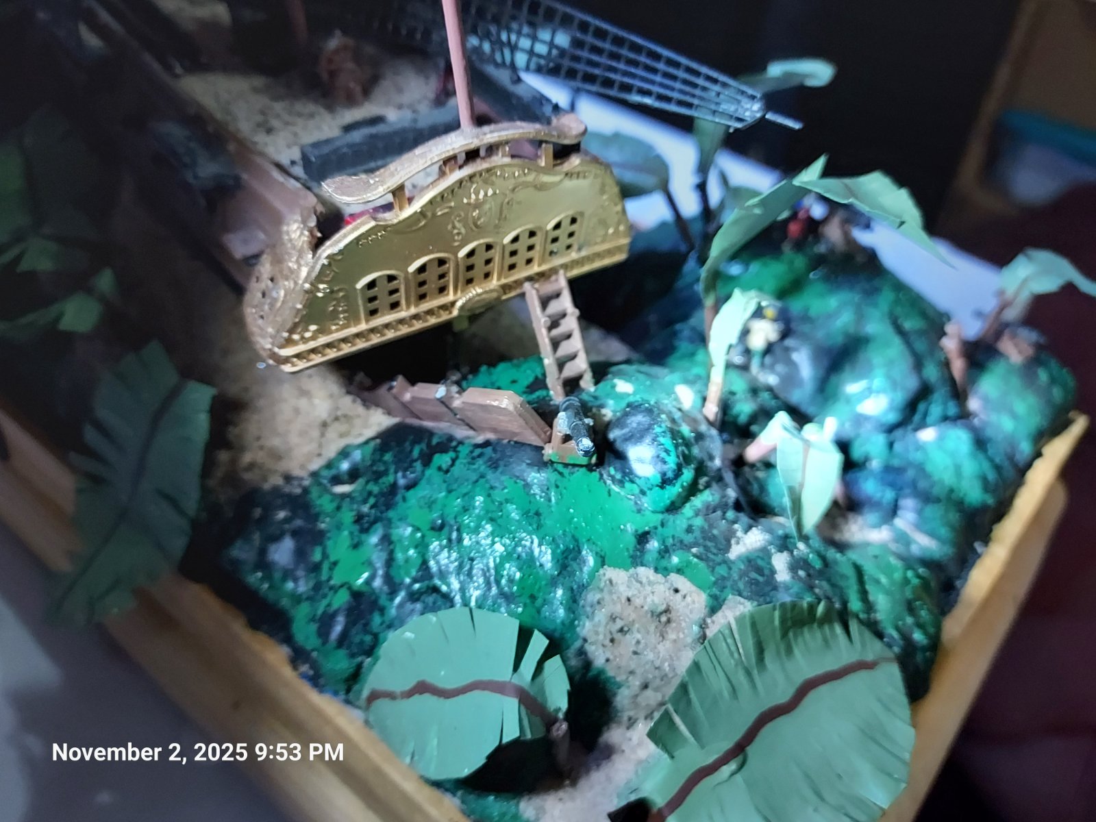

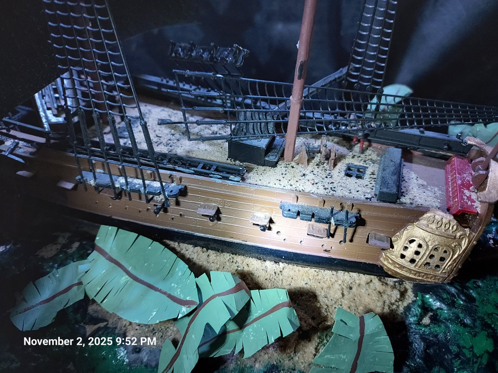

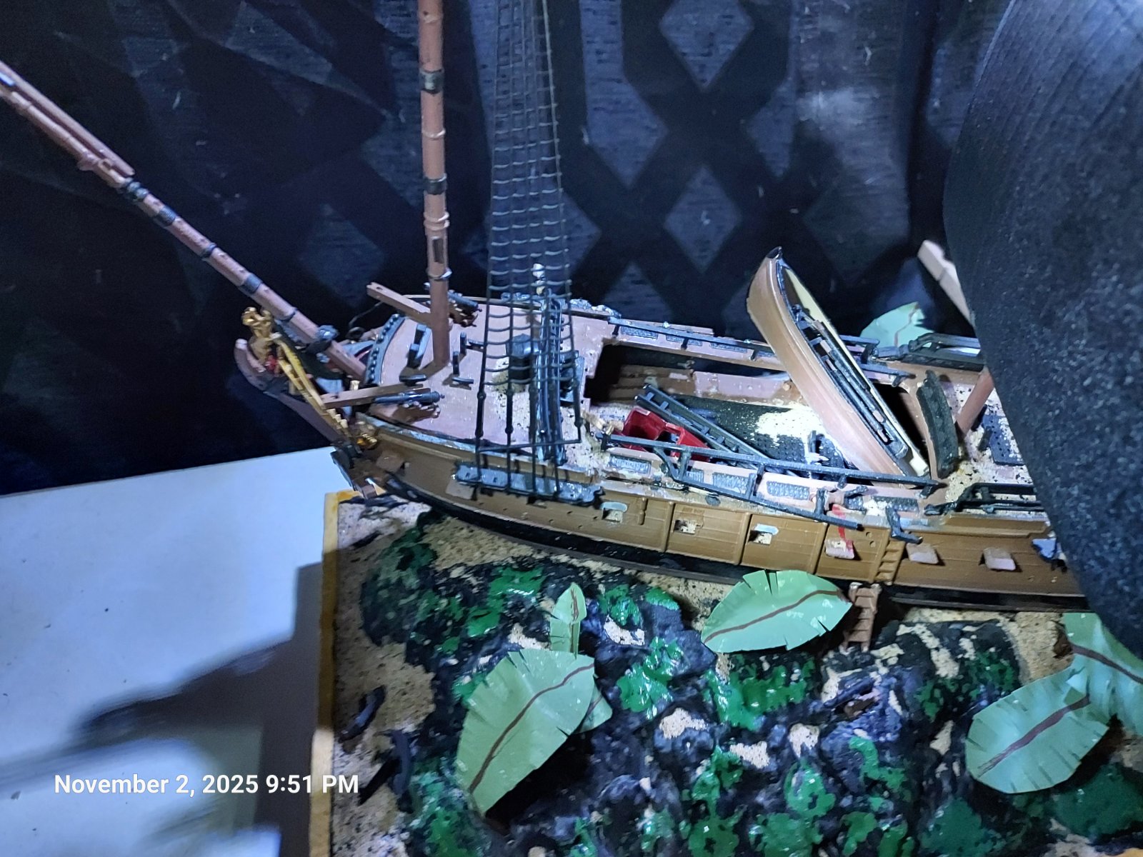

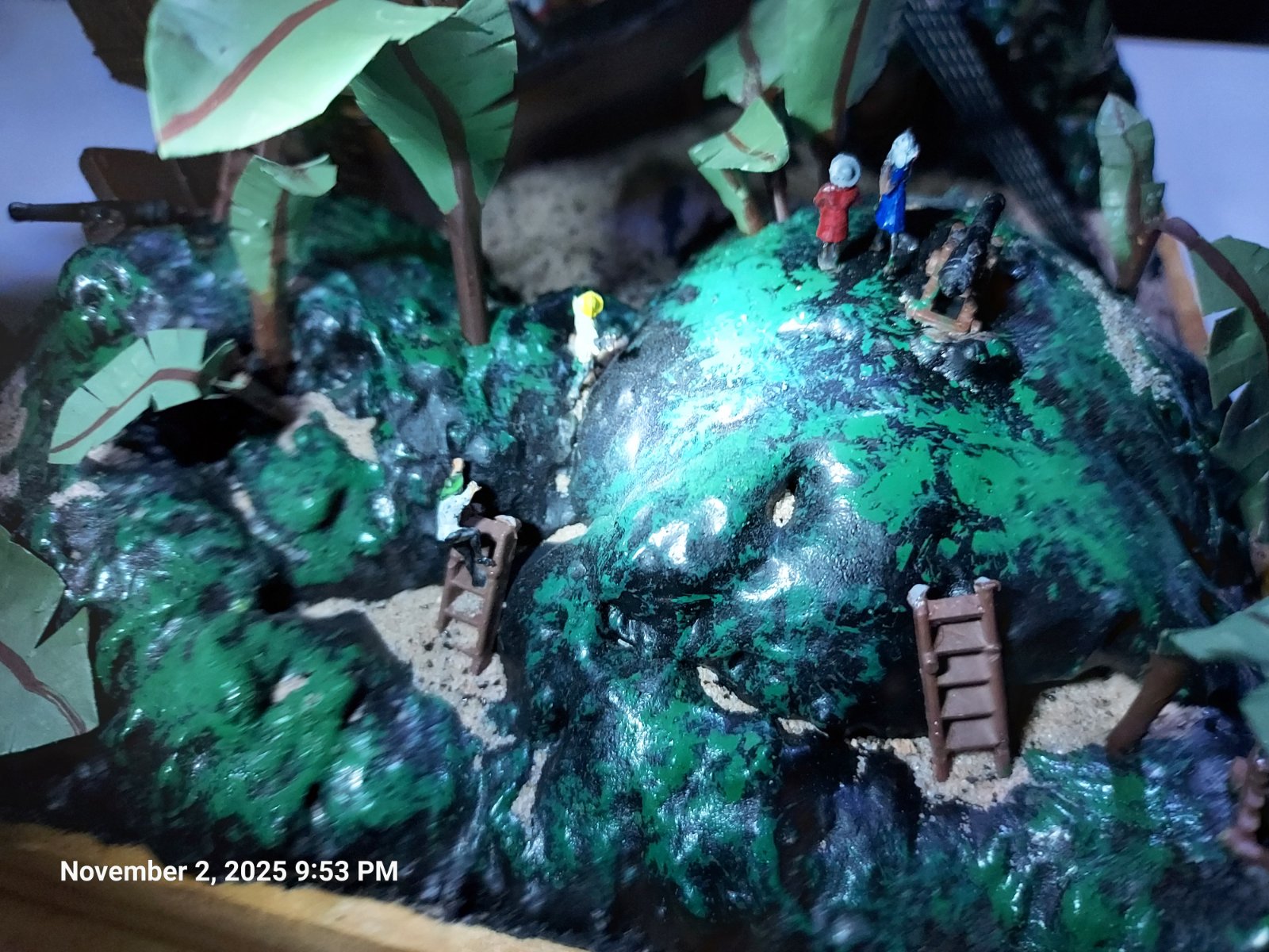

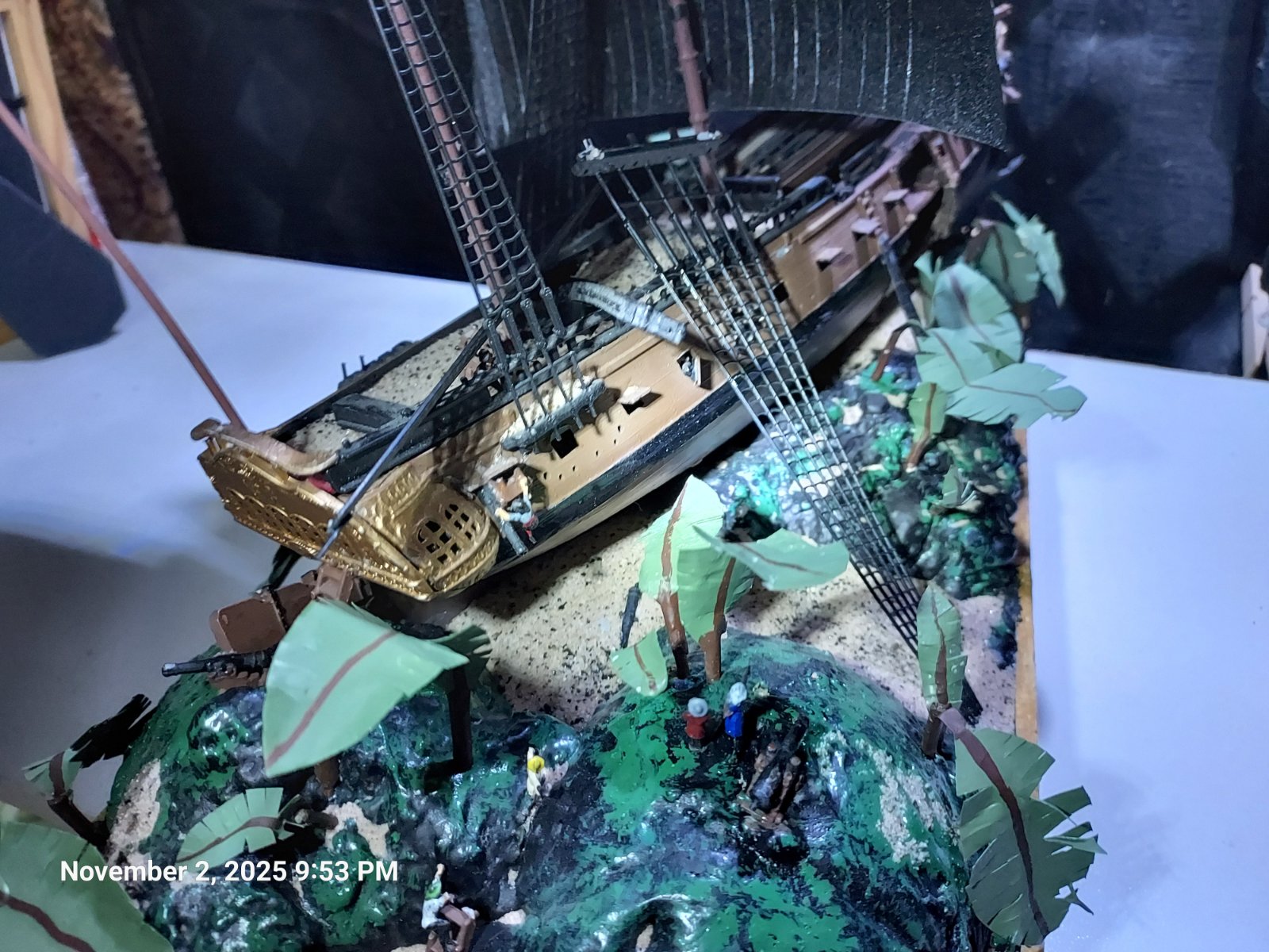

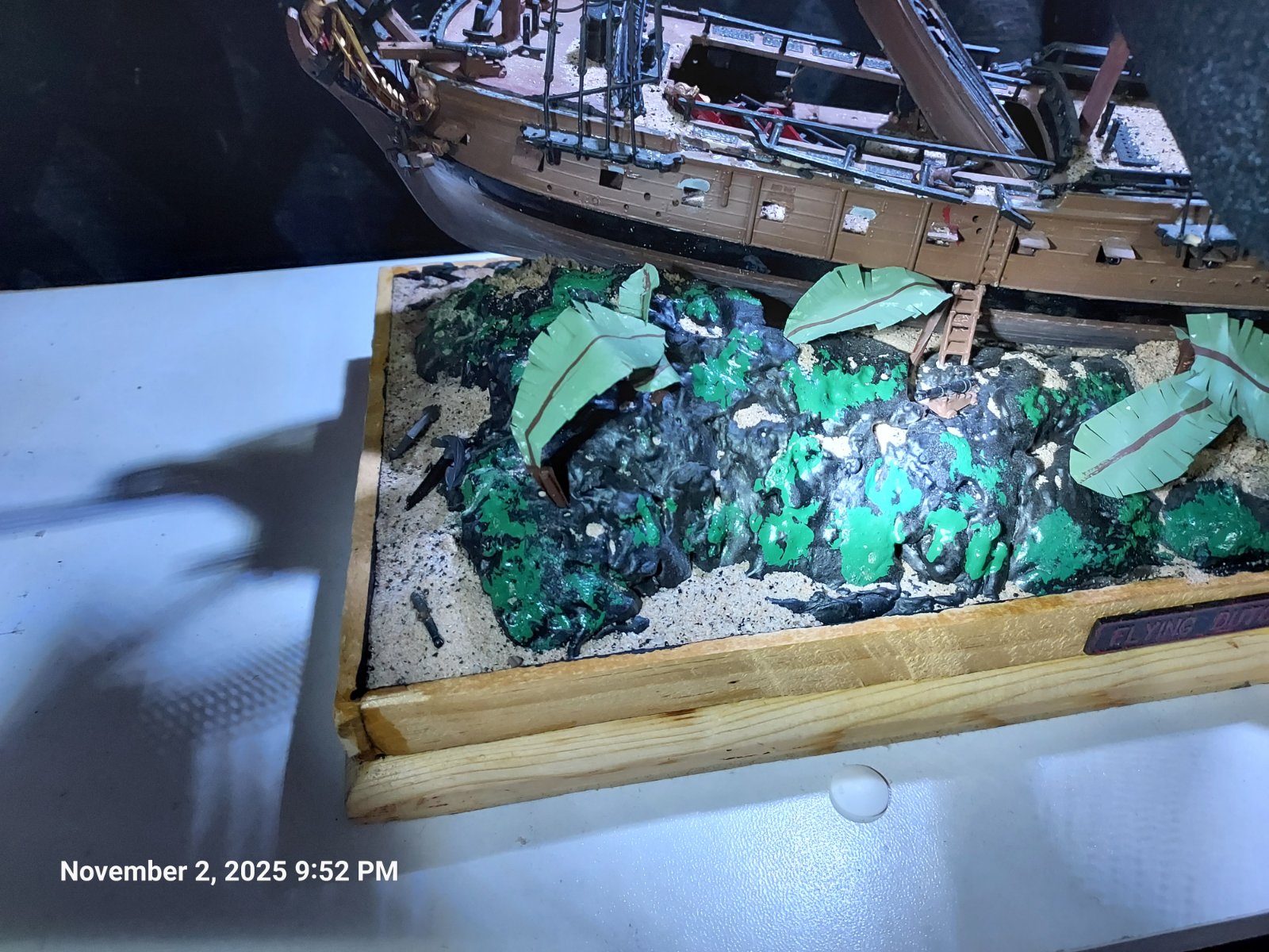

I think it would look better if i had some grass texture, one day when i get some (or make some) ill add it. It also would be nice to be able to keep the sand in place. The bottom layer is glued but the top layer is lose sand. I thought about hair spray but i dont want to risk it.

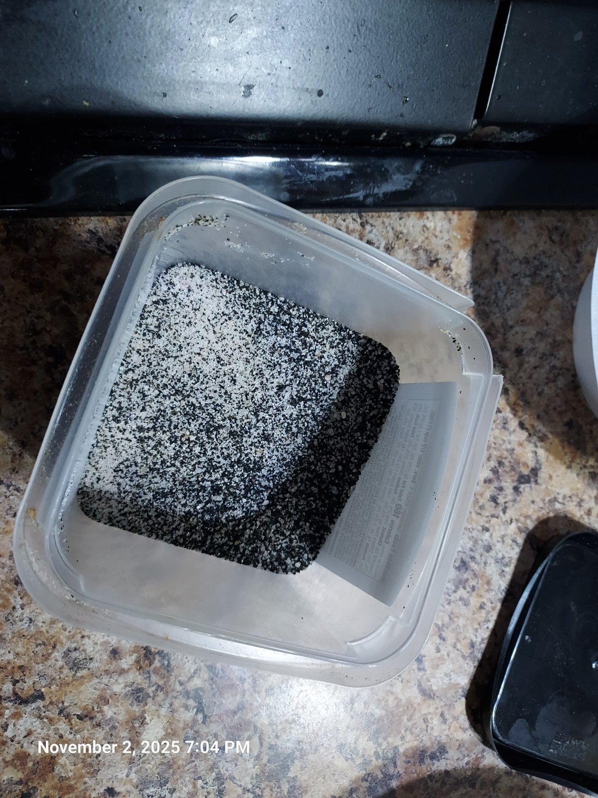

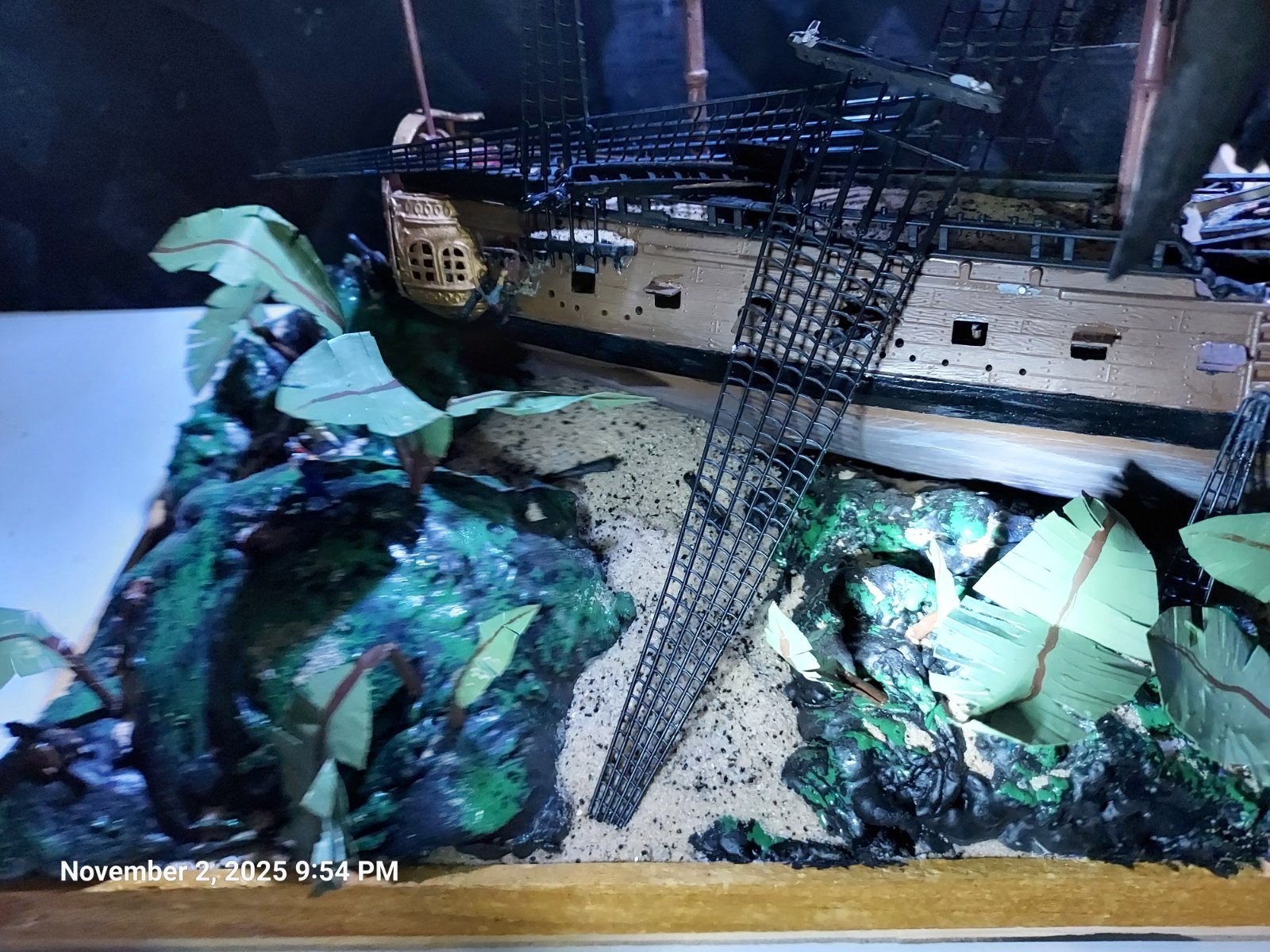

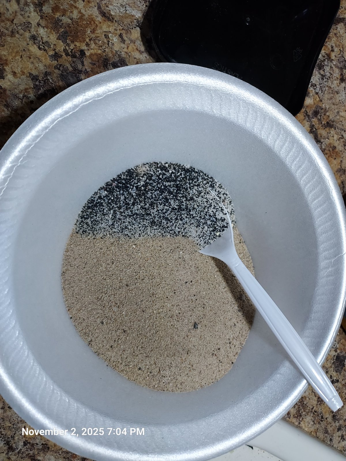

To fill the large sections of sand i had a small container left over of what i call mortar sand (the stuff you sweep into cracks of stone sidewalk, wet it and it hardens) and i mixed that 2 parts play sand to 1 part mortar sand, added just enough water to get it damp and packed it in the large sections. I hope it dries out and does not rot my wood base. If my idea works it should get really hard and dry out on its own. I suppose maybe spreading some elmers glue on the bottom first or painting the bottom may have been the way to go just in case. Alot of it has primer on it but some parts under the foam do not.
Here is a photo of play sand vrs what i call mortar sand, in the bowl is my mixture 2 to 1. In the square container is the mortar sand itself.

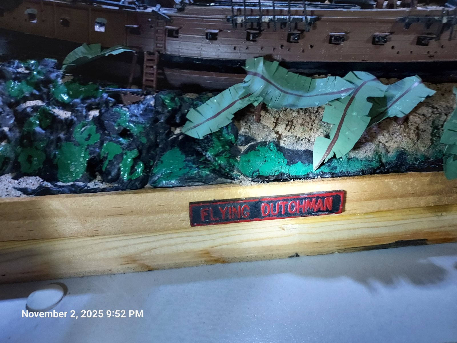

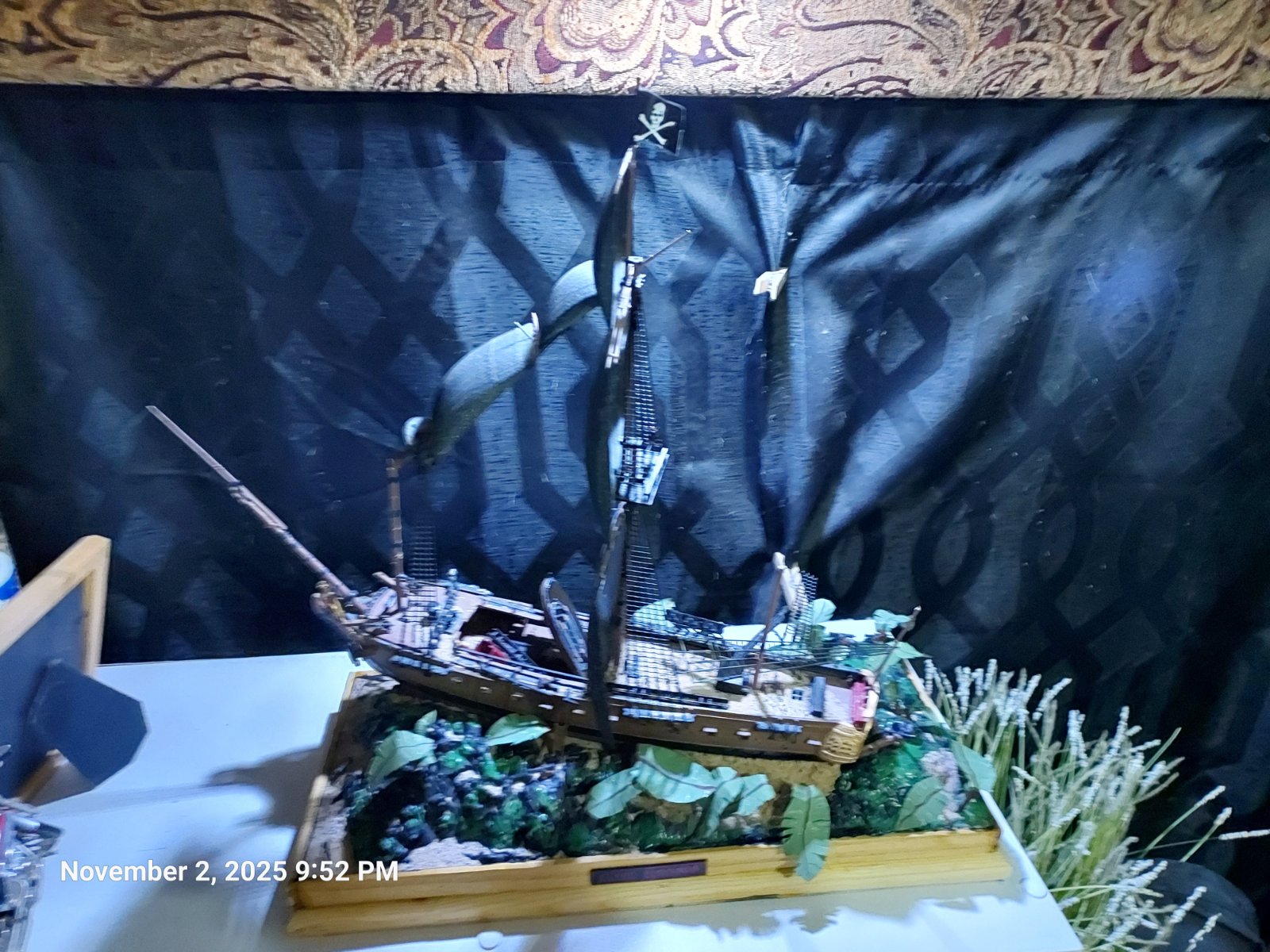

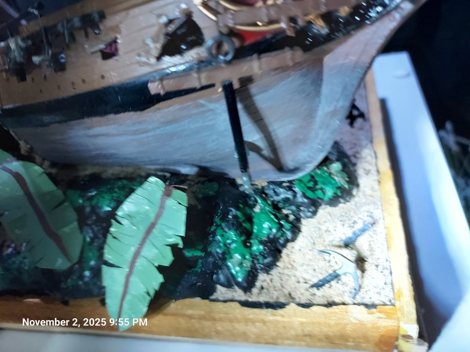

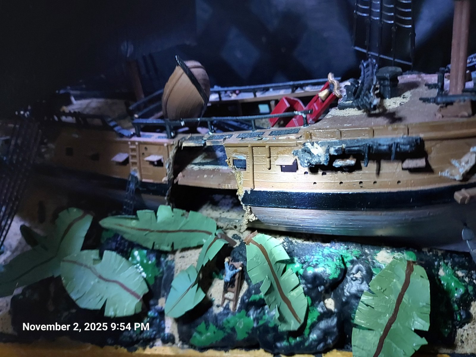

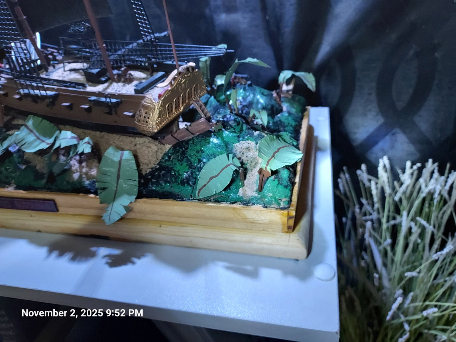

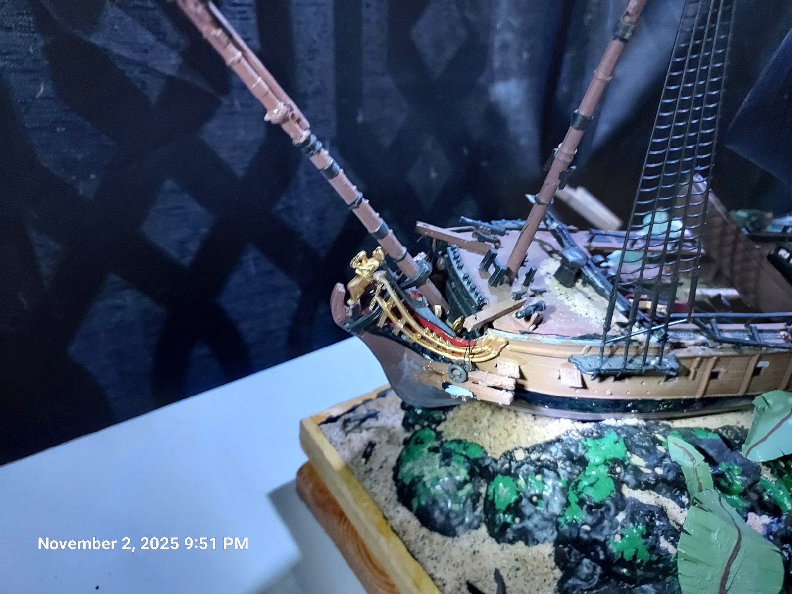

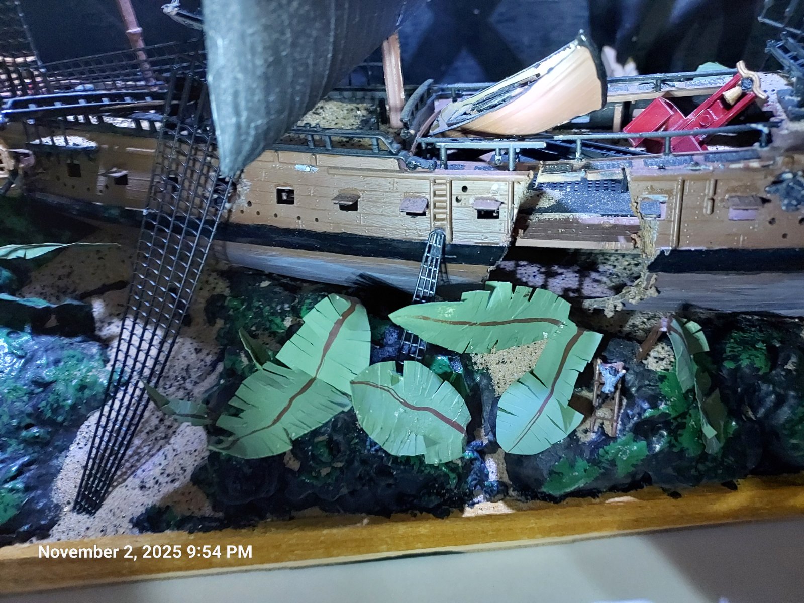

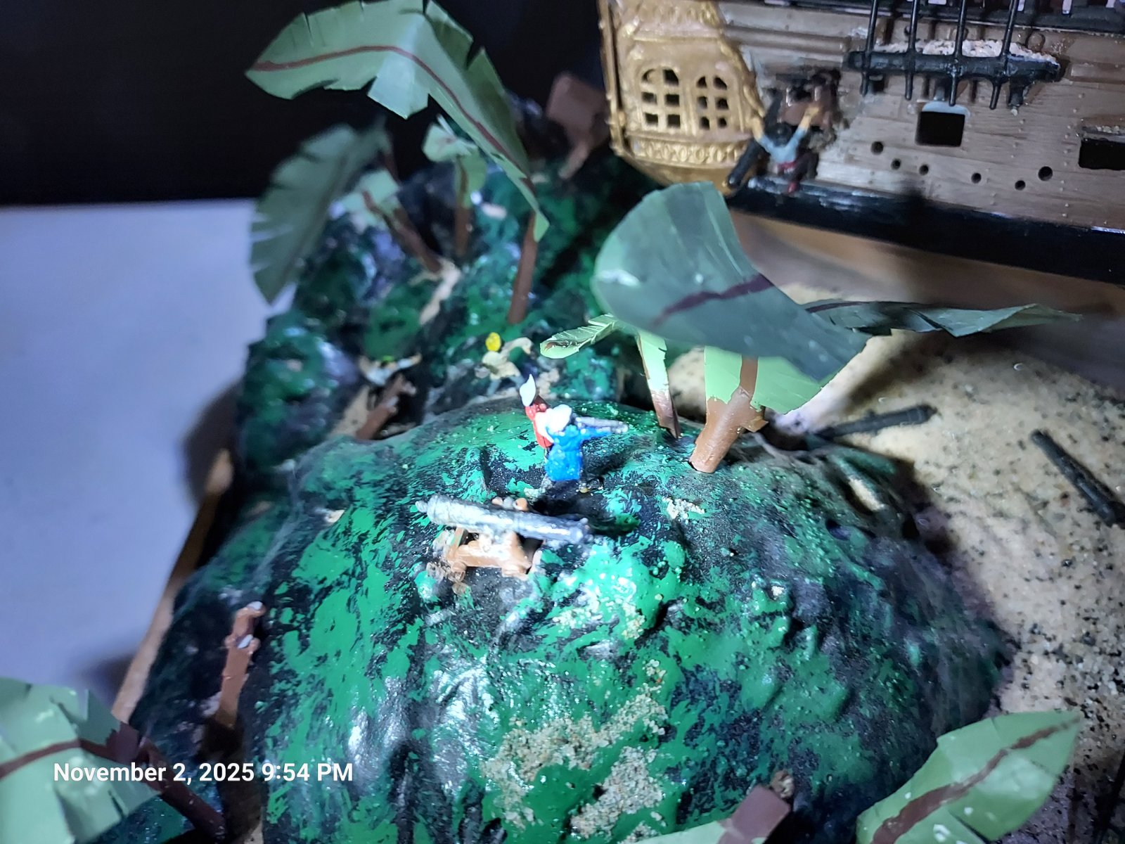

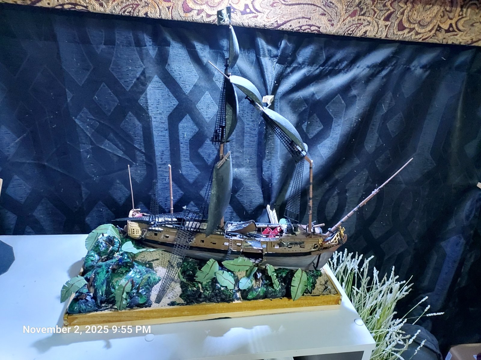

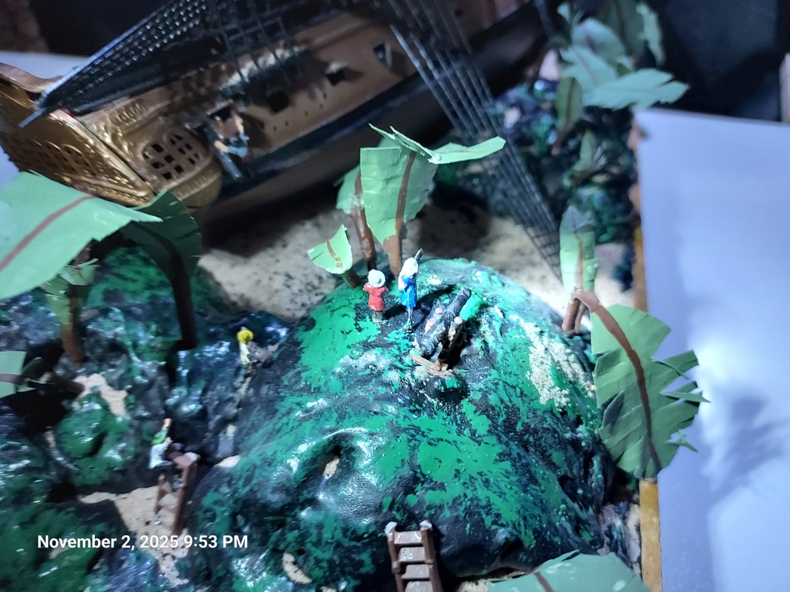

I am very happy with how it turned out, the pics dont do it justice, it looks so much better in person. :)
