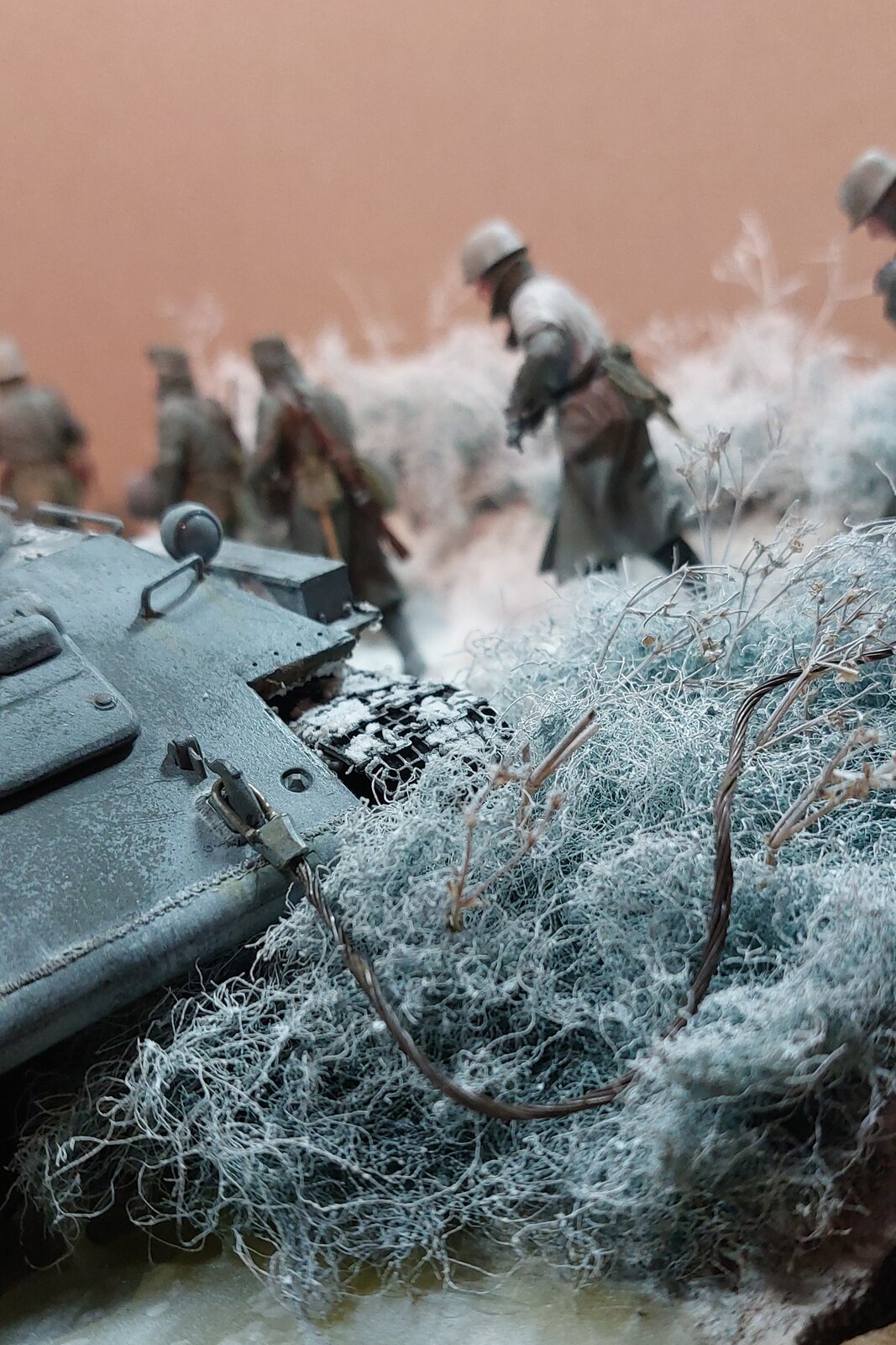

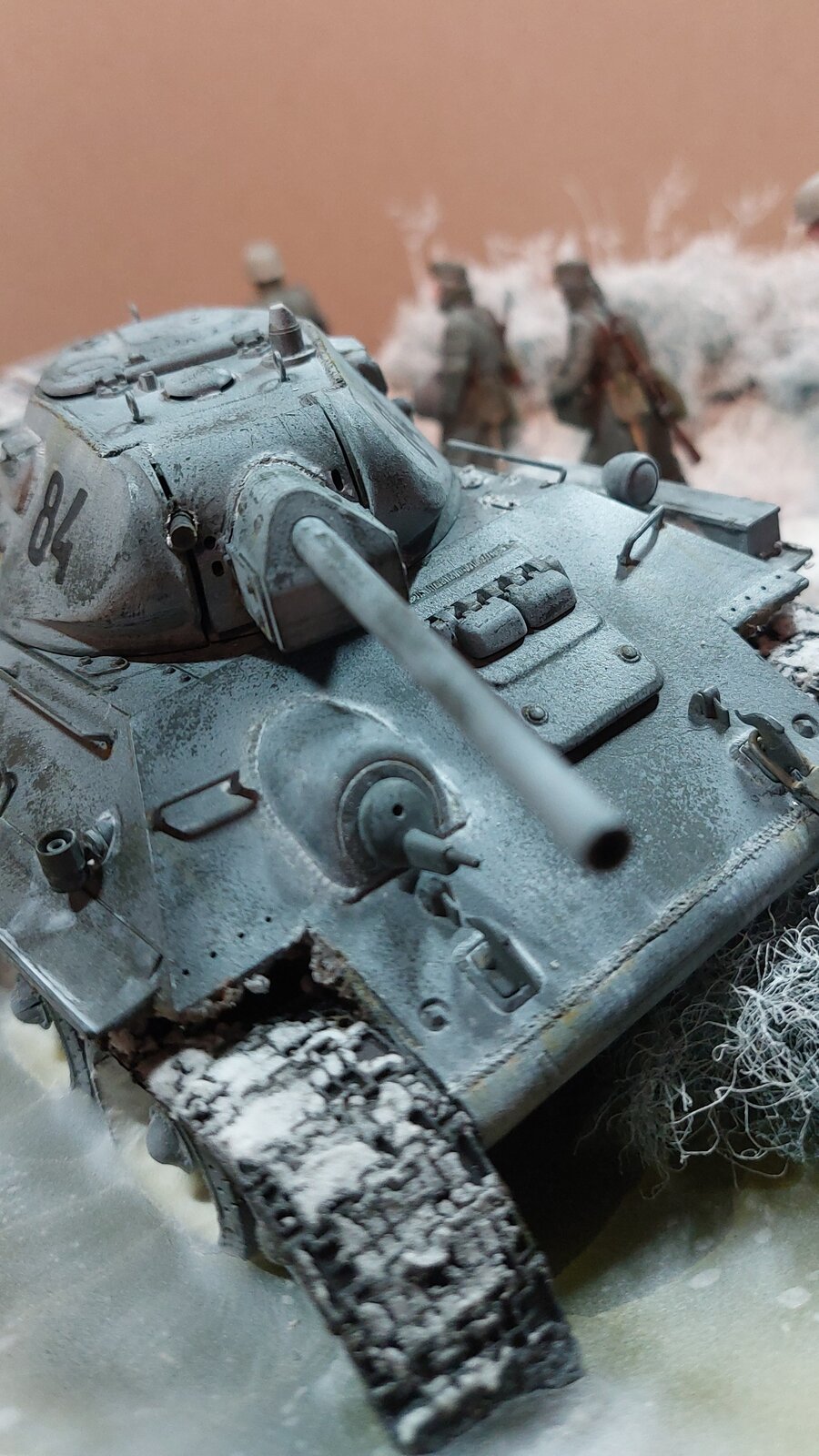

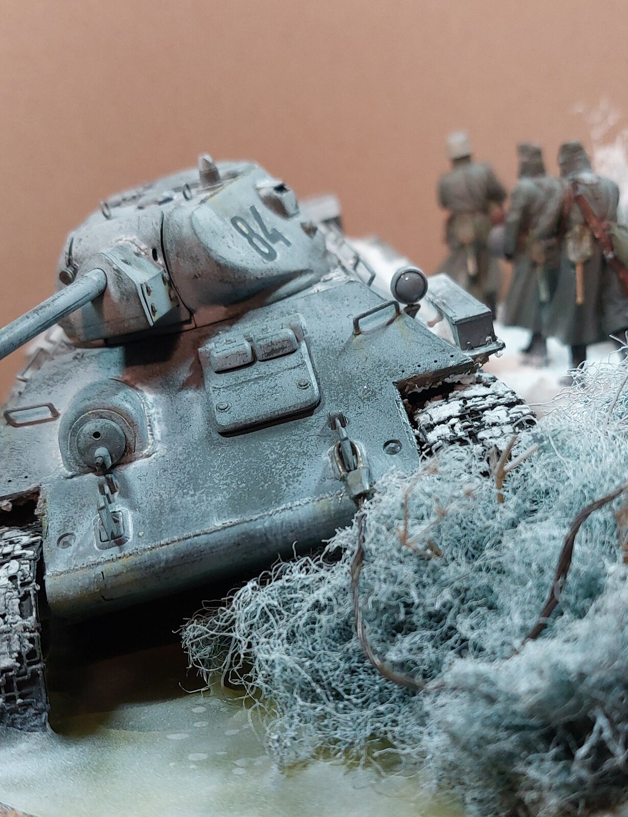

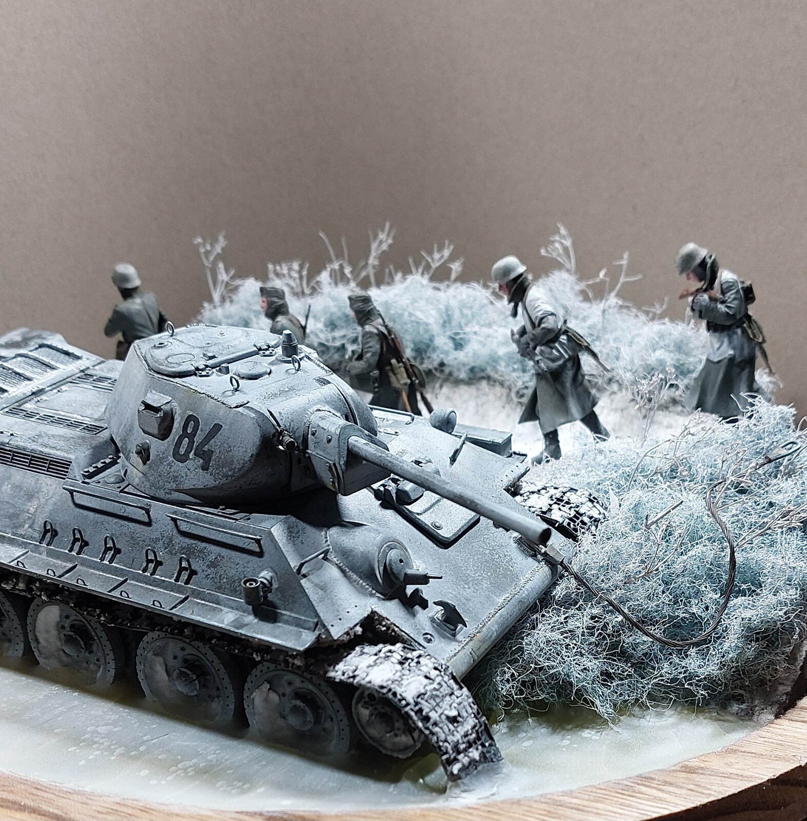

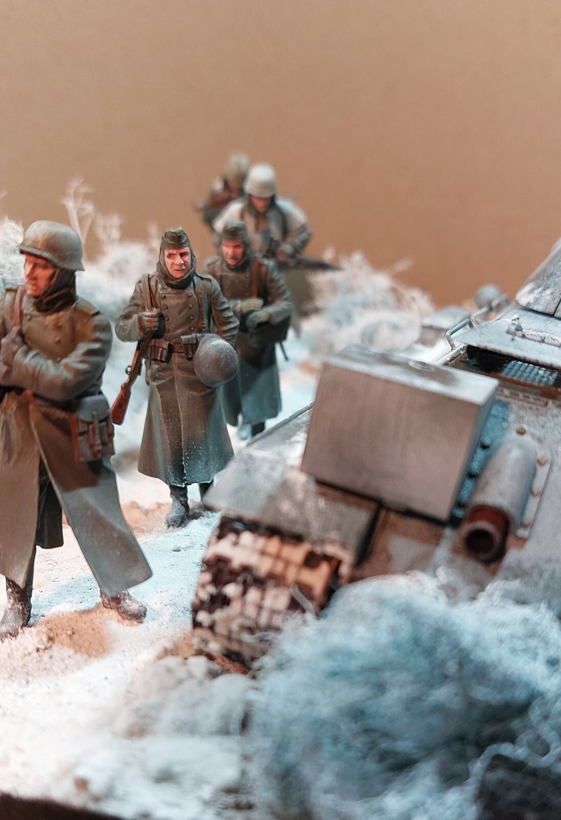

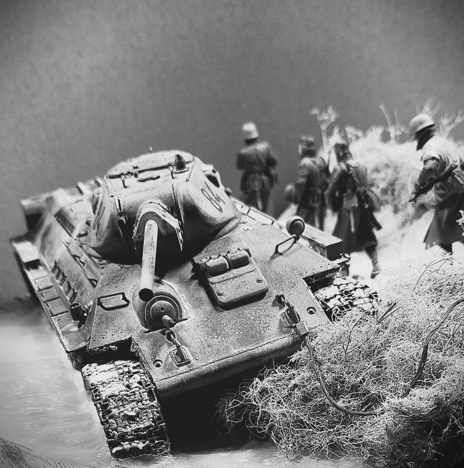

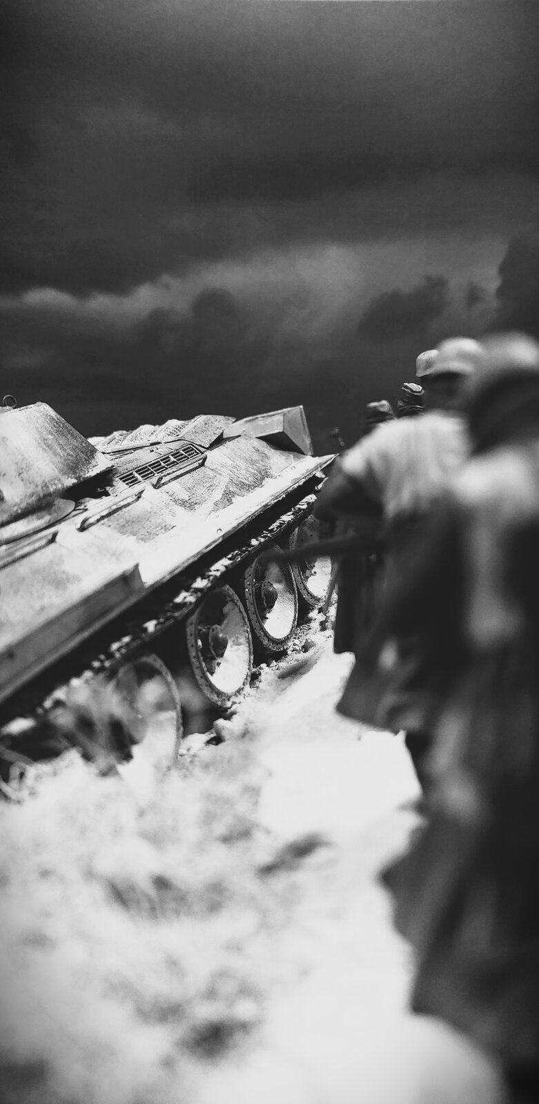

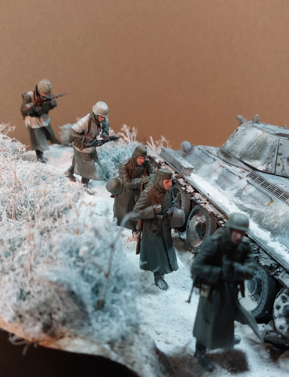

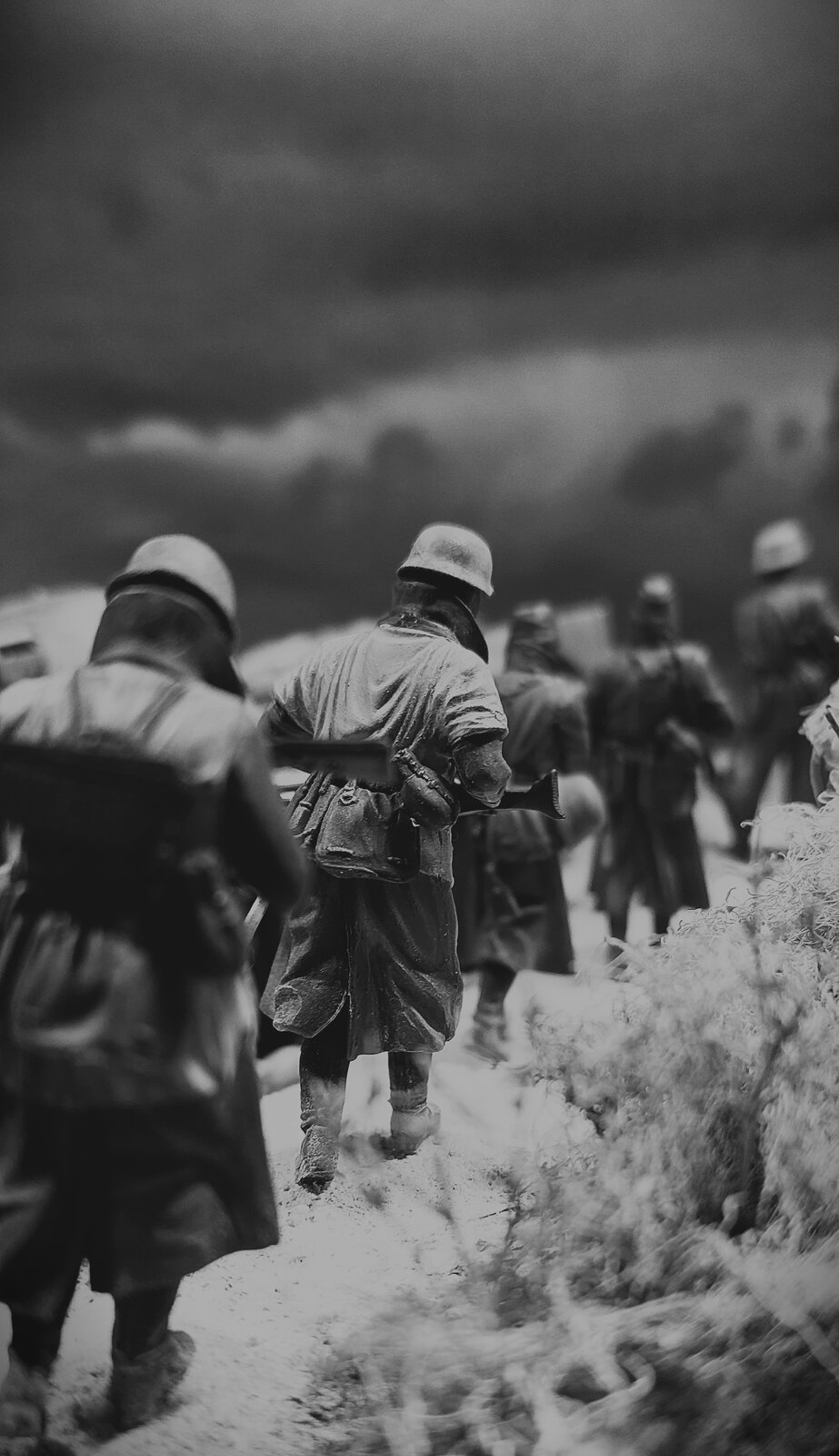

Thinking of naming this "Winter Wonderland"
It's the old Tamiya T-34/76 kit and Dragons 'Cold Wind' figure kit.
Let me know what you think of the dio and the tentative title, I'm open to suggestions for the title.

...the frost on the vegetation makes it feel even colder. That kind of cold snap chills you to the bone.
I like the tracks frozen in the ice, the colour and opaqueness of which is very well done!
Not sure about the title, don't think those guys are appreciating the 'wonder' of it all...
I love it!
What did you use for the snow? I've been messing around with white tile grout and while the gran is acceptable it is too yellow for my taste
Take that from a Canadian, he would know :-)
As each addition of the groundwork is attached to the base, I mist/dust the base with rattle can white primer from about 24-30 inches. The point is not to get too heavy a covering at on at one time. I dusted the base. I added the ground cover and dusted it again. Then the plants protruding from the ground cover, 3rd dusting, you get the idea.... light build up of almost dry paint when it hits. It creates a fine granular texture as well as turning it all white.
The final 'clumped' snow is done with lightweight spackling compound.
