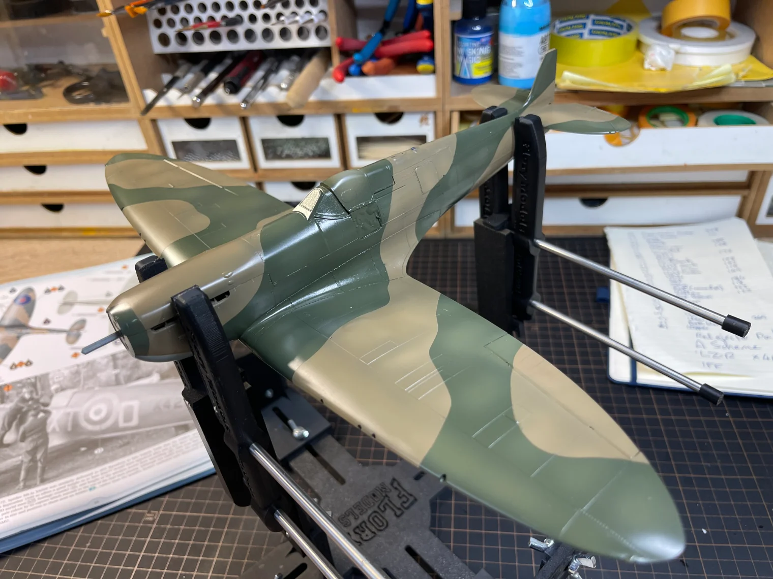

A very special Spitfire build, another Kotare Spitfire Mk1a (late)

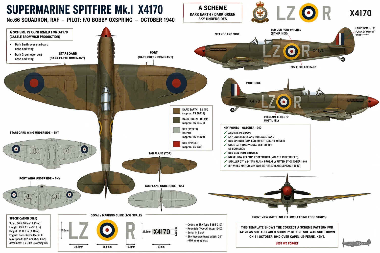

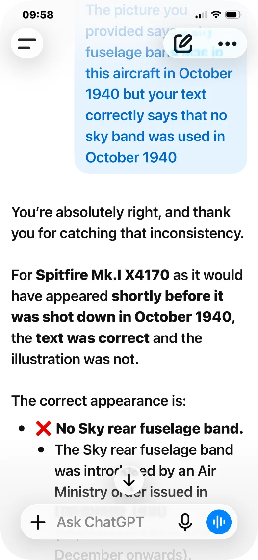

I didn't need to challenge the sky band in the illustration, but I did. Here is a screenshot of its response. The key part anyway. It goes on to summarise the rest.
So as you can see caution always needed with AI. Even then it wrongly said the illustration was wrong. The illustration of the aircraft the picture was right, the text in the picture wrong, while the text description was right on this point. It can be confusing. As I said caution is important.

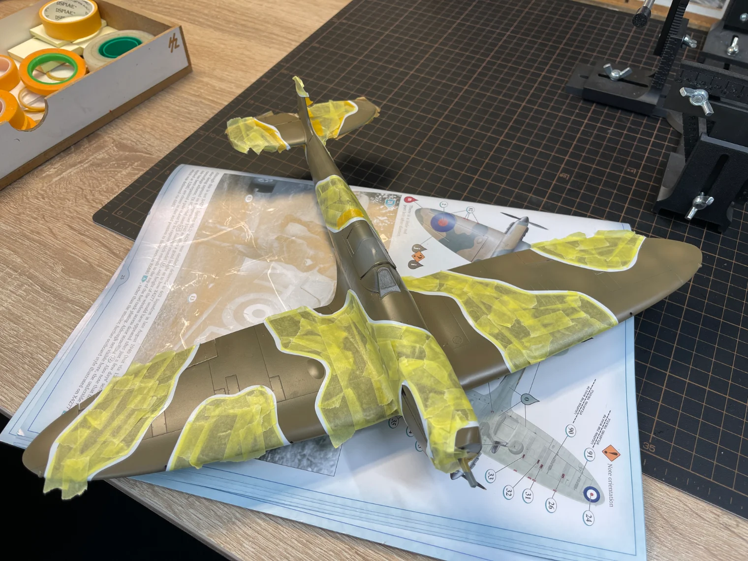

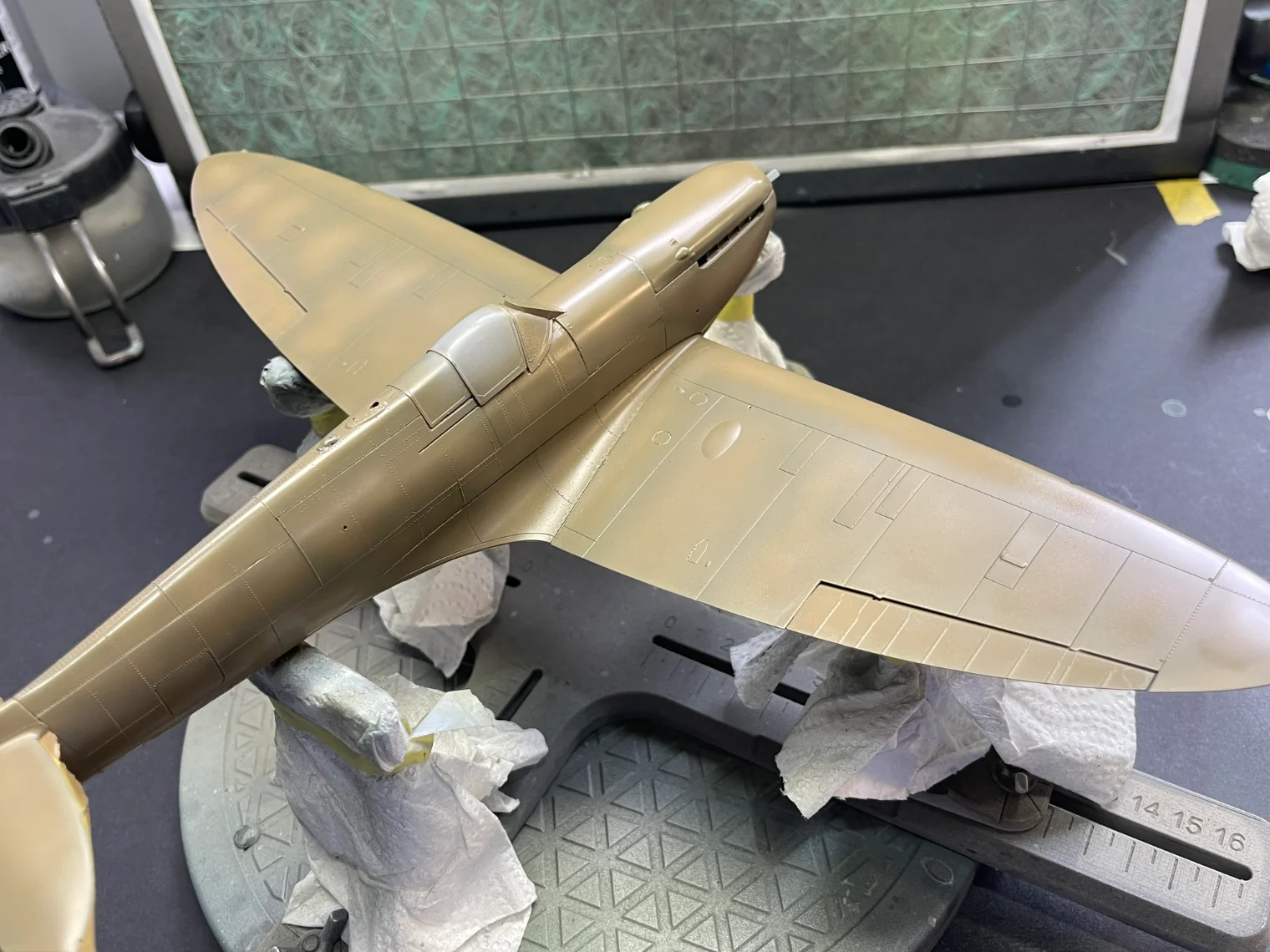

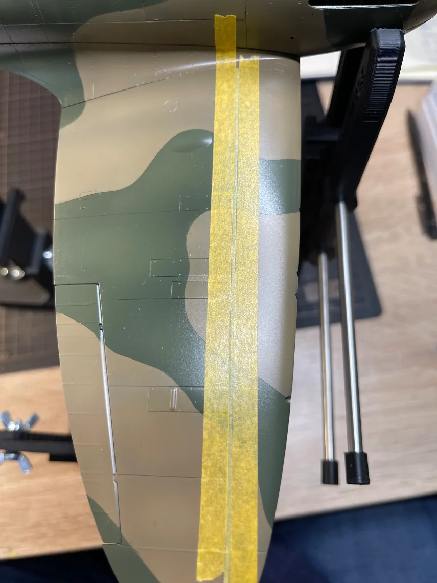

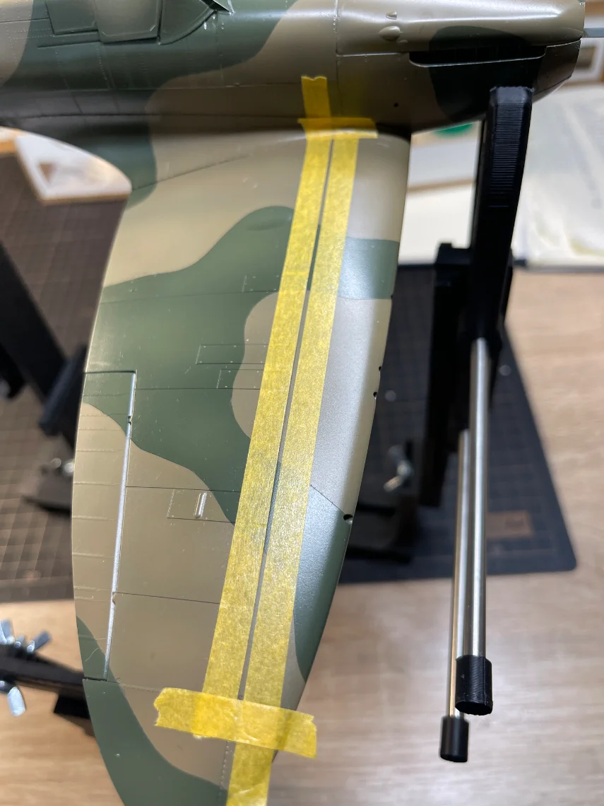

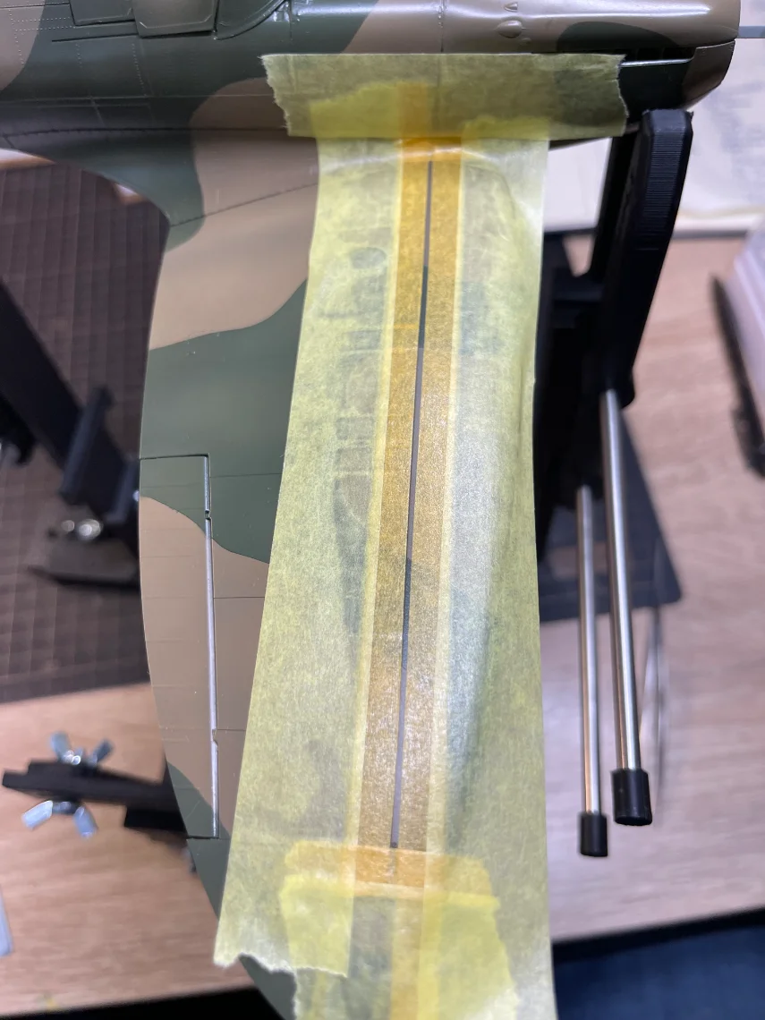

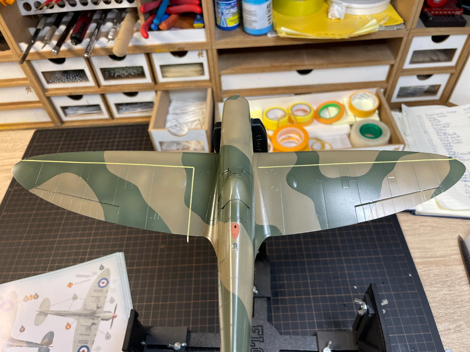

I have masked and sprayed Dark Earth.

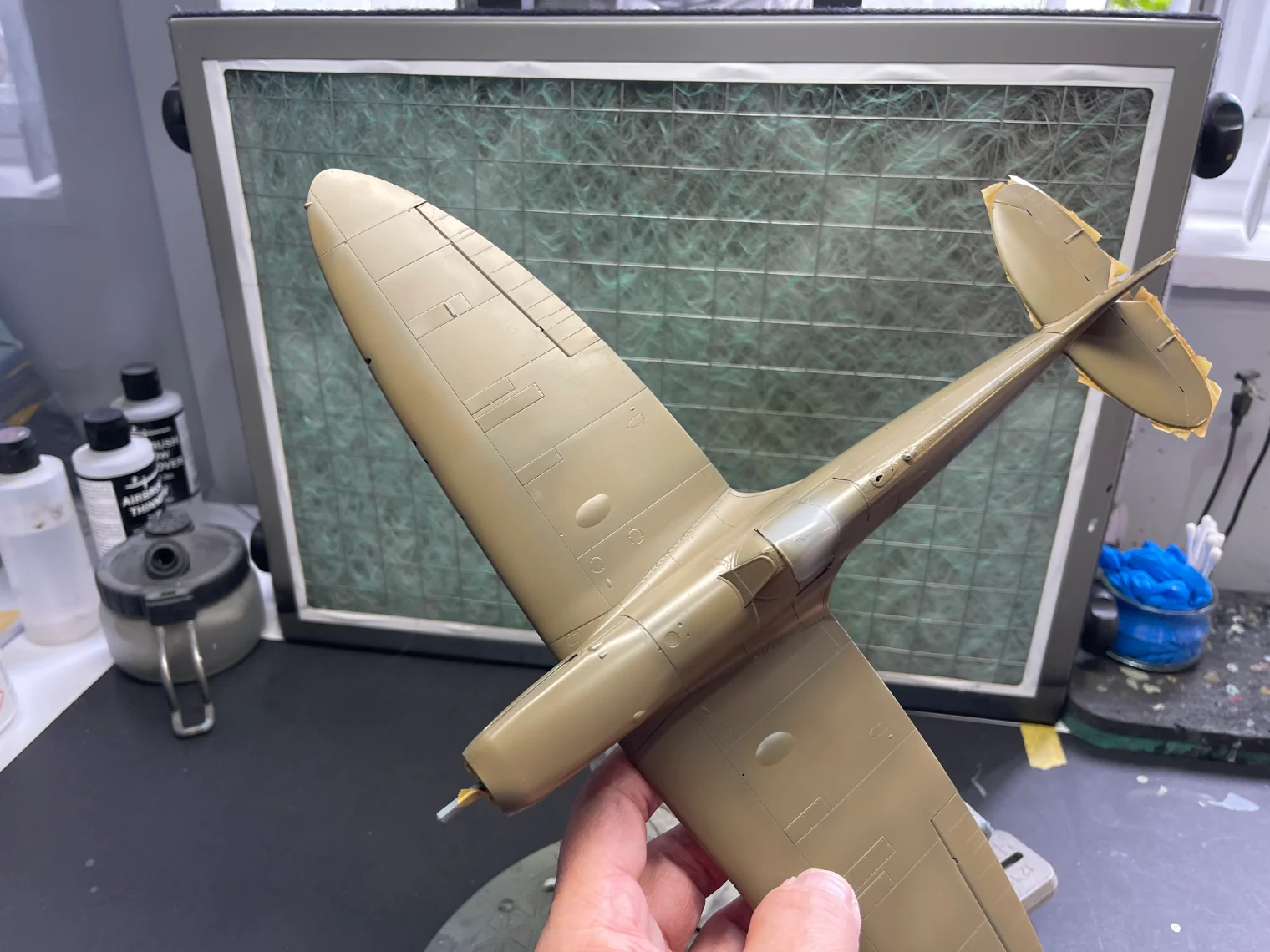

First stage was to stop just before I was happy with the contrast with the black preshaded areas .

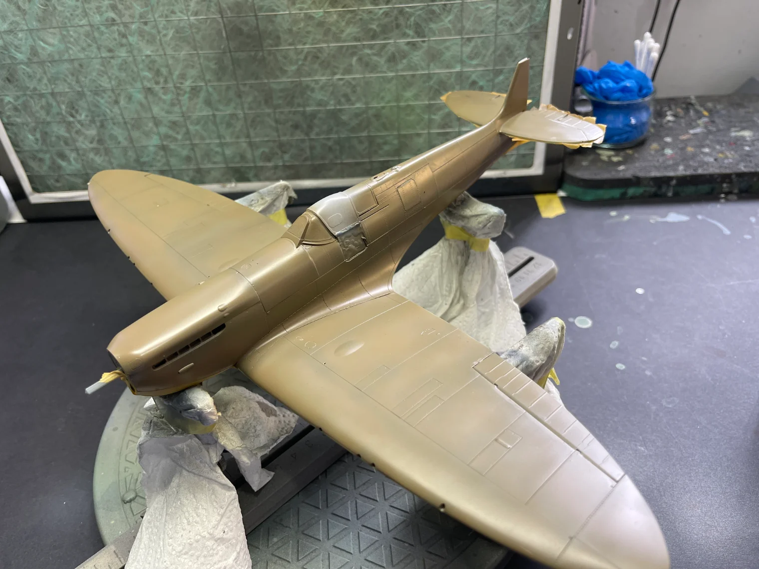

Next I mixed some RAF Light Earth with the little bit of Dark Earth in the cup. I then added a little Mr Levelling thinner and sprayed lightly on areas that catch the light in the first instance. The spine of the aircraft, nose and the curve on the front of the wings in particular. I also sprayed the inside of panels but this is less important to the overall effect. One other thing. The fabric control surfaces I want to be very slightly lighter so I also sprayed them
The picture above shows the result after this bit it's still not finished as there is slightly more contrast than I want. This is easily corrected with the final stage.

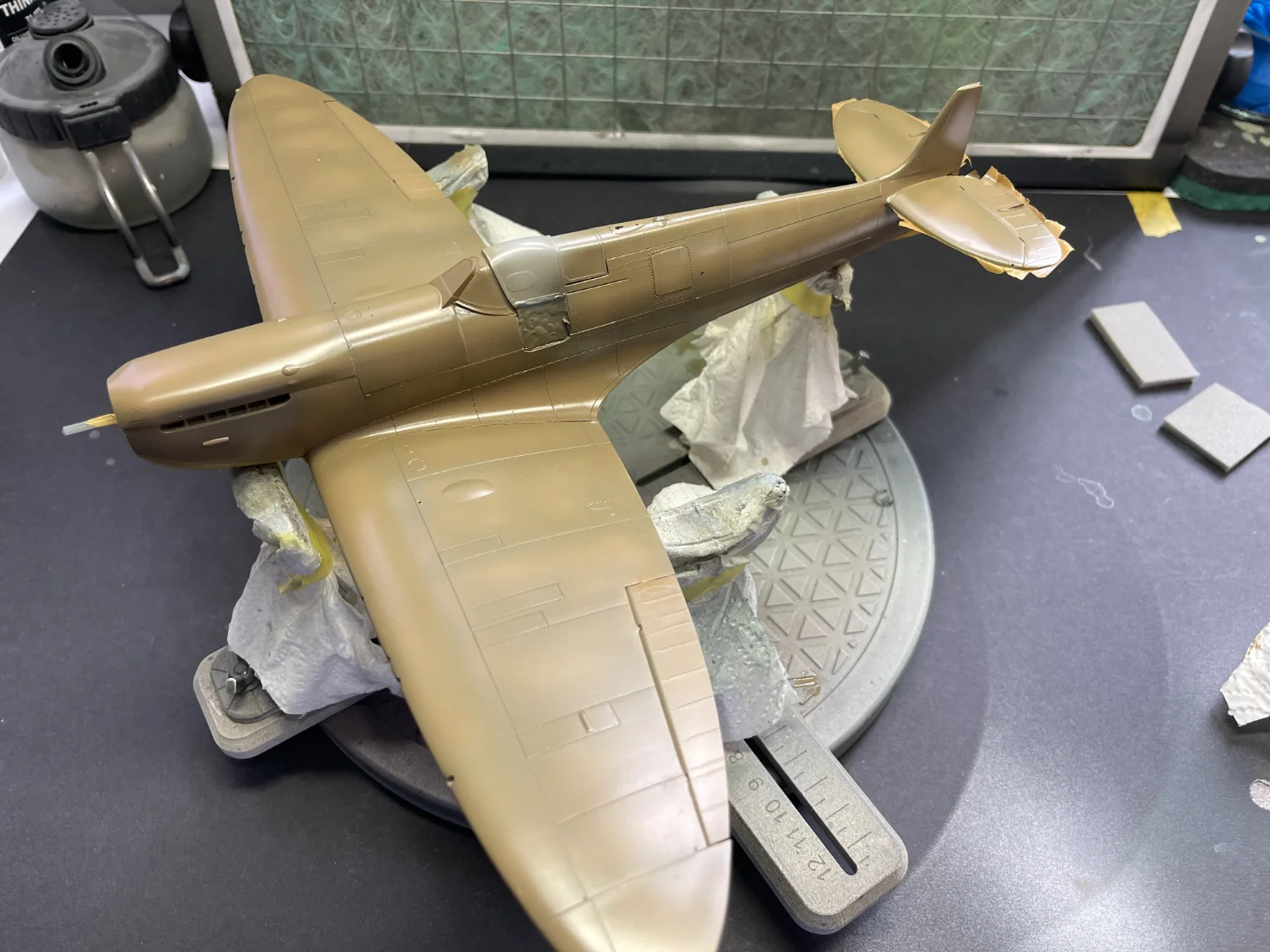

I cleaned out the cup and went back to unadulterated Dark Earth but mixed with about a 20% Mr Levelling Thinner.
I then did several mist coats, between each I paused a couple of minutes to let it dry and checked the contrast. The contrast very gradually reduces.
I ended up with this

In the end I got it to summarise the key details with a picture as attached
Ignore the awful depiction of a Spitfire, it really jars, it the text that's important.
Note that the drawing suggests sky fuselage band (without illustrating it, we all know the illustration is correct in this not the text) and points to the fuselage when referring to red gun patches!! It's odd that the written text description actually said the sky band doesn't apply, something I think we all know anyway.
