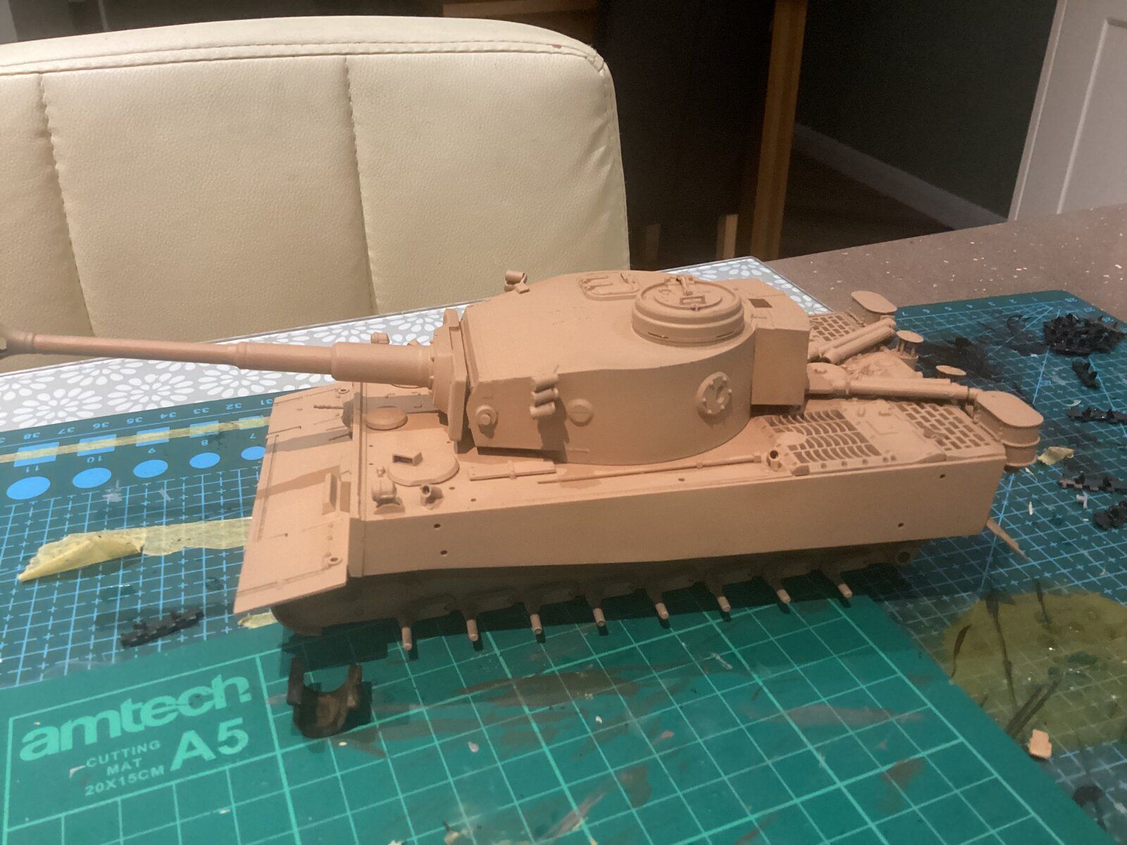

Hi I'm sorry for all questions but am new to this, I am making tiger 1 in Sicily colour ral 8202 , I am going to weather it but the colour looks like it has just come off the spru , so any ideas to make it a bit more realistic?

Have to agree with bear, one or more washes will do the trick. Allow a little while to dry thoroughly before adding a second wash if it's needed. Pantherman

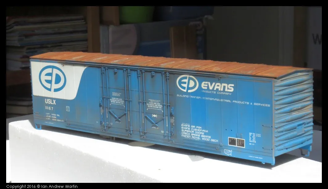

Fade the paint first, by spraying several highlights of white (90%+) thinner to paint on the model. You can do this with a brush too. Just make sure to get one that is wide enough for the job. I prefer pastry brushes (about an inch and a bit wide) to do this.
Don't make it too uniform. Paint fades as it will, and randomness is part of that "correct" look. Here is an example of my 1/48th-scale US freight car. It takes a while by hand, but I get better results (more randomness) than if I spray. Note, this was an as-bought car, already painted and decalled.

So a wash will tone down that brightness for certain and from there you can go forward.
Get a sheet of plasticard and use that to experiment with before you commit to the model.
