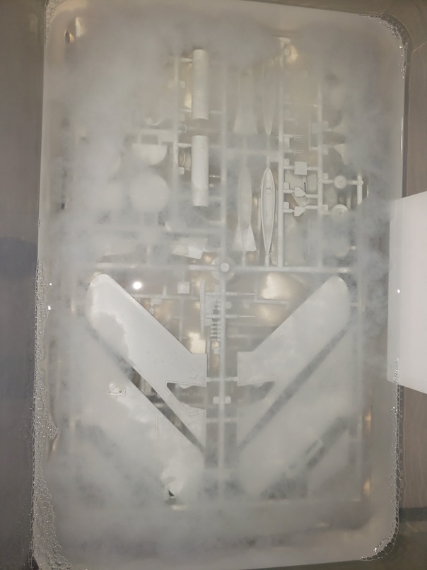

I soak the sprues, sometimes overnight, in a container filled with water and with a very small amount of Dawn dishwashing liquid then rinse the sprues in another container filled with fresh water. Usually the sprues look the same in the water after soaking, but occasionally, I've seen some thin misty wisps of grease that have been removed from the sprues. One time on an old SMER MiG-17 kit, I looked in the container after soaking overnight and it was filled with lumpy white-colored masses that came off of the sprues! After this experience, I always wash my sprues before building. I know it's extra work that most of the time is unnecessary, but I like to give myself the maximum opportunity to minimize my build and painting problems.
