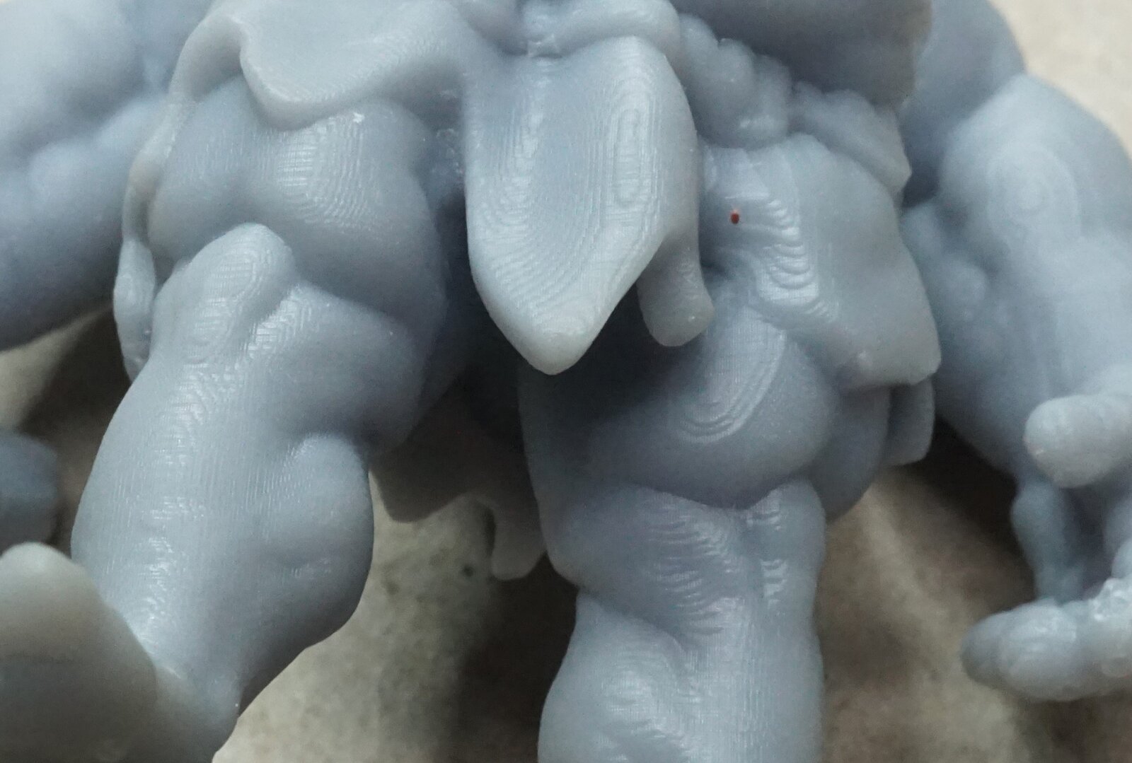

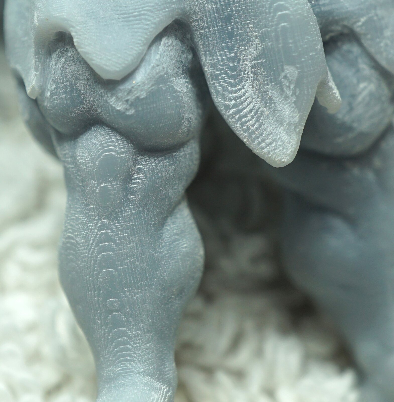

This isn't from hundredths of a millimeter in the print depth for each layer , it's from the resolution of the projected UV image :

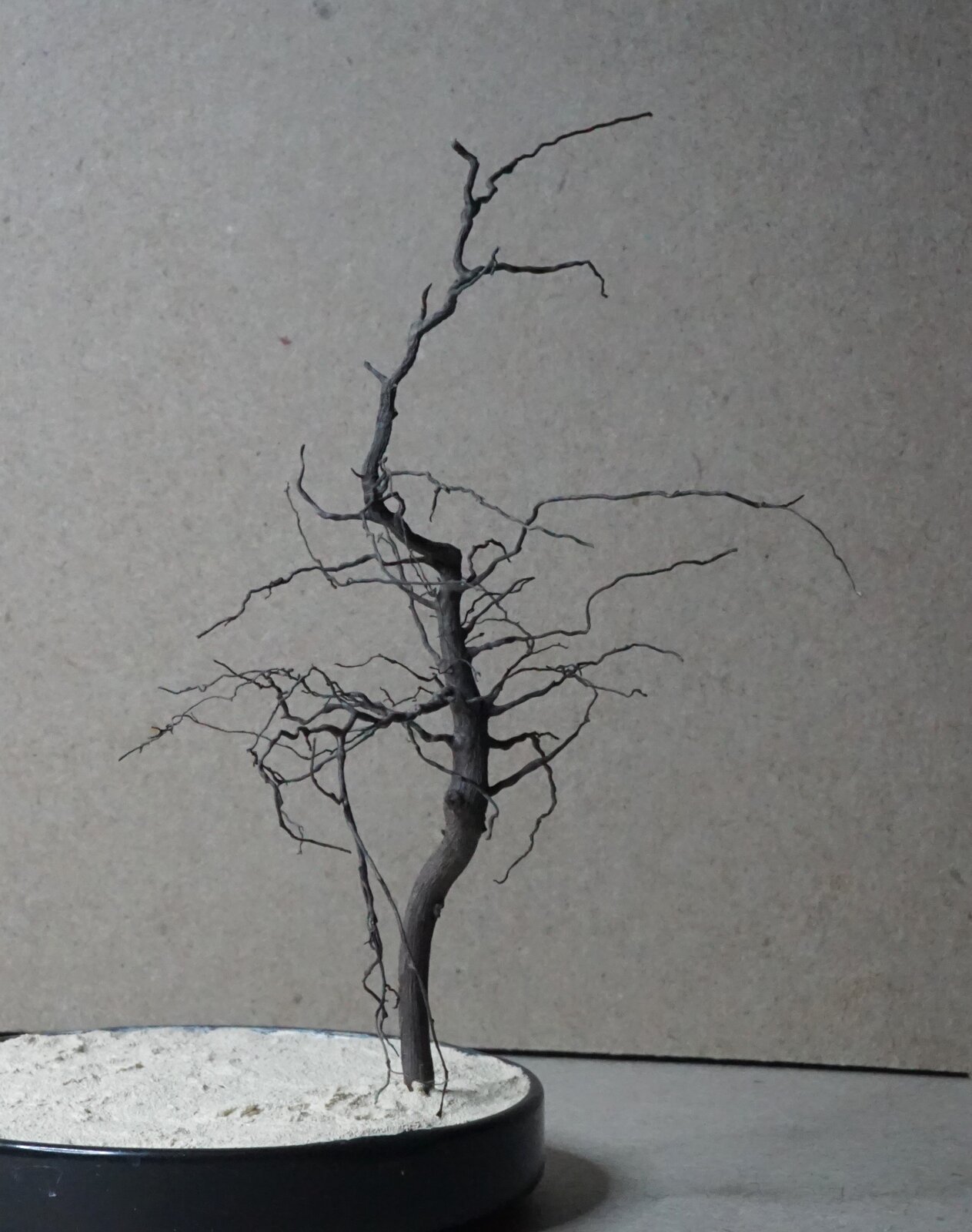

I like the shape , it looks cool from multiple angles

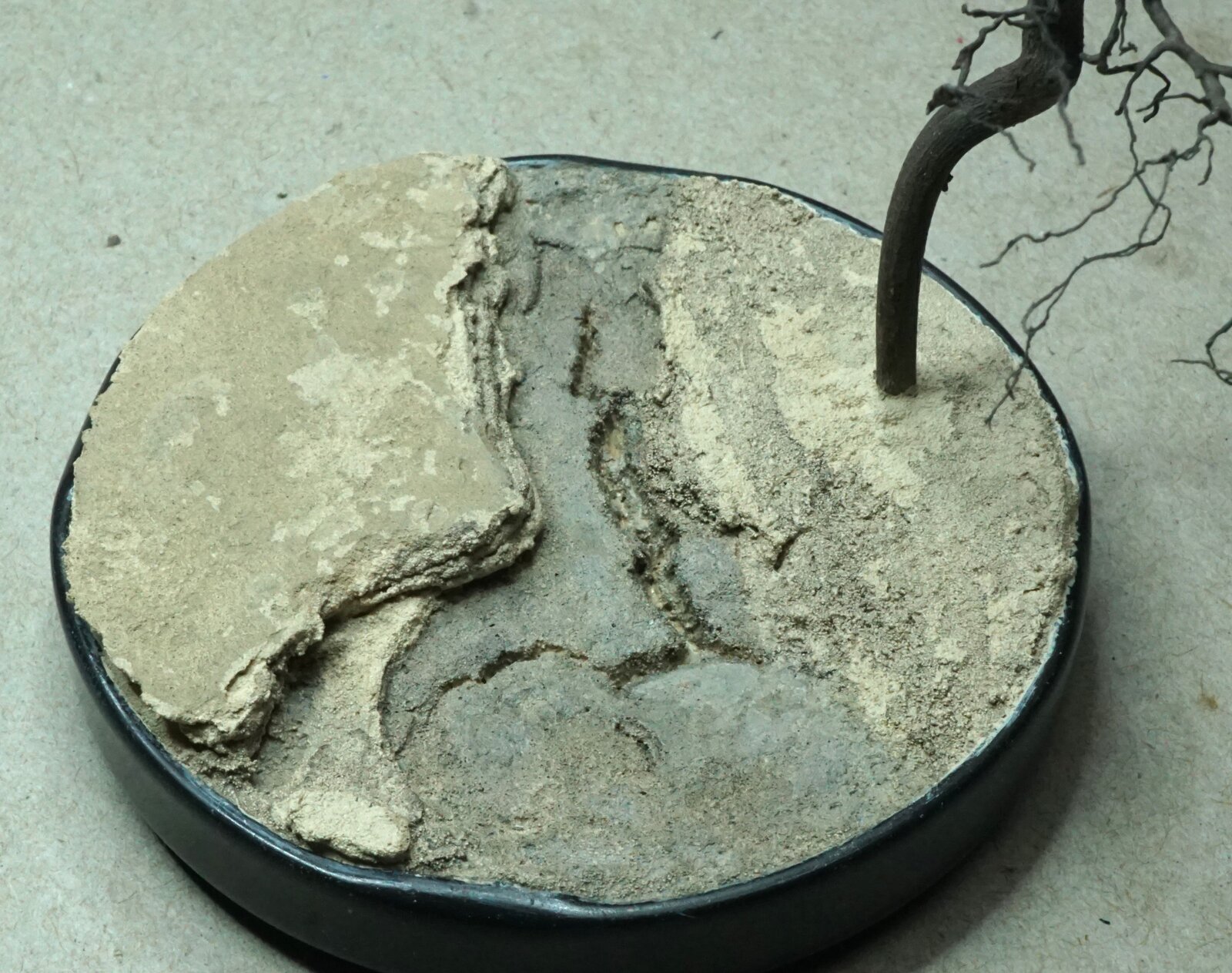

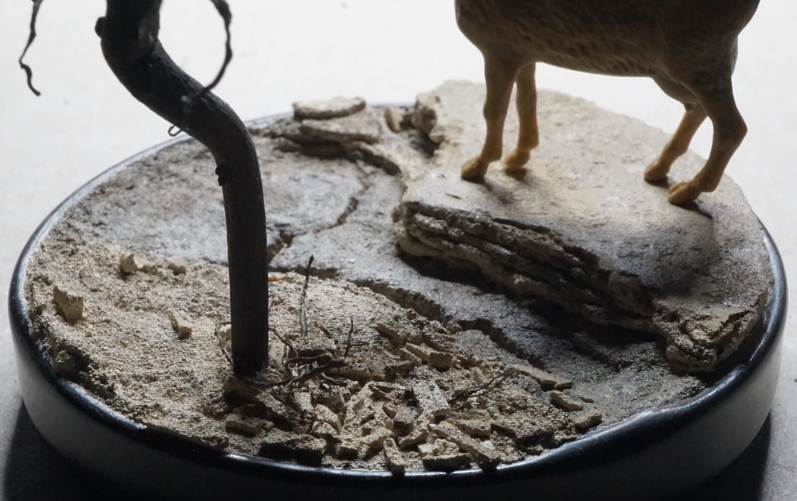

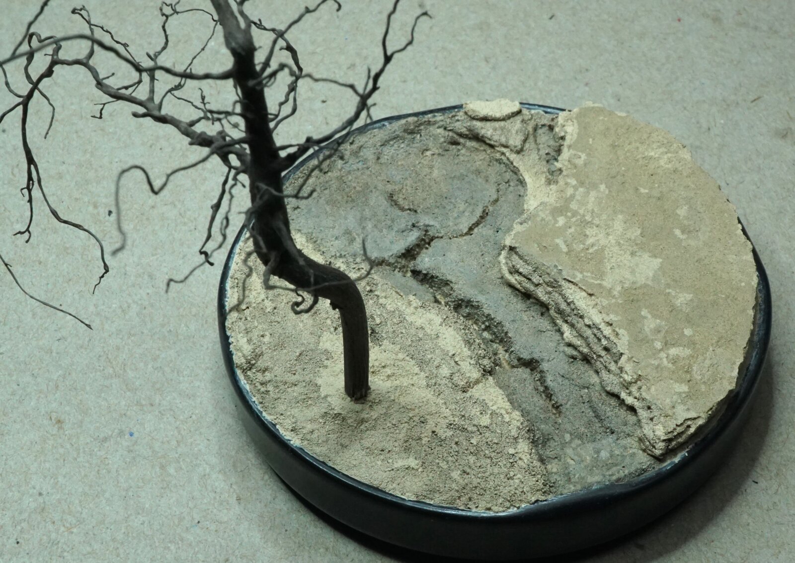

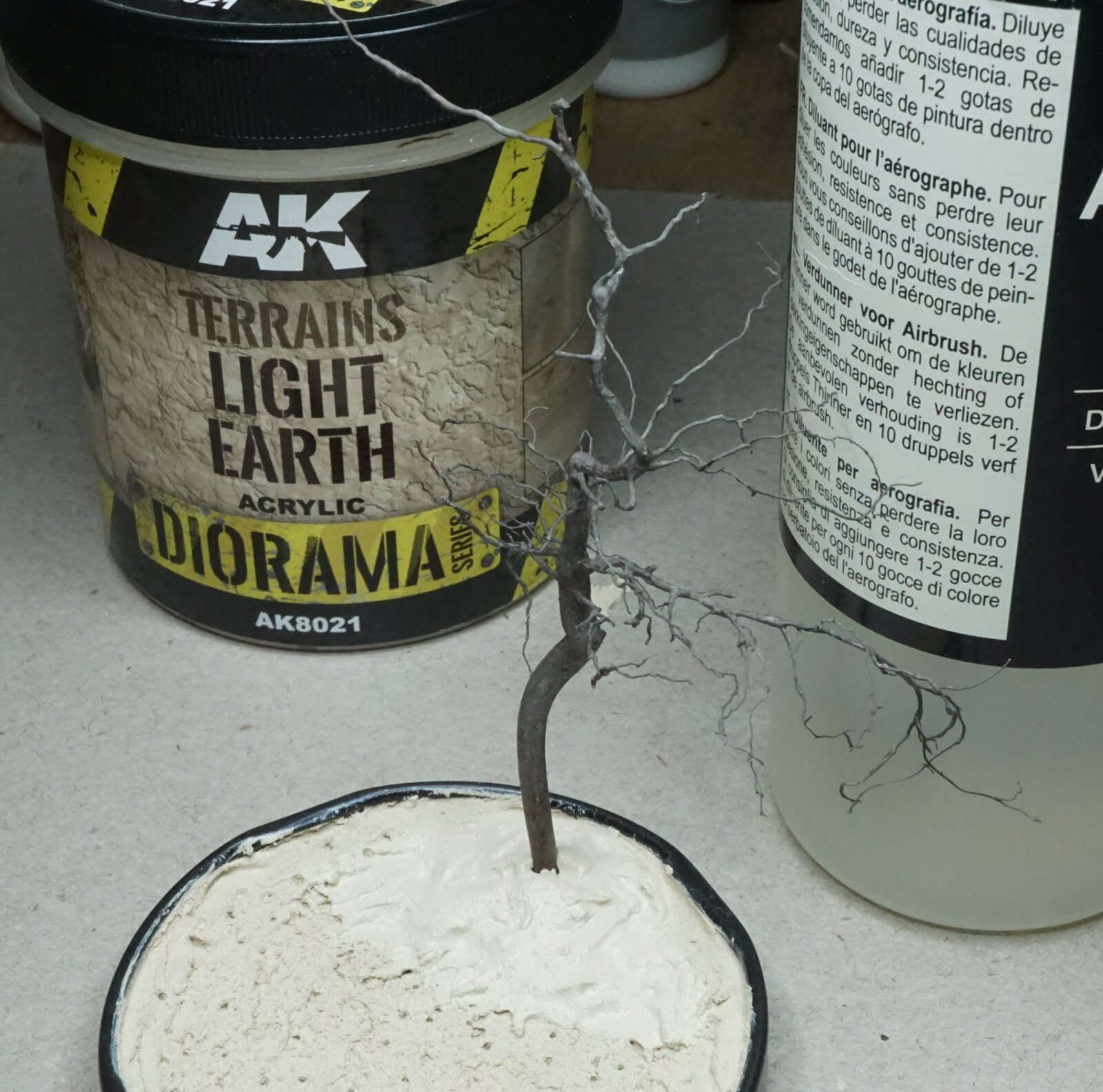

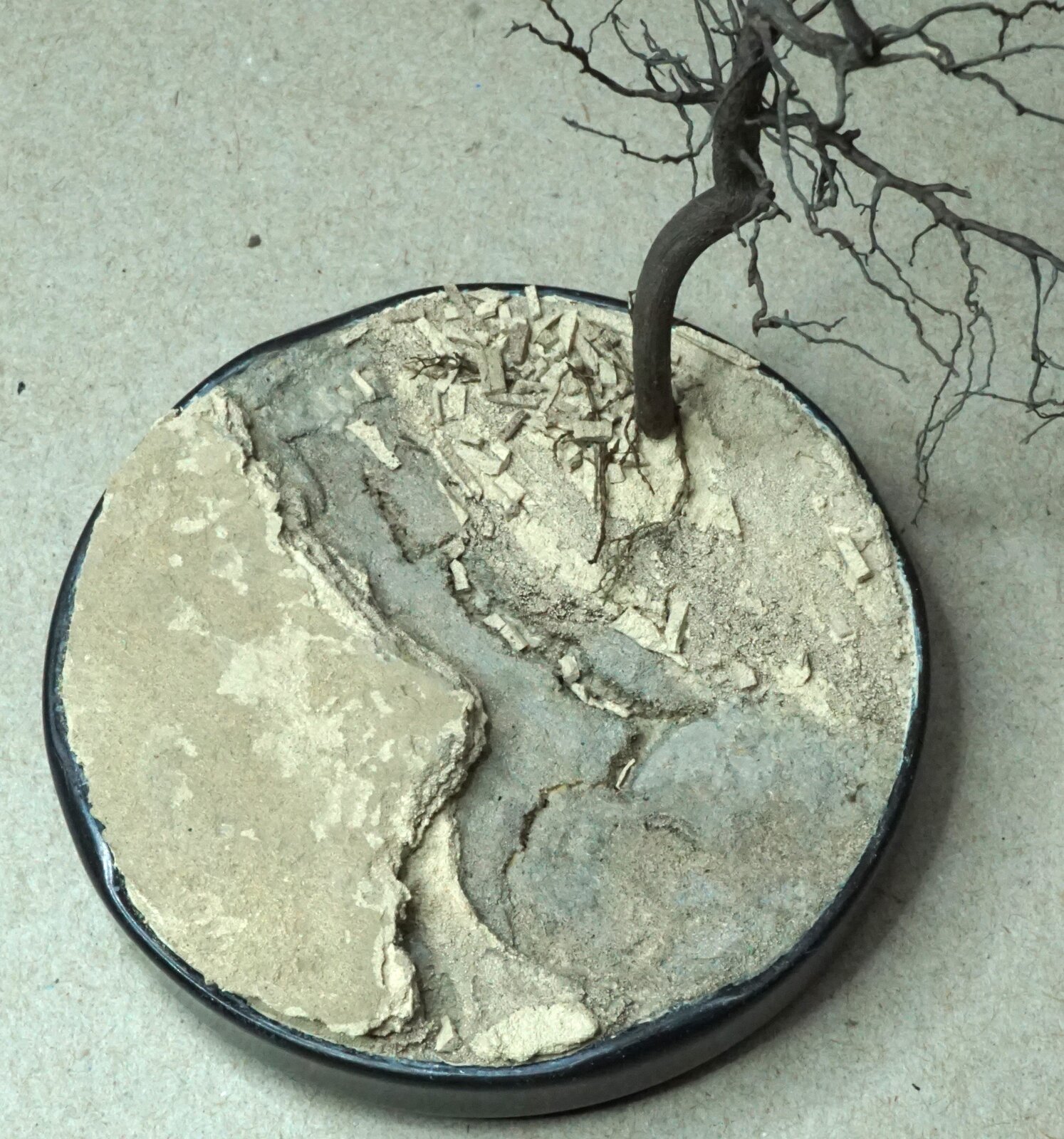

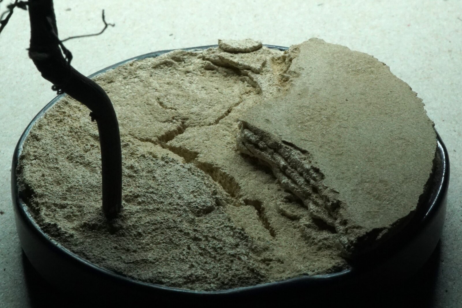

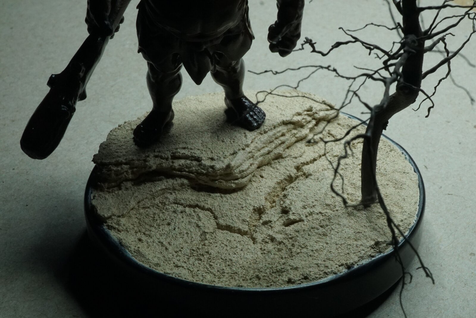

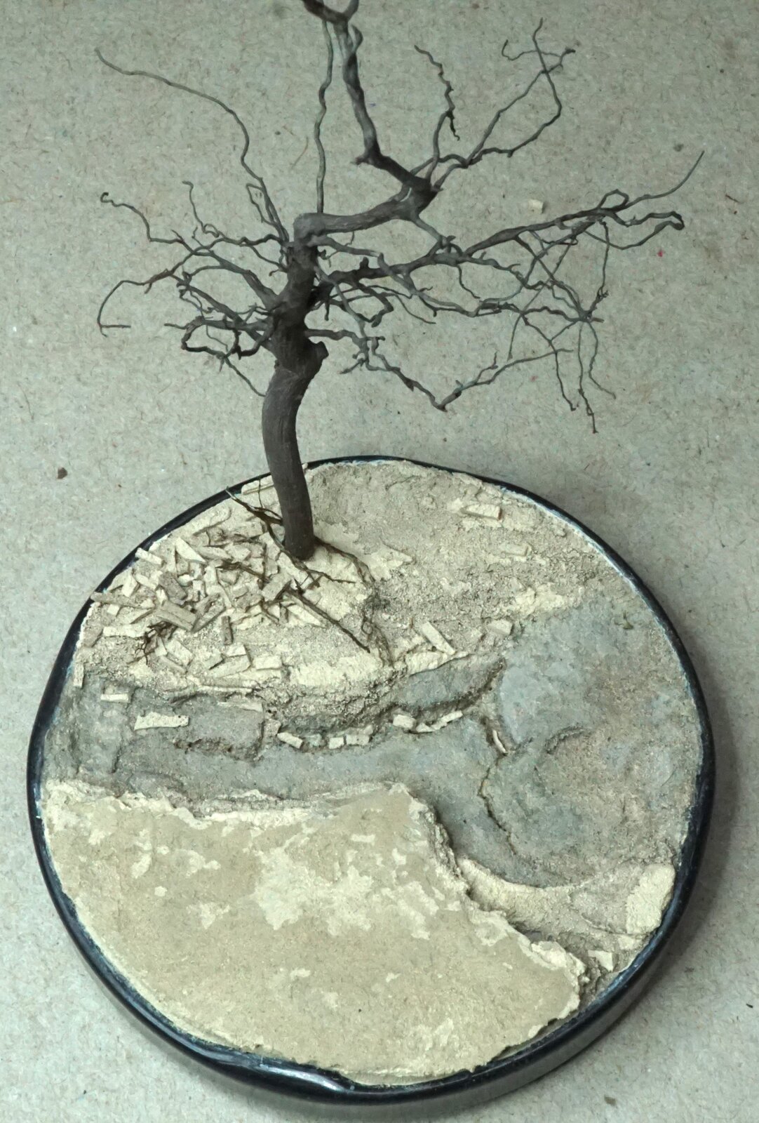

This is the first time using that AK acrylic terrain stuff .
I usually use gypsum , and I was thinking about doing the mass of it with gypsum and top it with that acrylic since I knew it would take forever to dry , but I said let's see what happens . I ain't in a hurry .
That stuff's been on the shelf for close to a decade -- I thought it was unopened but I evidently opened it at some point to check it out , lol , don't remember but I've definitely never used it on any projects .

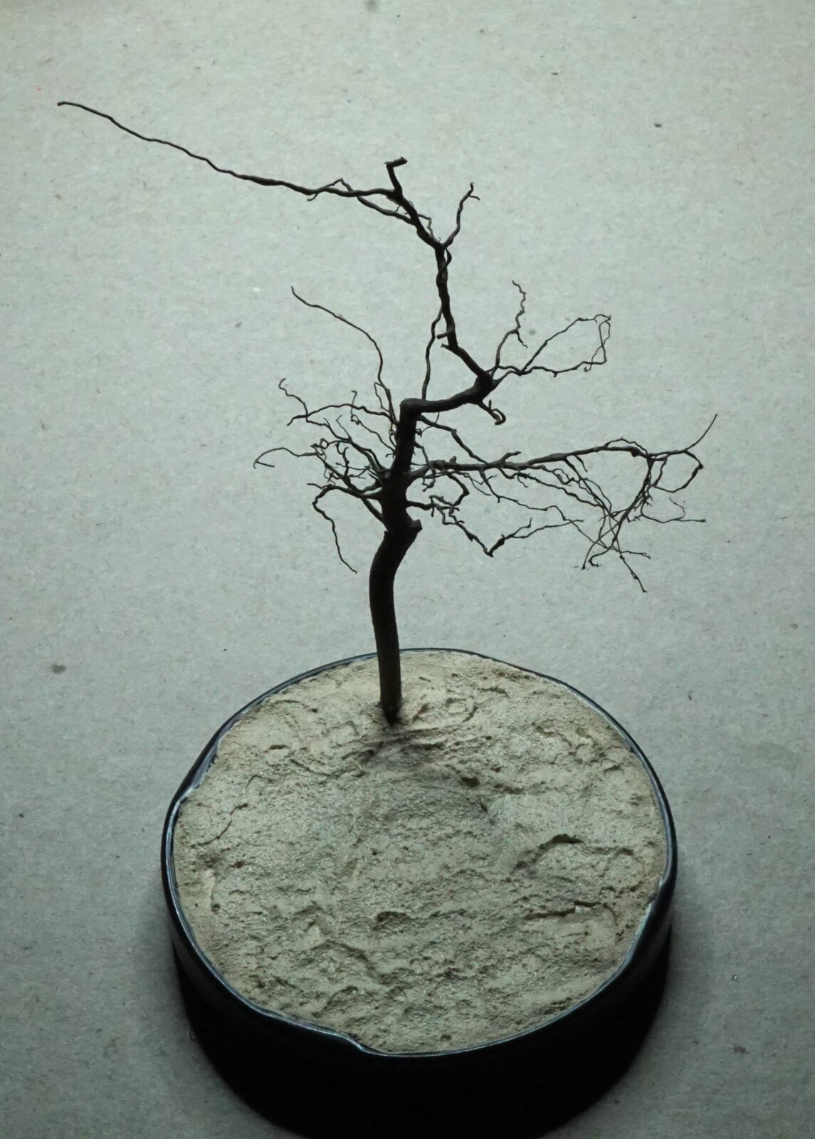

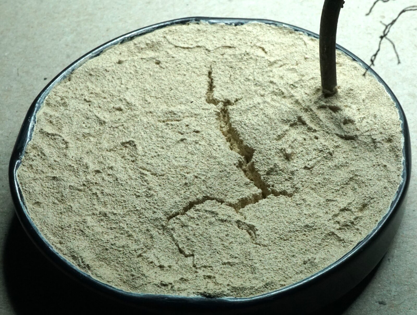

I did the above in 2 lifts of about 5mm depth each . The first layer dried for 3 days until it felt stable enough and then I did the second 5 mm layer this afternoon .
The first layer was thicker around the edges since I ramped it up under the lip to lock it in place .
( in that initial photo you can see all the holes I punched with a toothpick to speed it up , haha , Friggin graphite ! I'm going back to steel )
After the first layer cured I glued a little rectangular piece of styrene scrap , 1/2 mm thick , to the base of the tree using CA and more CA with baking soda . so I'd have a good anchorage and make it much easier to keep it upright while that forever mud dried .
Then mounted that using the AK last night .
It needs a little more depth on the tree side and then at least another 5 mm of depth where the giant will stand .

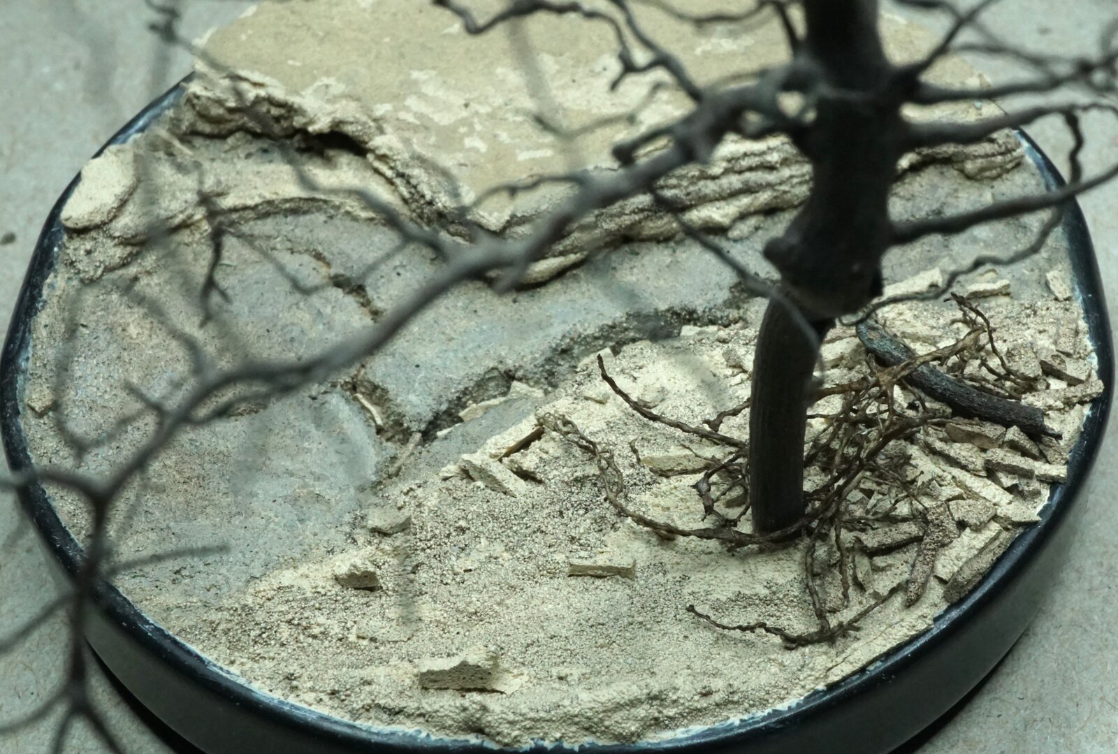

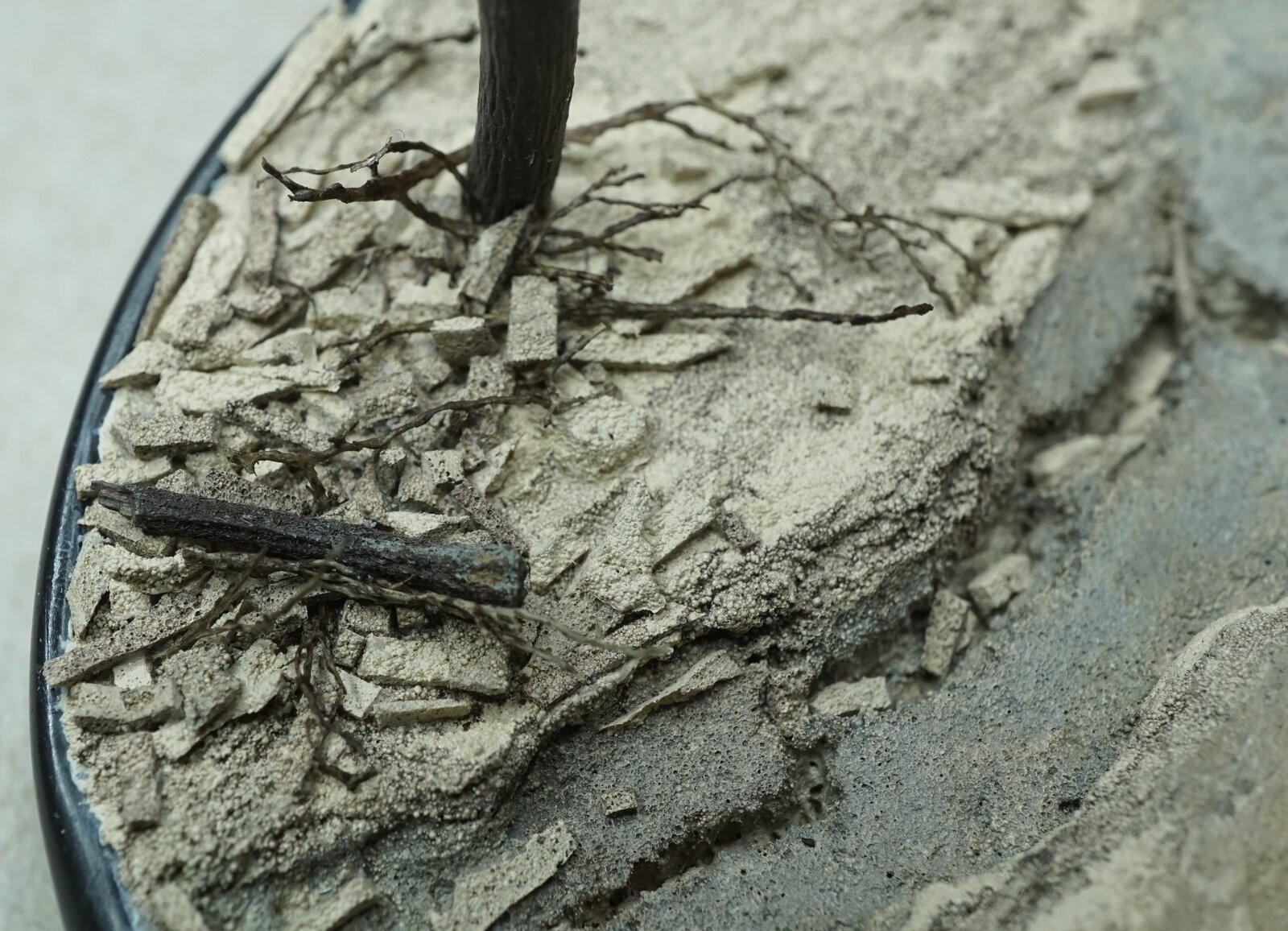

I spatula'd out some of that AK onto parchment paper in varying thicknesses so I can slice it into stone / shale fragments .
It won't conveniently crumble like gypsum , unsurprisingly , so slicing it is .
I'm psyched I get to finally start running color on a brush .

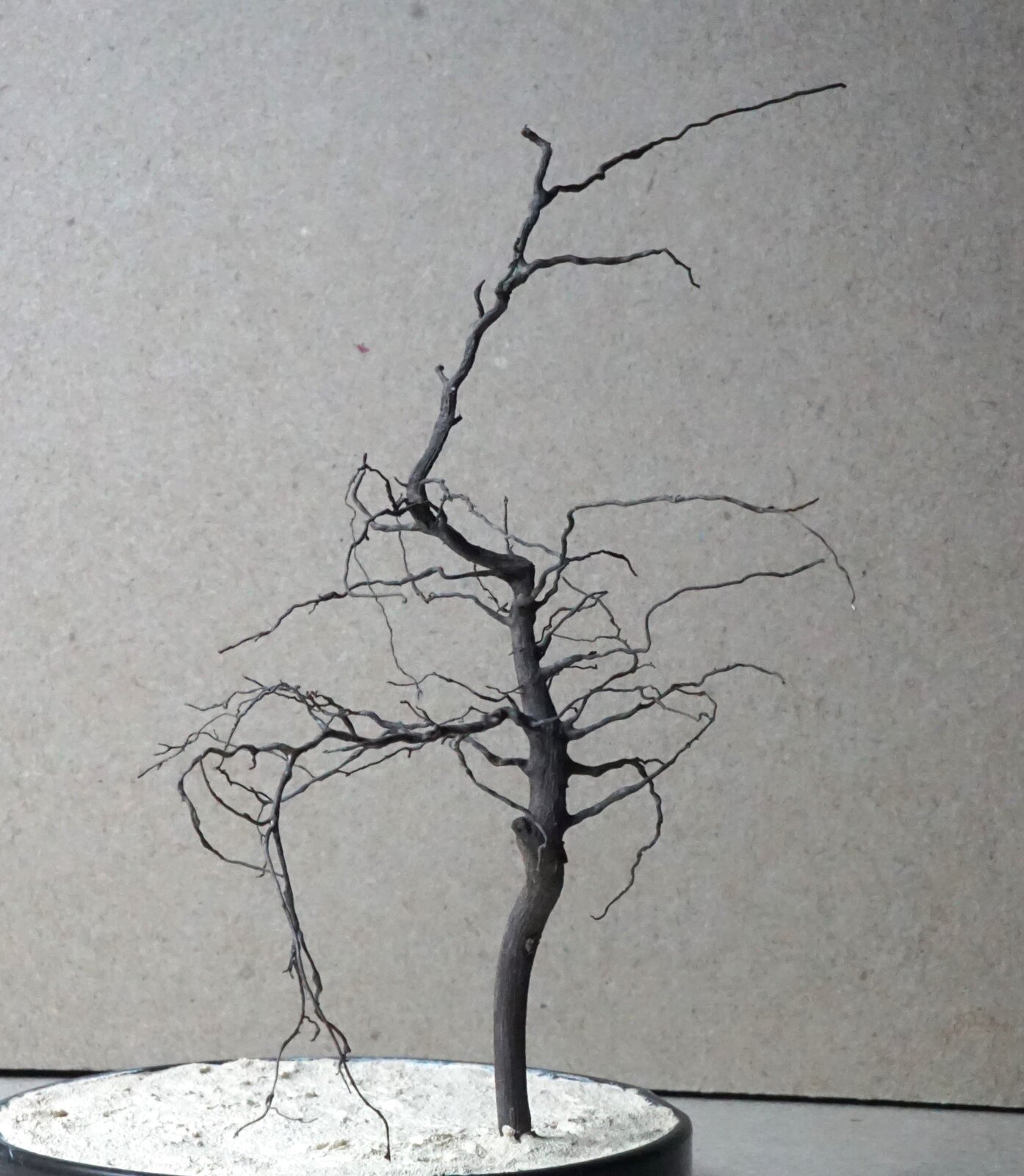

Are you going to leave it bare or add some leaves to it, Momo? It's going to look great either way, but I'm just curious about your final vision.
The tree looks great! It looks just like a number of the trees that my city planted at the start of the drought last summer.
