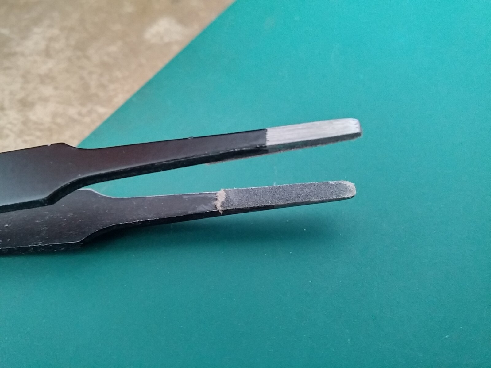

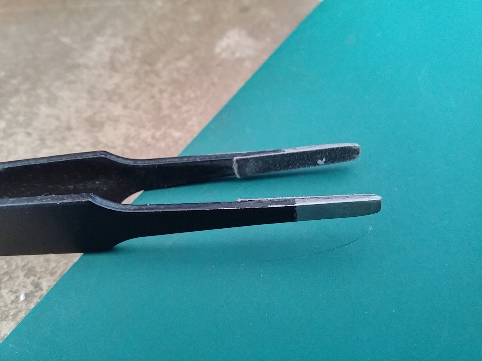

If they are normal tweezers I usually use some 240 wet n dry about 10mm in length and c/a it to each end of the tweezers. I first coat each one with c/a, then position the WnD, the length and width are no problem. Then clamp the tweezers together gently untill the c/a is dry, then with the ends held together trim away the excess WnD and you have a set of tweezers that will hold the part...
This is my set, the WnD will need replacing soon and to do that just scrape off the old WnD with a knife blade and replace.
