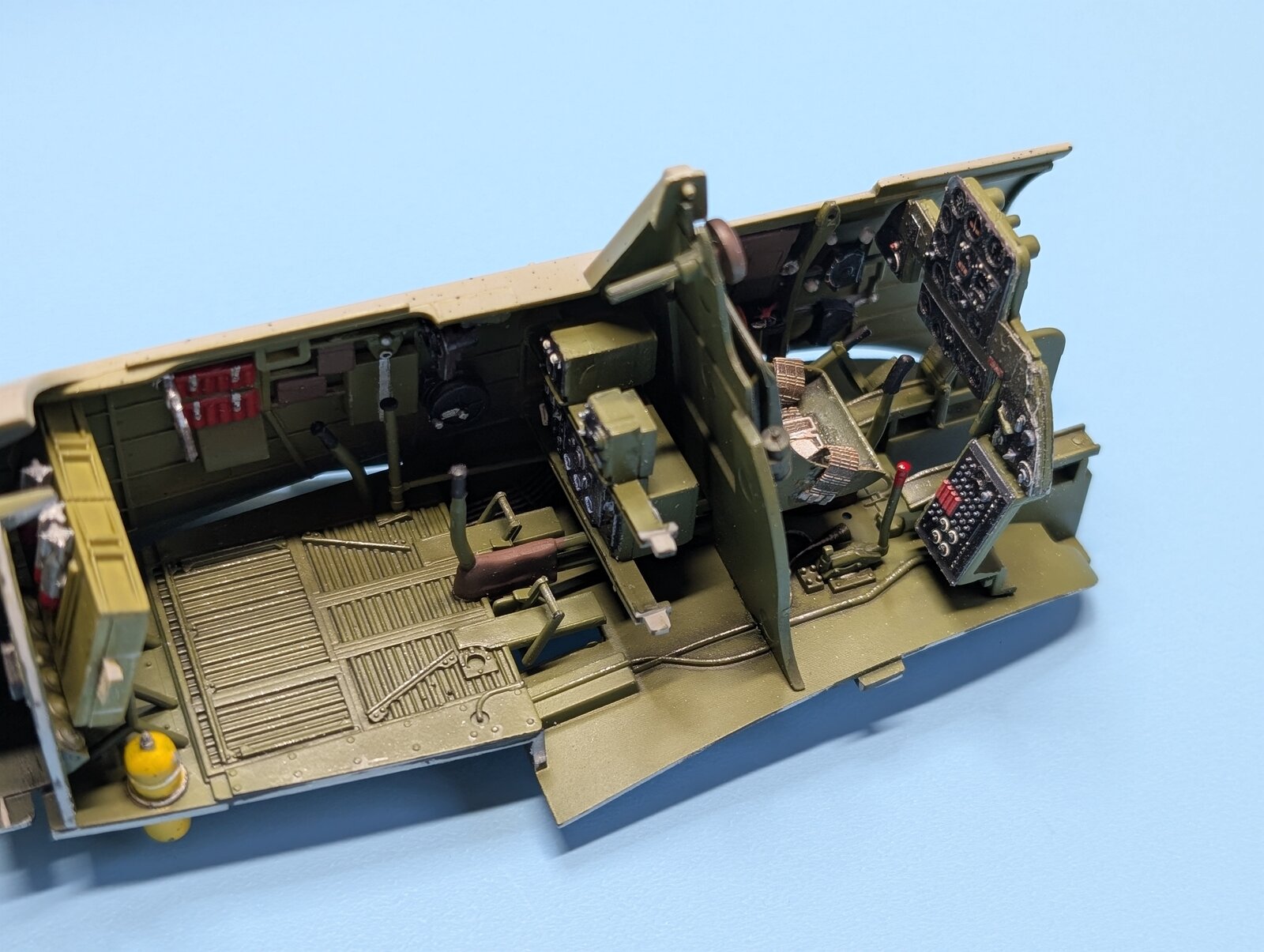

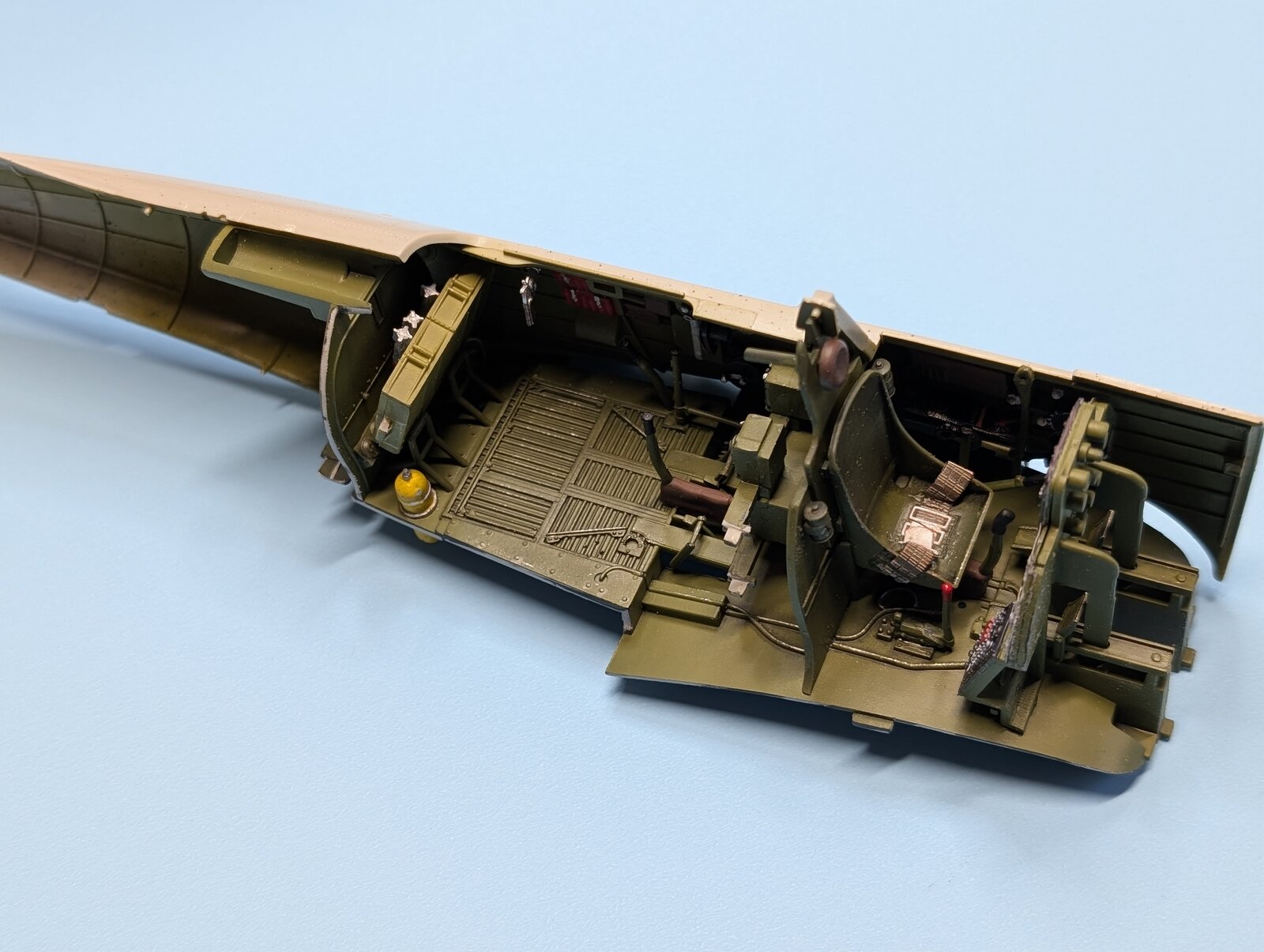

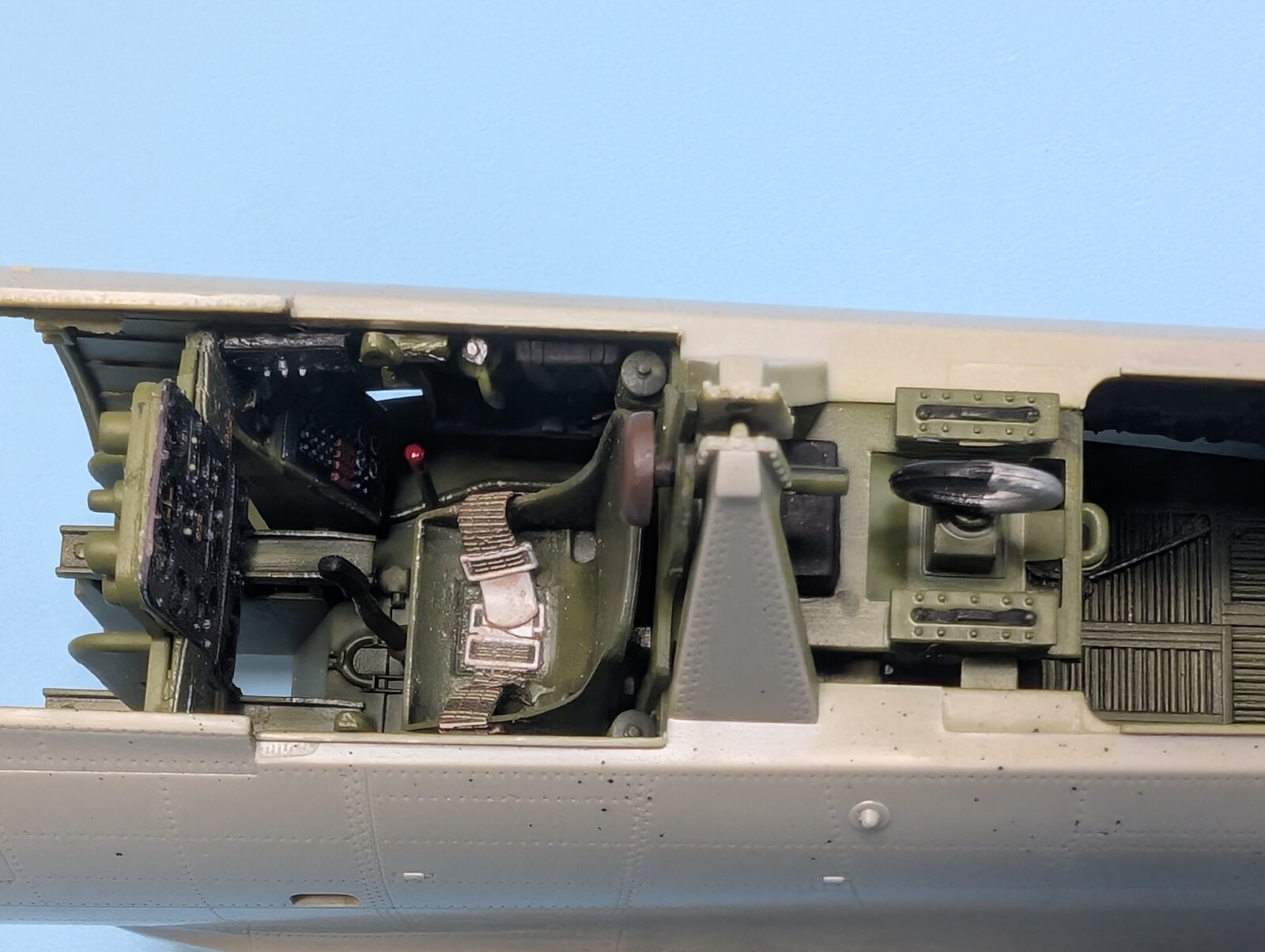

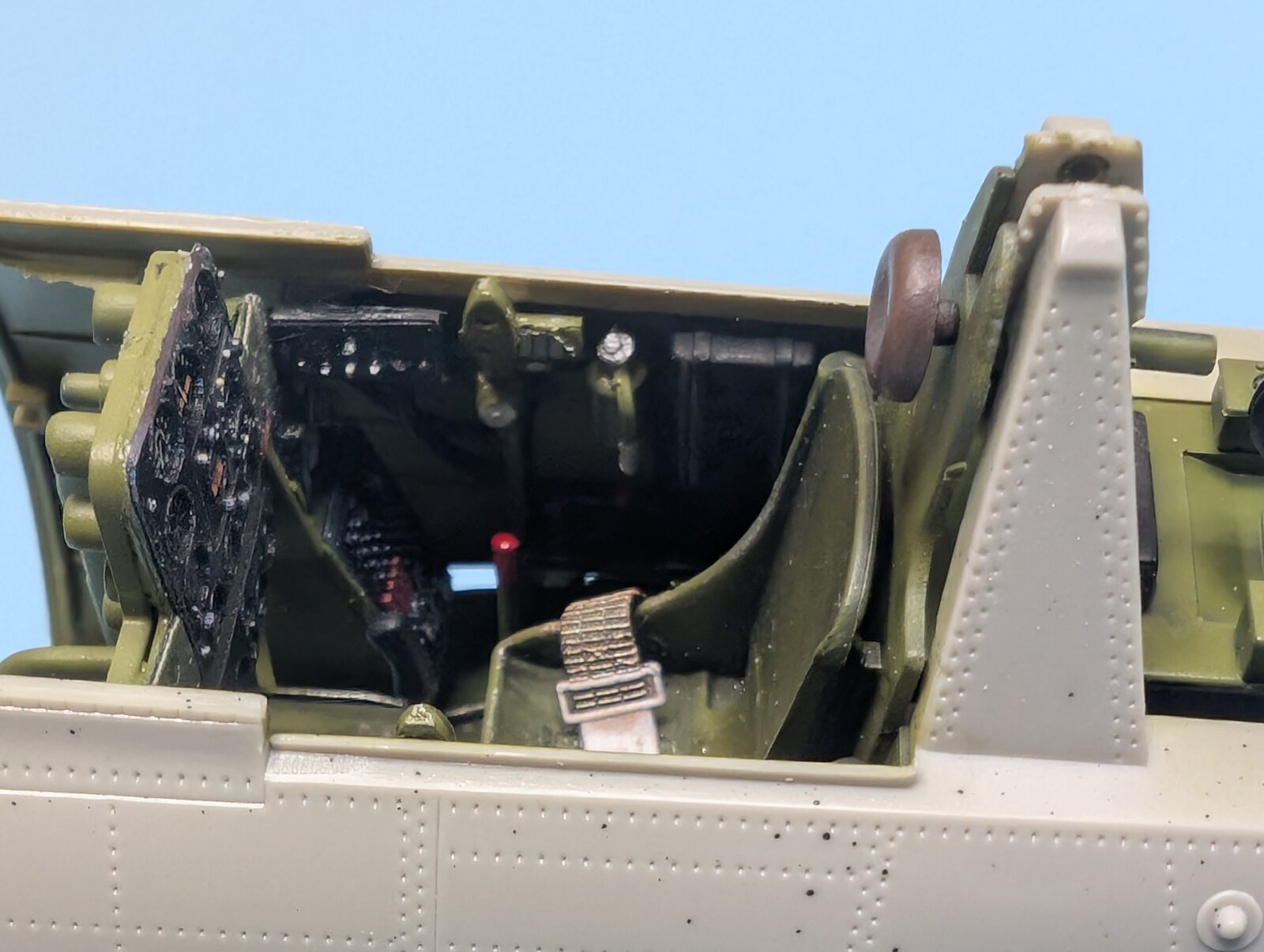

Hello to all. It been a while since I have posted a work in progress at SMA. I have been away for some time with family issues as well as leaving the cold north for the south. Its summertime and I have returned from Florida back to Wisconsin where my workbench and supplies are and have started a build which I hope will be both challenging and fun! I have been building exclusively Tamiya models which are gorgeous but have wanted to try some other companies . I have always been interested in the SBD Dauntless bomber and in particular the role they played in turning the tide in the battle of Midway. After reading about the battle and these brave pilots I selected to build the Trumpeter version of the SBD-3 Dauntless bomber and try to recreate the plane flown by navy pilot Lt. Commander Richard H Best.

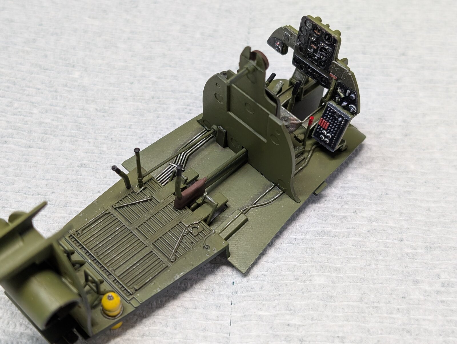

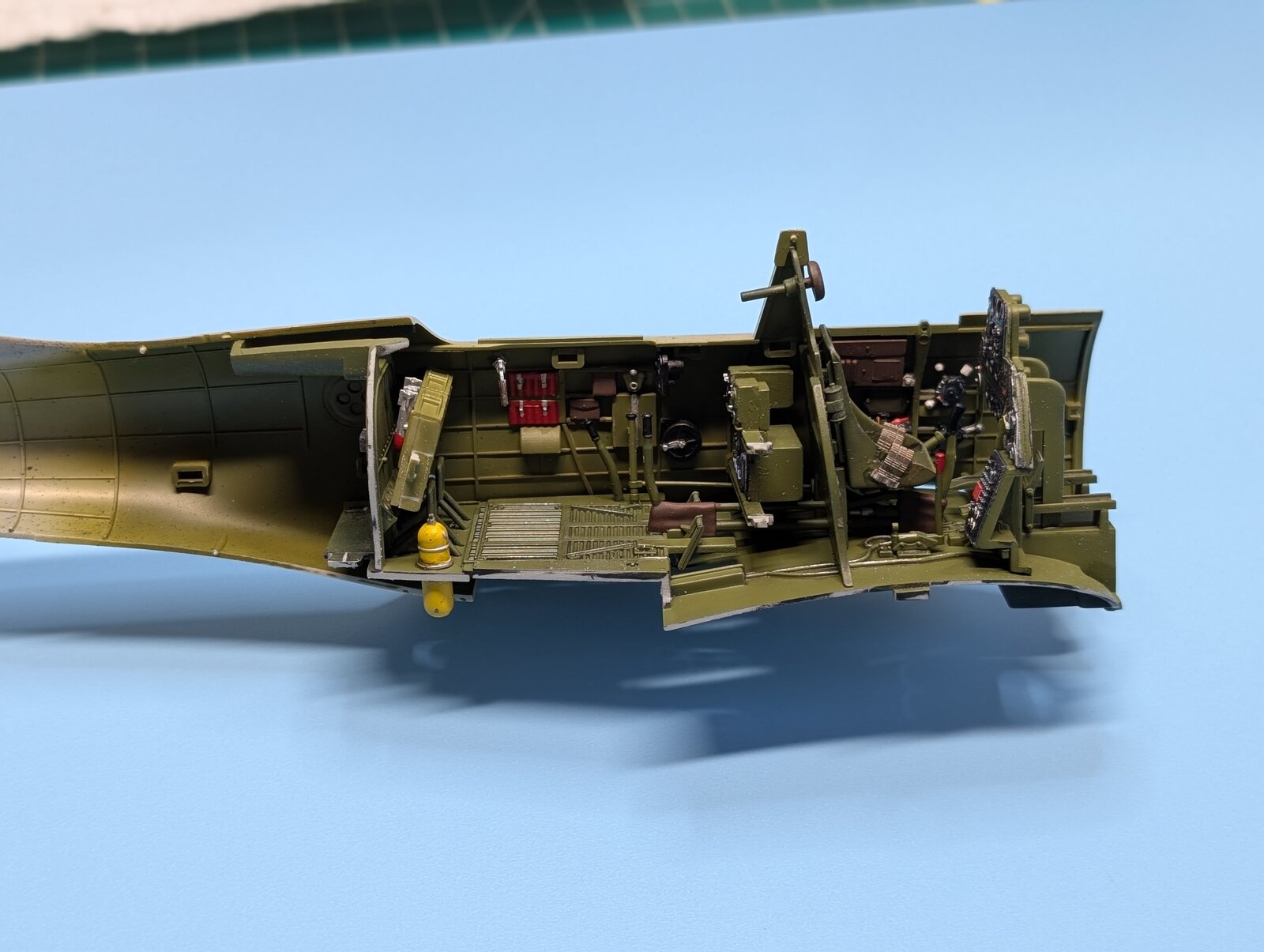

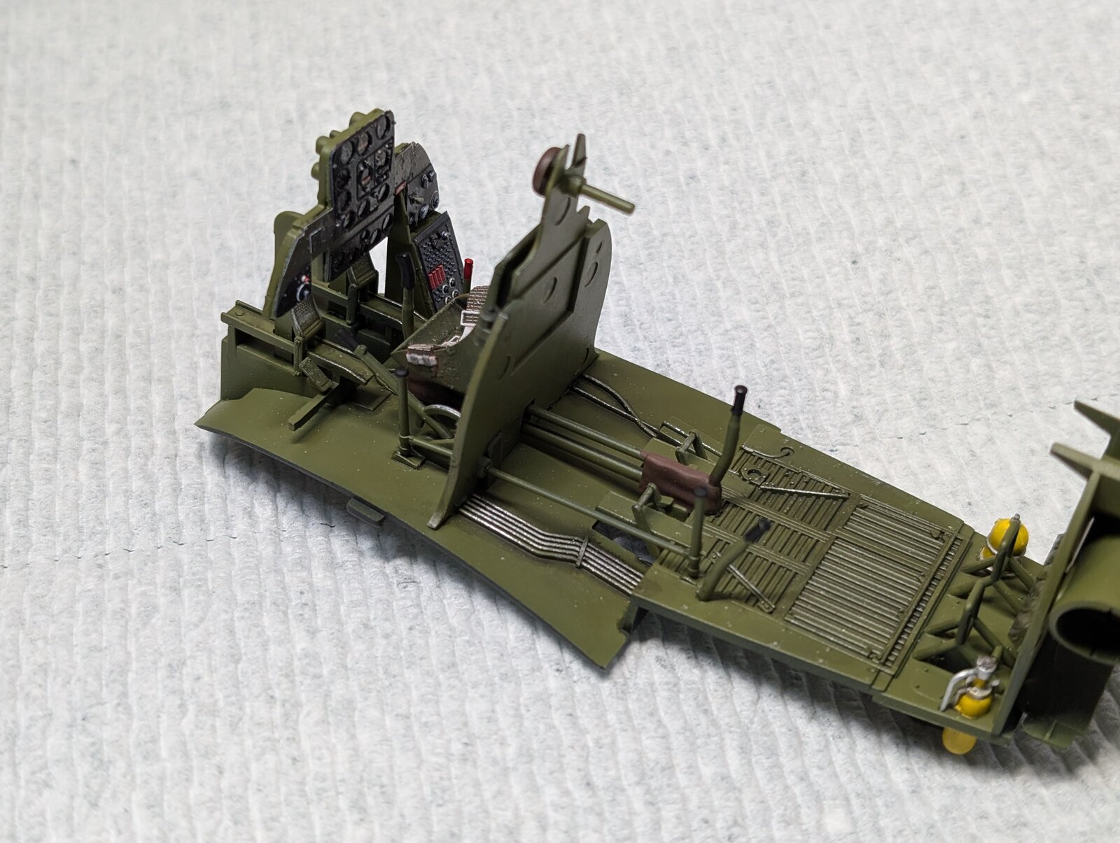

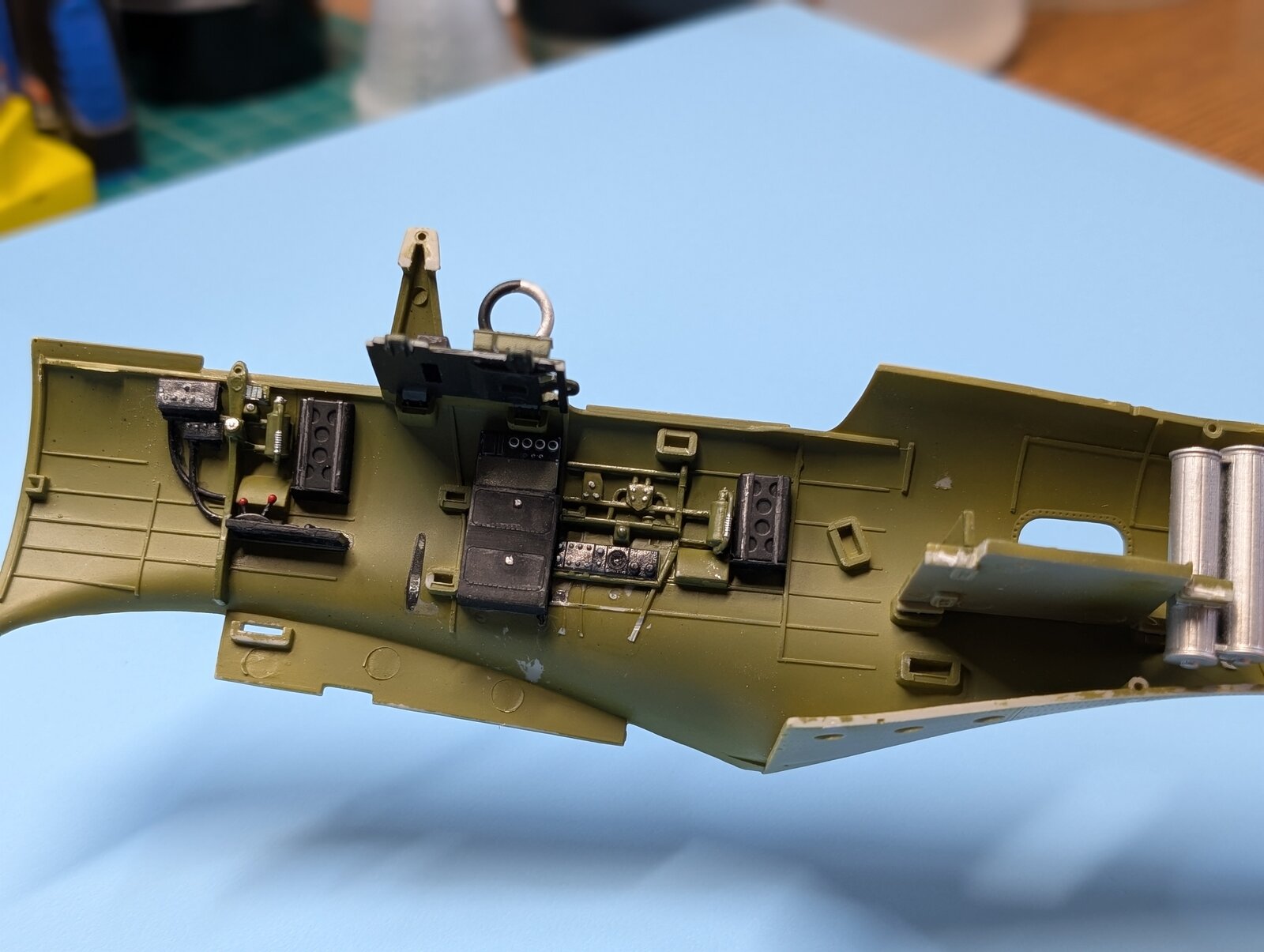

So I will start with the front office- the cockpit. I will be weathering the plane very lightly as this plane was essentially brand new. This fleet of planes was shipped from the mainland to Pearl Harbor and loaded on to carriers to eventually take part in the battle of Midway, June 4 1942. AS always comments and suggestions always welcomed
All the best
Docsudy
PXL_20241216_160527492.jpgPXL_20241216_160534034.jpgPXL_20241216_160541355.jpgPXL_20241221_183910507.PORTRAIT.ORIGINAL.jpgPXL_20241221_183914642.PORTRAIT.jpgPXL_20241221_183929808.PORTRAIT.ORIGINAL.jpgPXL_20241221_183942091.PORTRAIT.ORIGINAL.jpg

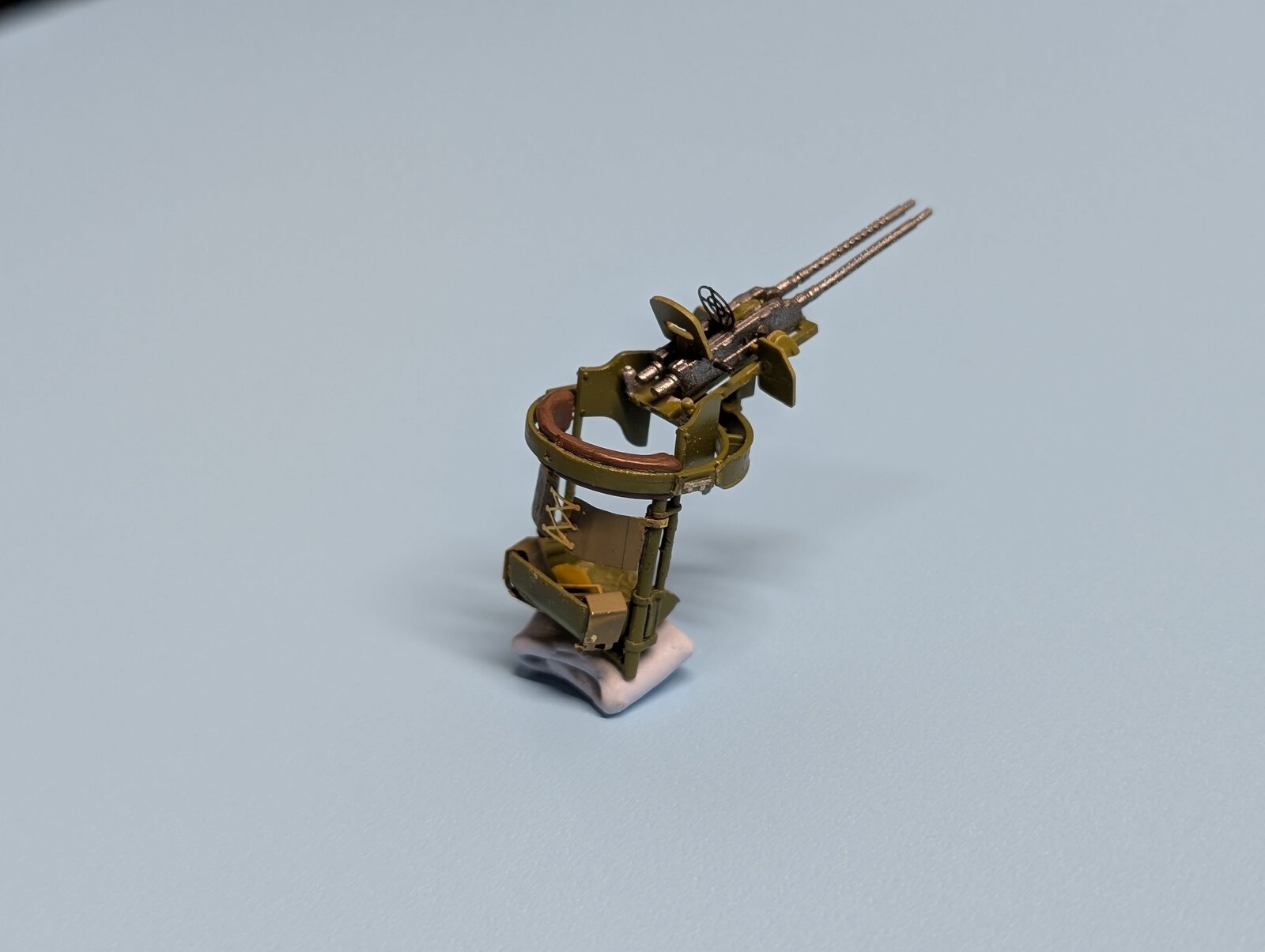

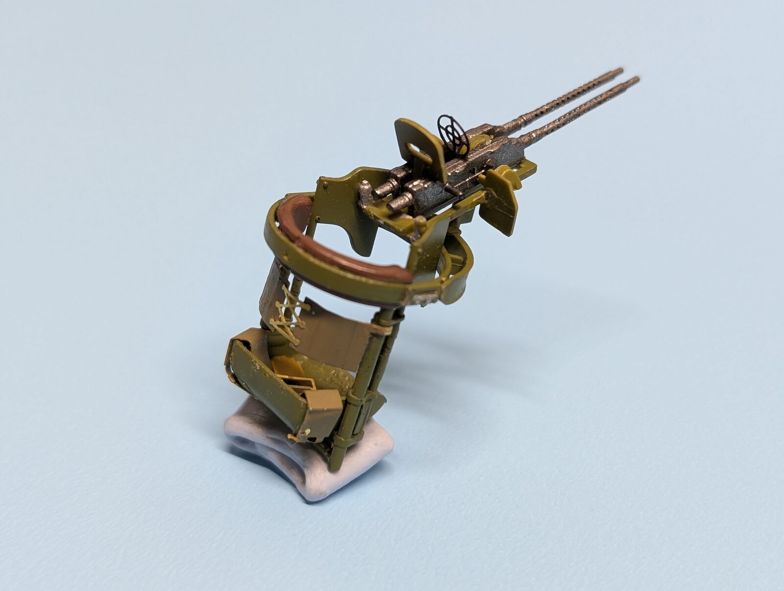

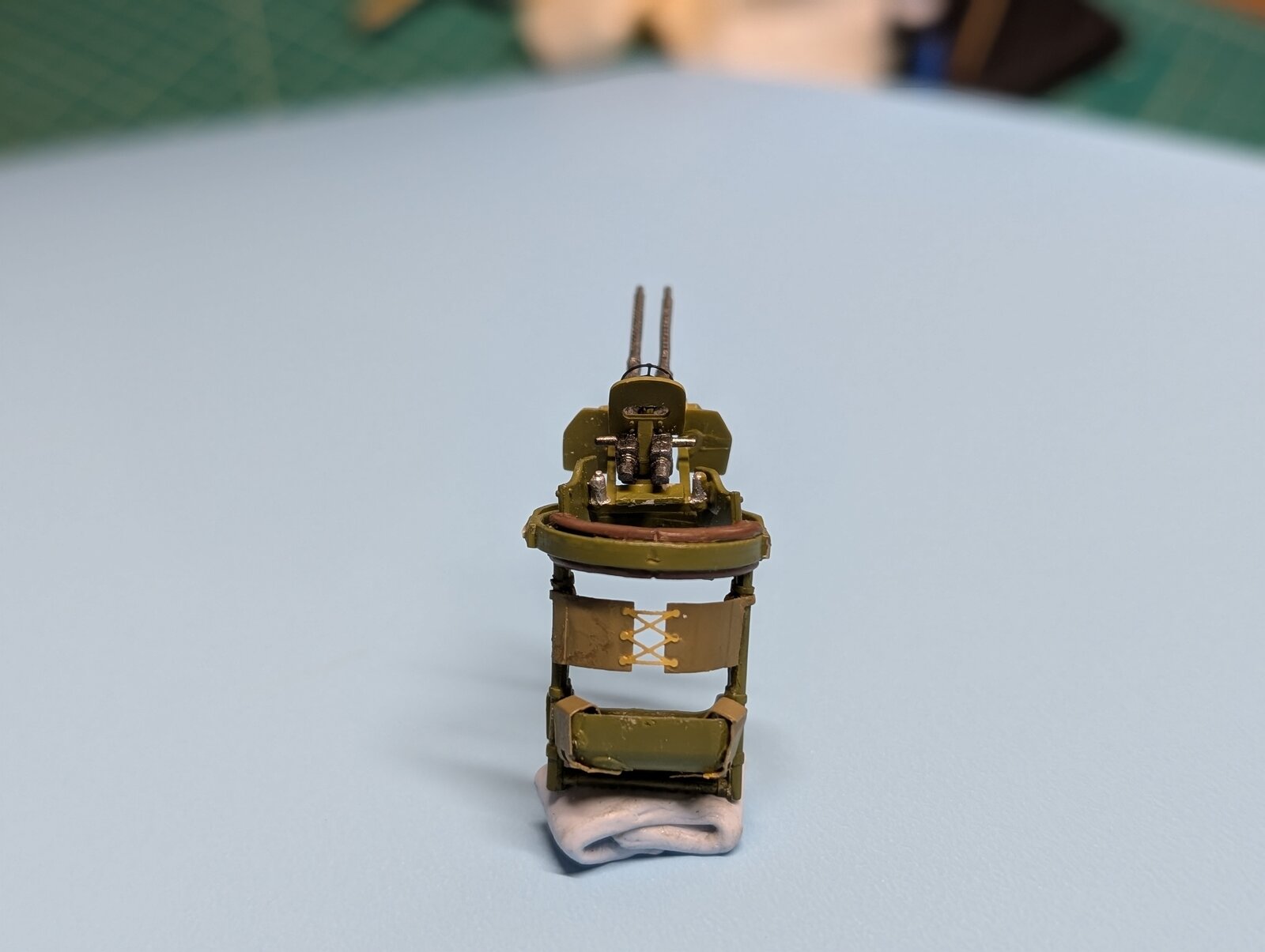

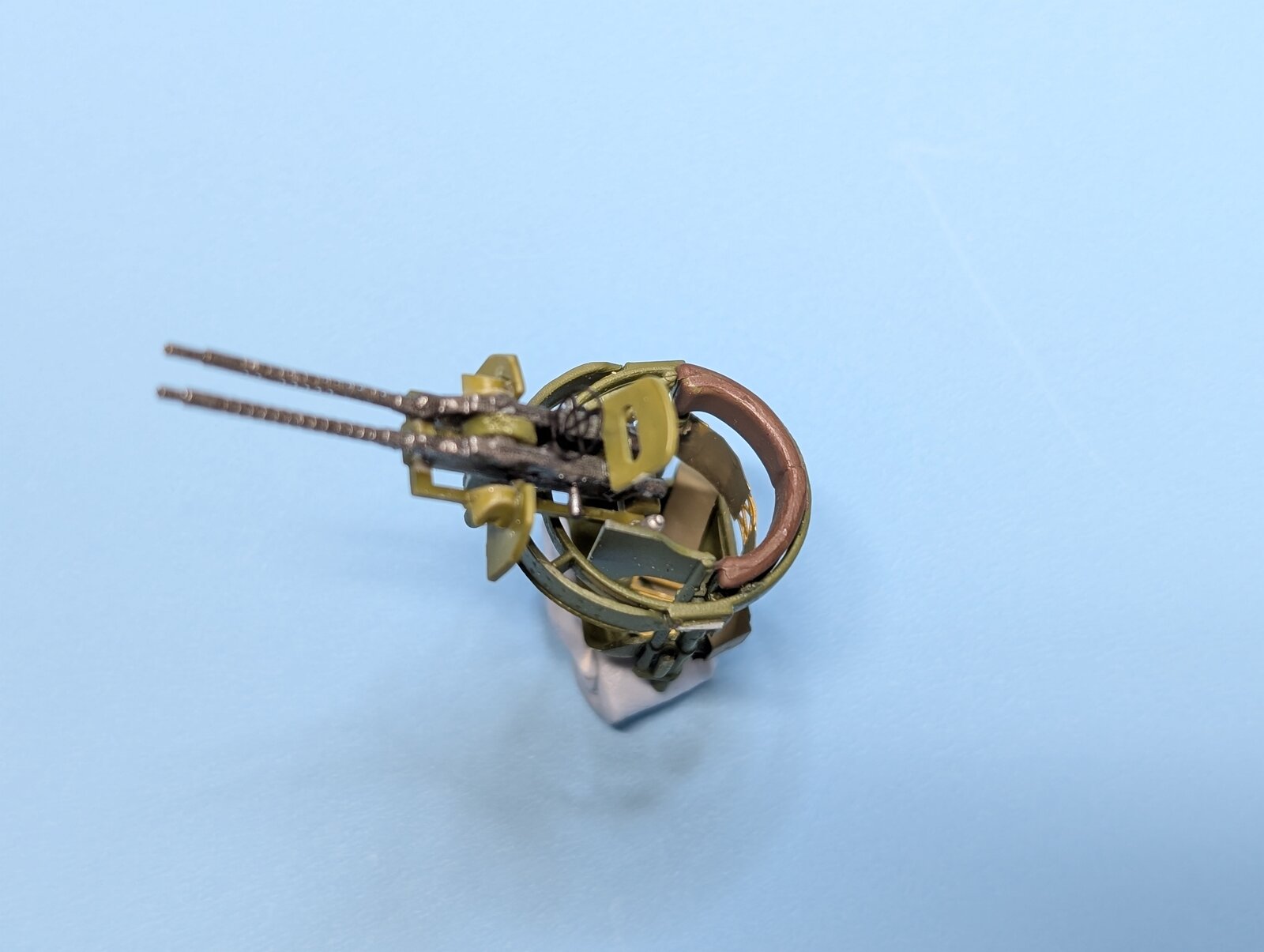

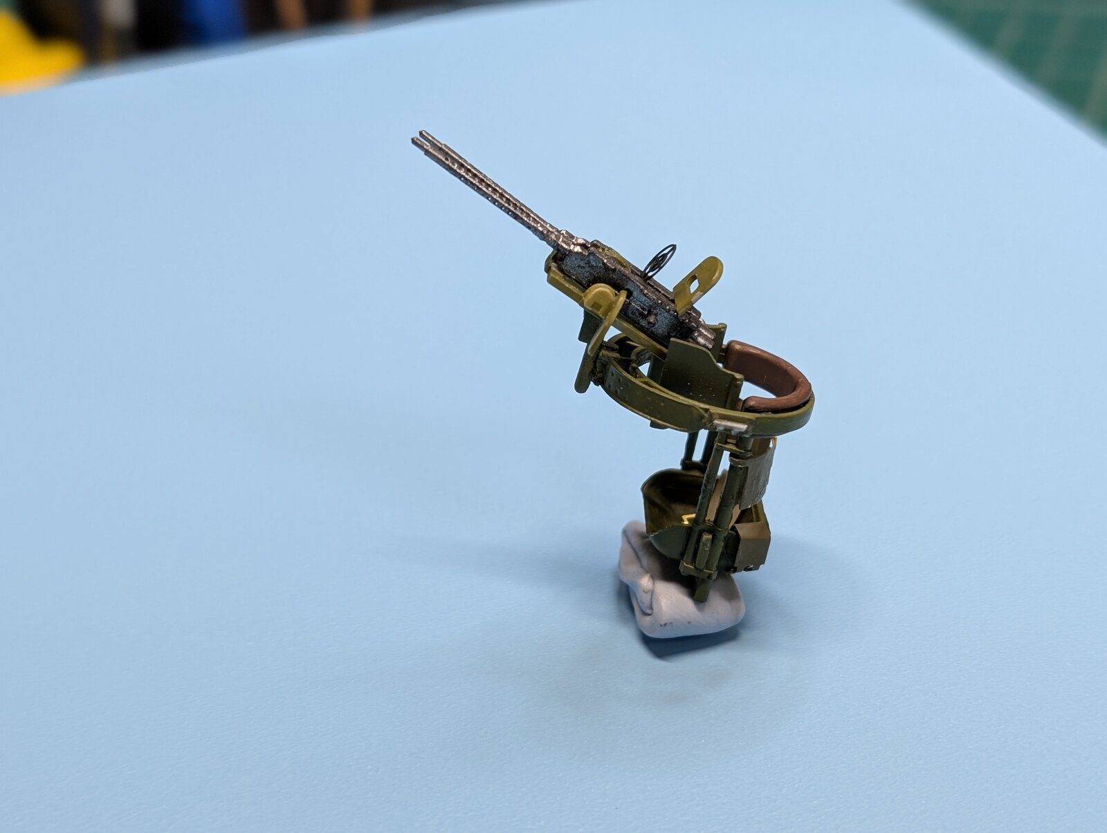

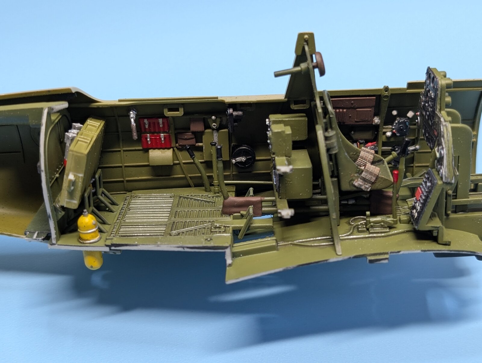

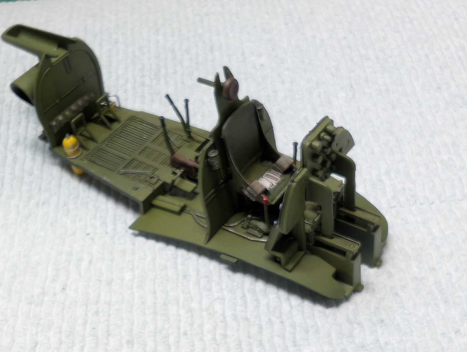

Once the cockpit was essentially put togather and painted attention was directed to the pilot seats and harnesses. The seat belts are single type which was appropriate for the time. They were a bit tricky as they were PE. I painted them and weathered them gently. The rear gunners machine gun will be placed later into the cockpit as I did not want to damage it the cockpit was masked off to paint the fuselage.PXL_20241221_183942091.PORTRAIT.ORIGINAL.jpgPXL_20241221_184521420.jpgPXL_20241221_184528787.jpgPXL_20241226_004854471.jpg

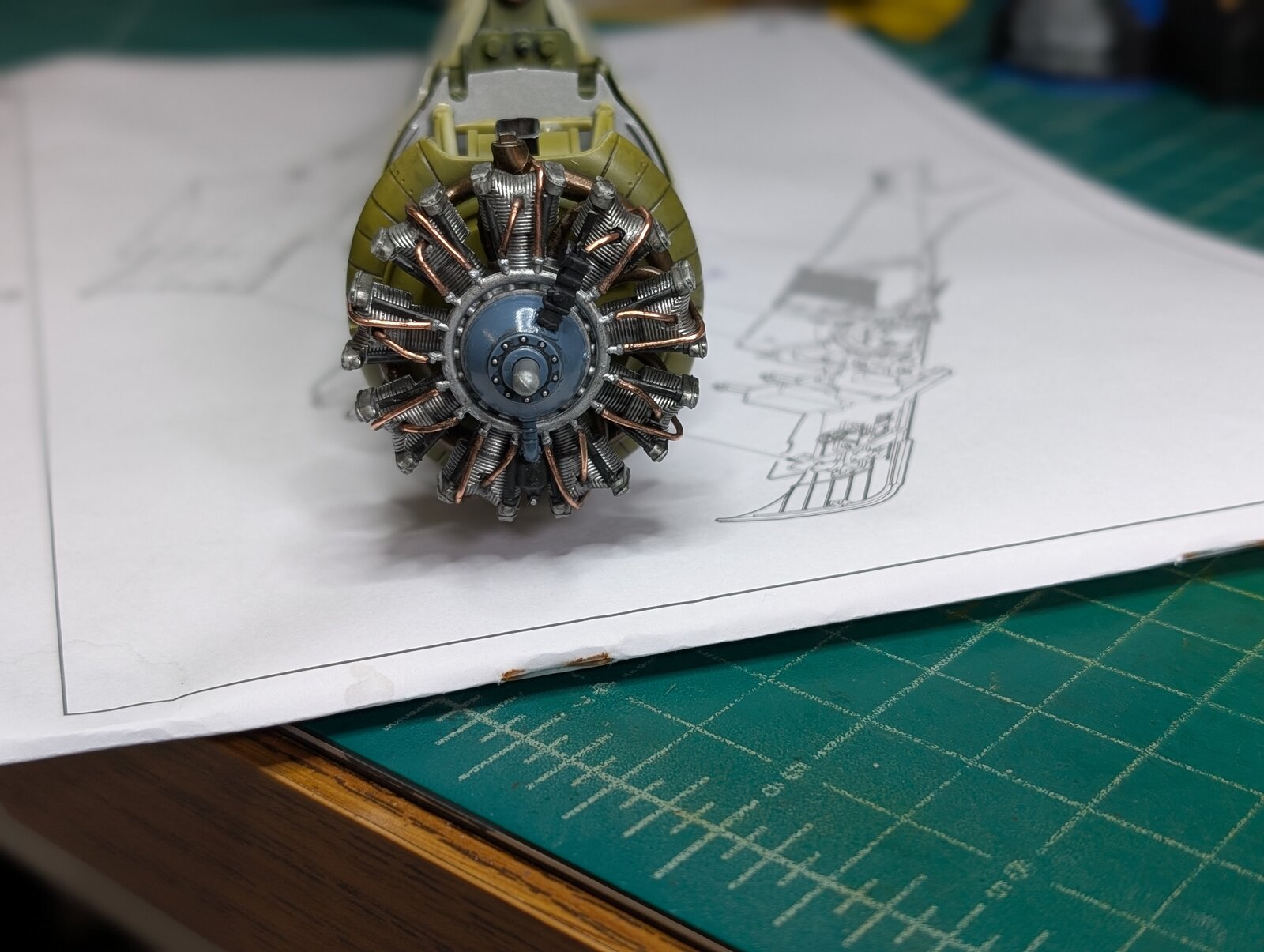

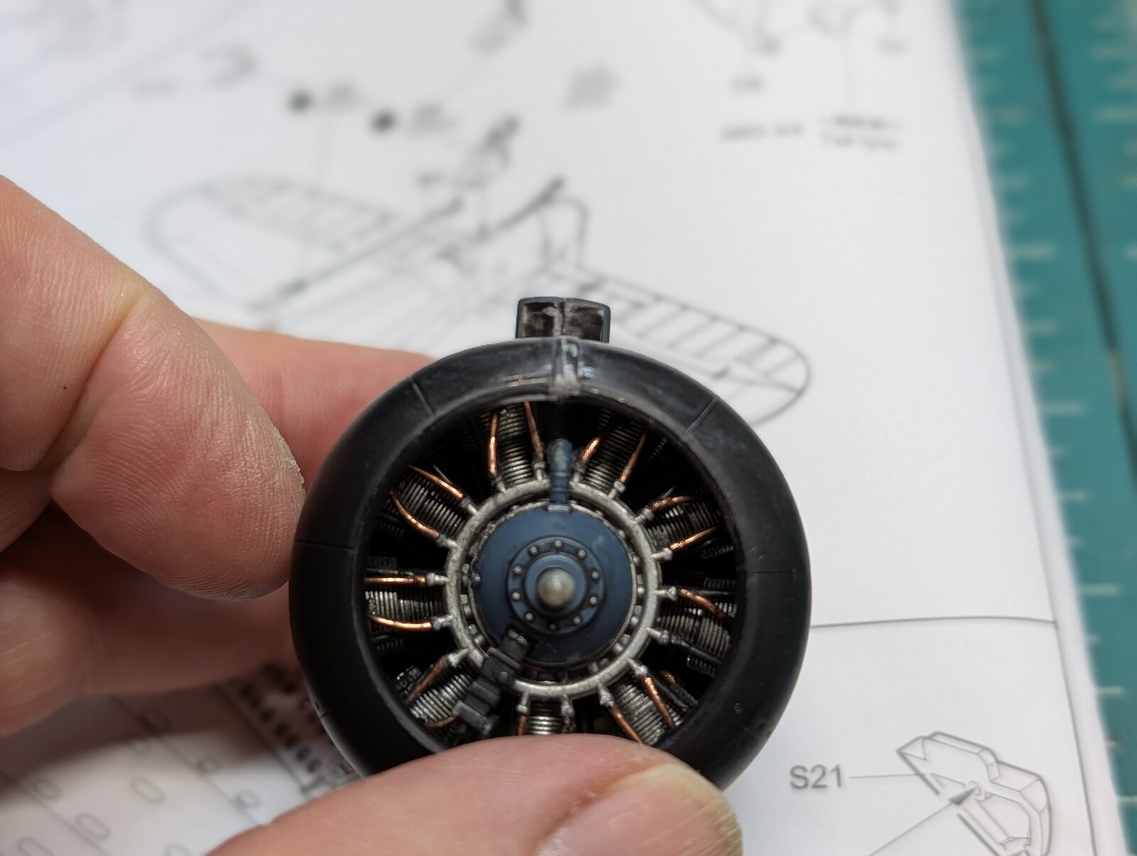

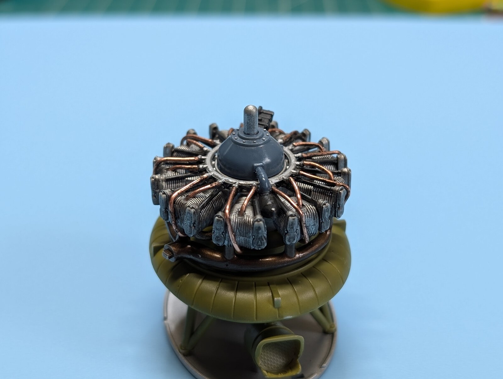

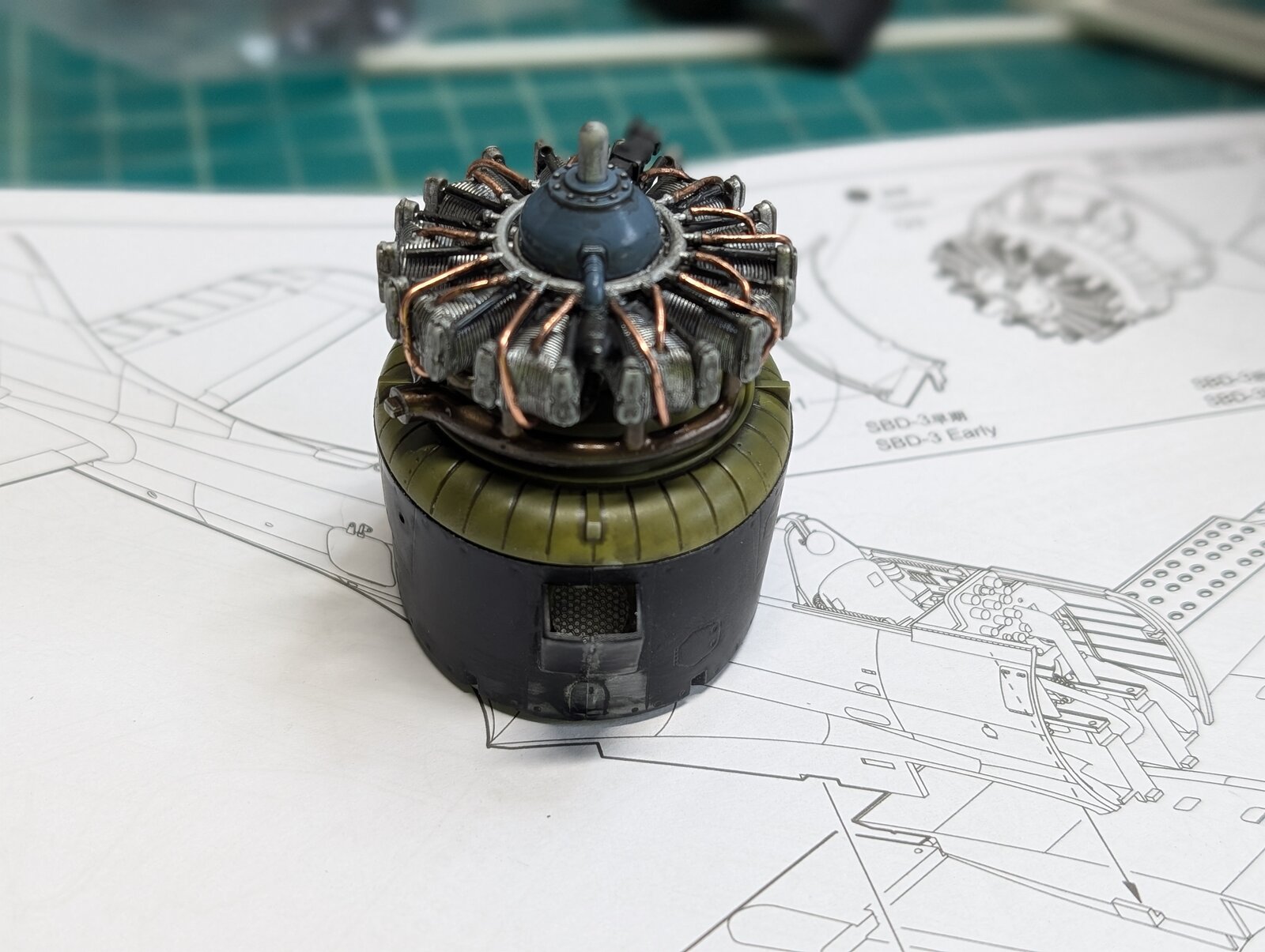

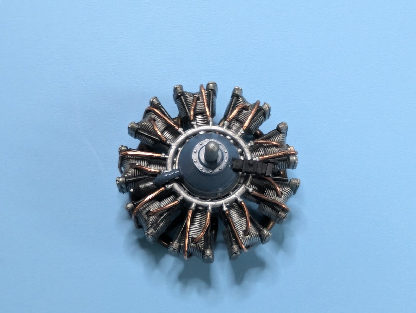

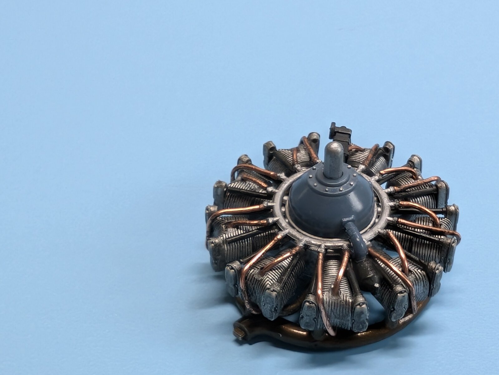

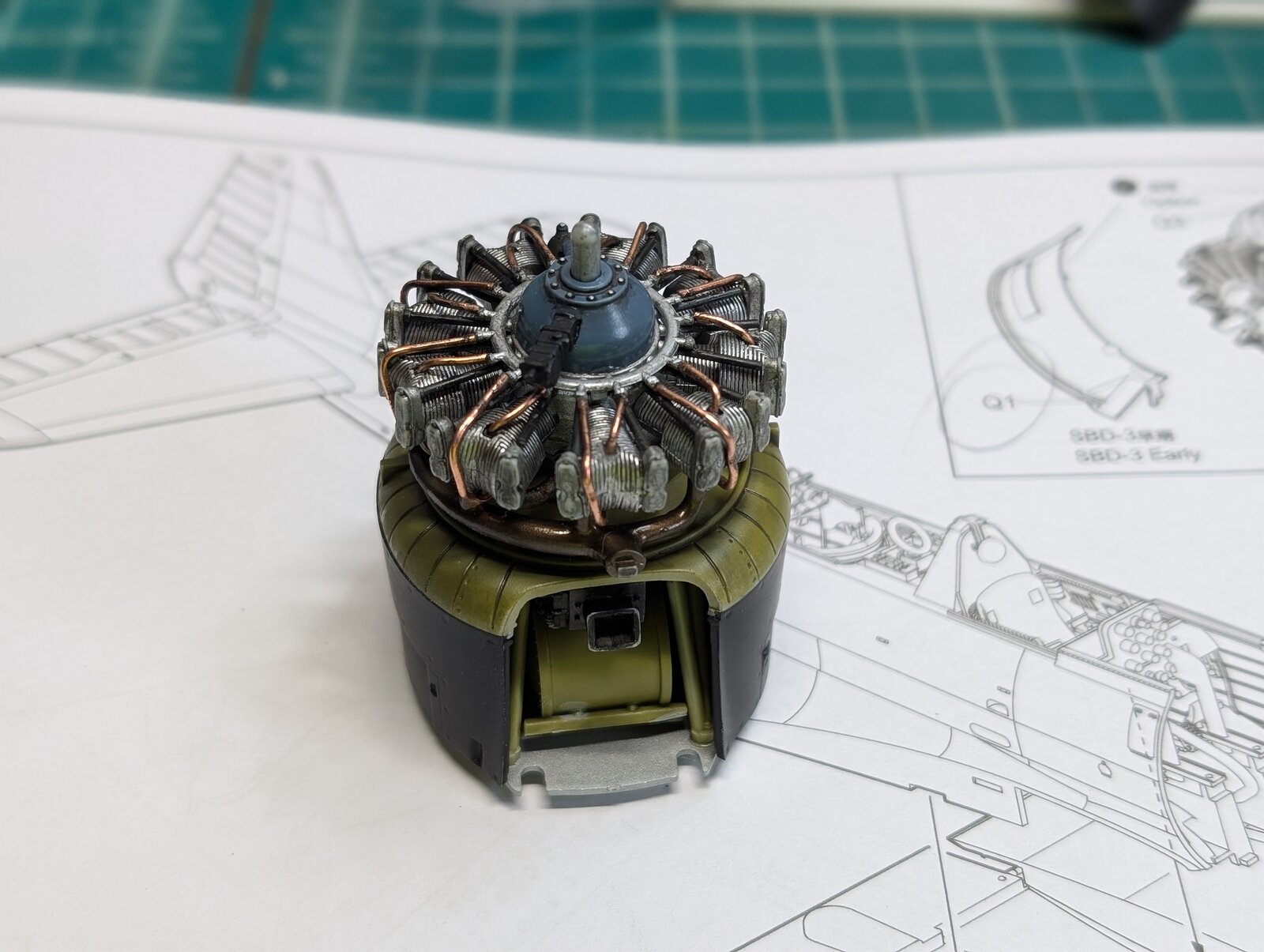

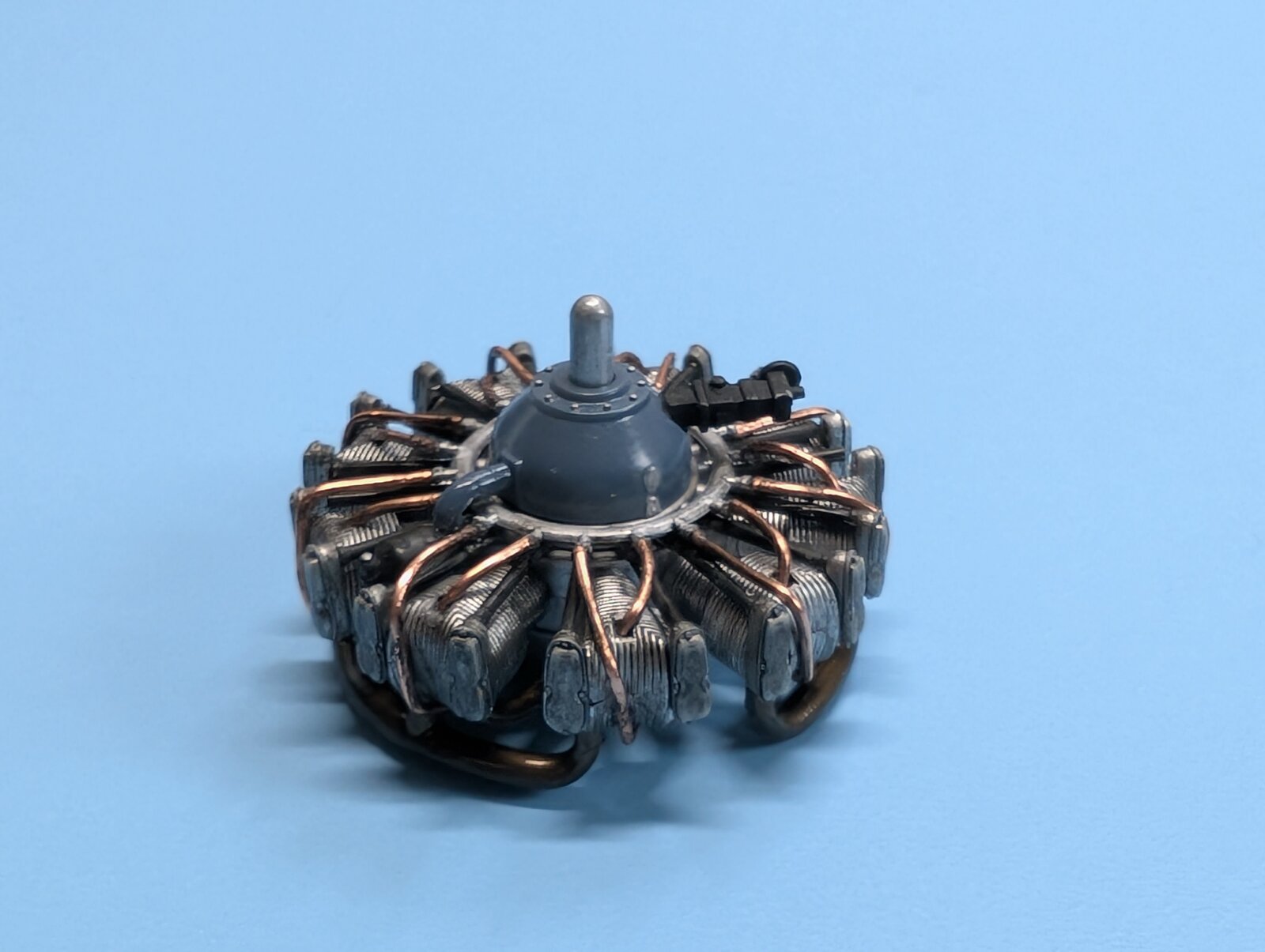

Attention was next directed to building the engine. I took the time to wire the radial engine with 20 gauge dead soft copper wire, which I found to be harder to manipulate then lead wire. It was what I had so I went with it. I think it came off nicely. Afterwards the engine and housing where assembled and gently weathered with Tamiya black panel wash and dilute black plus burnt umber oil paint mixed with mineral spirits. What do you think ?
All the best

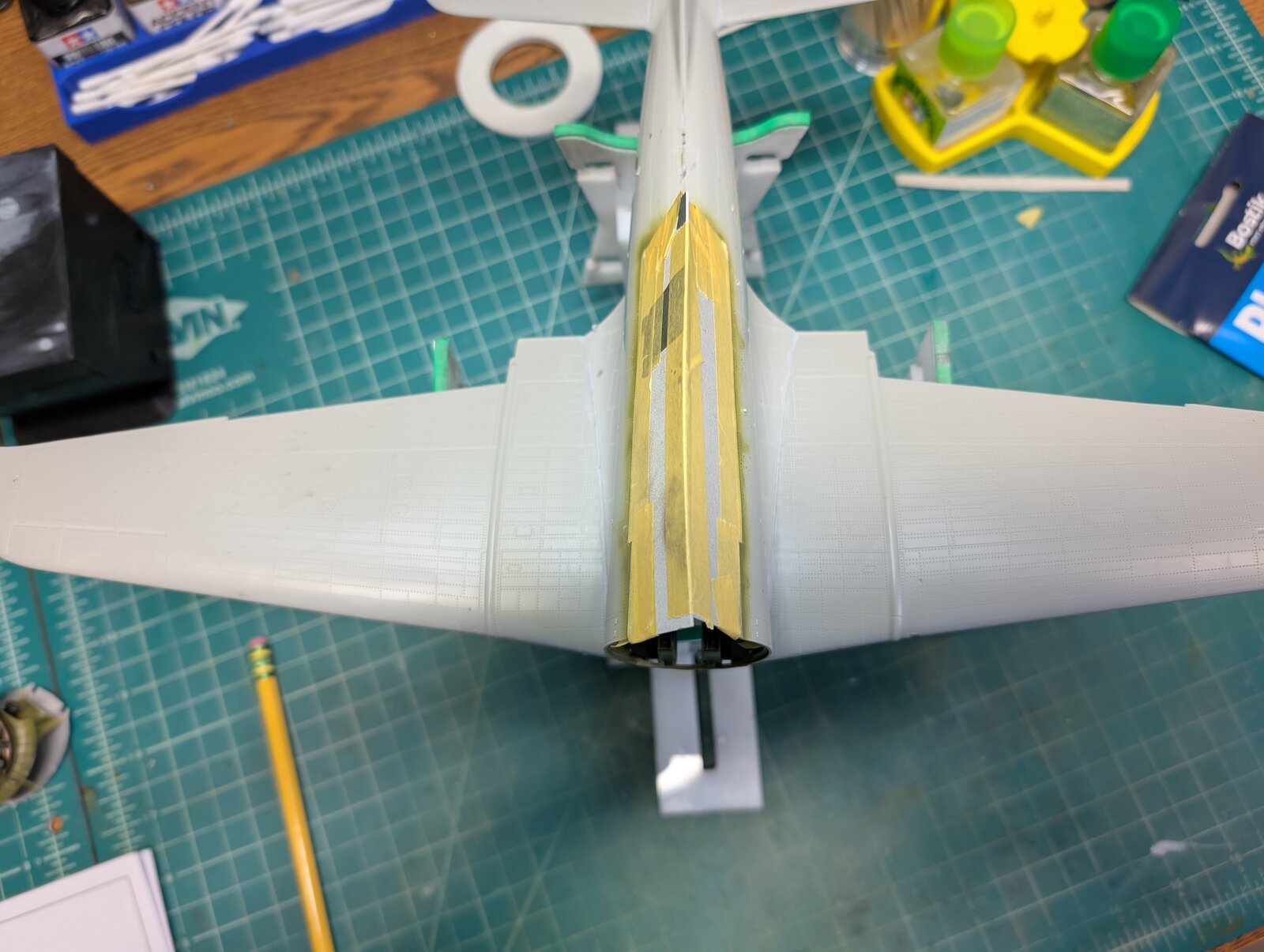

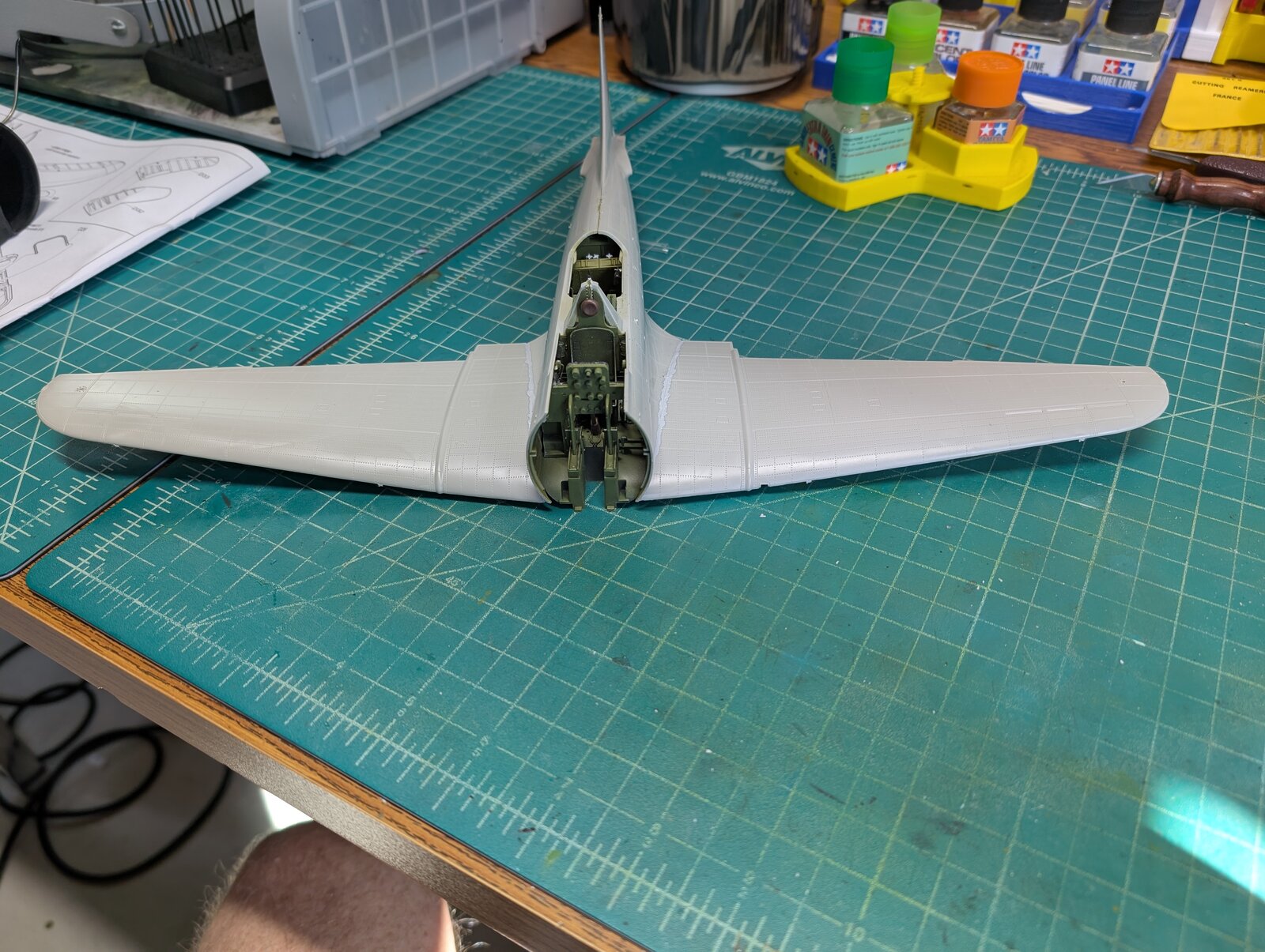

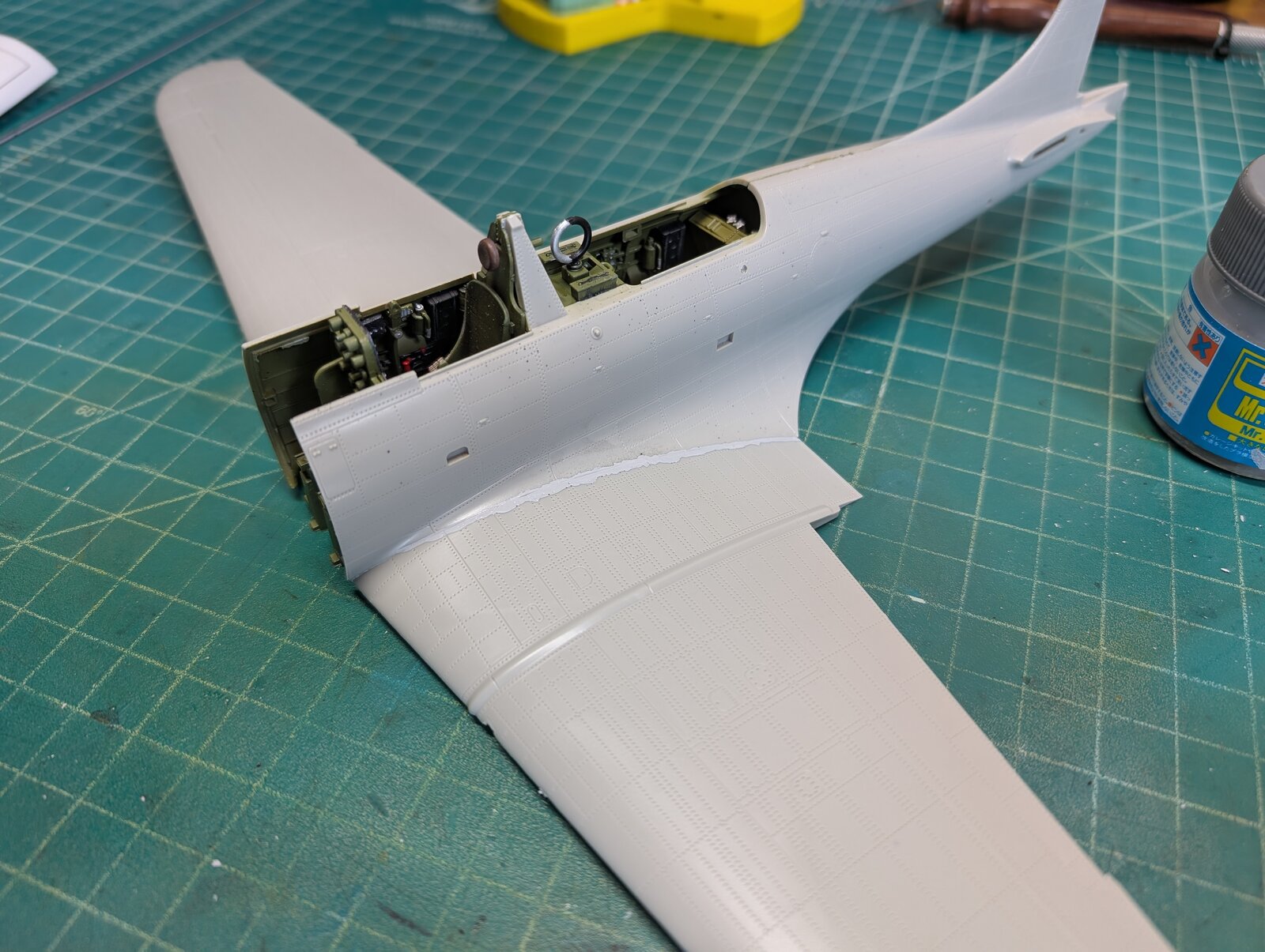

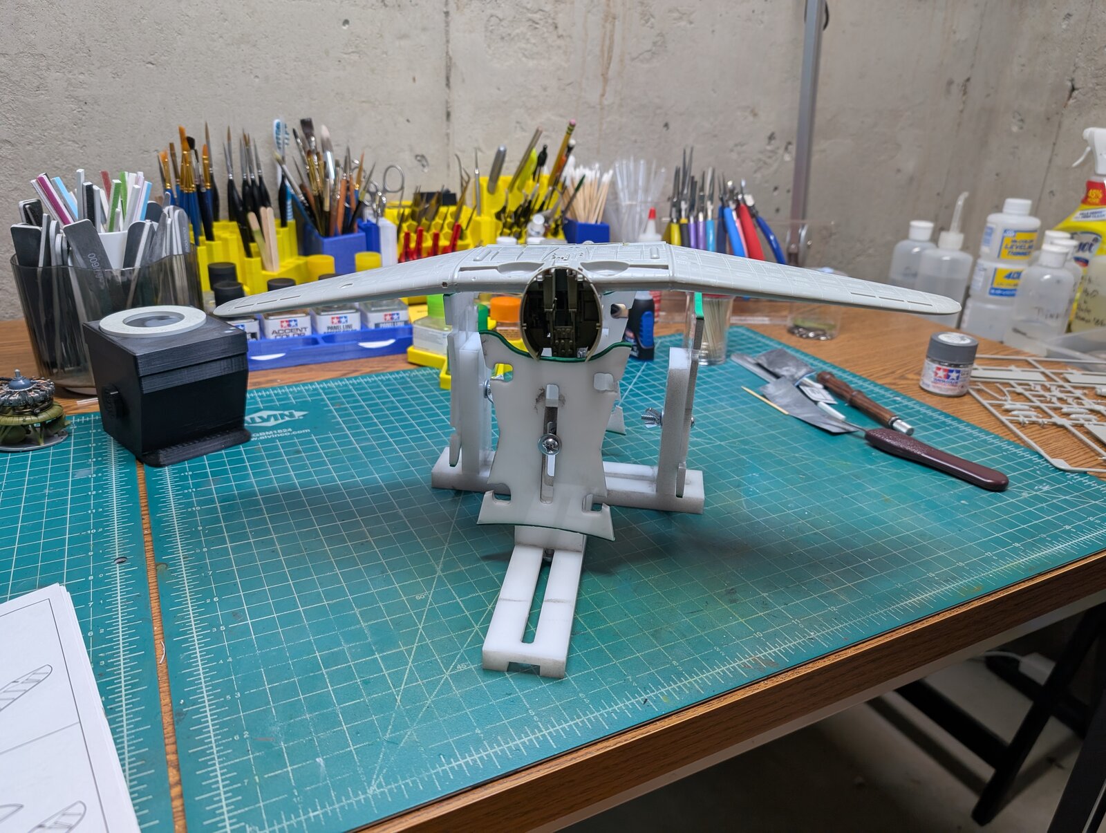

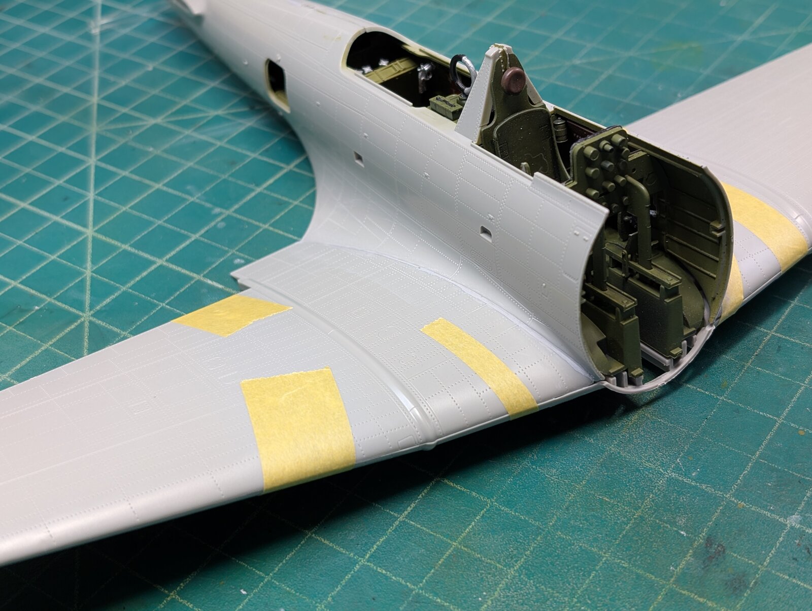

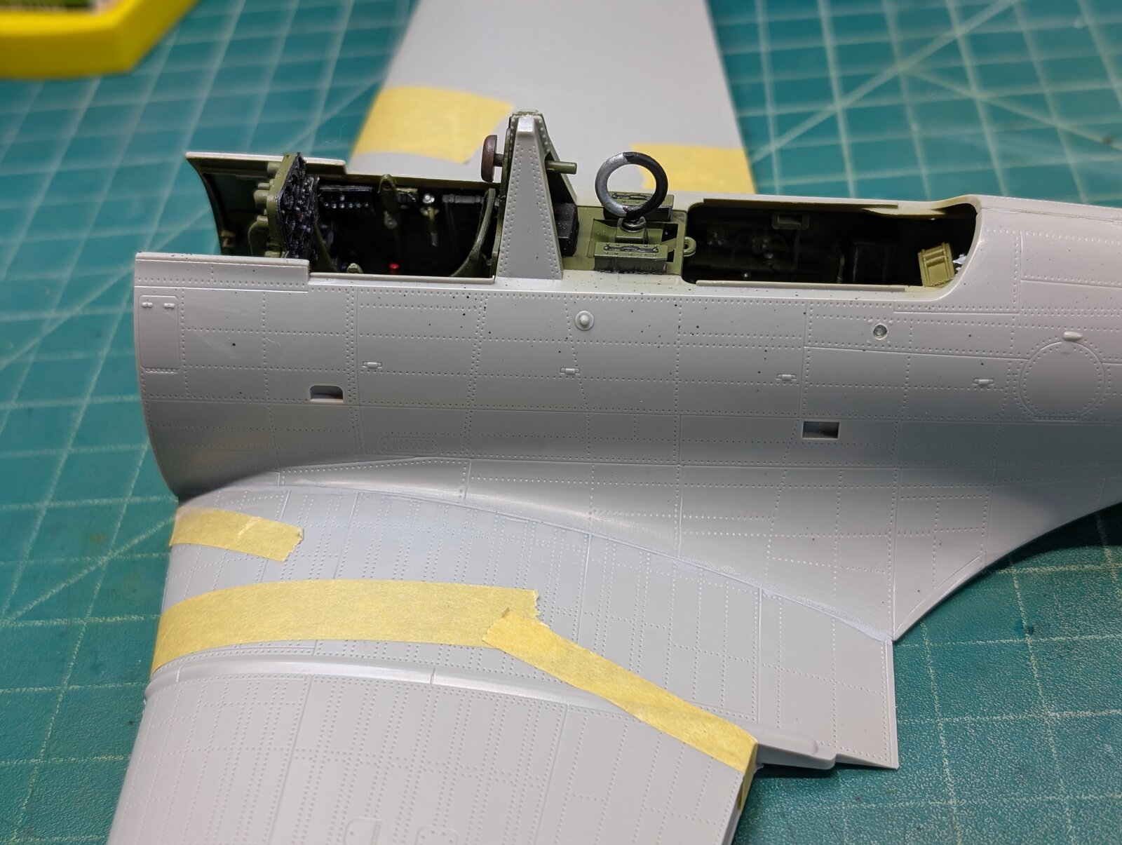

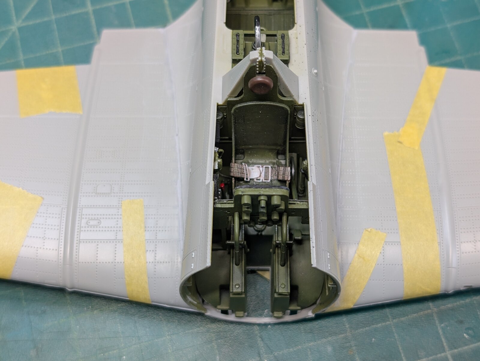

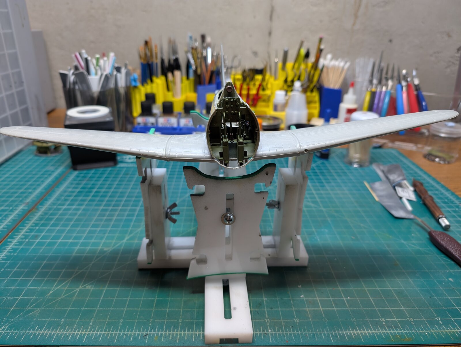

PXL_20250617_143243948.jpgPXL_20250617_143304299.jpgPXL_20250617_143311578.jpg After reading several reviews of prior builds, I saw several from 8-10 yrs ago by a well known modeler by the name of Tom Cleaver. He pointed out that Trumpeter in their instructions, would have you assemble the wings as a fixed unit which eventually attach to the fuselage. This can create a large seam at the wing root/ fuselage junction from his experience. In order to avoid this he recommended attaching the upper wing part on first, then attach the lower wing part to the upper wing part. Well for better of worse I followed his experienced lead. I was able to get the upper wing part attached to the fuselage with a minimal seams. I am filling the seams with Mr Surfacer 500 in several thin to avoid cracking. When fully cured I will remove excess ( hopefully with Mr Color thinner 400 and attach the lower wing parts to the upper. I am attaching a few images of my progress. Slow and steady !! Let me know what you think, comments or suggestions always accepted!
Thanks for your interest!

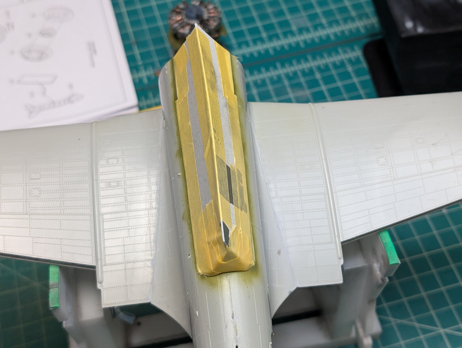

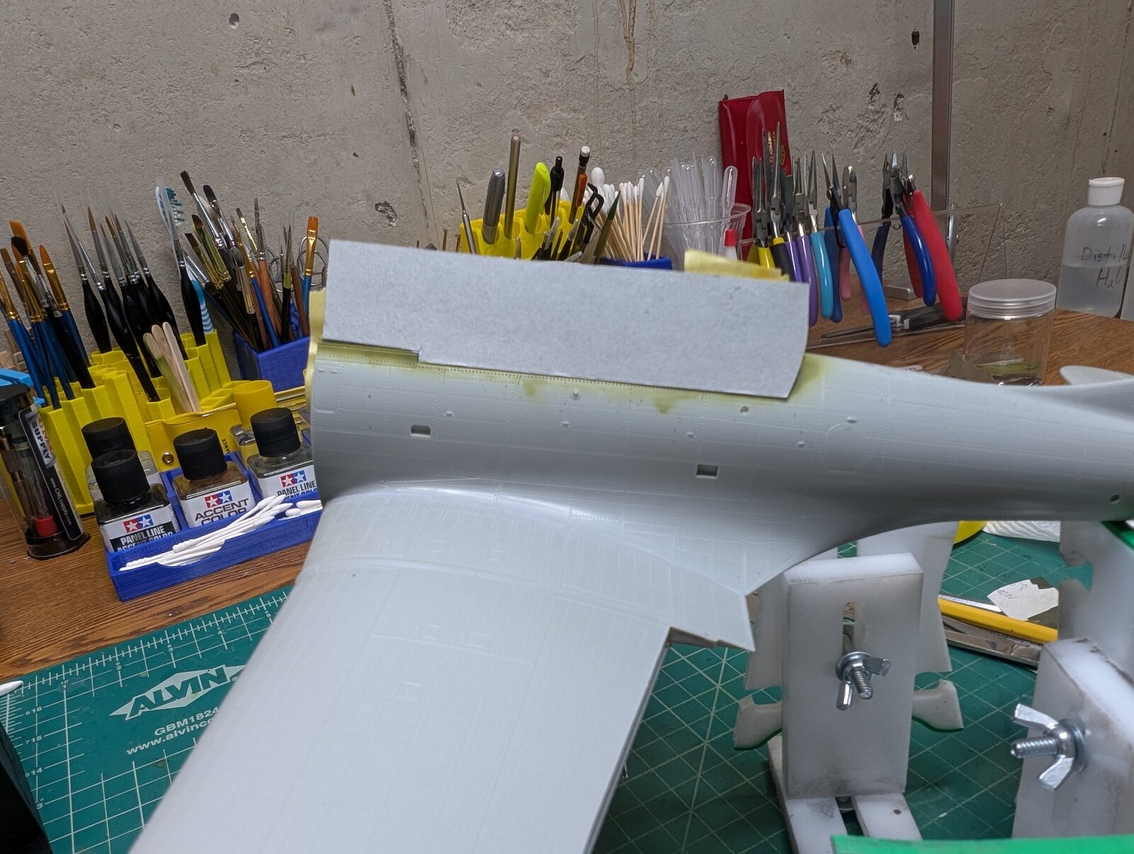

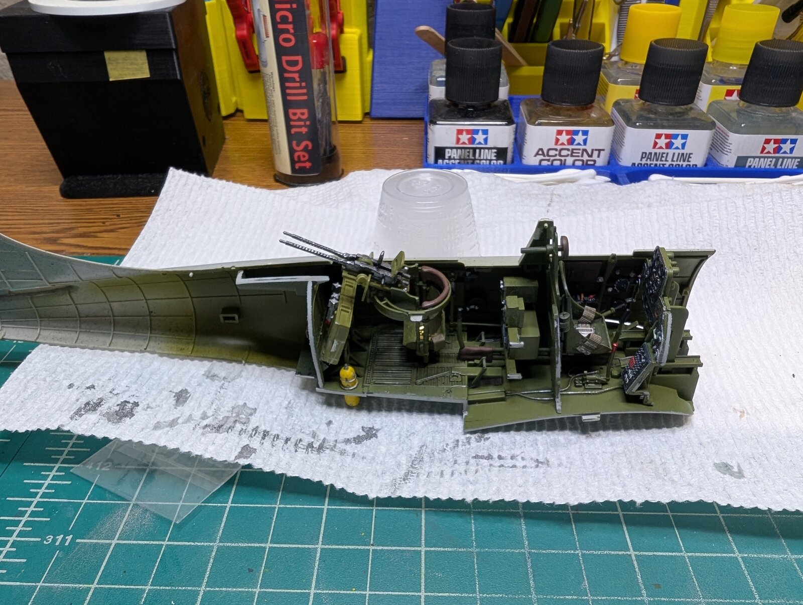

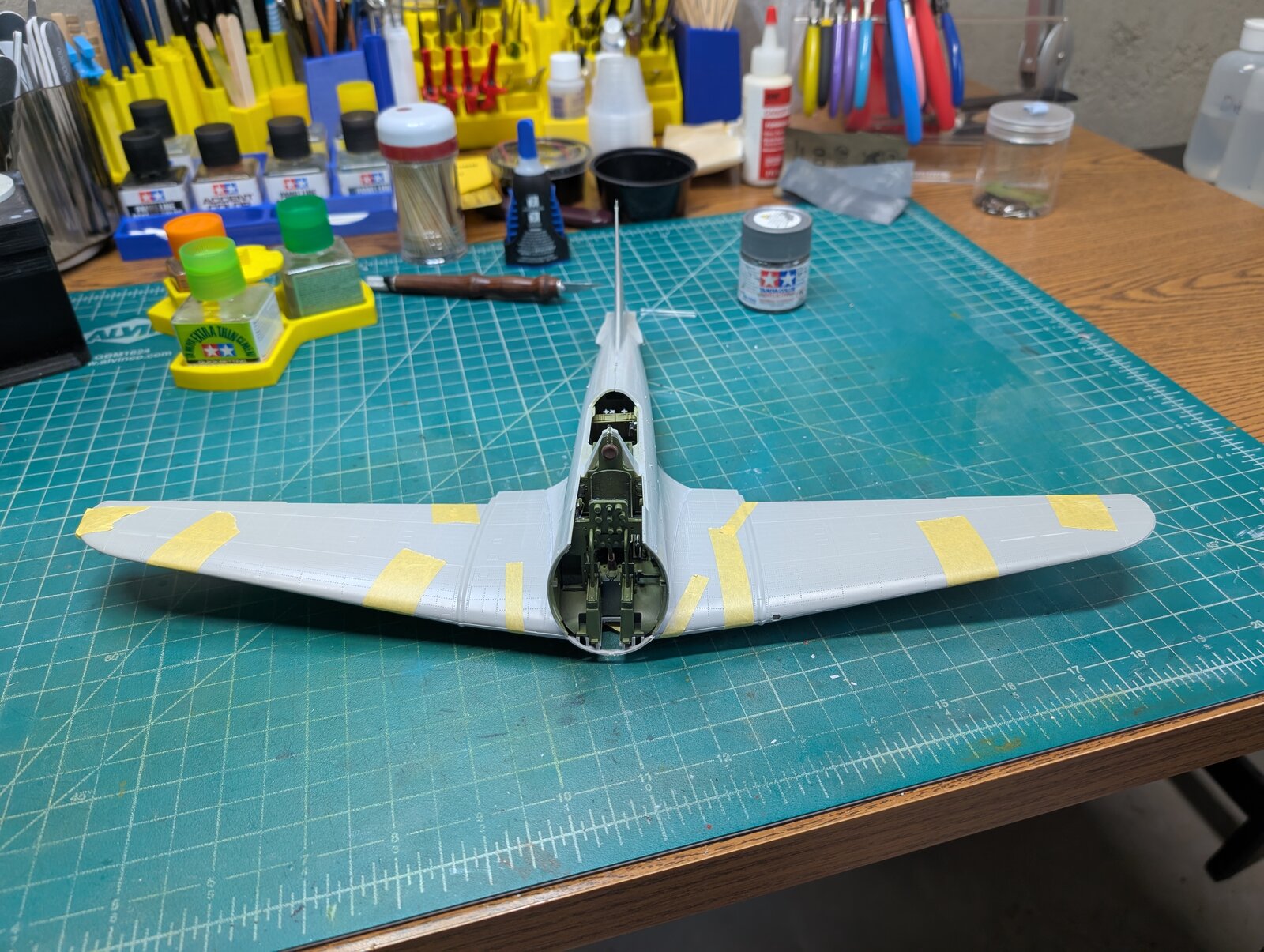

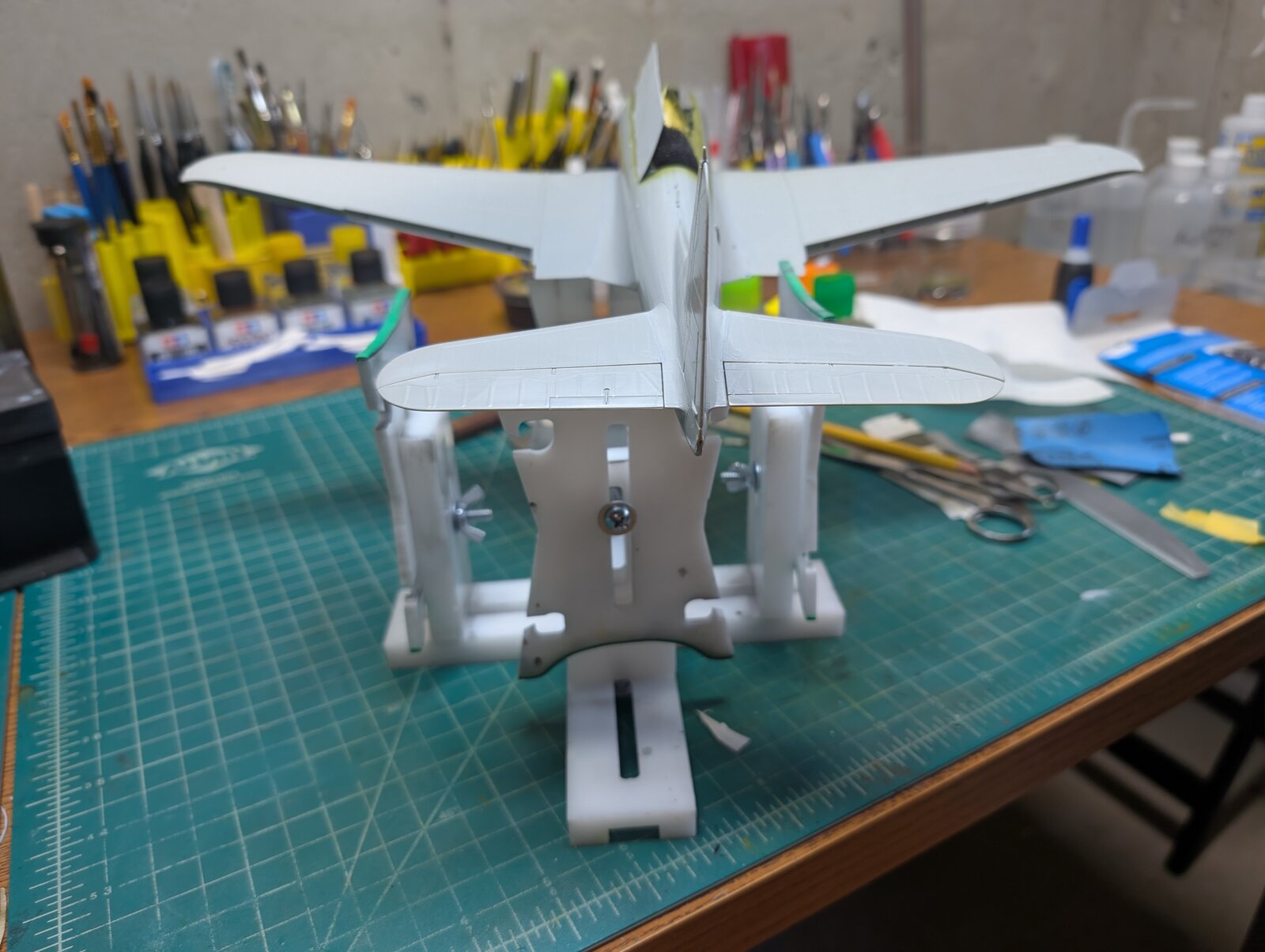

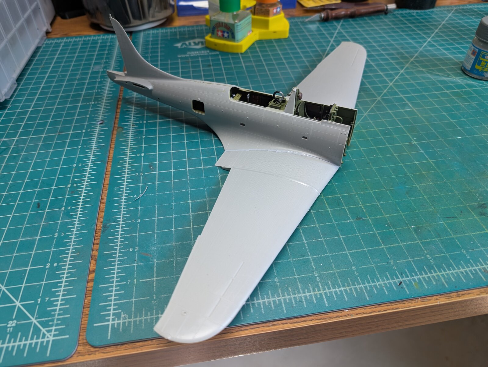

I made some progress PXL_20250618_162114979.jpgPXL_20250618_162124497.jpgPXL_20250618_162132020.jpgPXL_20250618_162142871.jpgPXL_20250618_234050043.jpgPXL_20250618_234111112.jpgPXL_20250618_162114979.jpgPXL_20250618_162124497.jpgPXL_20250618_162132020.jpgPXL_20250618_162142871.jpgPXL_20250618_234050043.jpgPXL_20250618_234111112.jpg by attaching the lower Wing parts to the upper Wing parts. They did fit but it was a little bit of a struggle. Once they were together, I taped them in place in preparation for gluing. After gluing the upper and lower halves of the wings togather I finished filling in the seam at the wing root along the upper surface with Mr Surfacer 500. I did learn one thing in this process. Once you put Mr. Surfacer 500, you should remove the excess within 30 minutes of application. If you let it cure overnight (like I did) it makes the process much more difficult to remove. I did find that that Mr. Hobby 400 thinner worked nicely followed by applications of isopropyl alcohol on a q-tip to remove the excess and create a nice thin panel line. I have a few pictures to show the finished product before gluing the two Wing halves together.

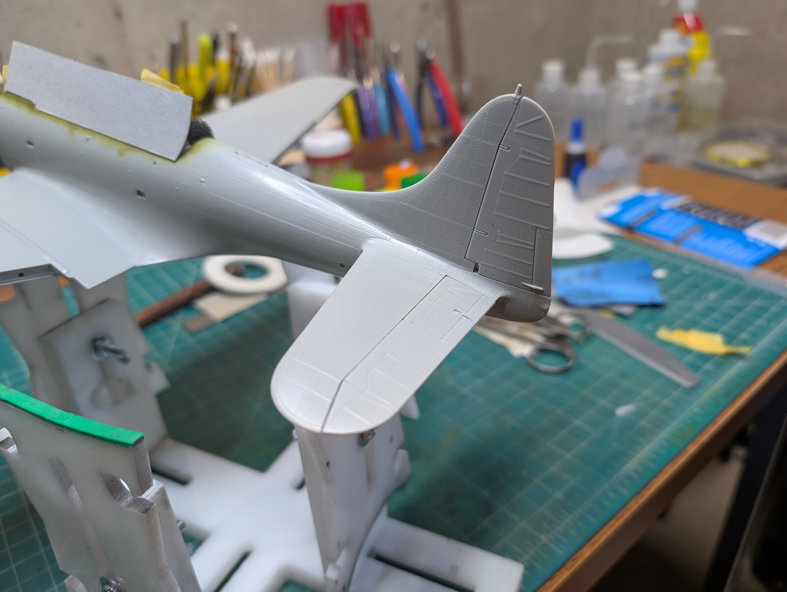

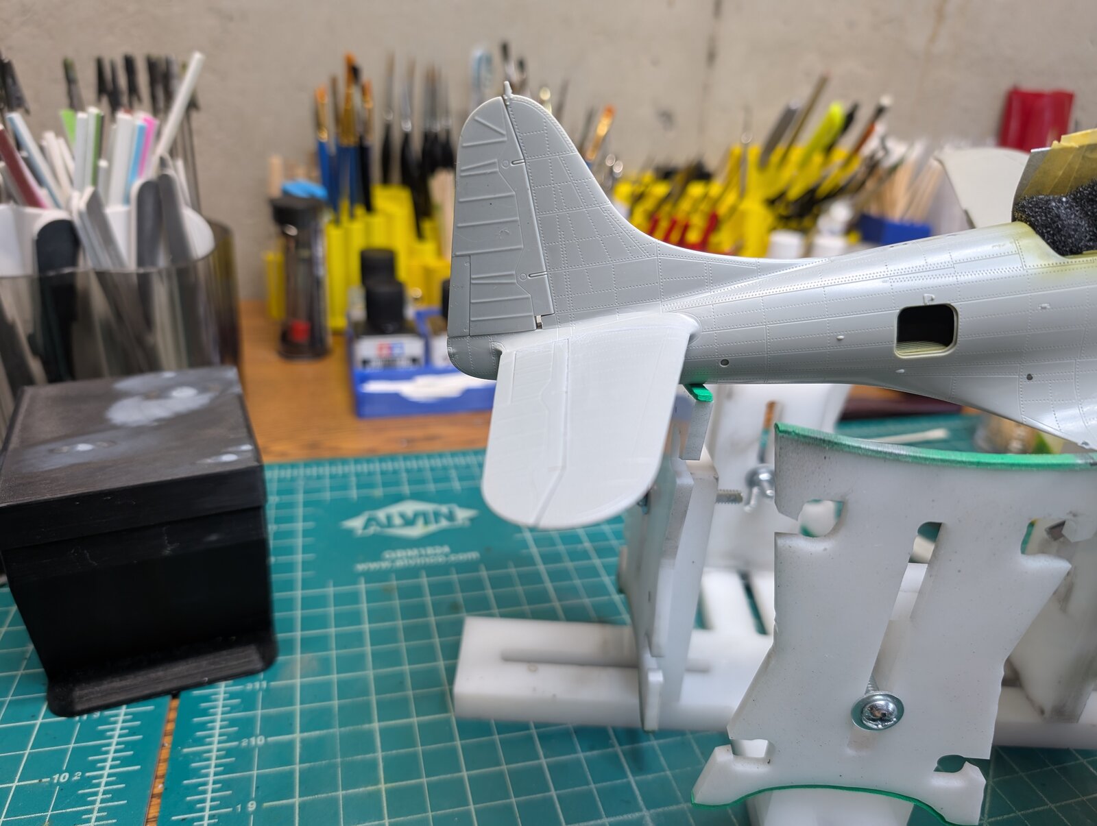

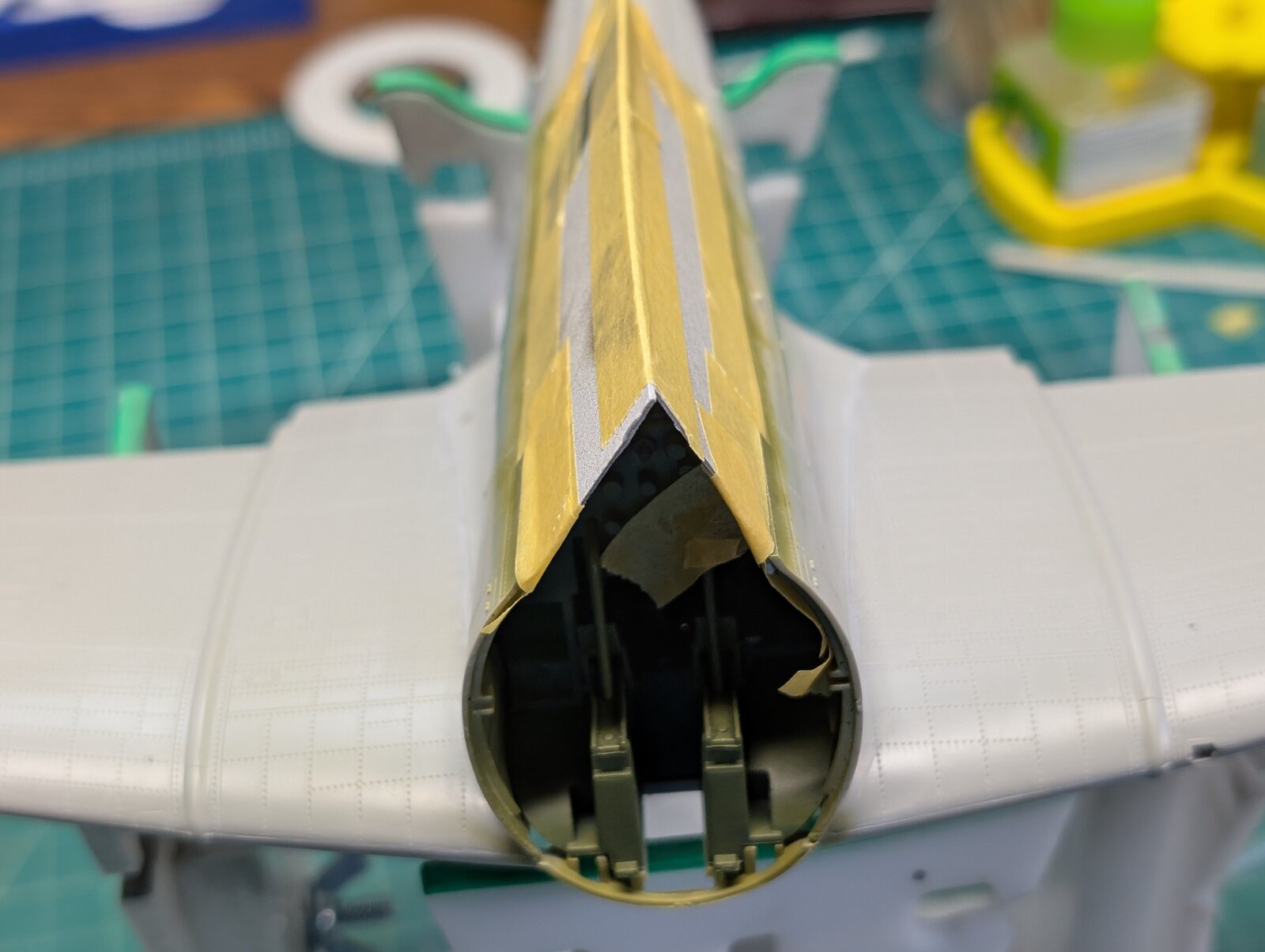

I am checking back in with a small bit of progress on the SBD Dauntless 3 . I finished the attachment of the horizontal stabilizers and the mild seam gap at their junction with the fuselage. Once filled with Mr Surfacer 500 and 1200, removing the excess with rubbing alcohol and finished with some fine grit sanding. Once the rudder and horizontal stabilizers were attached and seams filled with excess removed with rubbing alcohol attention was directed at fine spraying of the cockpit edge and pilot seat support wall with Mr Color C351 zinc chromate. Once dried my attention was next directed to cover up the cockpit for future painting. I spent a lot of time trying to figure out how to do this. No room for any purchase for masking tape on the inside of the cockpit walls. So I came up with a idea. I measured and carefully cut out two pieces of thin cardboard to match the outer surface of the cockpit margin. I held the first piece in position with blue tack adhesive puddy followed by small pieces of Tamiya masking tape on the interior surfaces of the cockpit and cardboard. The rear of the cockpit was filled or gently stuffed with thin pieces of foam to abut to the curved rear margin of the bombers cockpit. Then a second piece of cardboard was attached to the other side like the previous one. All in all after about 90 minutes of fiddling I git pretty good margins all around. Further masking tape on the outside of the cardboard seemed to add the needed structure. Hope it works, if so it could be a good plan for future builds when needed.
Well that's all for now. Much work to do will keep you posted as the steps unveil themselves.
Let me know your thoughts
All the best Gary

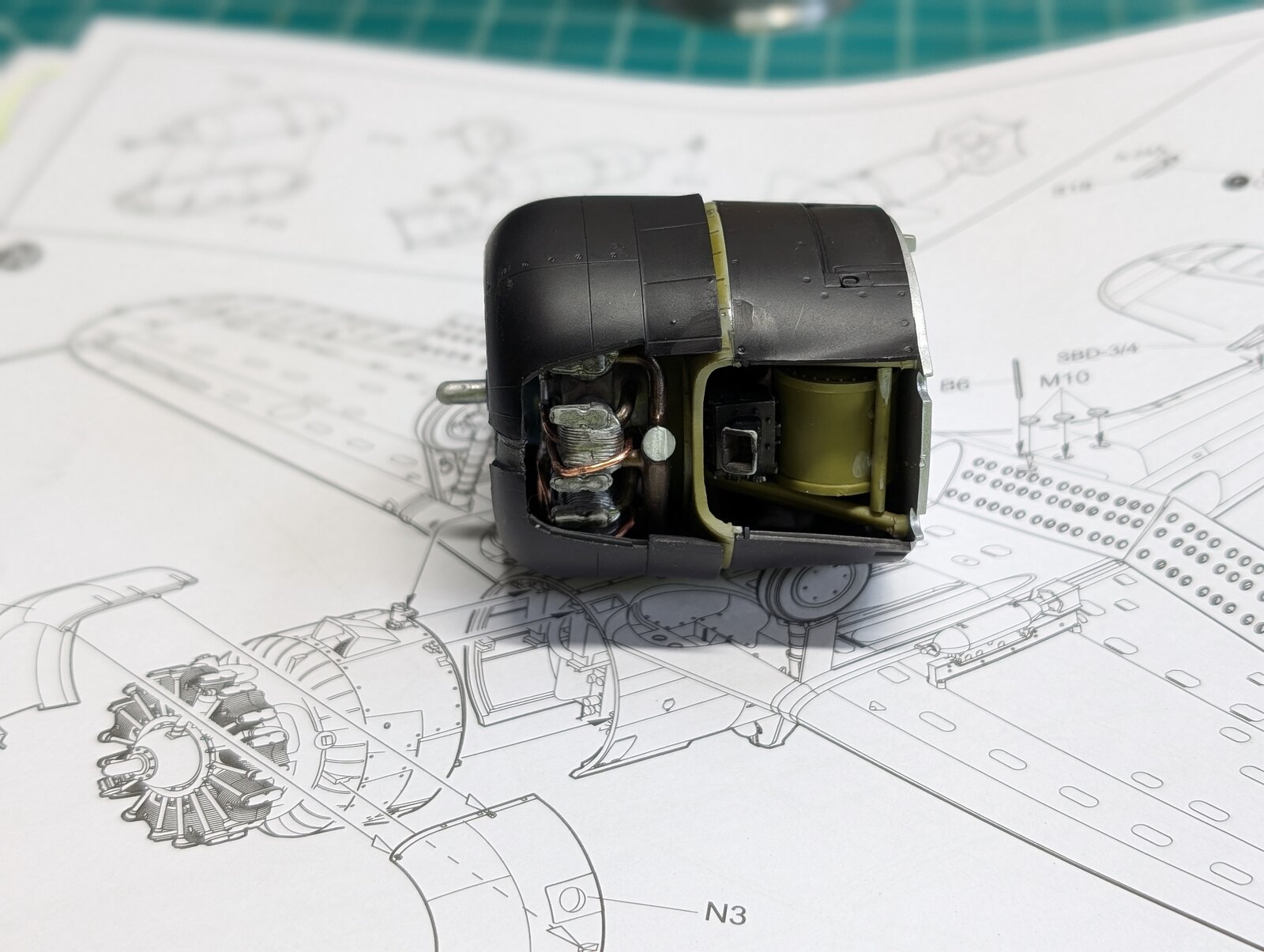

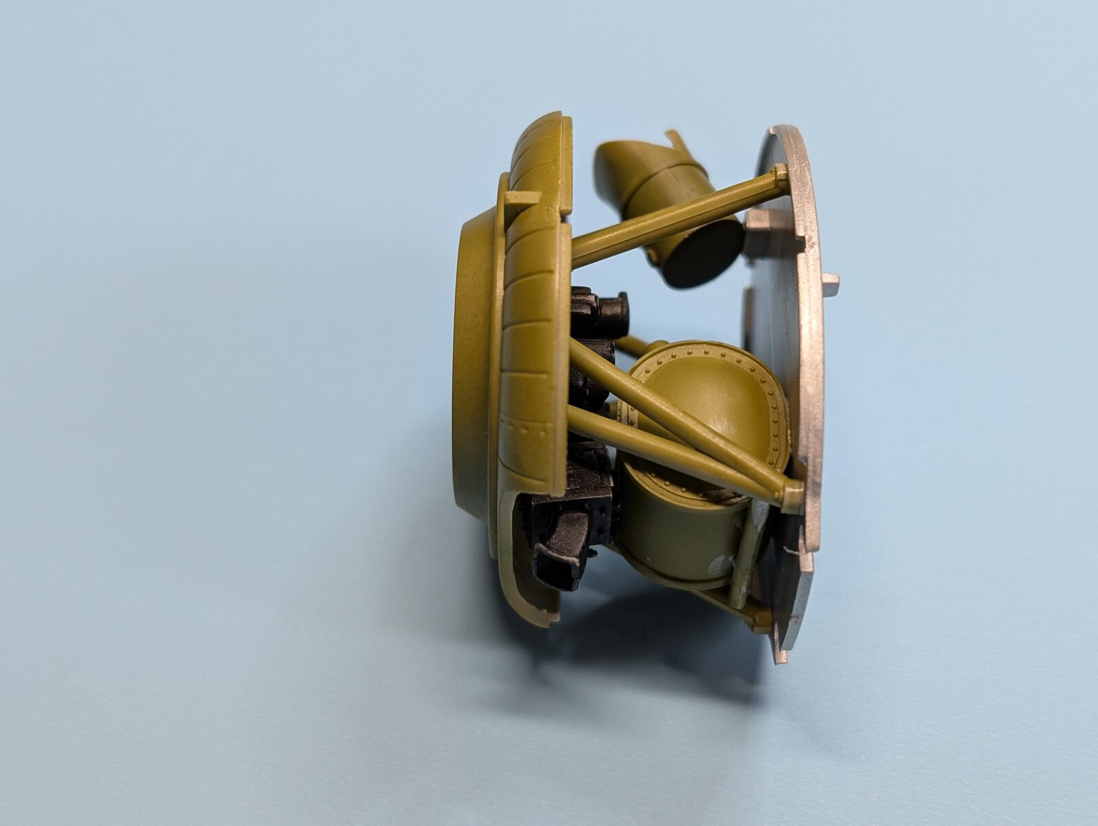

Hello again.
I had a little time to return to the bench and work on the dauntless. I thought I would show a little of my progress.

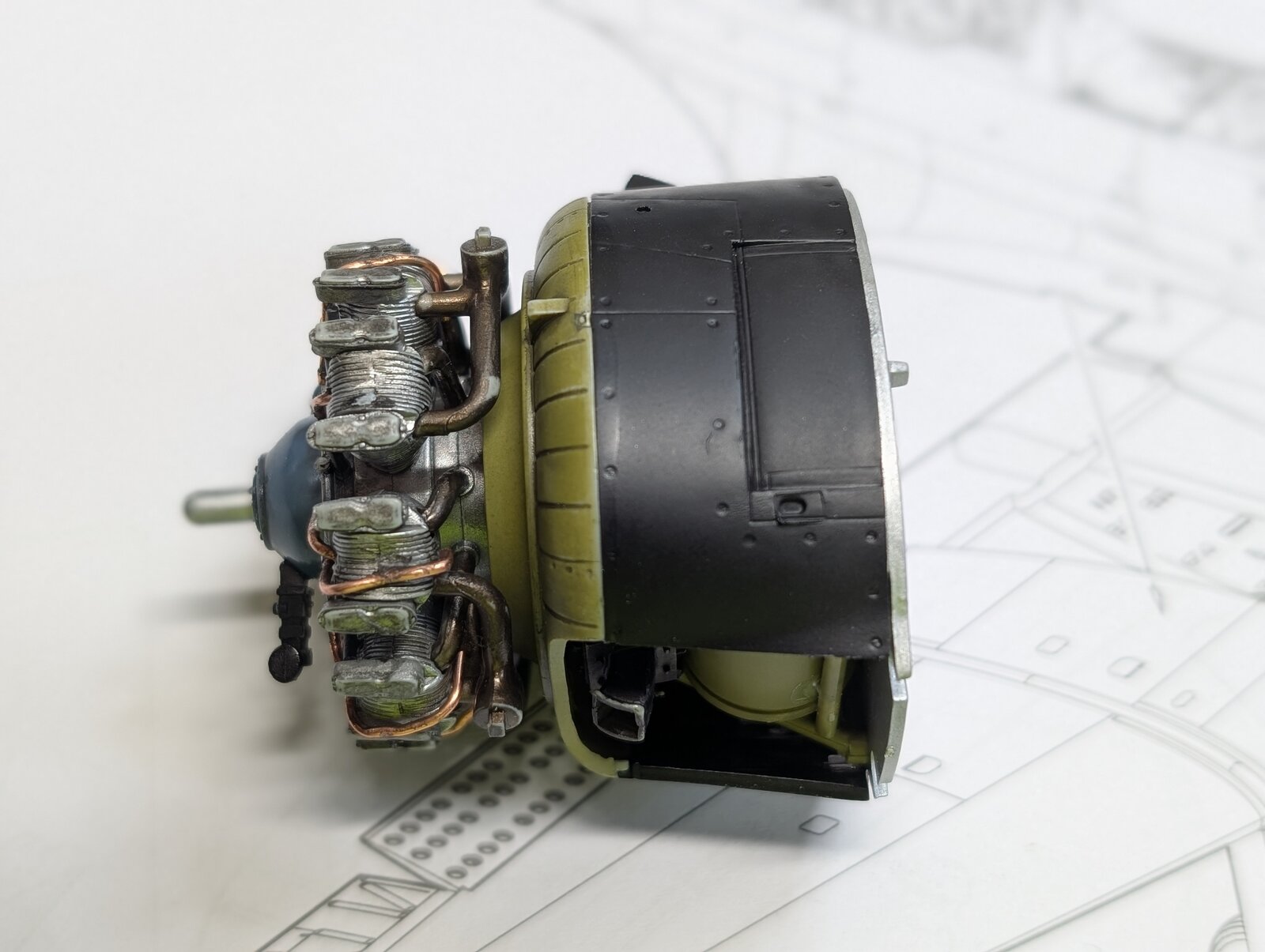

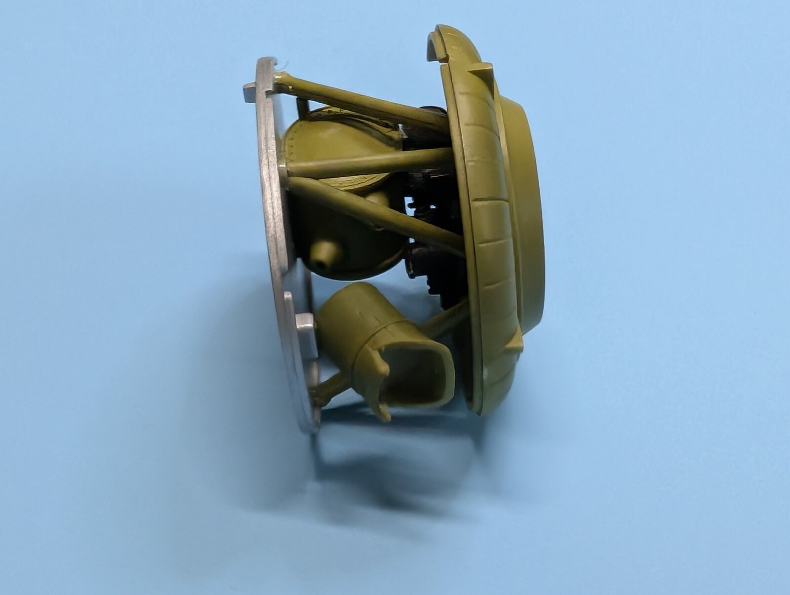

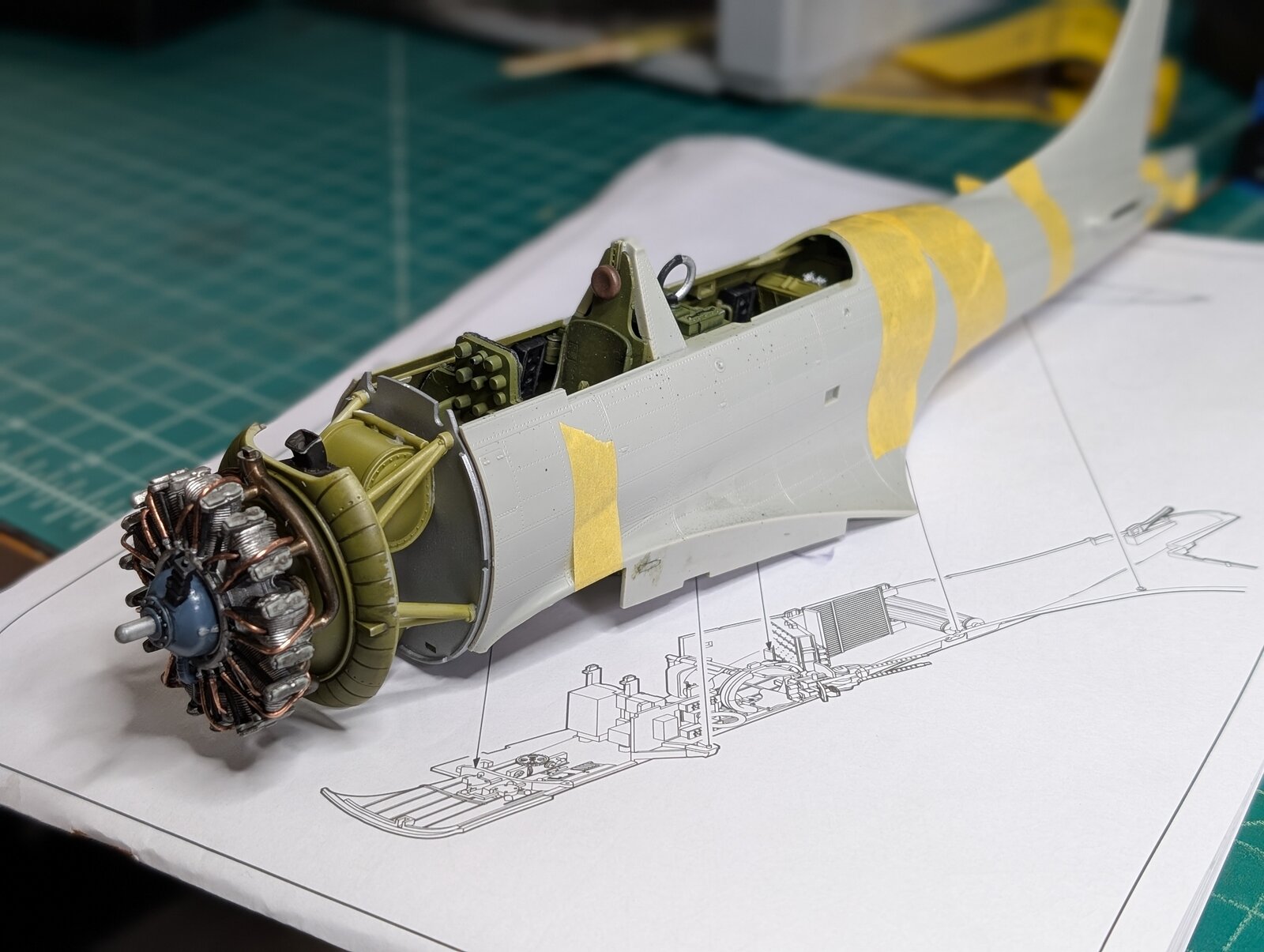

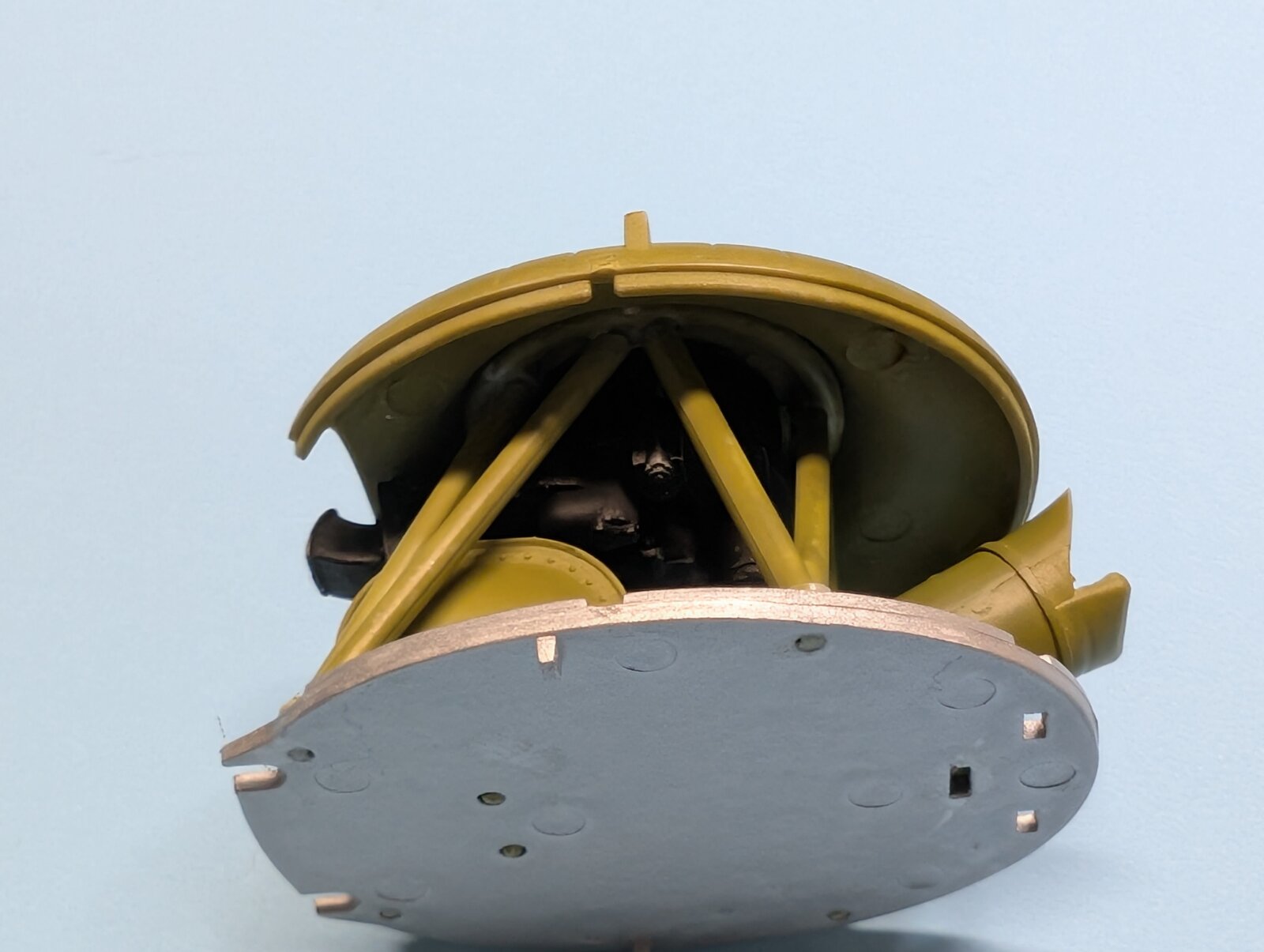

I directed myself to installing the cowling onto the radial engine and its support structures. Once again Trumpeter is a far cry away from the accuracy of its instructions, diagrams and general fit when compared to Tamiya kits. After spending time trying how to correctly mount the radial engine on to its support plate I thought I had it correct. Once I glued the engine on to the backing plate, fitted the side cowling plates together and looked at the whole engine structure I seemed rather please with myself. However, It wasn't until I put together the front cowling pieces together and tried to attach them to the engine I realized I mounted the engine 45 degree the wrong way so the main exhausts would not line up with the holes in the cowling ( LOL!!!!). I blame once again my inexperience and Trumpeter's poor drawings in this matter.PXL_20250624_200601519.PORTRAIT.jpgPXL_20250624_200617893.PORTRAIT.jpgPXL_20250624_200624092.PORTRAIT.jpgPXL_20250625_162318793.PORTRAIT.jpg
However all in all the engine structure looked really good to me and was not worth destroying all that detail just to make it structurally correct. In addition once the the front cowling pieces were assembled and glued to the rest of the housing I realized no one could see the exhausts and I would glue external exhaust pipes coming from the engine and no one would notice the difference. Only you guys will know !!

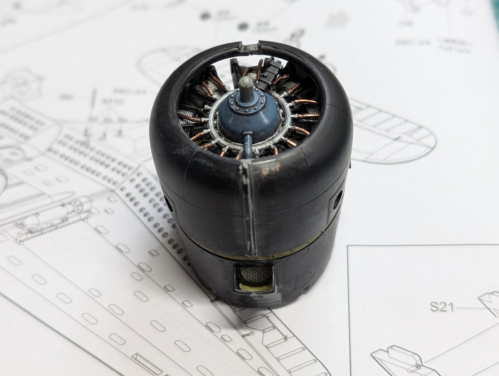

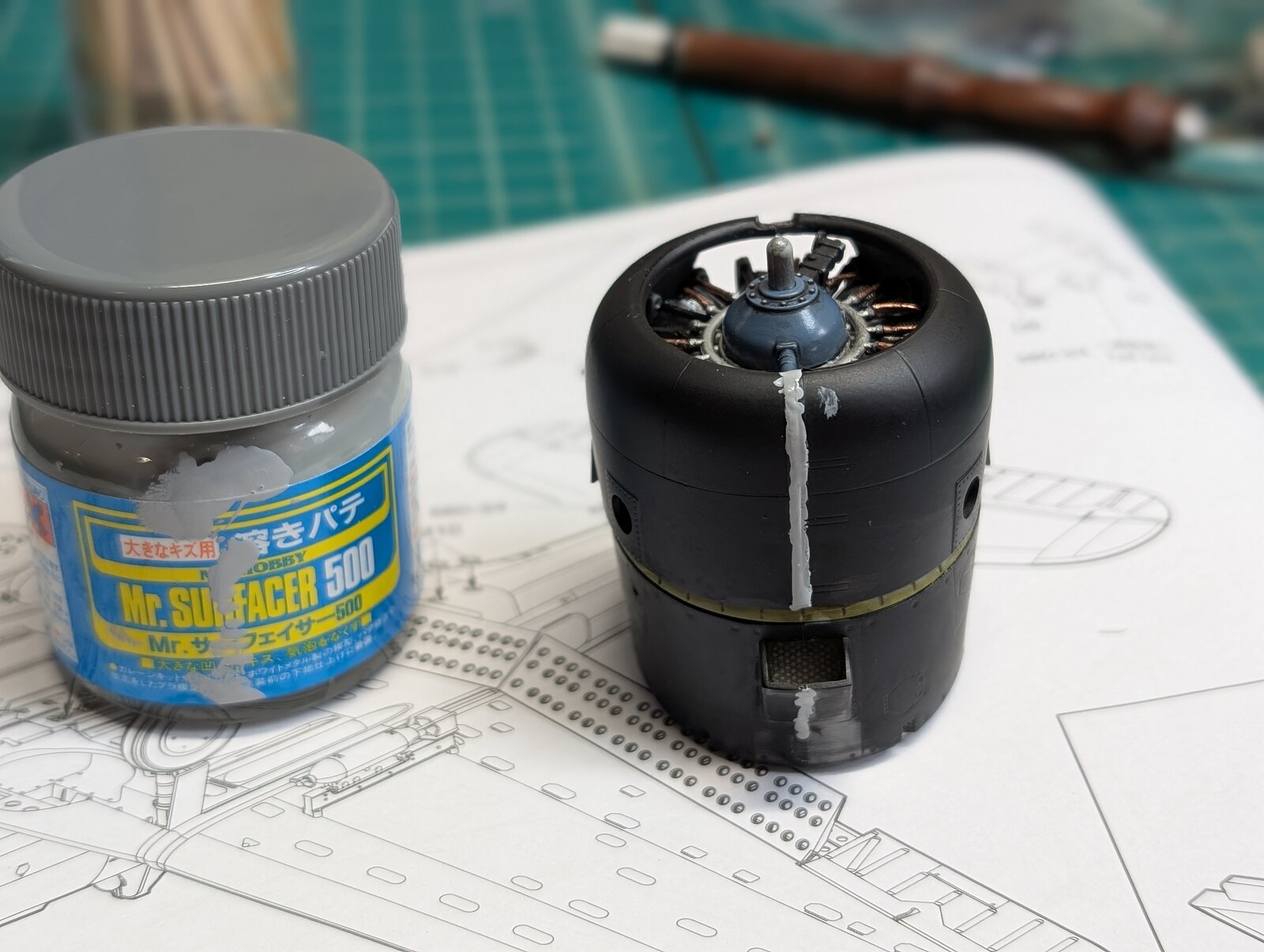

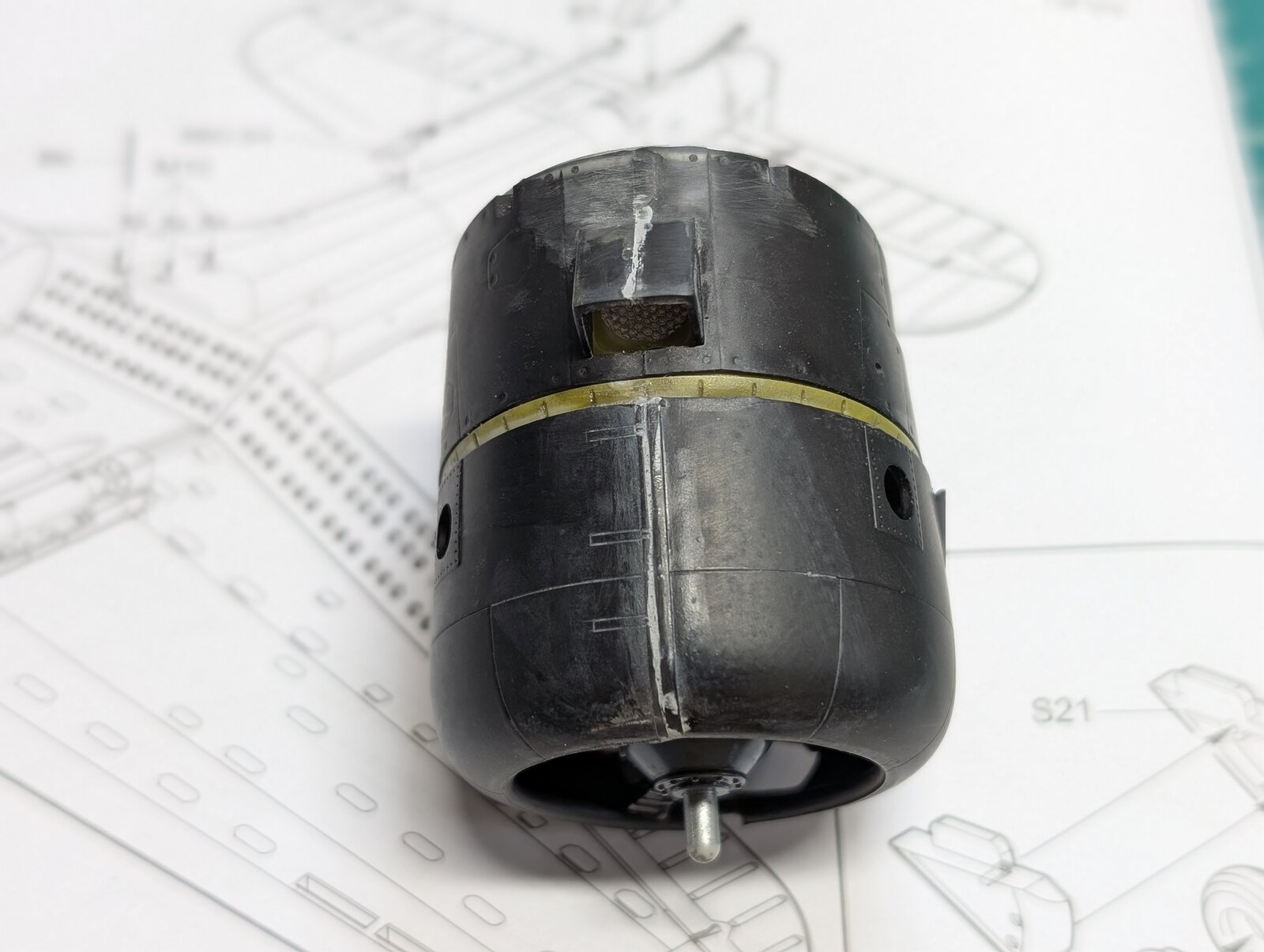

So after a short break I returned to the bench and looked at the engine structure and notice I need to fill the cowling seam. So out came Mr. Surfacer 500 , fine brush and filled the seamed.@0 minutes later out came Mr. Hobby thinner /leveler and isopropyl alcohol and took off the excess. A little fine grit sanding and I think I was done and ready to prepare for priming .PXL_20250625_162858057.PORTRAIT.jpgPXL_20250625_164853176.PORTRAIT.jpgPXL_20250625_164904403.PORTRAIT.jpgPXL_20250625_164910765.PORTRAIT.jpg

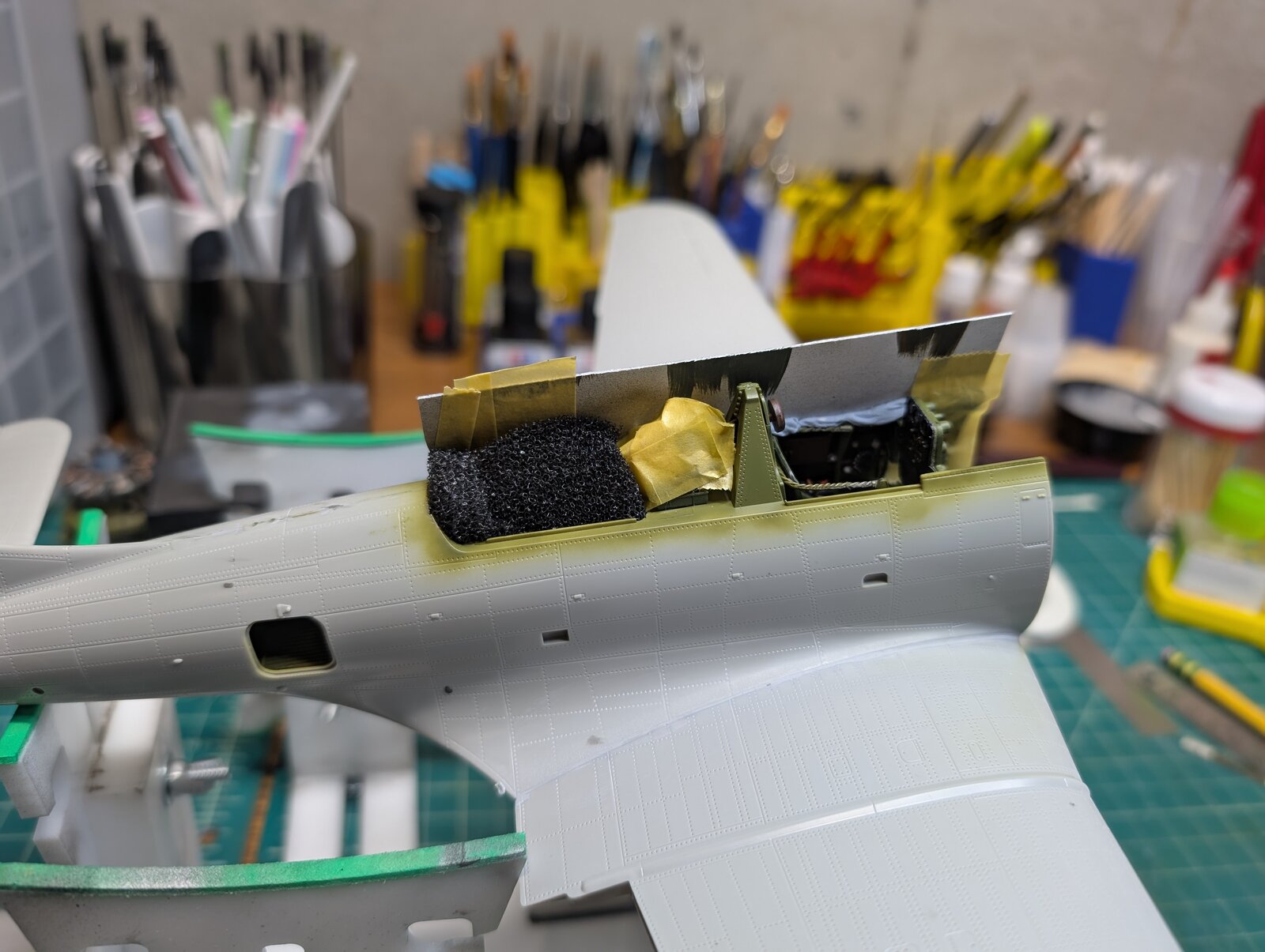

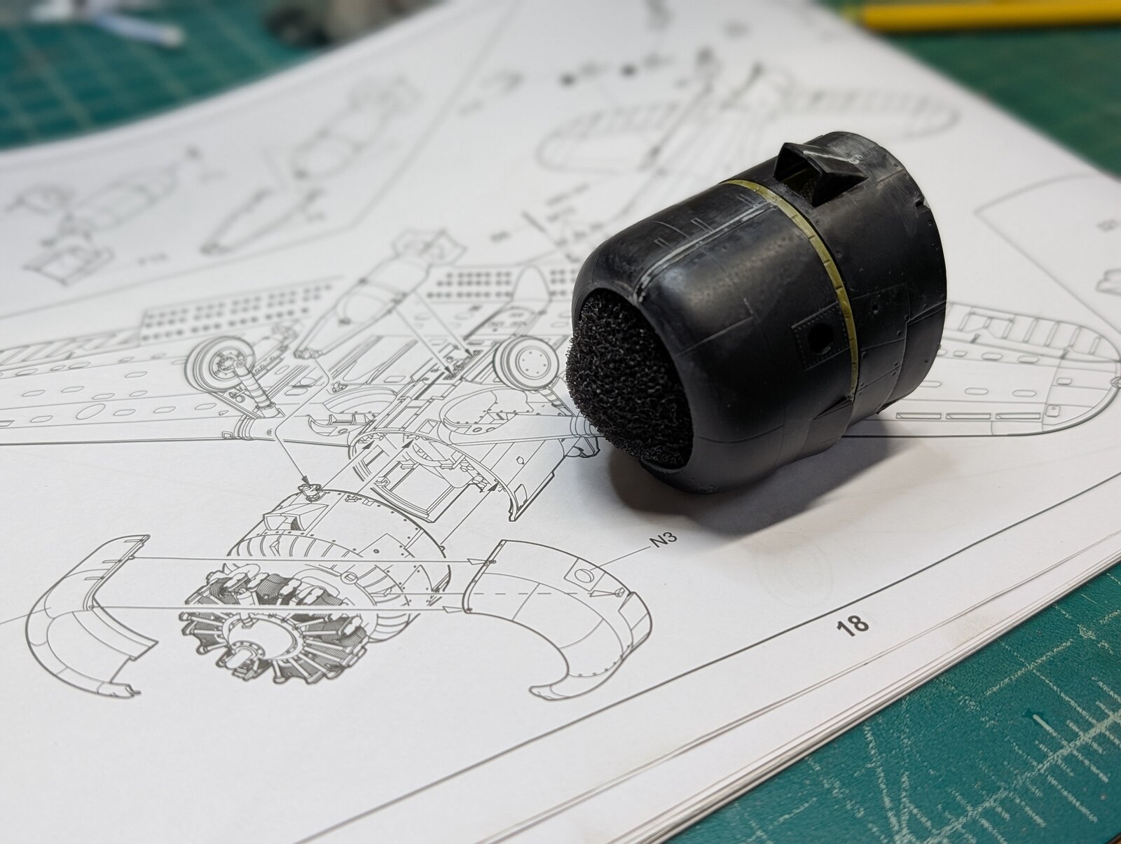

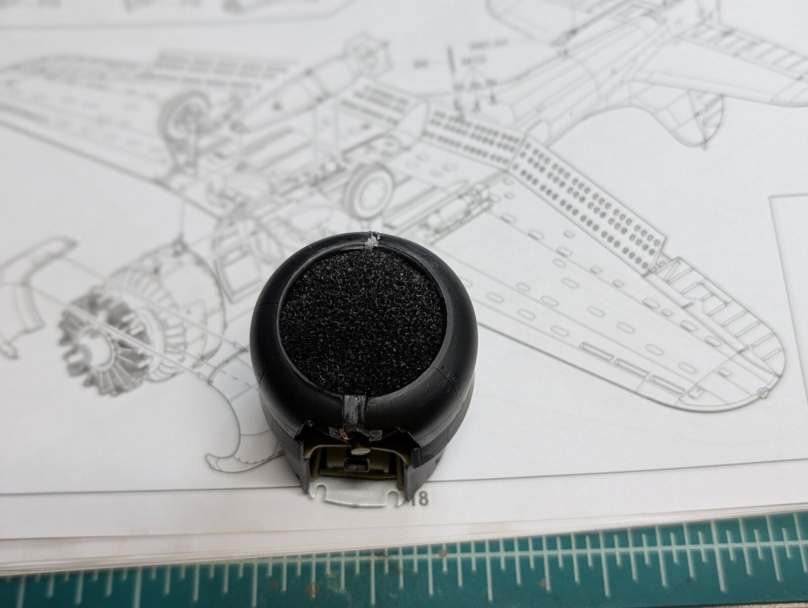

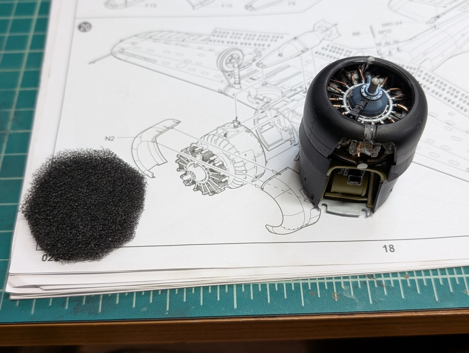

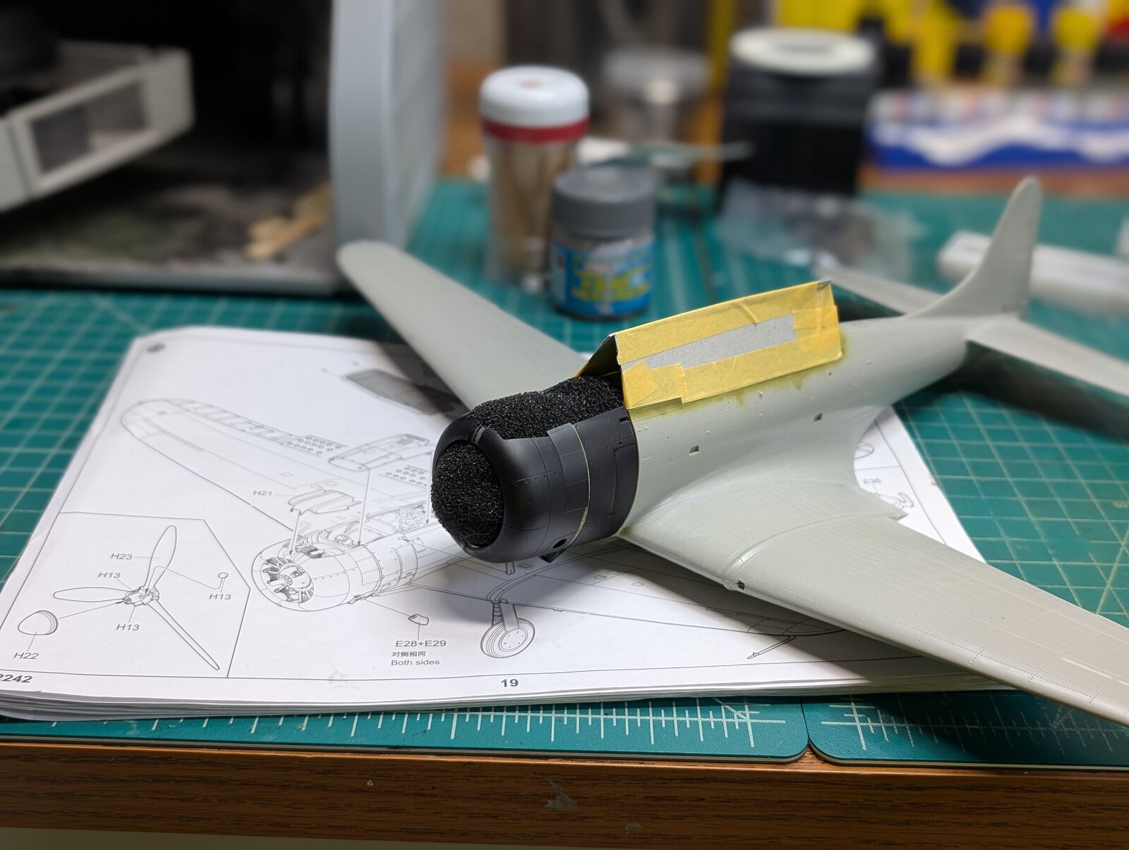

I realized I wasn't quite finished with the engine. I now needed to protect all that nice detail I did from wiring the engine. I have seen many people attack this problem in several different ways. Tamiya masking tape always seems the simplest and some times is. I have found after 40 years of being a physician , the simplest route isn't always the best route. Some time there is no room for tape to have a purchase, other times it pulls off over time or it can have an incomplete seal often at rounded margins. Now many of you who are far more experienced than I have techniques which you employ with varying degrees of success. I once saw a experienced modeler post in a forum the use of thin foam sheets cut to specific shapes then literally stuffed into position making a nice seal with the margin of the cockpit or opening ( in this case the front opening of the engine) and does a nice job in protecting the part which is covered by the foam from future spray painting with the airbrush.
PXL_20250625_165303185.PORTRAIT.jpgPXL_20250625_165317548.PORTRAIT.jpgPXL_20250625_171258626.PORTRAIT.jpg of what I did for those not familiar with this little technique.
Well that was all for today. Now on the small bits like wheels, landing gear, bombs etc.in preparation for lots of airbrushing to follow. I do plan on black basing this beast first, then giving it a two tone paint job with little post shading techniques. My hope is to give this bird some subtle tonal qualities to the paint scheme (remembering when Richard Best flew this plane the planes were essentially brand new!
