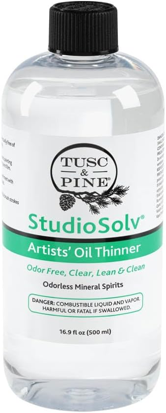

I've not had trouble getting the Tamiya panel liner off of X-22 or LP-9. Soak a Q-tip in mild turpentine, blot about 60% of it off and rub softly, very softly at first and add a little more pressure until it comes off. One thing that can go wrong is too much thinner or too much pressure will remove the part you want to leave in, so sometimes I blot 75% of the thinner off the bud.
I've had the panel liner stain the acrylic paint without the clear 1st, but that is not what you indicated. Are you letting the panel liner dry completely? If so, maybe leave the thinner there for 20 to 40 seconds then rub?
The oil washes are more forgiving, I think the Tamiya product is a bit hot. But if using oils you get a 1-2 week dry time so I do not use them often.
Edit: I stopped using X20A to thin my Tamiya paint, settled on MLT which is a lacquer, so maybe that is part of the reason? I hated 7th grade Chemistry, so I stay away from the topic in general :-)
I've settled on this brand of thinner, but think there's a hundred others that will work well.
