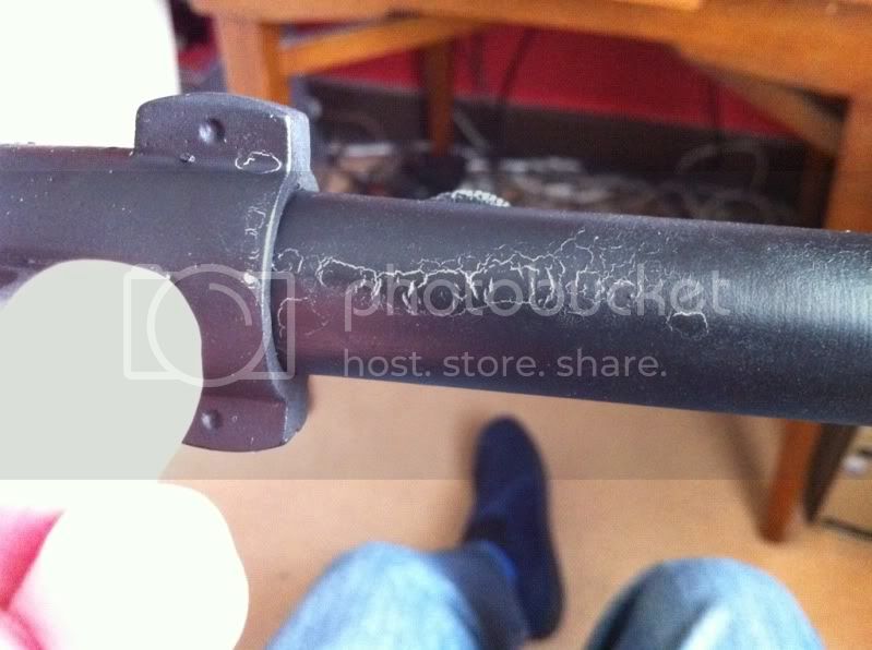

I have a project thats all gone a little wrong and i'm wanting to start from scratch if poss.
It's a resin kit that has been primered, painted with 3 separate coats of paint, had AK chipping fluids applied and a final coat of paint applied. Is there some way in which i can strip all that off of the kit without damaging it?
Thanks in advance for any help.
TTFN Matt

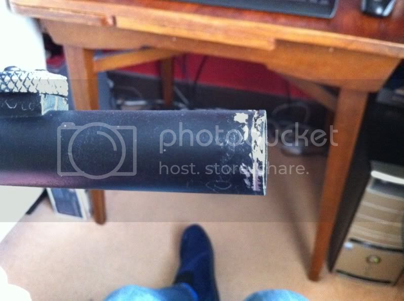

The chipping fluid is cracking the paint all over, i guess thats how it works.....but also i'm not sure the 'chipping' effect fits with the model....i'm after more of a worn polished look.
TTFN Matt
ahh looks like you hadny let it dry propper.
use warm water and a old tooth brush to remove the paint were you sprayed the chipping fluidit may take a bit of elbo grease. soaK the gun it the wather for a few mins, Just not hot water because that could damage the resin whe you take it out.

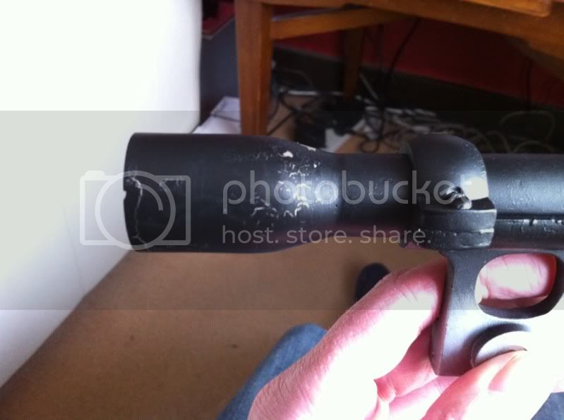

Thanks for the replies guys.....guess it's back to the drawing board for me, not sure how's best to get the worn metal look i'm after. Had hoped chipping was the way but it just didn't look right. ::)

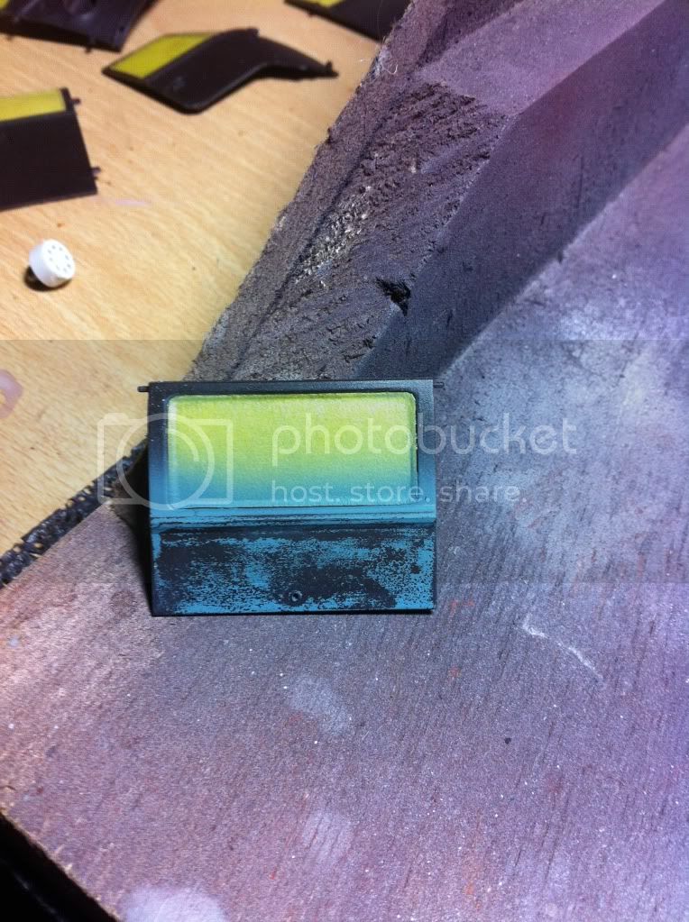

one coat will give you light chipping. and it will work after a few days. i sprayed the back door of the vw a few days ago with the chipping and just done the paint on it now and i gave it a light ribbing with a brush. and this is what i got.
i recomend you try it on a bit of scrap, also try out Hair spray withh do teh same with requires more work., aslo try that on scrap!
To be honest Matt ,I dont think chipping is the way to go on a gun . They seem to wear more that chip ,why not try some of AK Interactive 'Steel' pigments ,its fantastic stuff and just needs rubbed on like graphite to give a brilliant metal finish ;)

Thanks guys, that chipping looks well nice spud what sorta brush did you use?
Yeah Chris thats what i thought when i saw the effect on the gun.....just didn't look right somehow. ::)

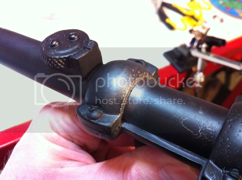

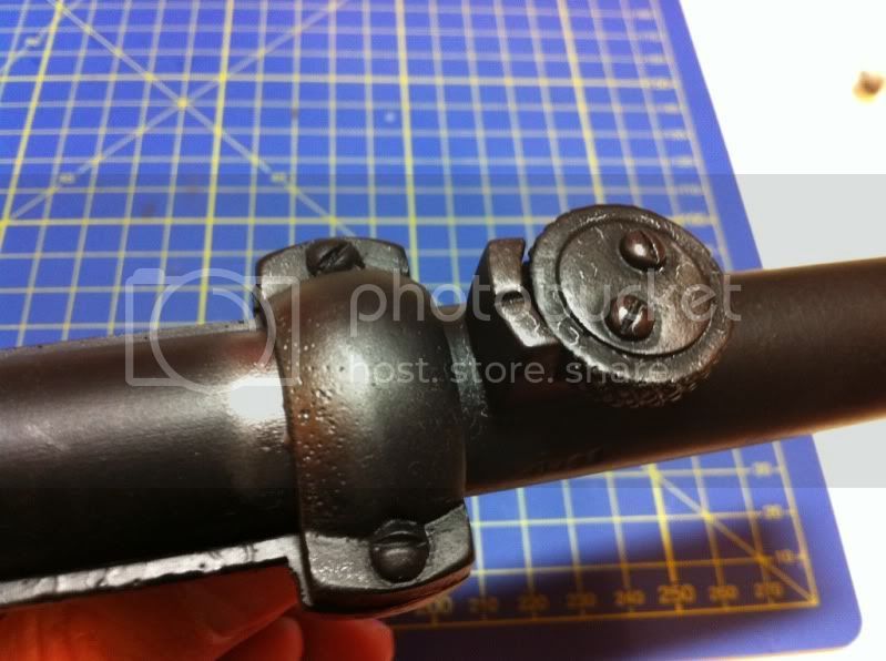

As luck would have it i got some AK Dark Steel for my tank build and just gave it a very quick try out on the scope for the gun.....heres what i got (ignore the chipped bits, i tried the pigs on the bracket edge and screw heads)
Like you said it looks far more natural to me, will the effect dissapear tho if i varnish it or will i need to apply some sort of fixer?

I dont think the effect will disappear ,spray a little clear on to see before you strip the gun again , but just put it on in light coats ;)

Matt i used an old flat brush i cut short to make it a little bit stiffer 8)
