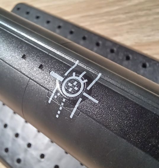

As the title says...and currently creating havoc with my ocd... just by knowing that it is indeed misaligned.
Can this be somehow fixed without destroying everything around/under it?
It was applied using Micro Set/Micro Sol a couple of hours ago. I has not been varnished over.
Thanks in advance
Keep it wet with warm water for a while and it will eventually lose adhesion , then you can float it over a bit , wick away excess water until it seats and then let air dry .
Some will detach before the entirety , just don't try and move it until it's completely free or it will tear .

Lot's of warm water and a steady hand as urumomo suggested. I get the OCD thing, you just can't let it go.
Can you get a replacement decal if it all goes wrong? Usually worth a try from the manufacturer. Pantherman
