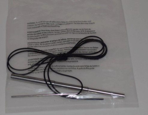

Don't ask me what inspired me to buy this, but it looked interesting, Not a new kit as there is some flash to deal with, but not a lot. Over 300 parts, including some vinyl tubing to simulate hydraulic lines and stepped metal tube for the large ram piston inside the compactor.
