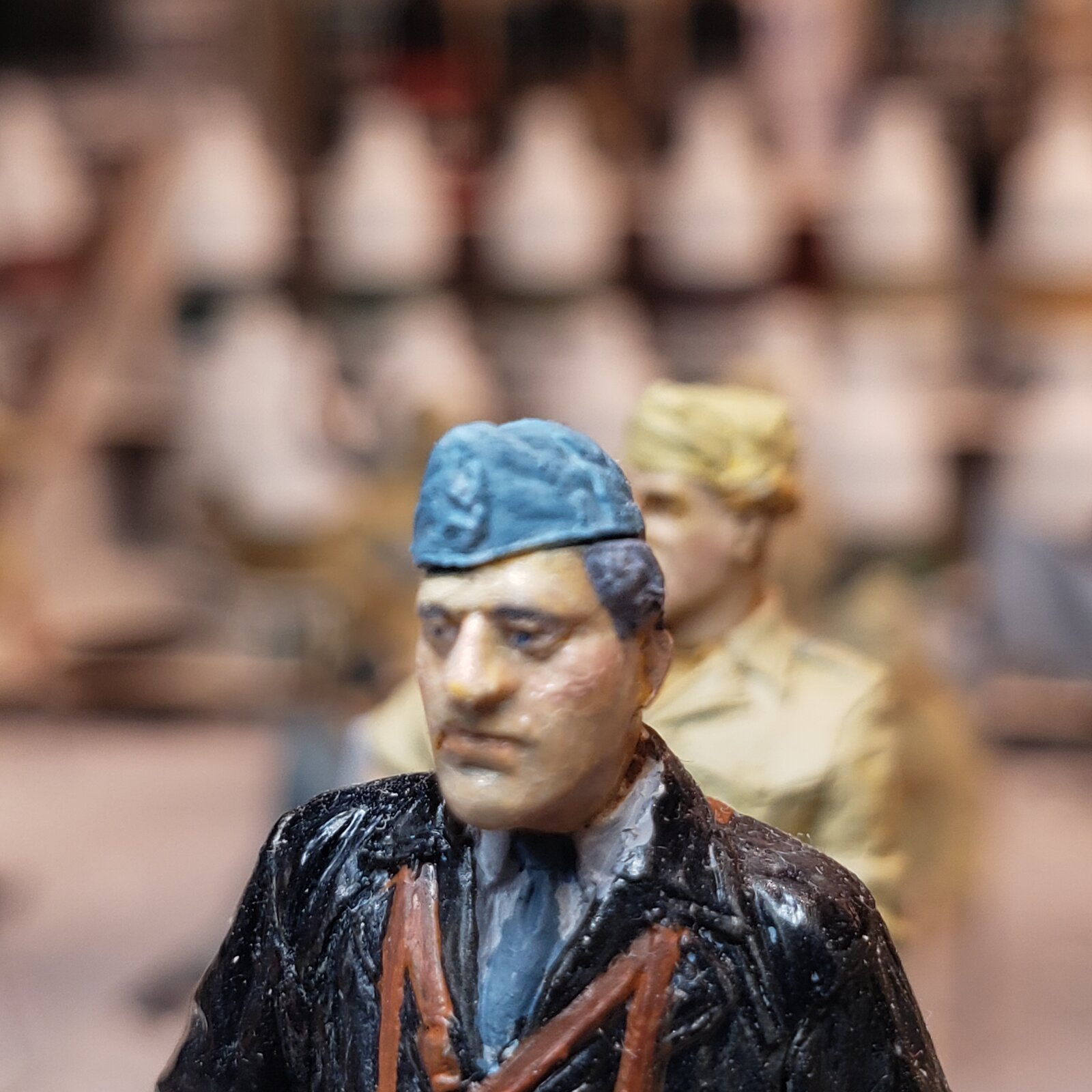

... so, switching threads for a while, the Topo figures thrown back in with their buds, added to the queue, subjected to my crazy notion that oils are the way to go for faces, exposed arms and legs.
Most of them volunteered for the experiment... after a few days, their personalities starting to develop.
It will be a while before they are ready for the limelight, but I'm trying to apply some of the Bannerman techniques in the resources recommended by @Steve Ski .
Of course my starting point with these is different, but some nice pointers for using oils.
I will probably finish up the uniforms in acrylic, with possibly a few highlights in oil.
Taking my time.

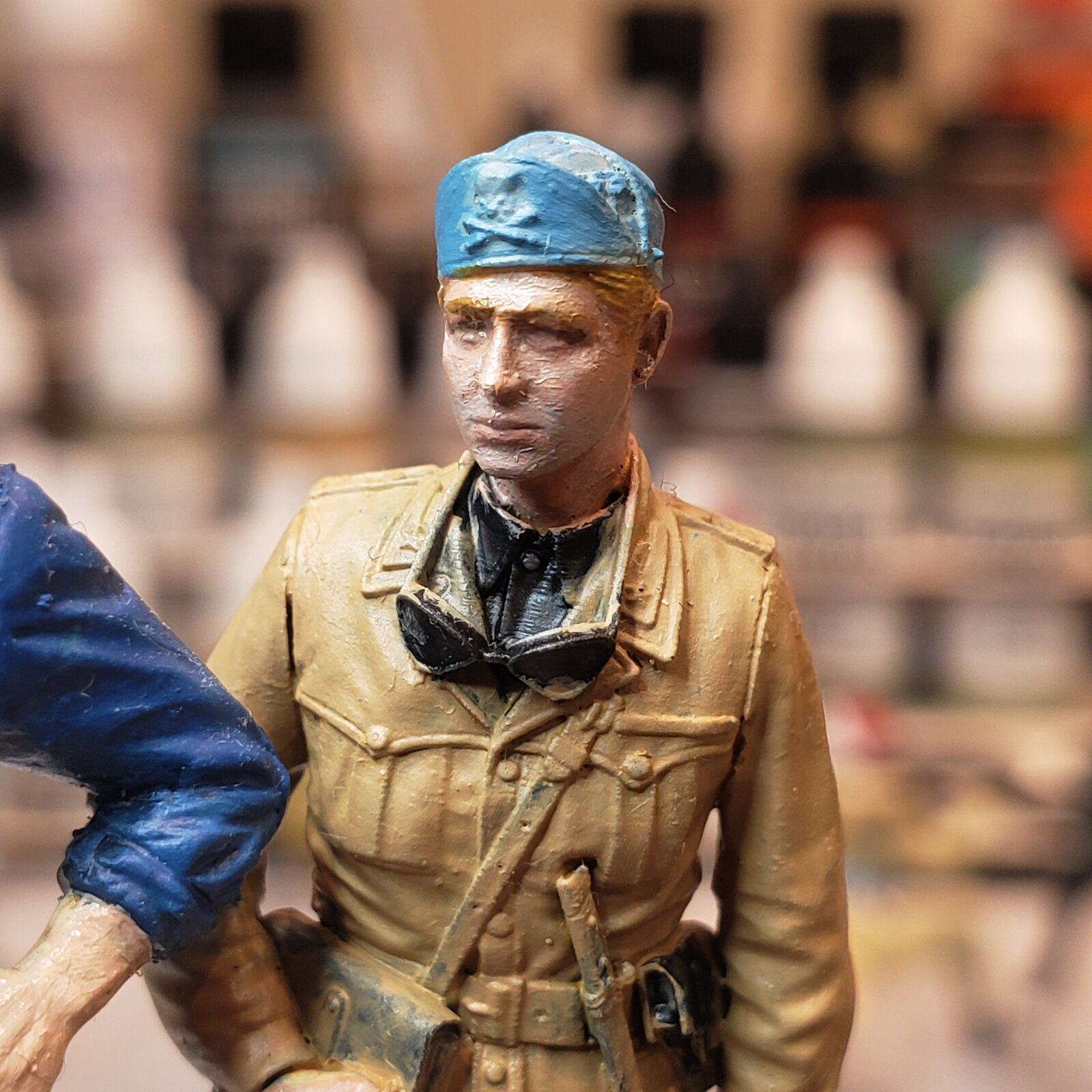

So I'd named this guy Roberto... then I thought he should have a mole... then I looked up DeNiro... Robert! :eek:
Now my model making is free associating!
And now I know what he's thinking: "When this stinking war is over, I'm going to America, and I'm gonna drive my own taxi!"

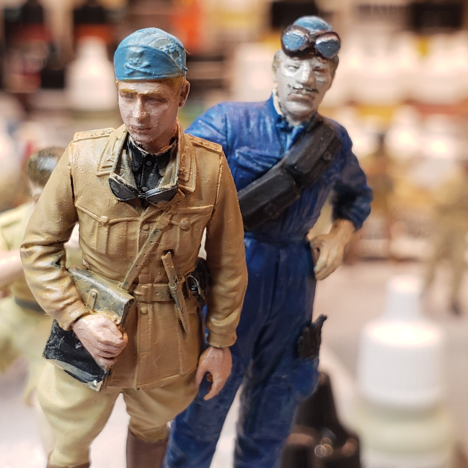

A bit of colour correction, boosted my cheaters to max (2.75x).
Tomorrow night I might try evening out the brush marks. If you zoom in, oils look like oils, but also like his skin is flaking!
Part of the learning with oils is not just the colour mixing and blending, but also how they get carried to the surface, how they dry, how they sit on and move from the brush.
I knew this stuff 45 years ago, but I seem to have to relearn it... then again, I wasn't painting tiny figures, it was on 36"x48" (and larger) canvas and masonite boards!
I am remembering now how much I loved mixing colours. I'd forgotten how much easier it is to mix subtle variations of hue, tint and shade with oils... without the need for extenders, retarders and wet palettes.
And for skin tones, the depth and warmth of oils so different from the flatness and uniformity of acrylic. Of course, I find these properties of acrylic make for a predictable and dependable medium when painting vehicles and uniforms.
Even my basic oil set is proving pretty adequate for what I want to do!
Tiny amounts of Burnt Umber, Titanuum White, Black, Yellow Ochre, Magenta and Pthalo Blue... and oils stay workable for a few days!
Of course that also means at least a week before they are mostly dry on the figures. Probably longer.

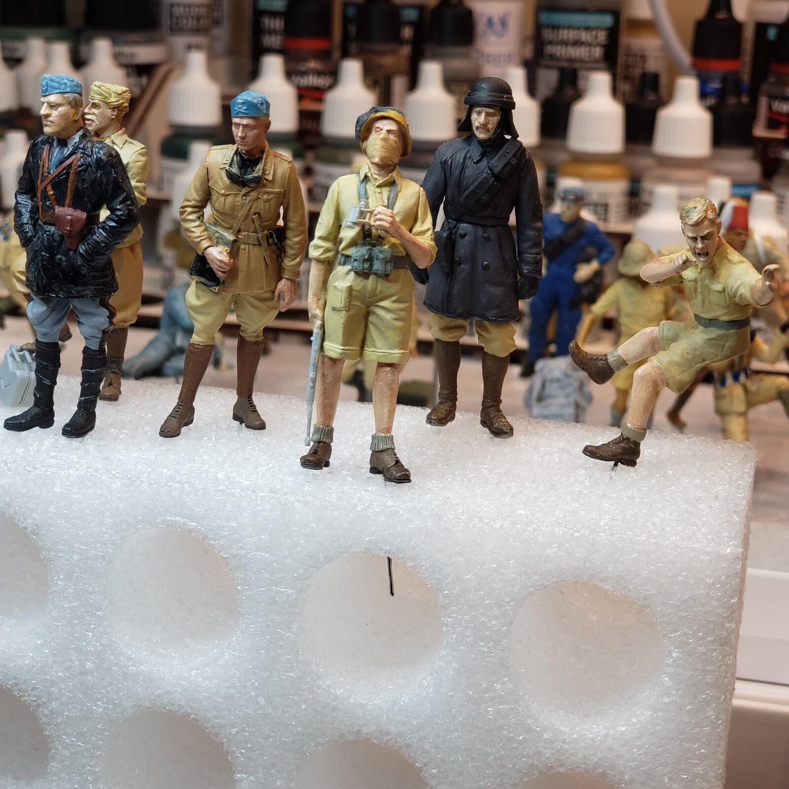

So 7 of my horde now sporting oil, another 21 to experiment with!

You do things a bit differently than I do, but that's going to be normal for all of us, whatever works for us is how it gets done. If I may make an observation, the one thing that sticks out right away is the amount of paint you have on your brush. The brush marks are visible, but that's is an easy fix. I never leach off the oils from my pallet, I use wax paper taped to a card board backing. So, mine will be thinner going onto the brush anyway, but I basically stain the surface, vs actually painting it. You will always want to remove any lint or brush marks as soon as you see them. This will help with the smooth transition between tones and make blending much easier. Like I said, this is an easy fix, you're doing good, Amigo.
And you are correct, Barley, there really is no need for a rainbow of colors, just some basic ones, everything else can be made to order. Keep at it, Ruck On!

Kudos, you did impressive work with the facial features and skin tones. I especially love the work on the eyes, eyebrows and mouths. They can be hard to get looking right but you nailed them. Also the Robert De Niro mole was a nice touch
Don't sweat the brush work too much.
Brush work smoothing can be refined and eliminated over time. You mastered the hard part of painting the details
Zoomed in like this with such bright lighting is always tough and in some ways does not really represent what it looks like in person. I always find things in my own stuff that I thought looked near perfect in person with normal lighting, but then find lumpy or rough surfaces when zoomed in
For me it's like turning the bright bar/pub lights on at 2 AM :D
