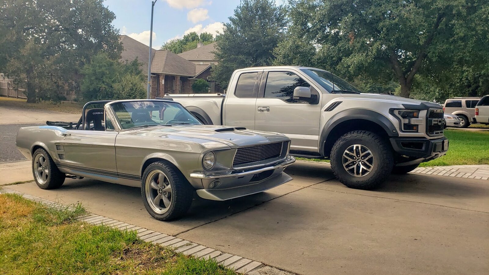

That said, I'd love to see your GT500, my other hobby is a 1:1 functional model. Not a real Shelby, not even close (a mere "C-code" which they made many many thousand), they made no convertibles in 1967, those came out in '68.
