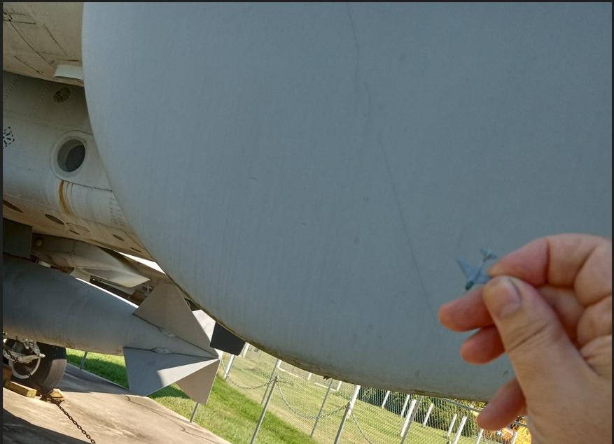

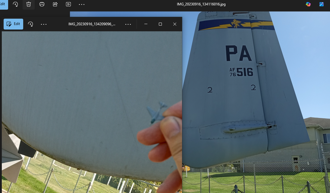

For what it is worth, below is a picture of Vallejo Ghost Grey next to the tail fin of an actual A-10
Granted this A-10 is a static piece that has sat out in the sun for years, if not decades, so paint may have faded a little, but from what I understand, the Vallejo Dark and Light Ghost greys are pretty close to, if not slightly bluish compared to an actual FS color chip.

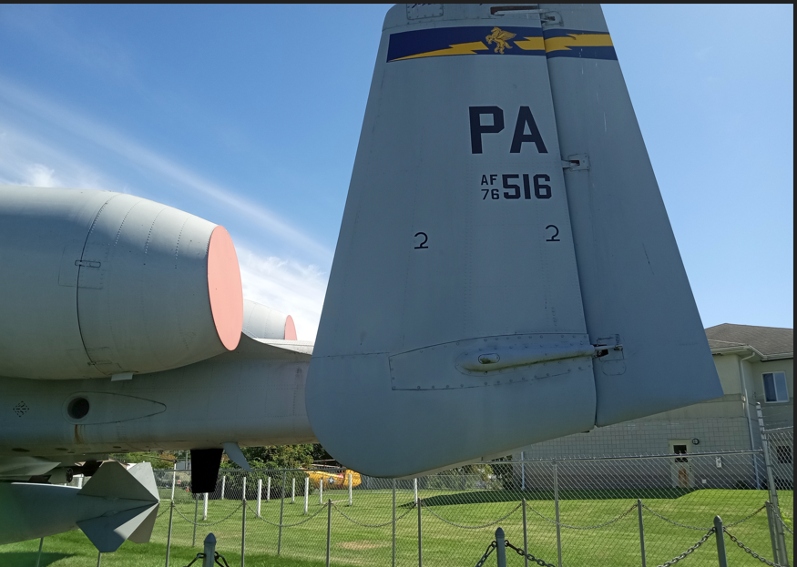

Another factor is if it is in shade or sun
Dark Ghost Grey does wind up looking rather bluish in certain lighting, or against bright backgrounds while it is on the shade side
but you can also see in this pic that the bottom where I was holding it up against has some light patches

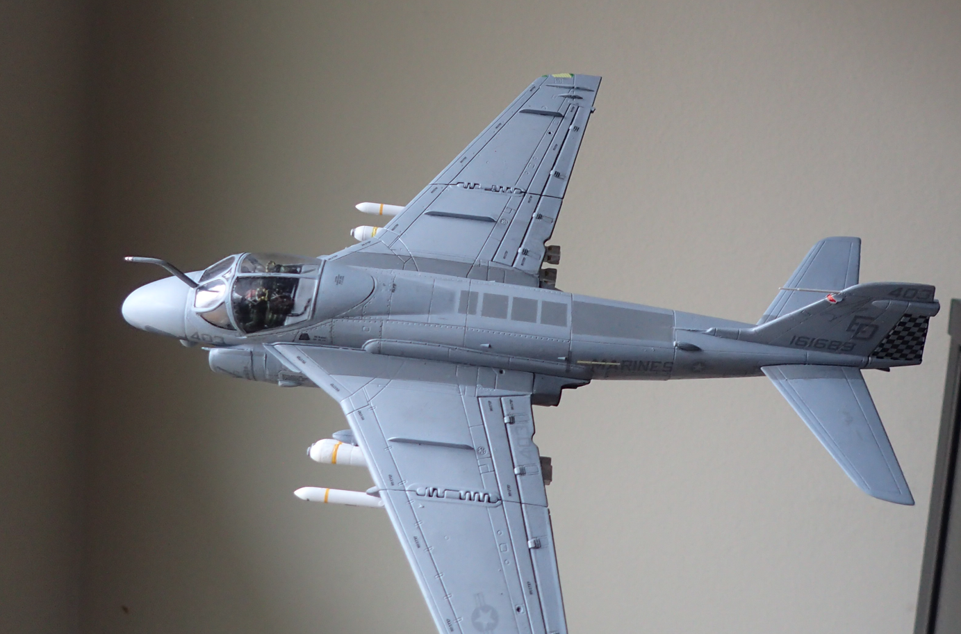

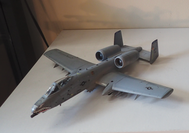

and below is an example of using the light ghost grey mixed on to tone down the Dark Ghost grey. My next attempt I think I might add a bit more light ghost grey
