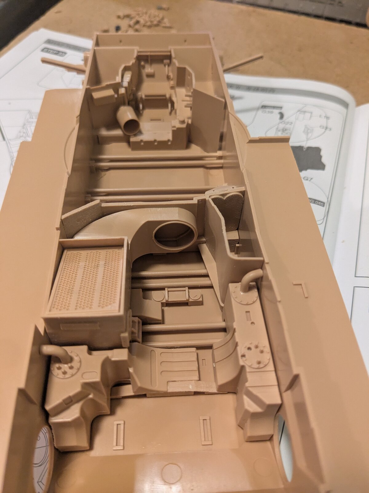

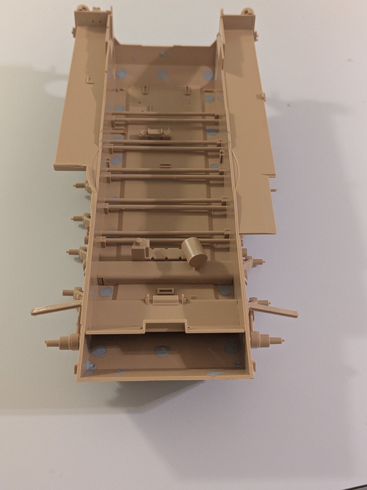

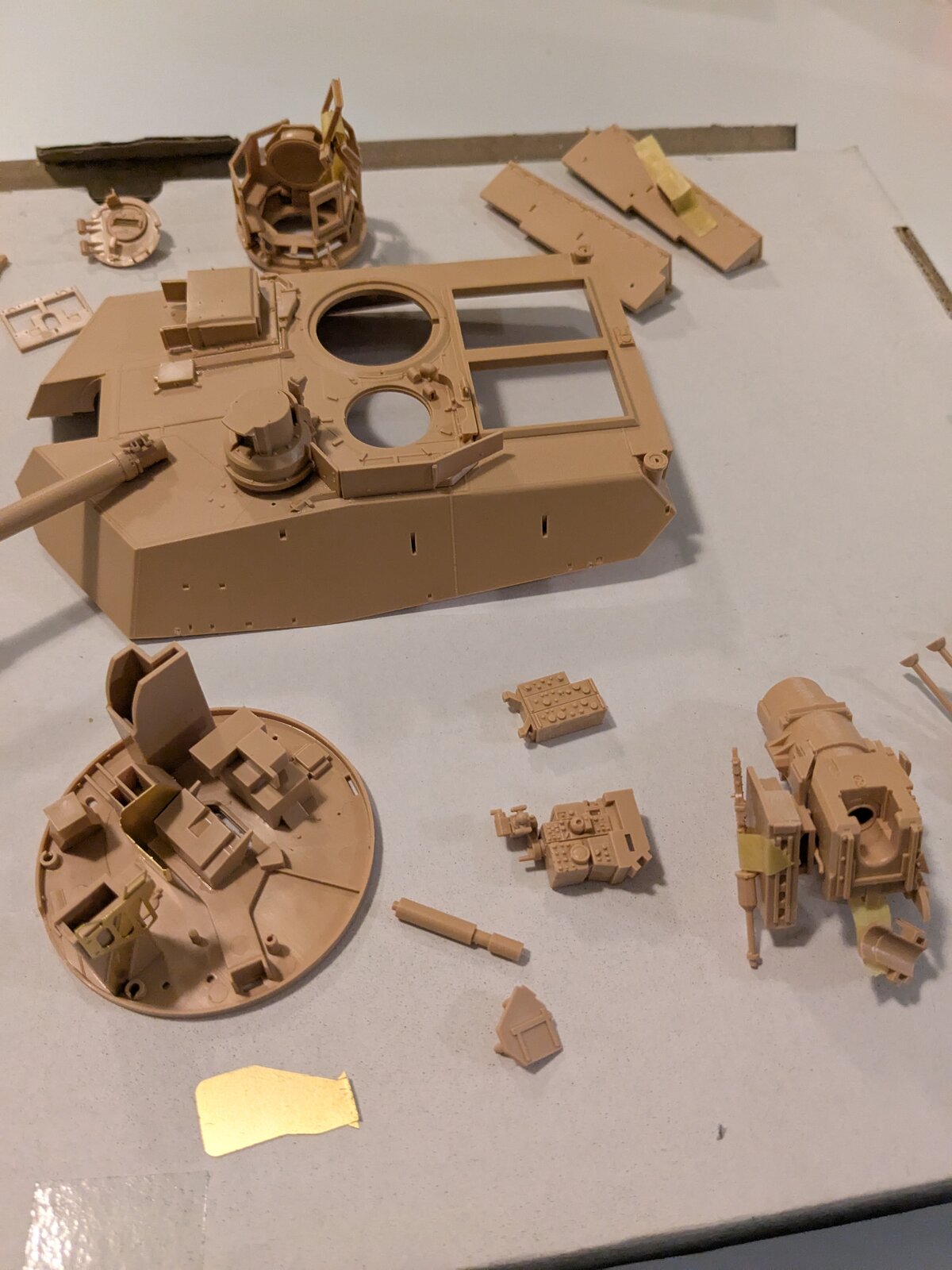

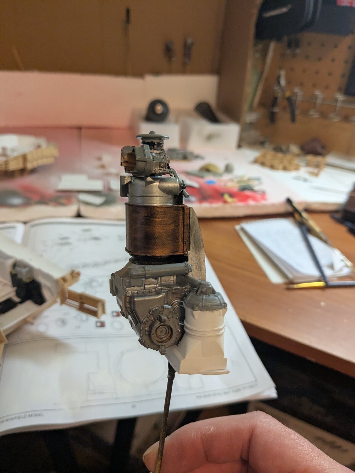

So I decided to build this kit for obvious reasons.

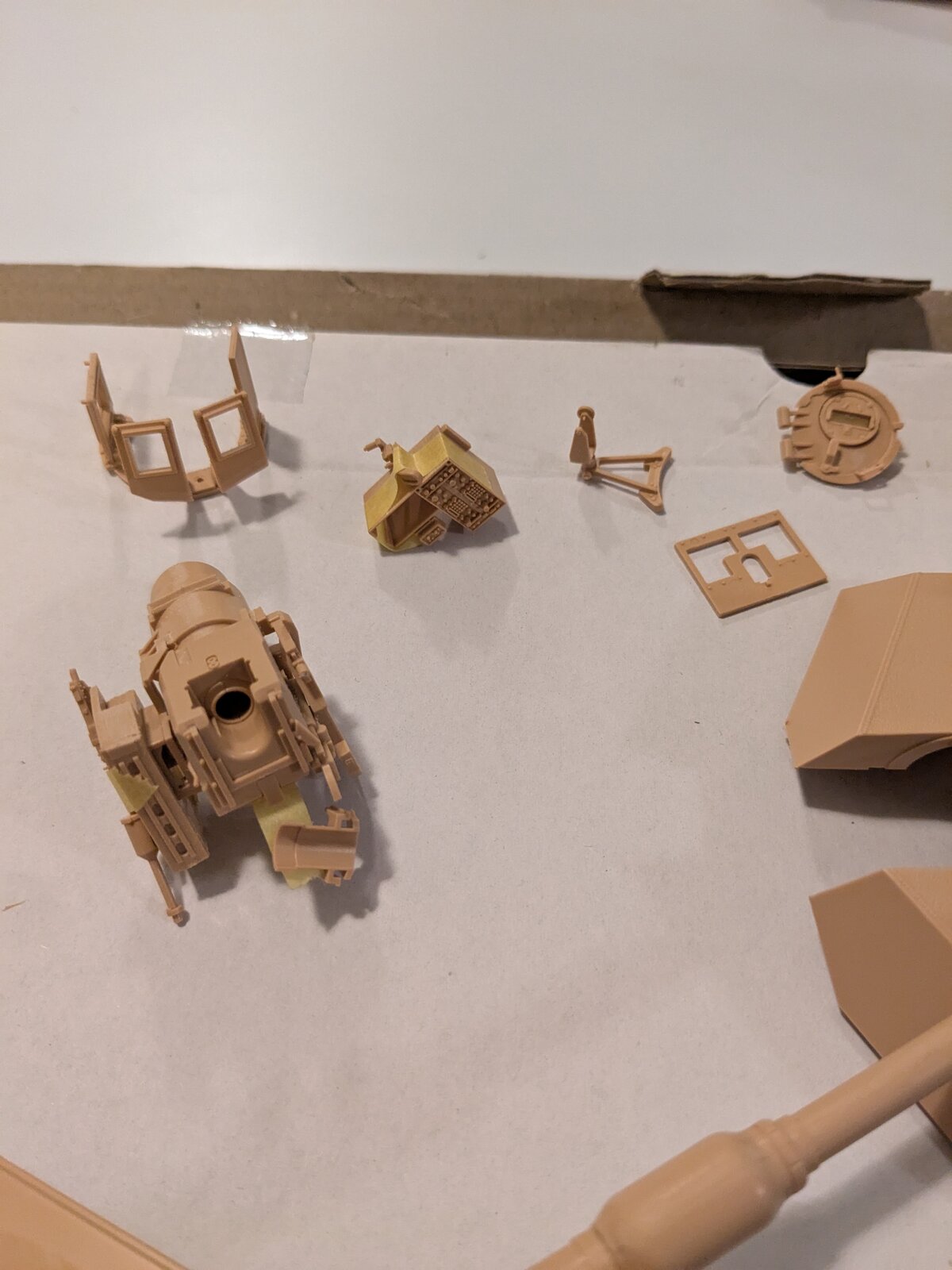

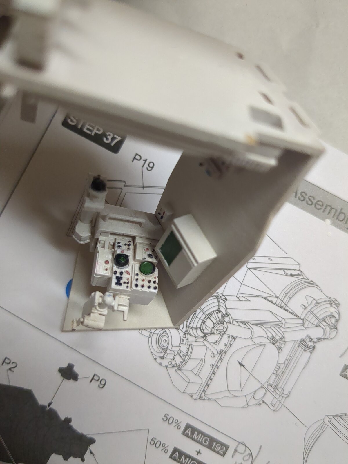

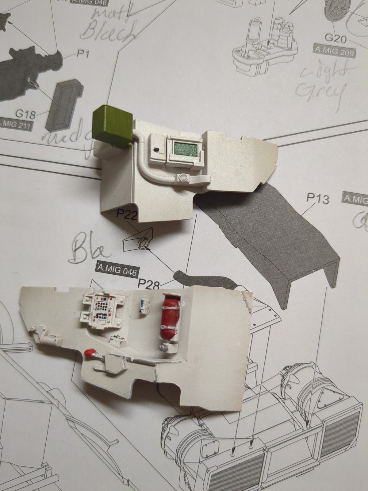

I am starting as sub Assemblys basically so I can see what is shown how it is shown so on so I can decide my method of display for the tank so as much can be displayed as possible.

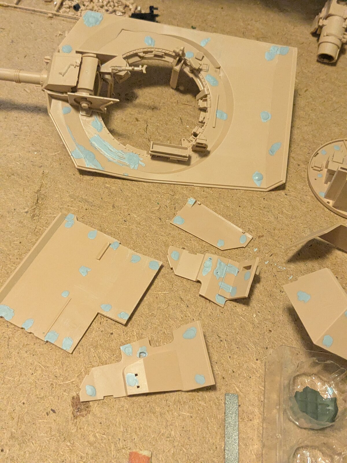

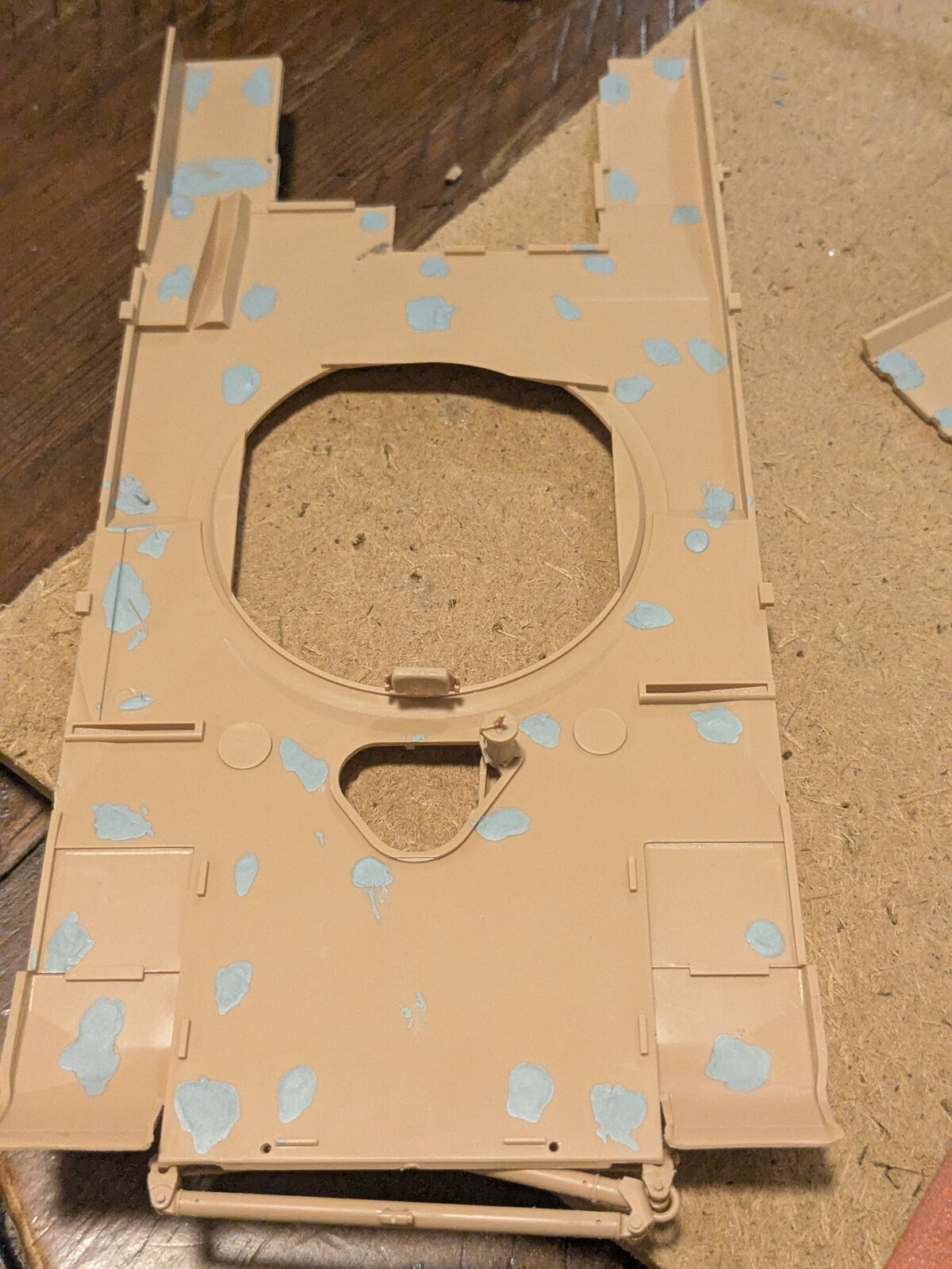

It is a good method in my opinion to do this kit also because it makes painting much easier and allows test fitting. It also allows you to see all the spots you will need to fill and sand and trust me depending on how displayed it is alot.
I'm my opinion not a beginner kit at all lol... I think the instructions could be alot better as well. It lacks clarity in some places so.. yeah test fit important along with some critical thinking.

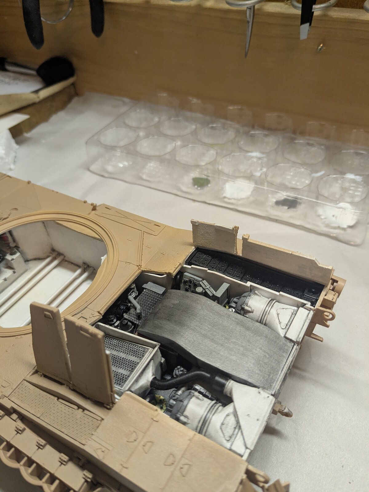

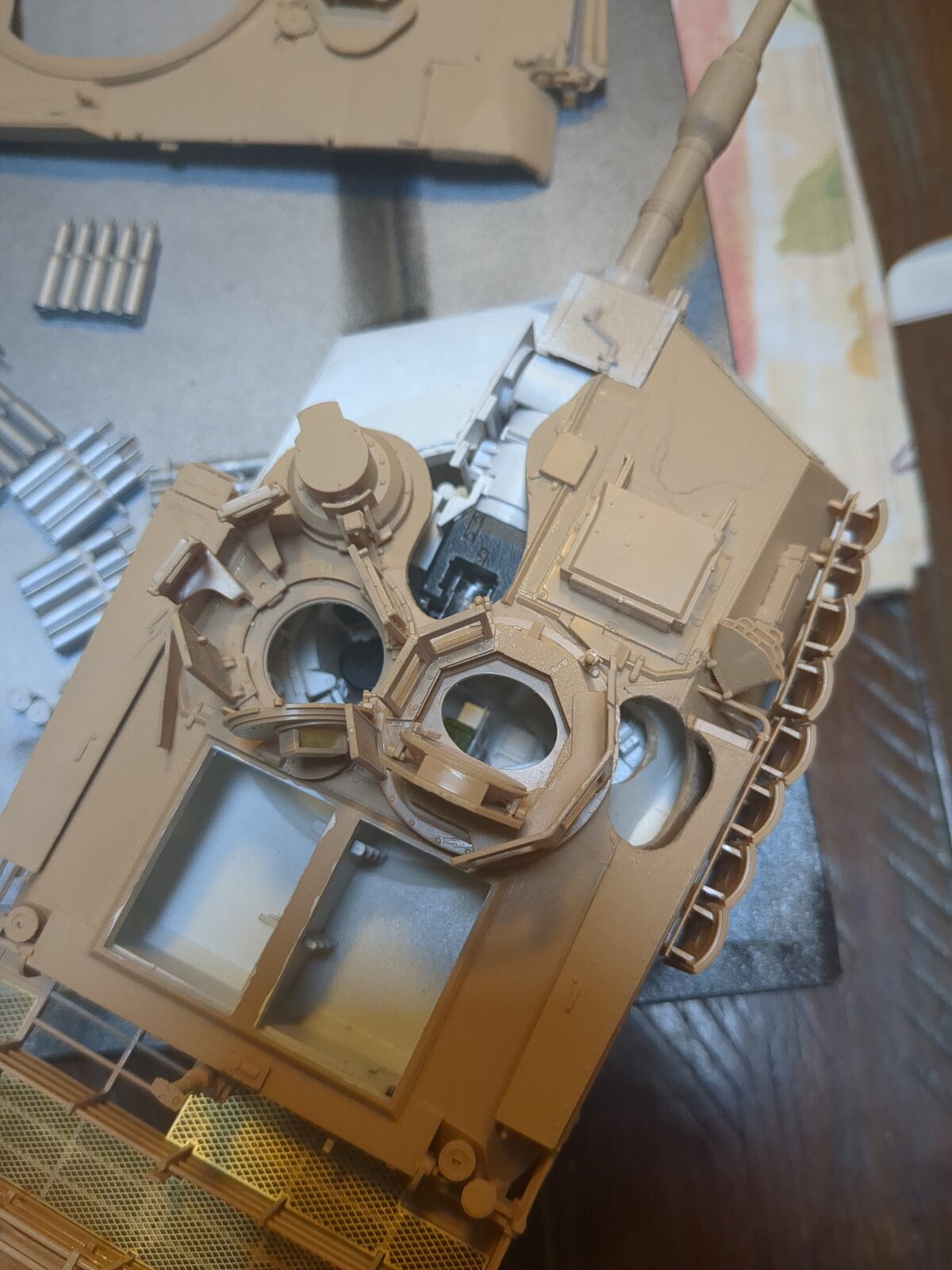

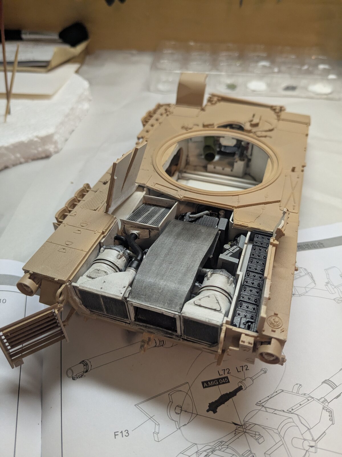

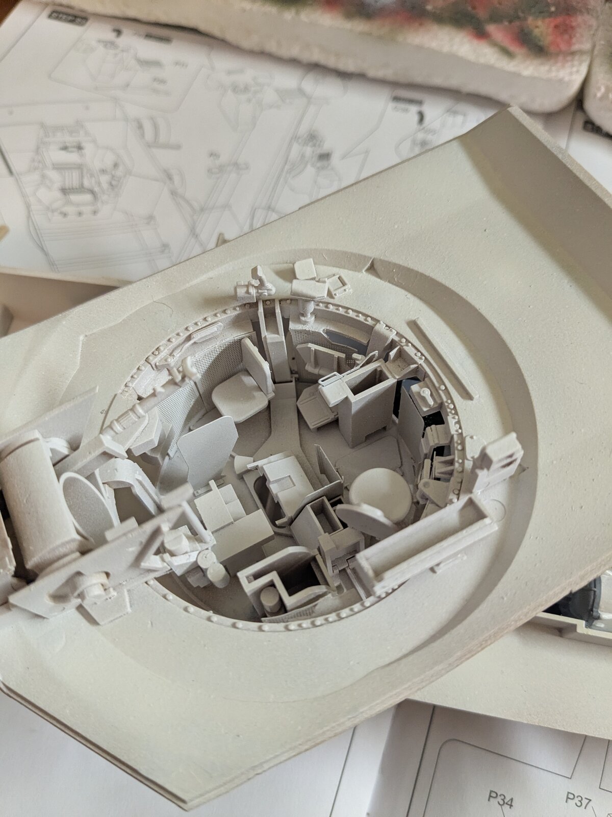

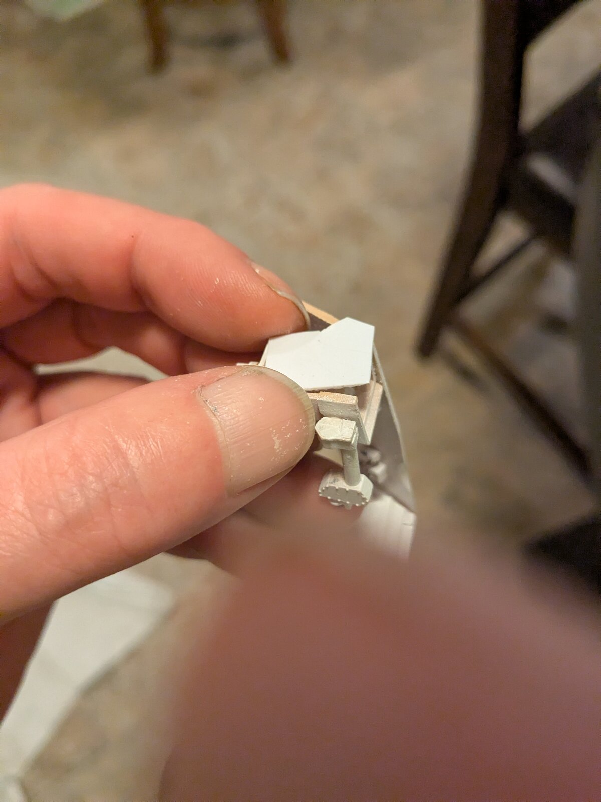

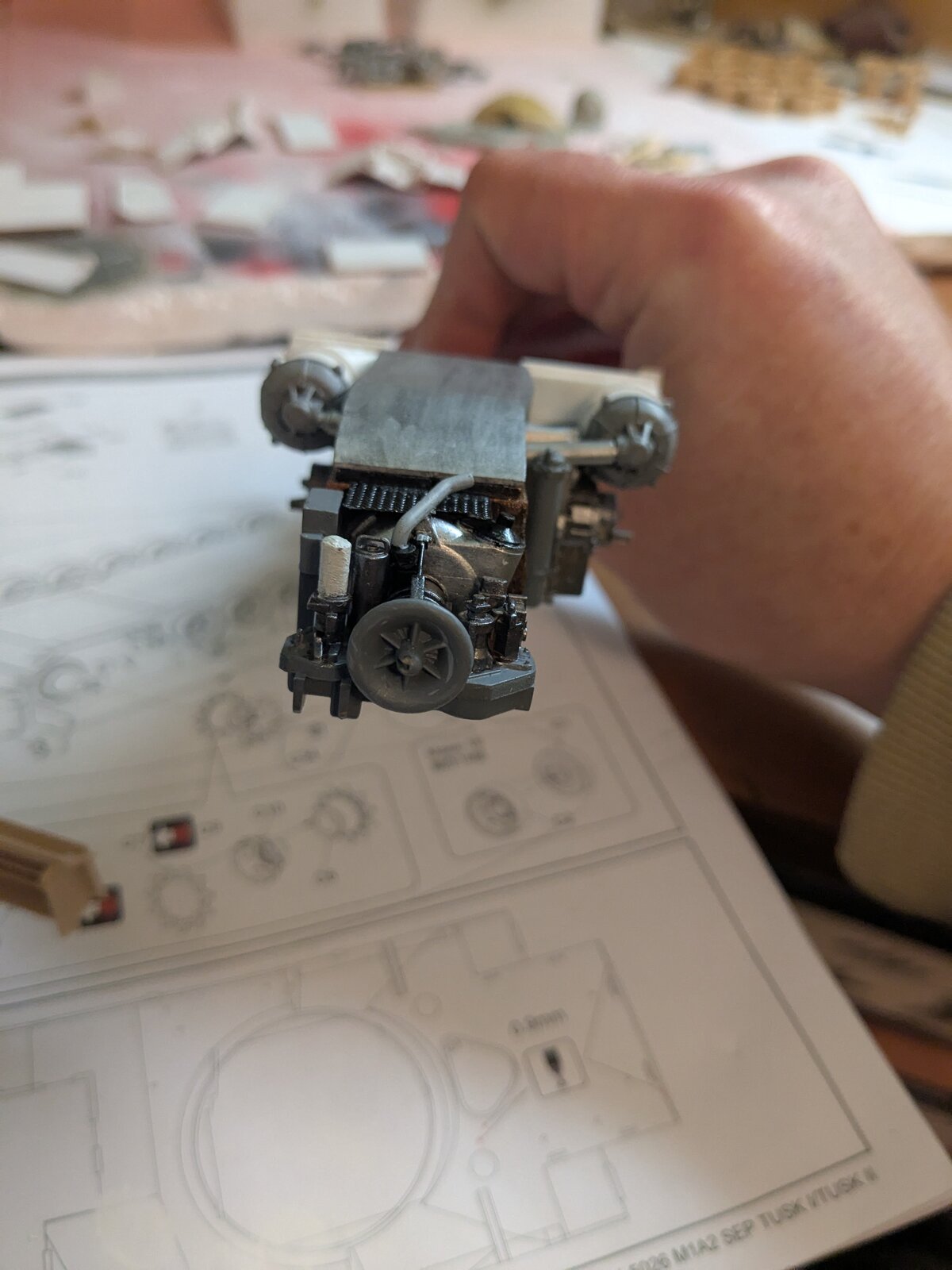

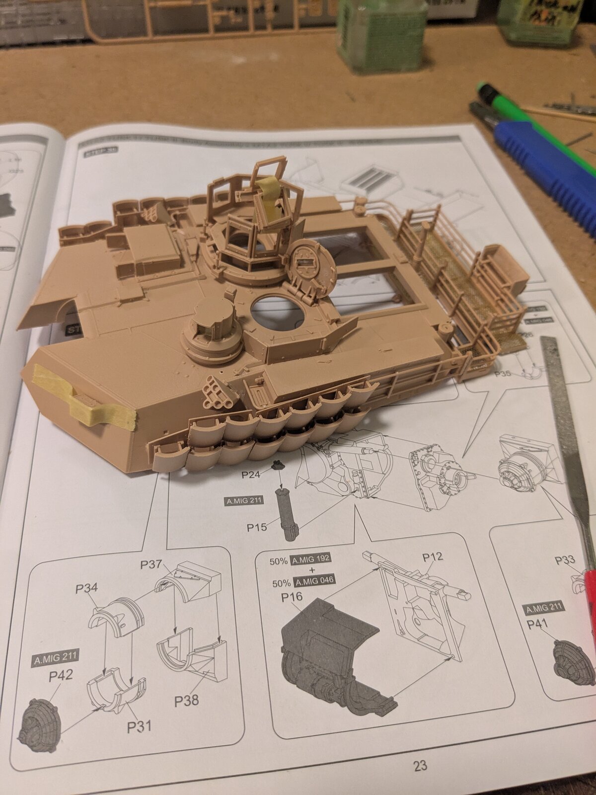

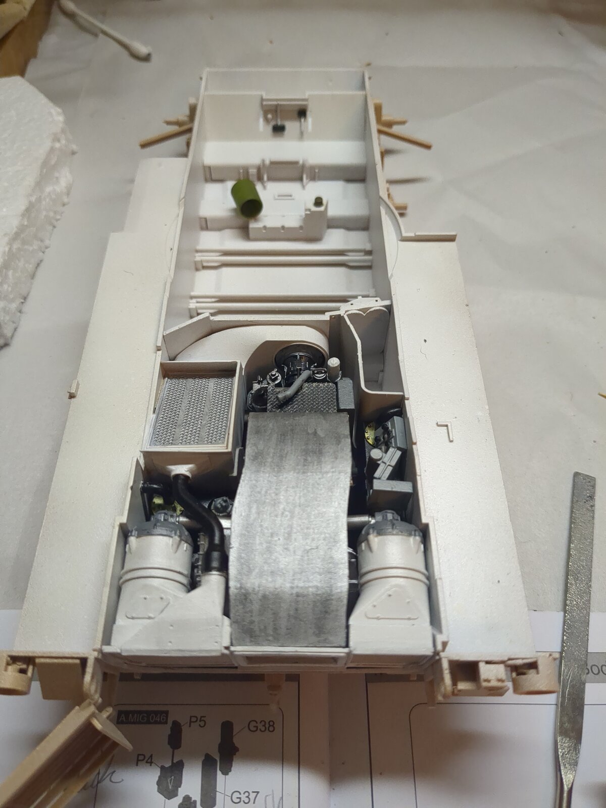

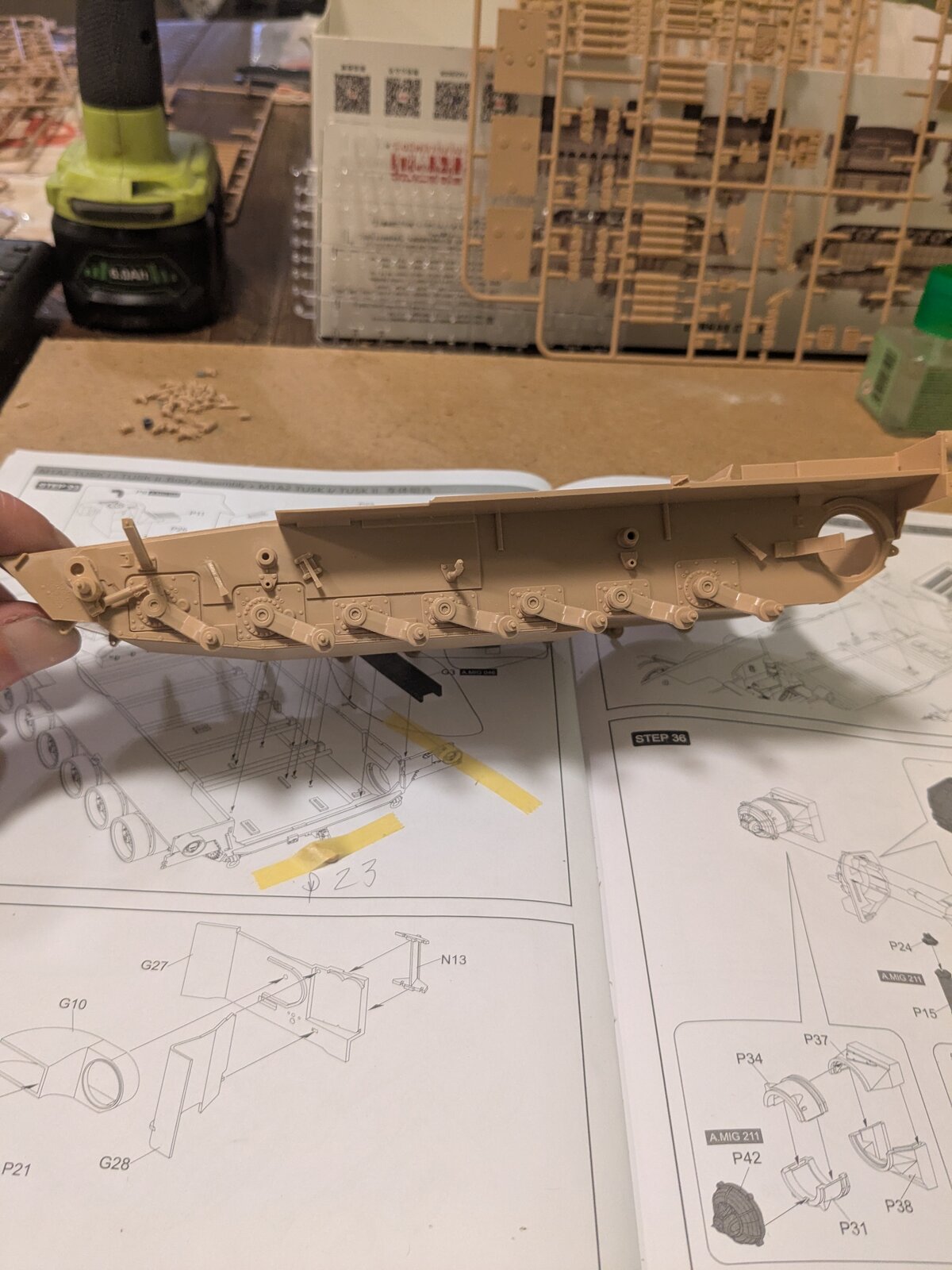

Some work done today... Some is mocked up some is glued in place. The road arms with the axels going through were interesting to build. There whole thing is moveable and flexible but it makes putting it together challenging to say the least.

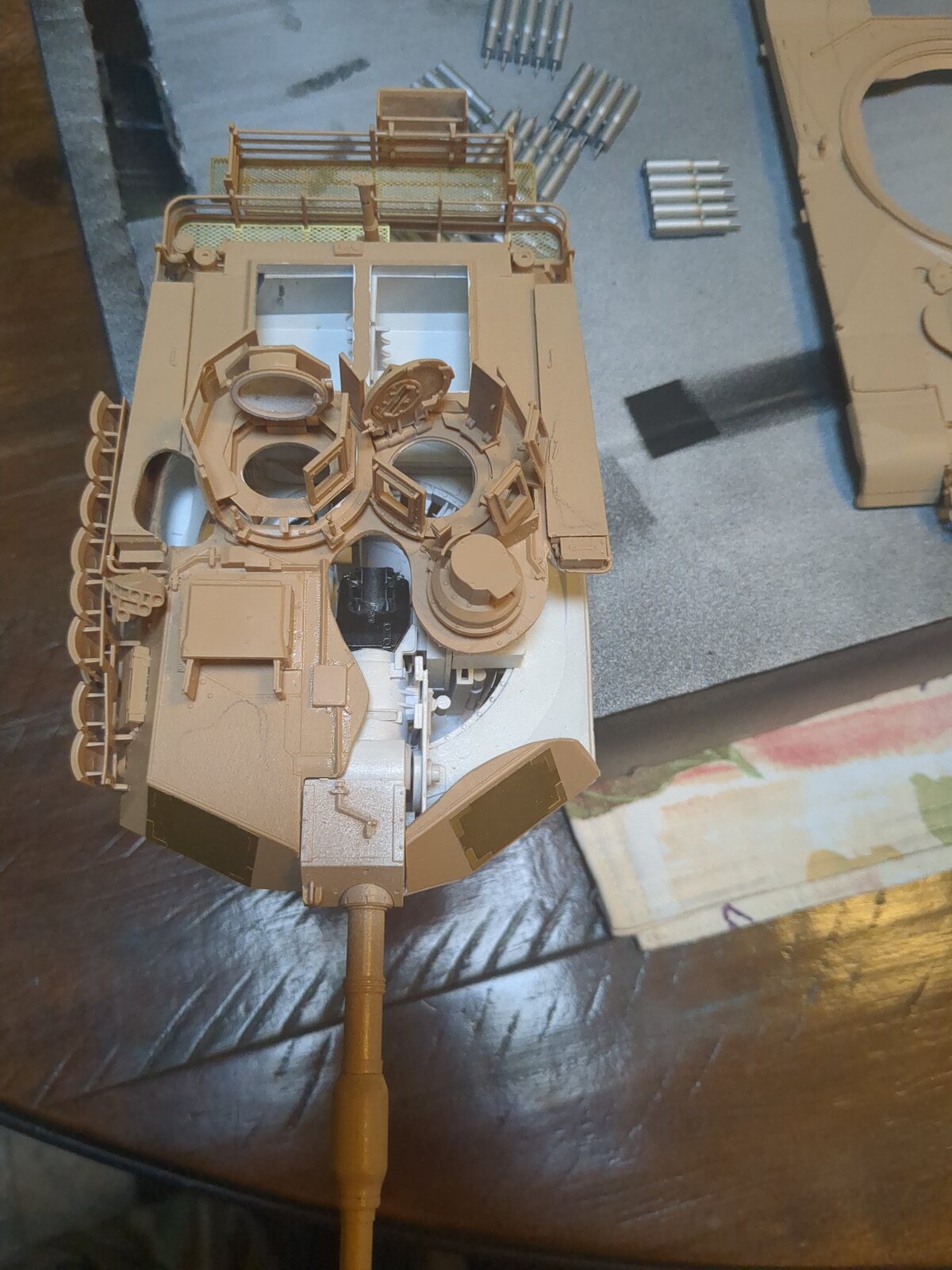

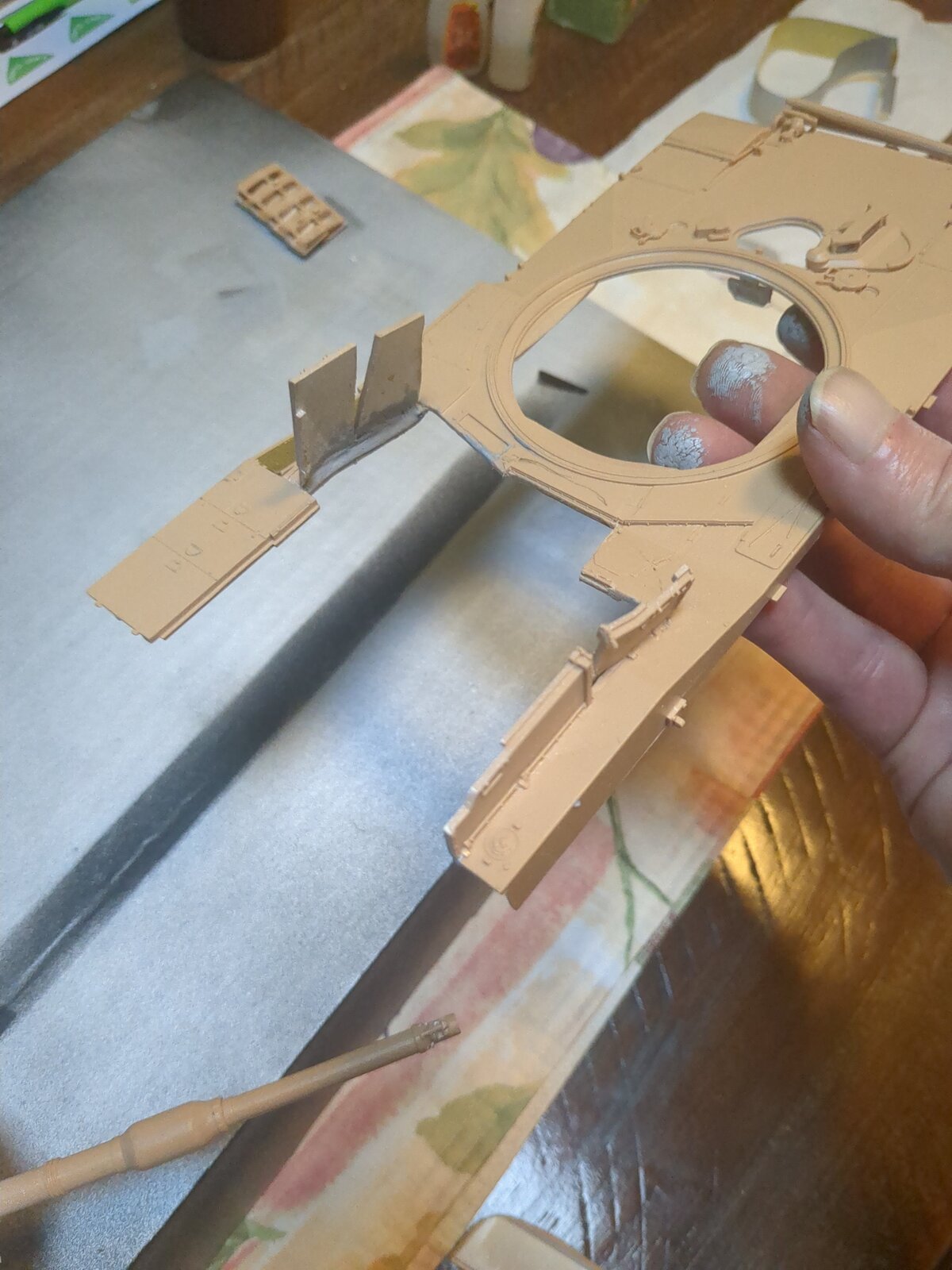

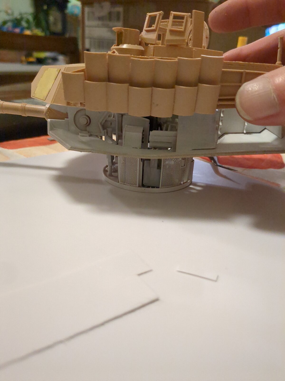

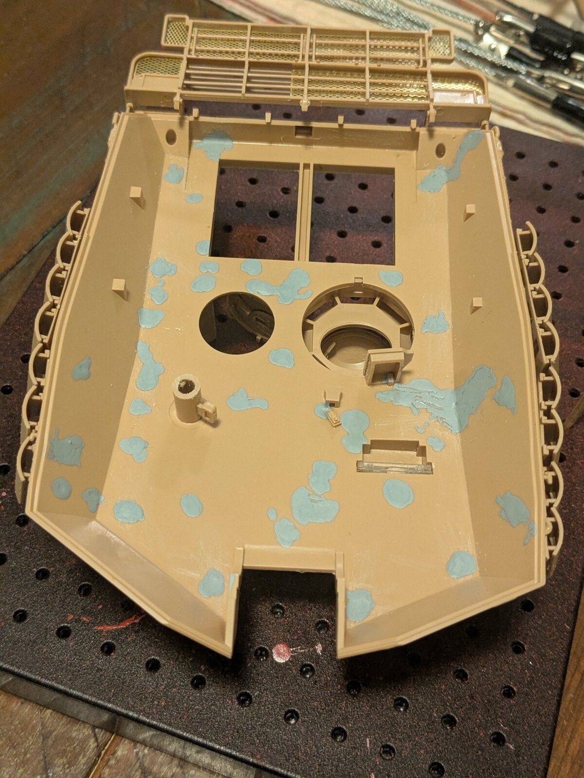

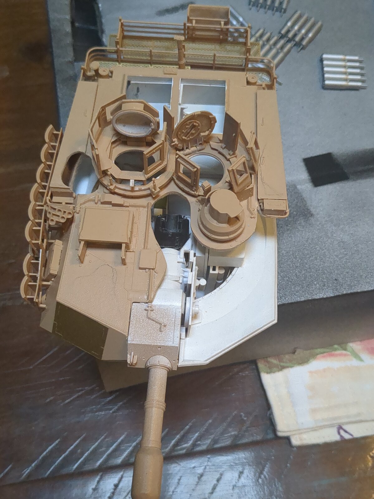

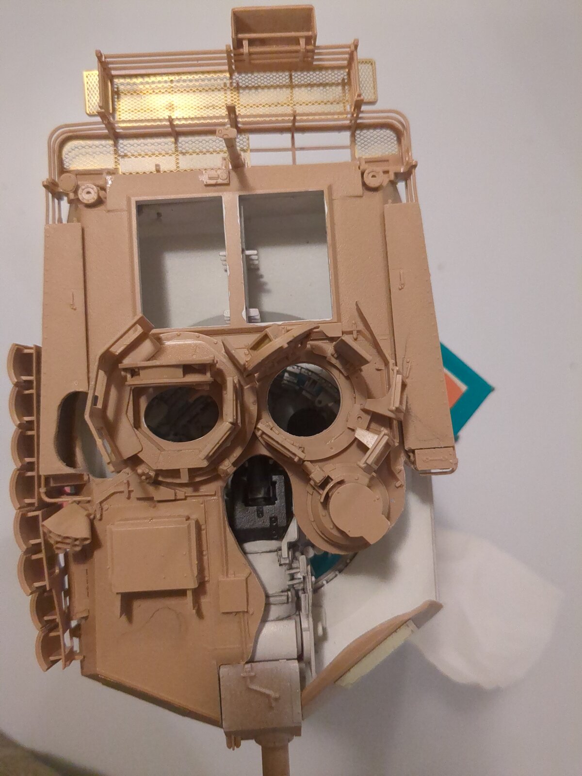

The slat armor on the turret is quite interesting as well, alot of holes to drill. Really the whole model has alot to drill depending on how you want laid out, version, so on. There is also alot of sand and fill depending on it too

I do think you could have saved yourself some work with the EP marks on the upper surfaces.

Could have if I displayed it closed... I will not be displaying it closed. I have a plan for how it will be displayed and you will be able to see it depending on angle.

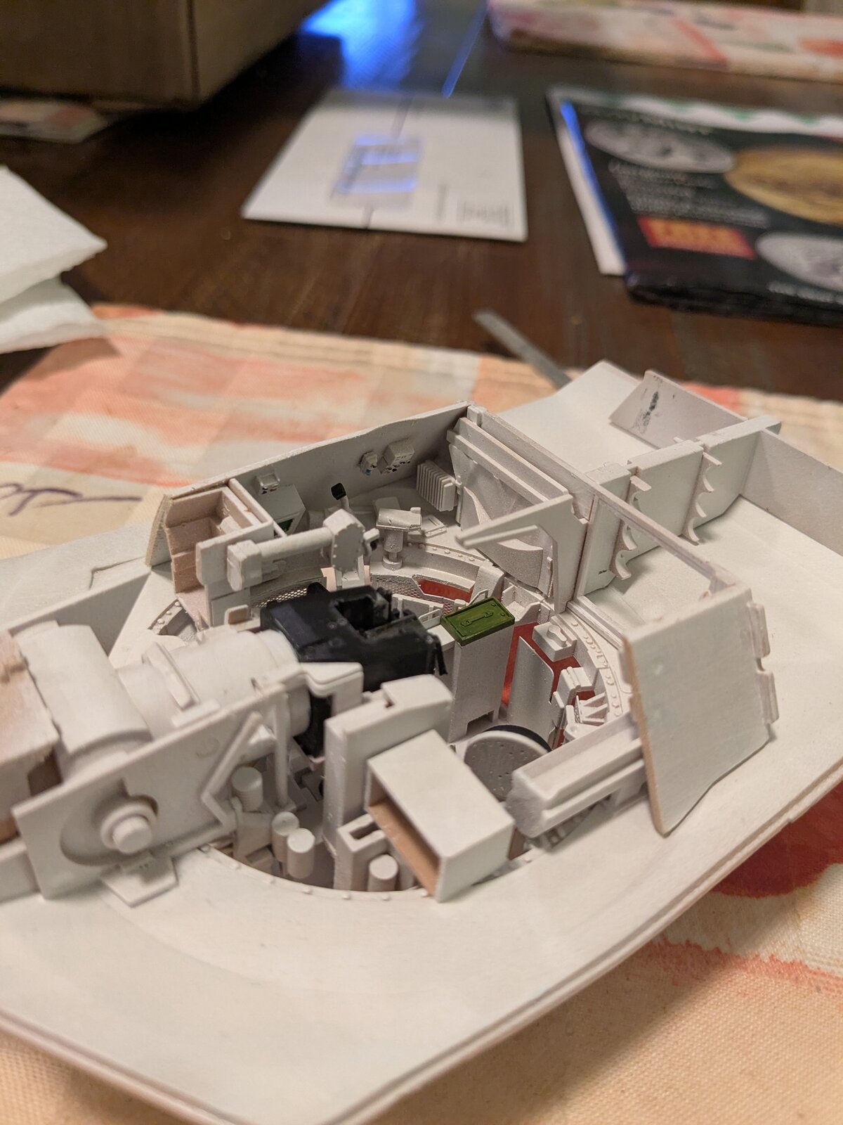

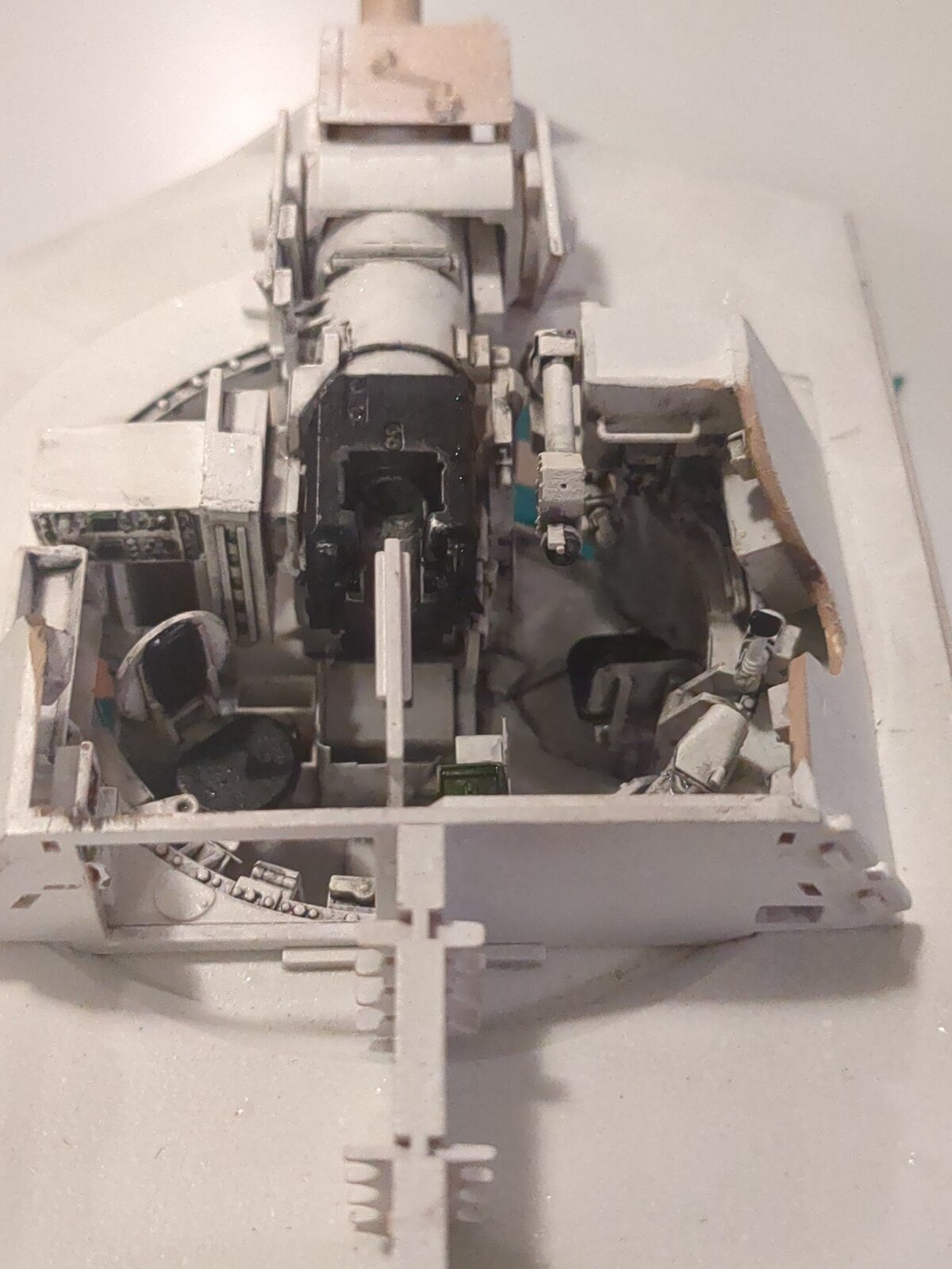

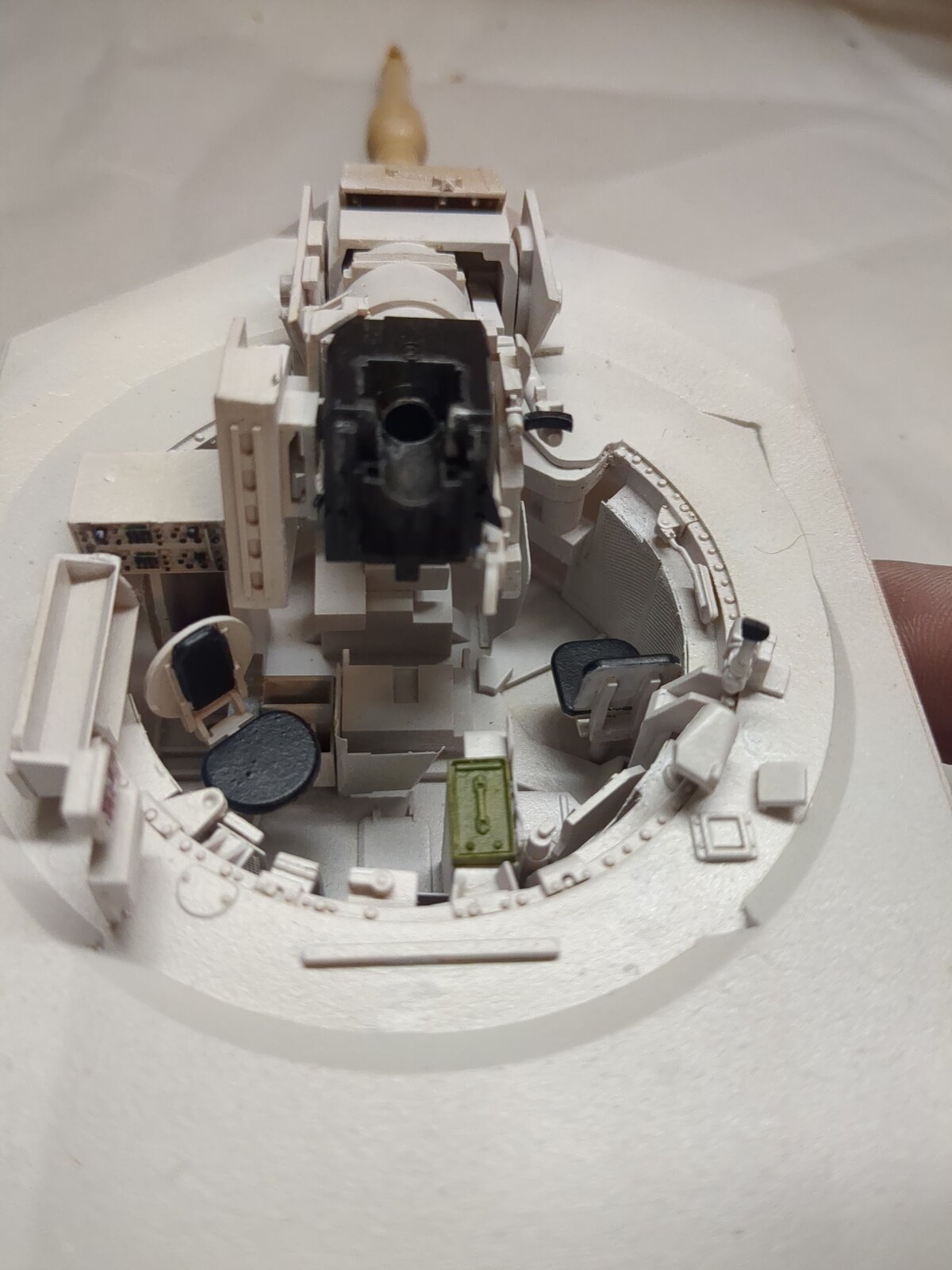

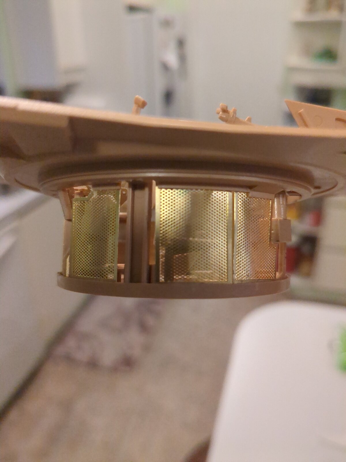

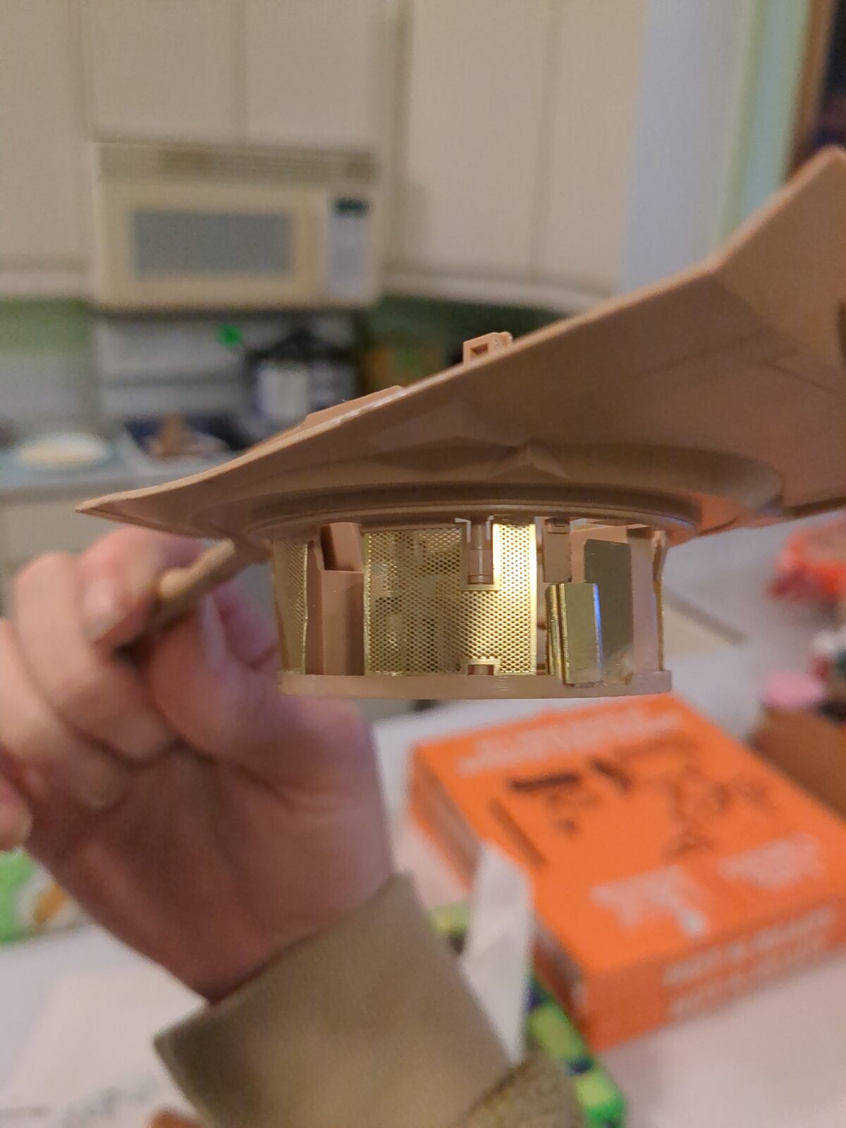

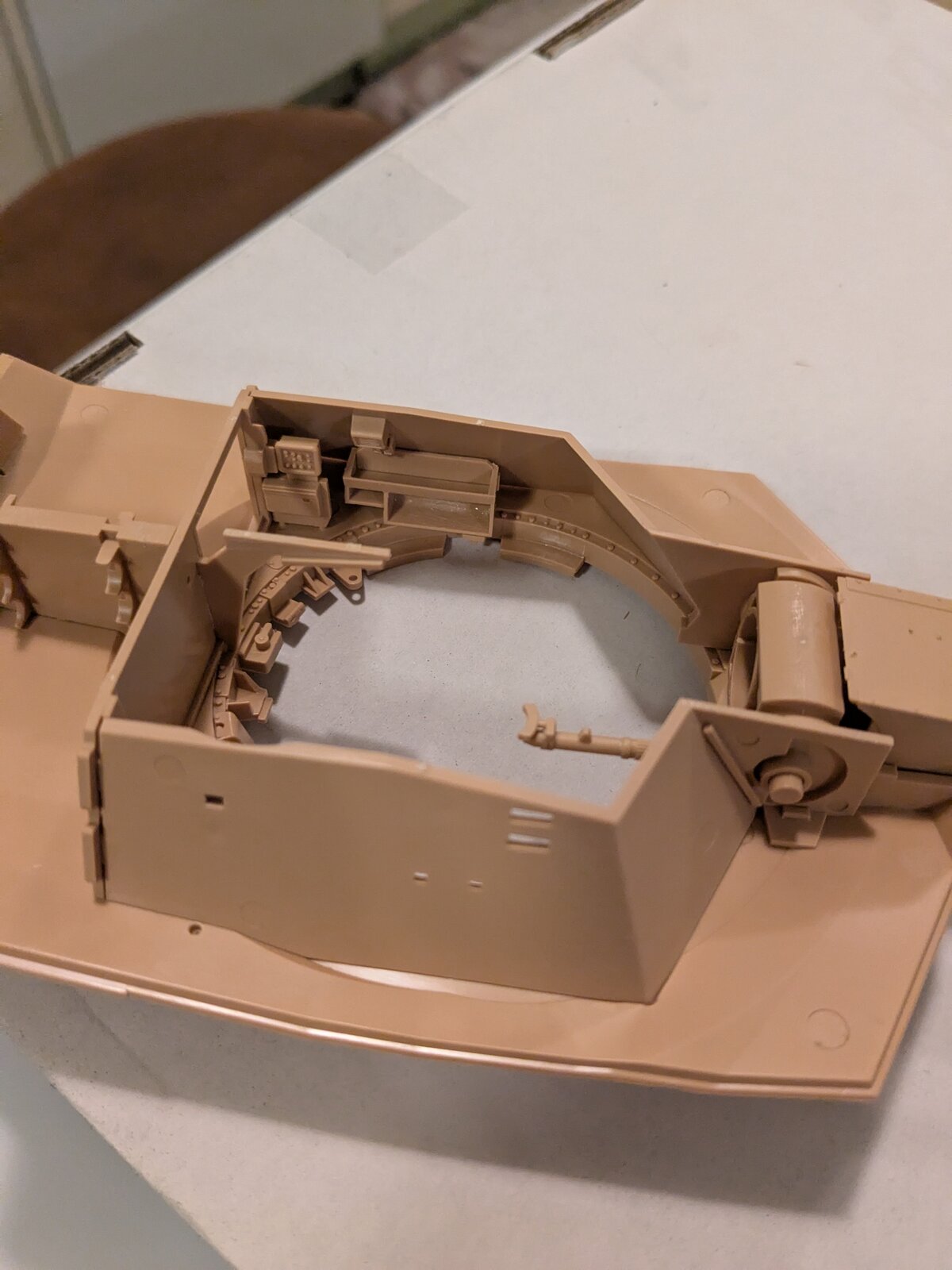

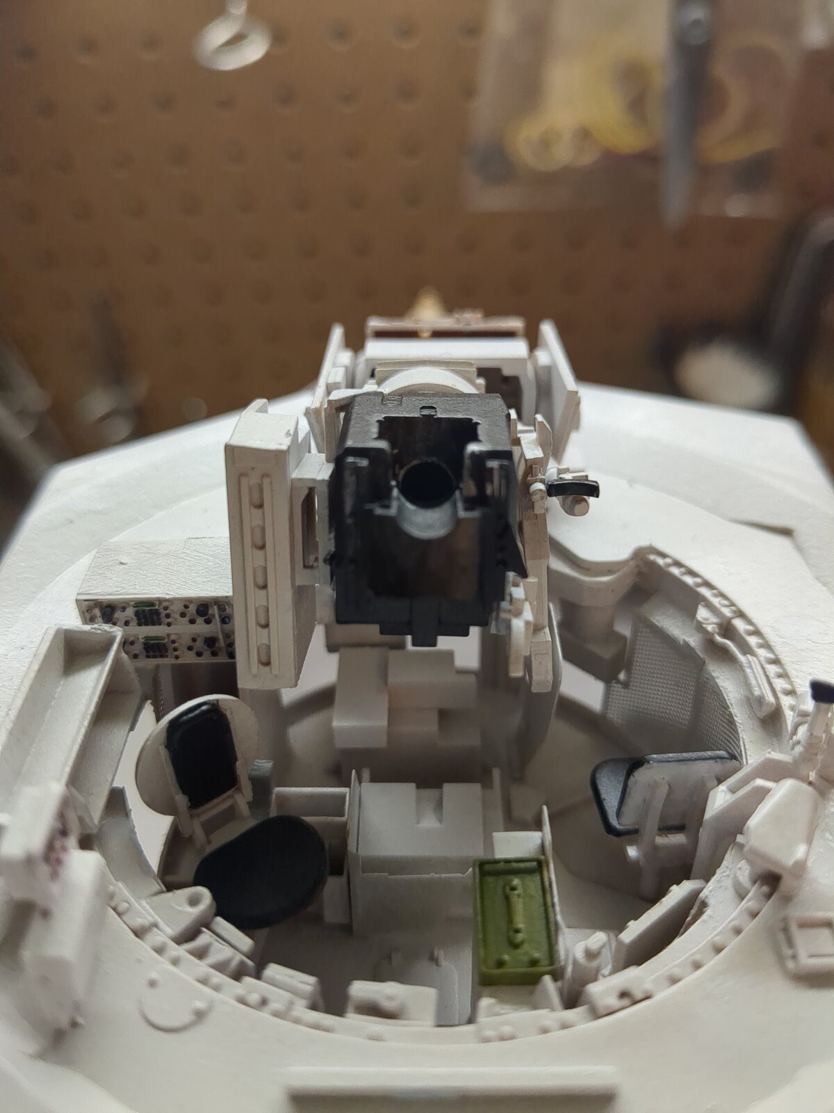

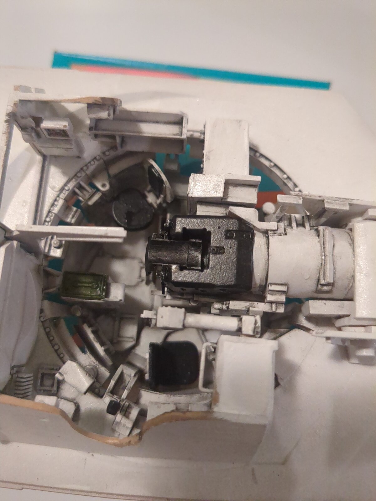

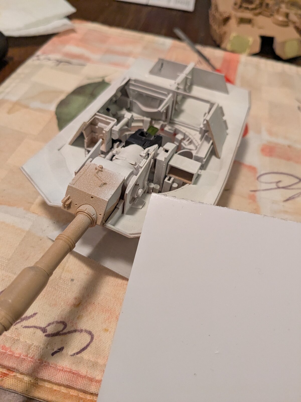

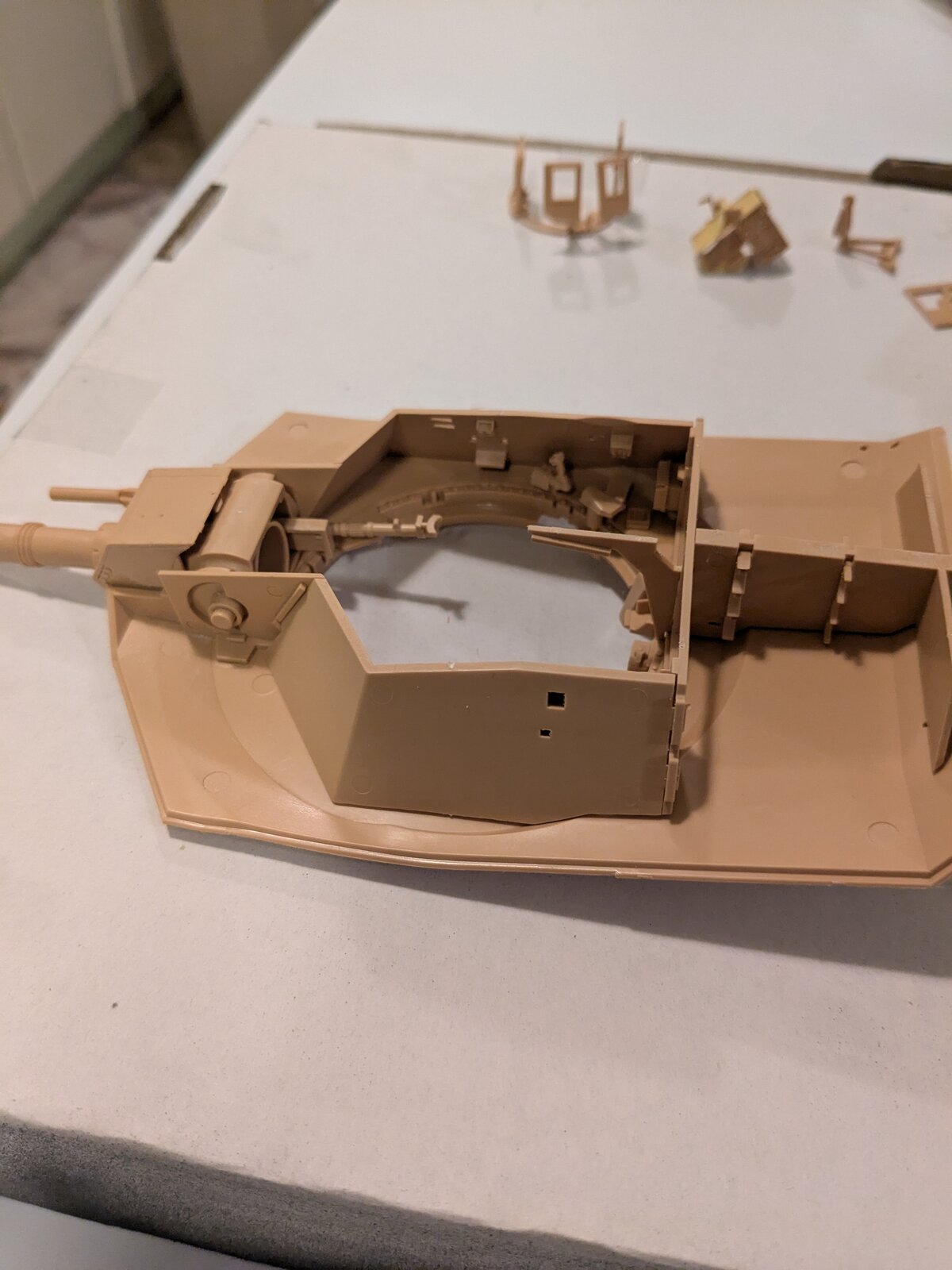

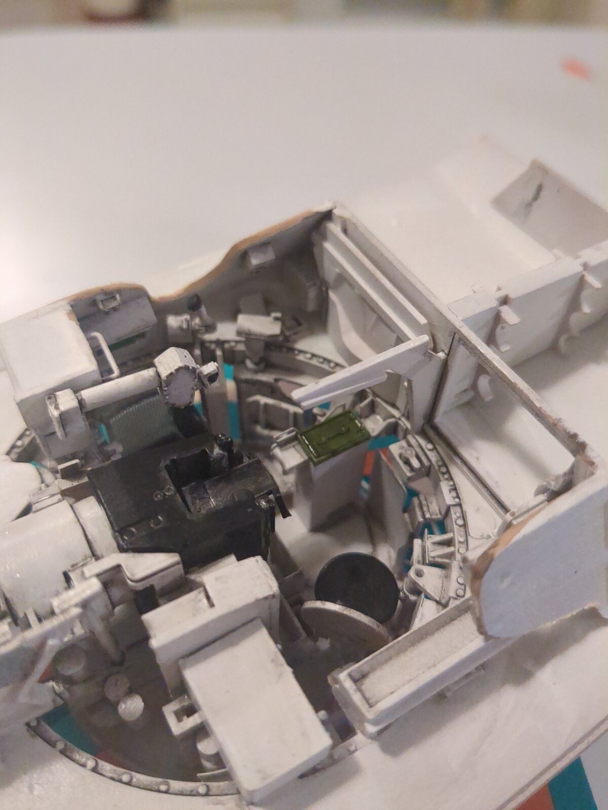

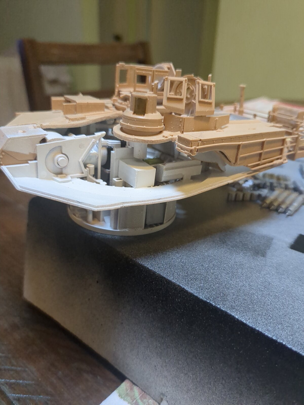

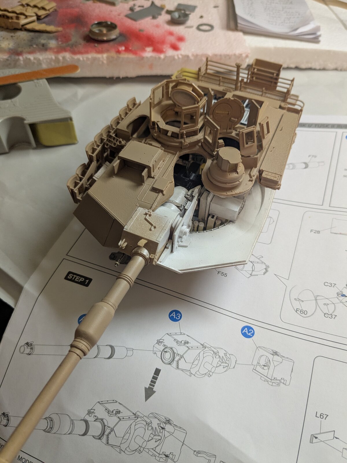

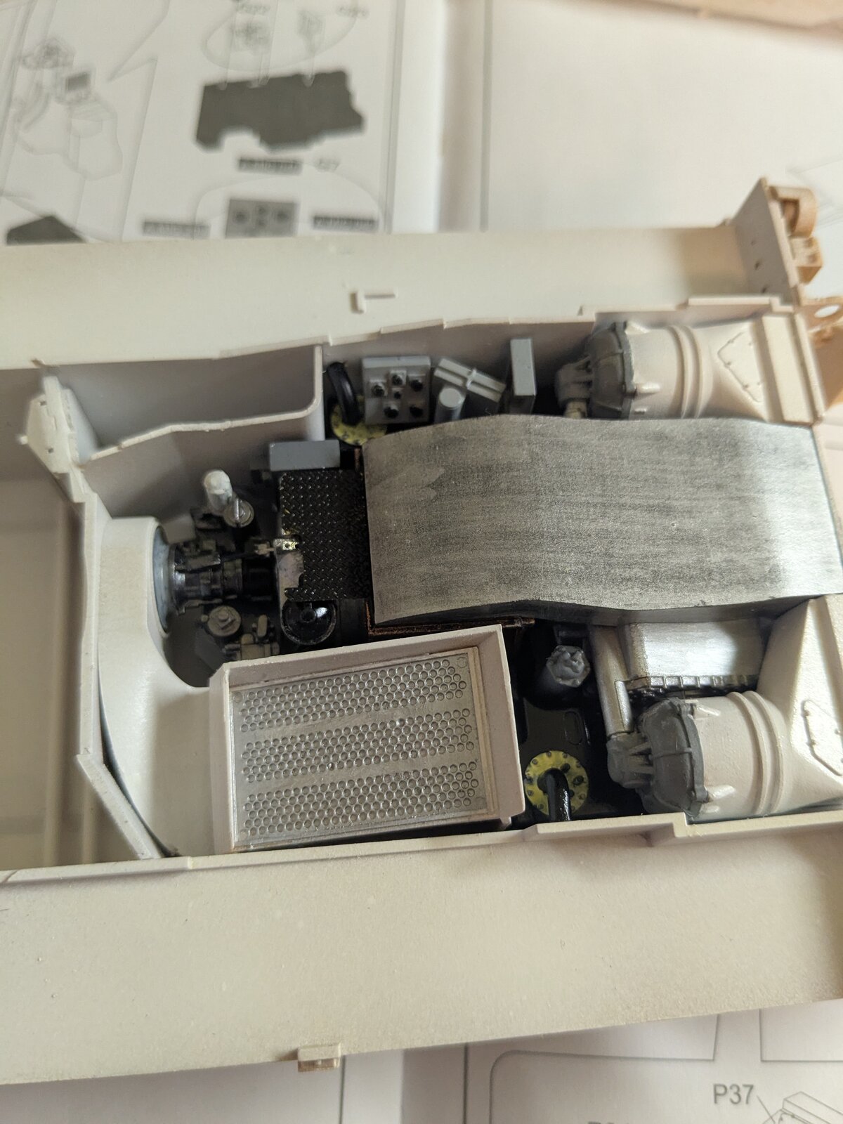

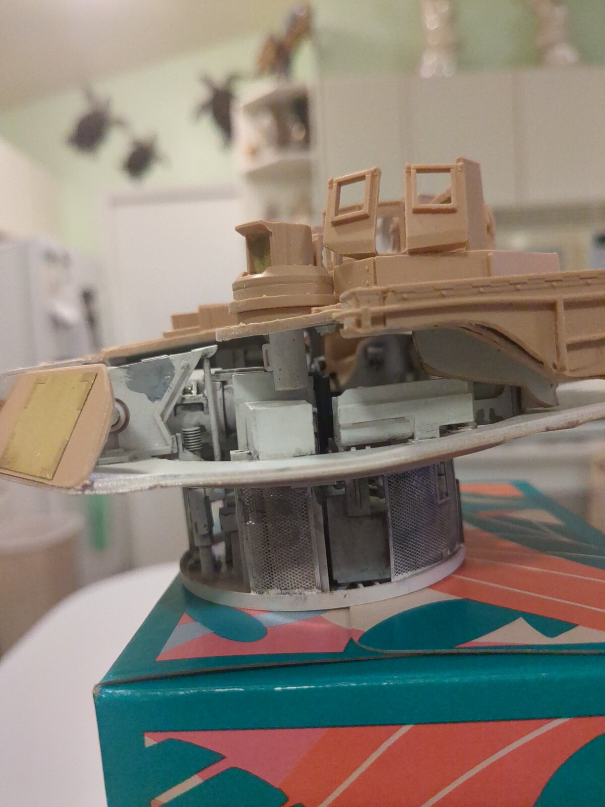

Started to think more on how I'm going to display everything when model is finished. I decided to do a interior wall cutdown to see it better from angle with how I'm going to display it. This brought up some issues to address.
I used sheet plastic to cover and fit those for the cutdown. This will allow better view when I finally assemble it all. I only cut the parts of the wall with no mechanical's on them.

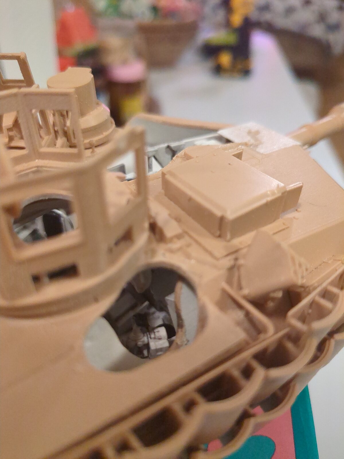

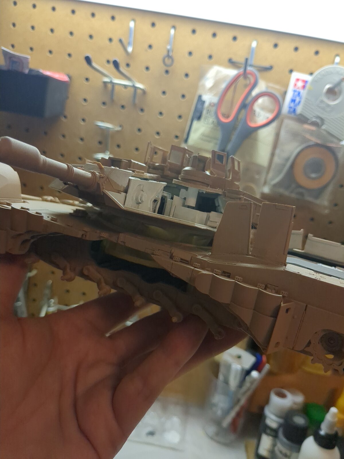

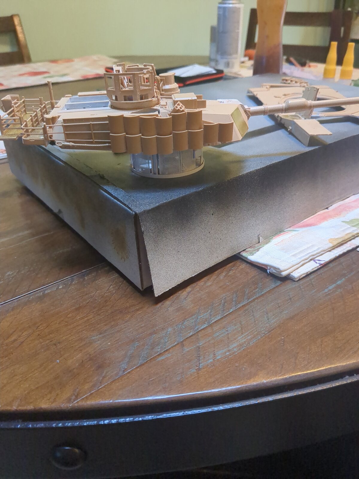

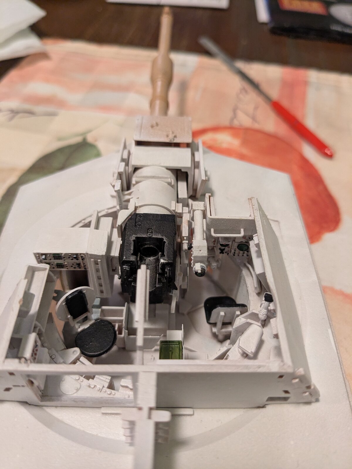

A rough idea of how the top will be displayed. There will be seperation between the upper and lower turret halves. It will be minimal, just enough to see interior but not to far as too look terrible lol.

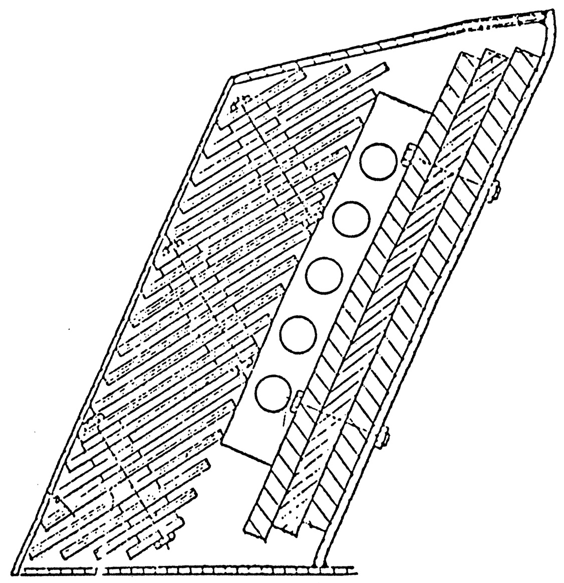

If you want to make a really interesting model, you could scratchbuild the armour arrays that would become visible if you lifted off the outer shell on the real tank :)
Here's a cross-section of the turret side armour on the original M1:

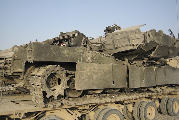

Possibly it's been changed on the M1A2, but going by this photo of a destroyed one of those, it doesn't look much different:
The stack of three plates with tube-things behind it, that's lying on the engine deck, is probably the turret front armour.
