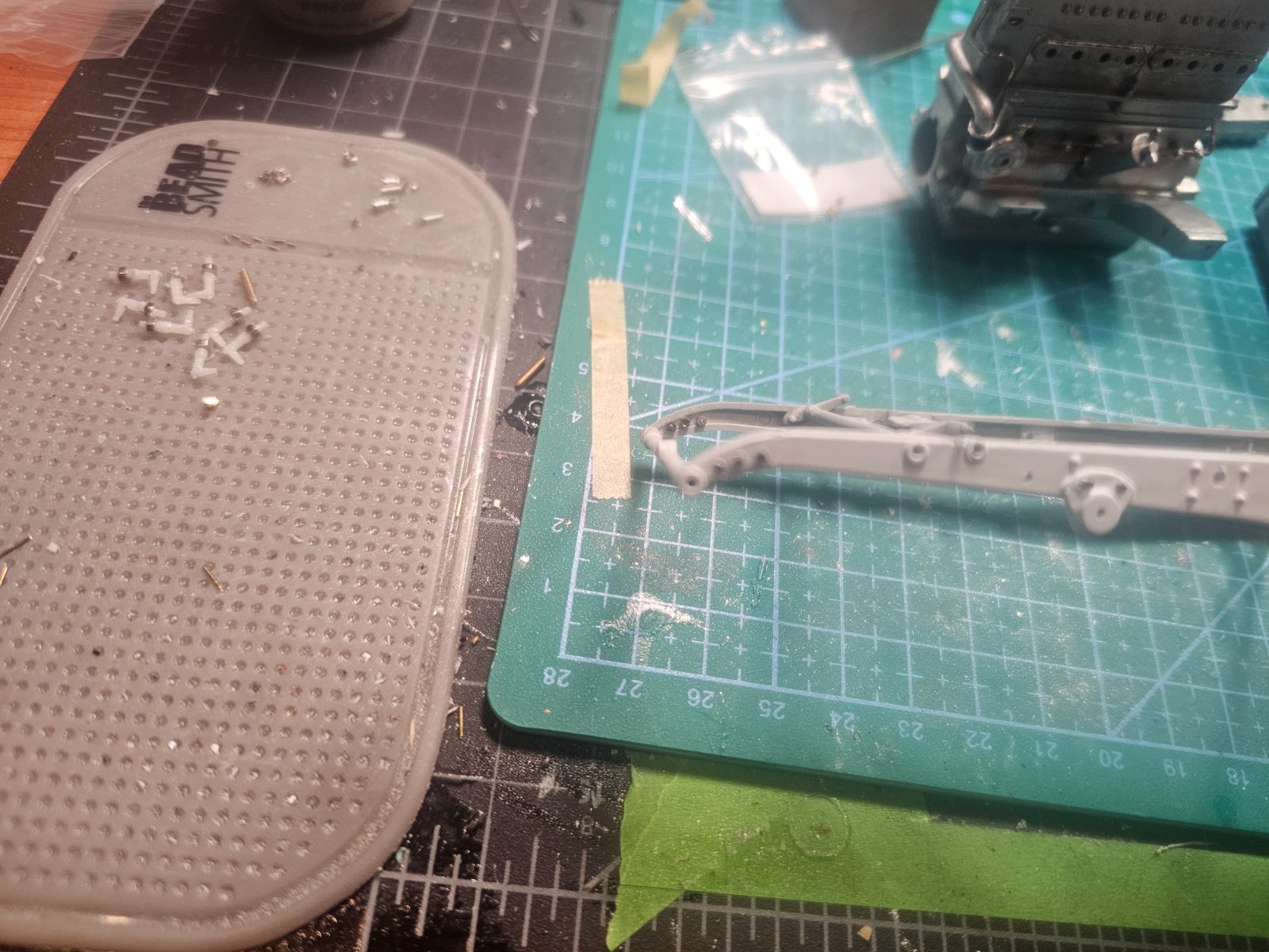

More fiddly parts!

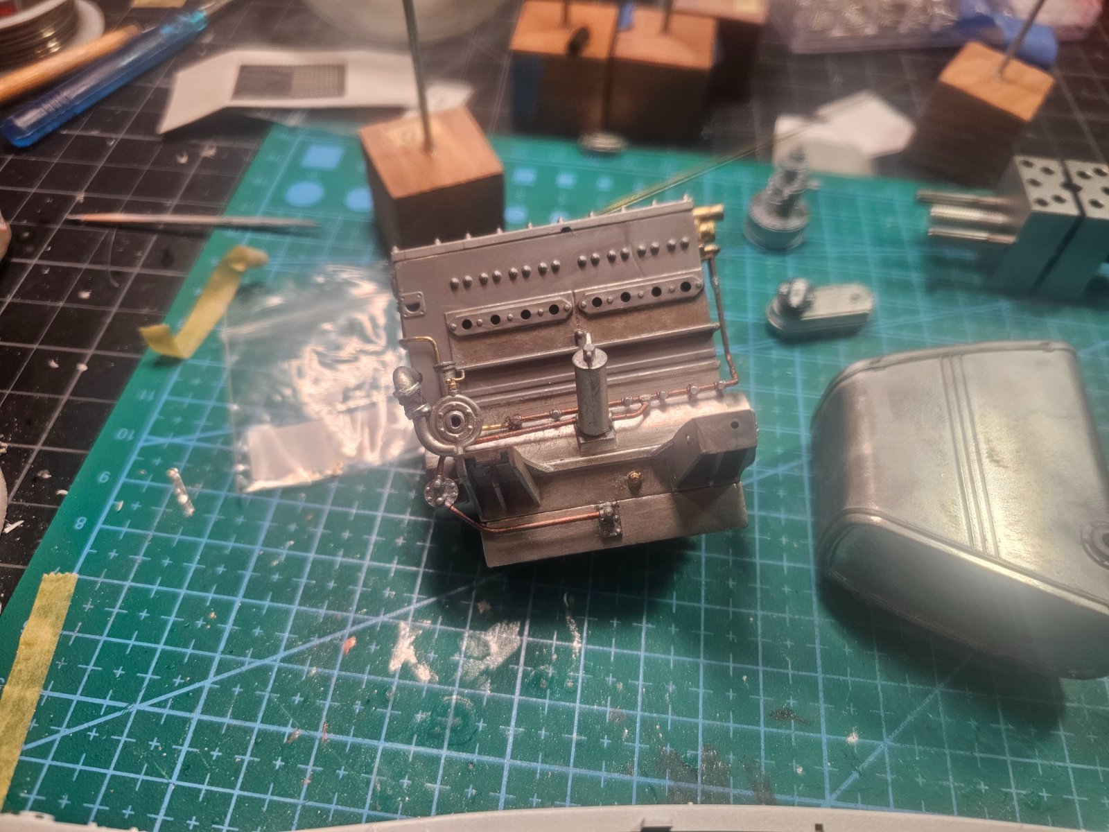

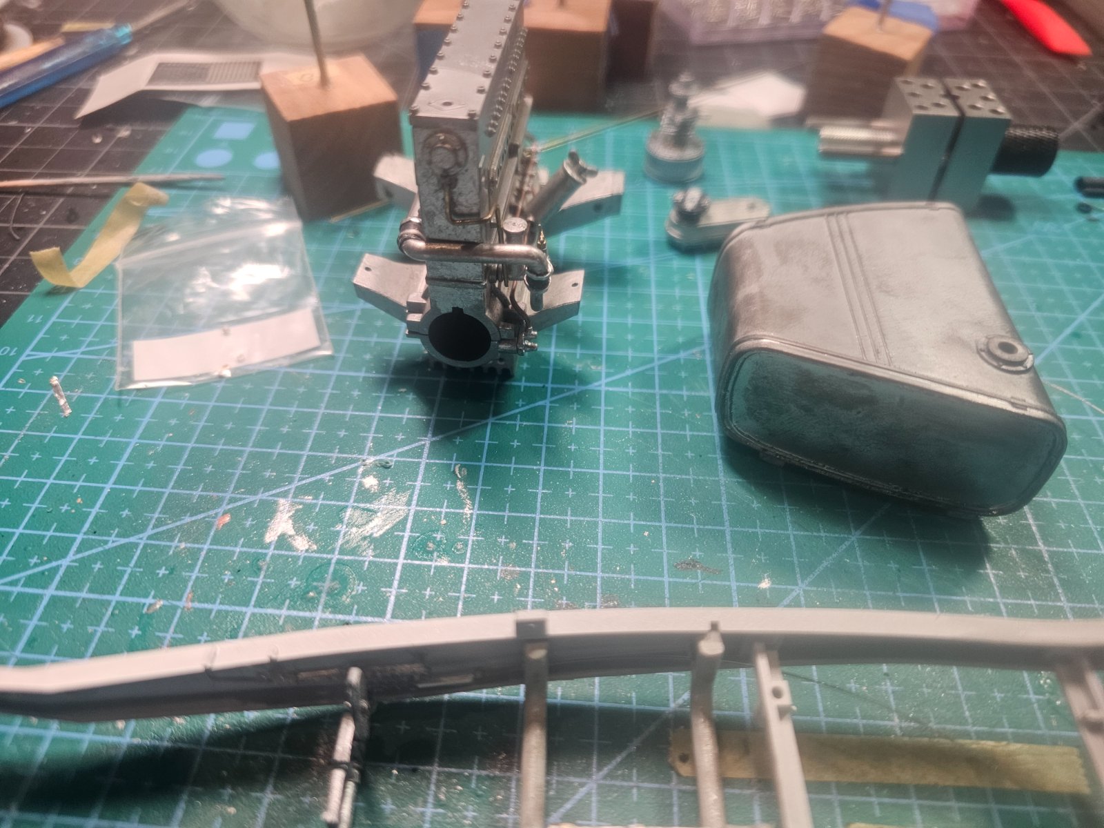

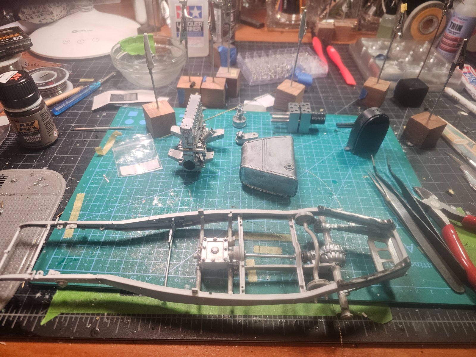

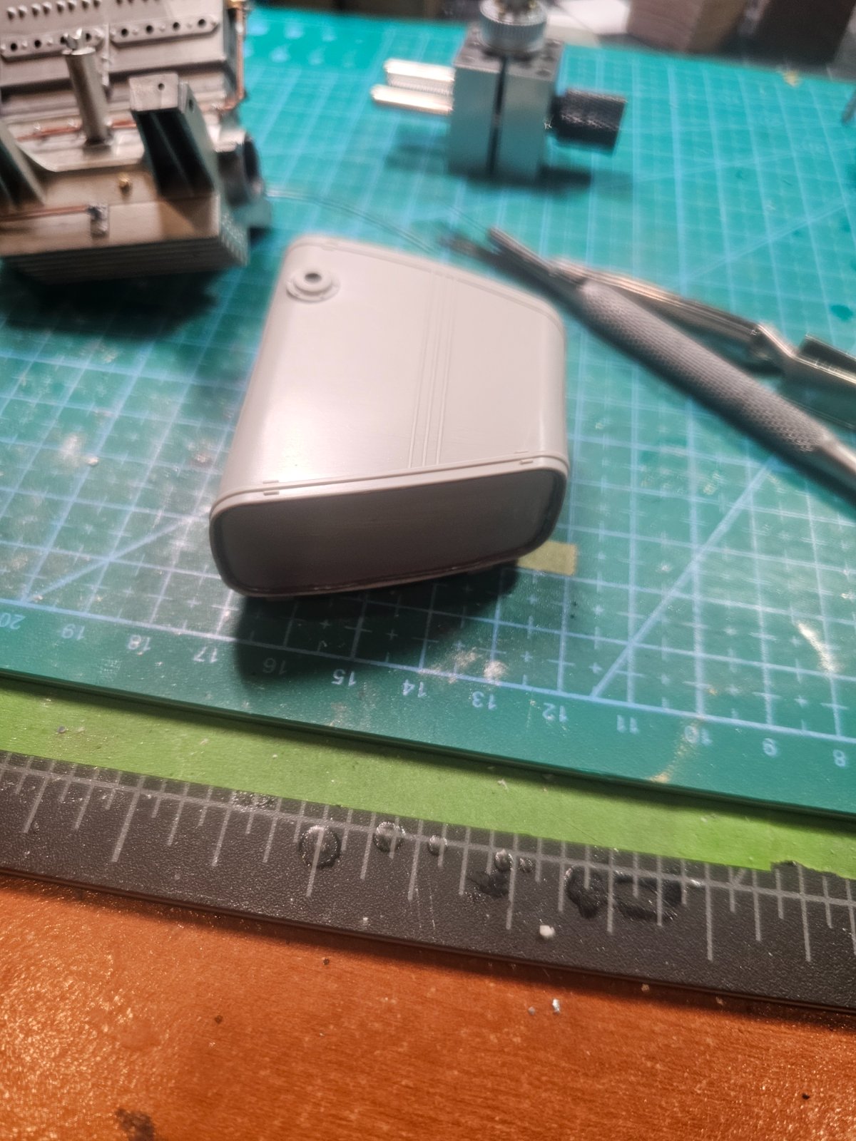

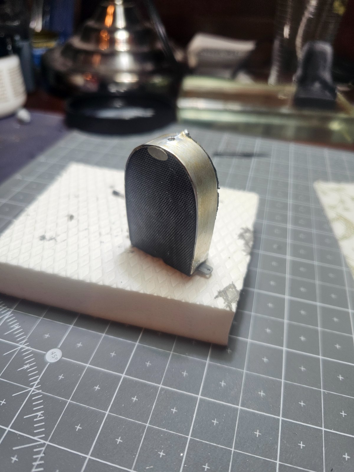

Starting to work on the gas tank..that no one will ever see..as well as the clutch..all will be hidden by body work.
The gas tank needs lead wire around the seams...at least ill know it looks like a welded tank.

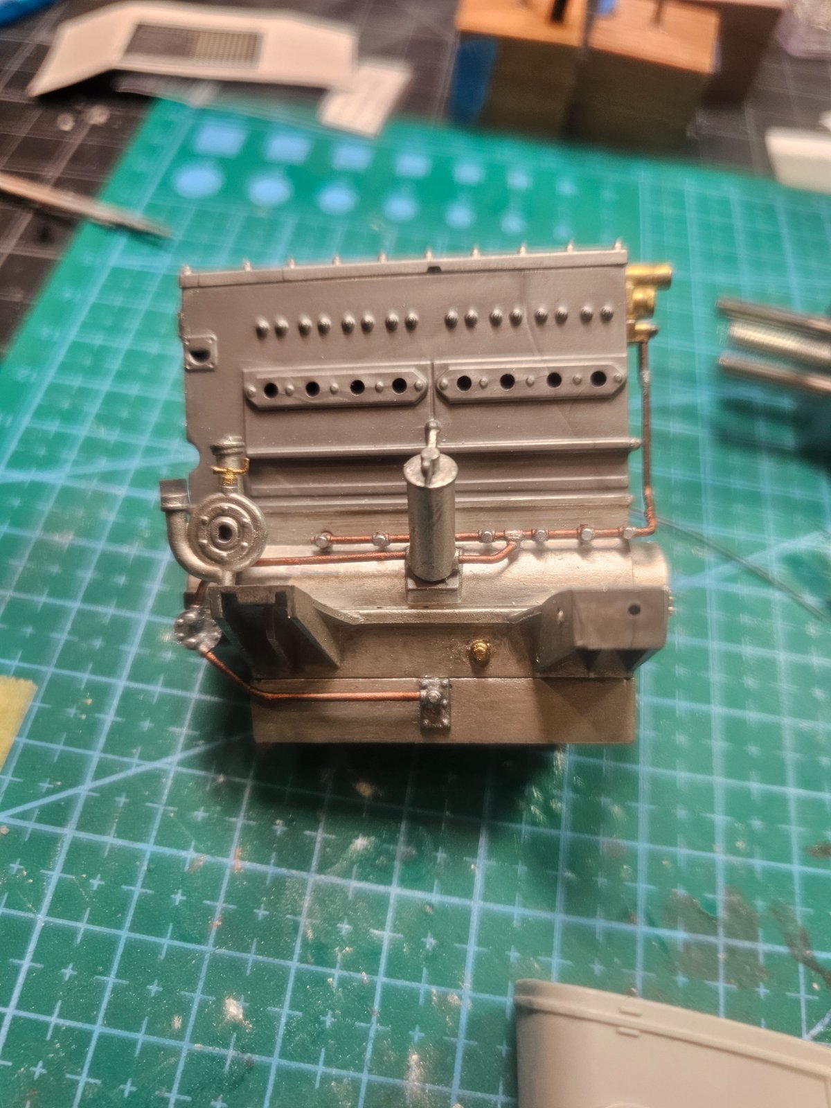

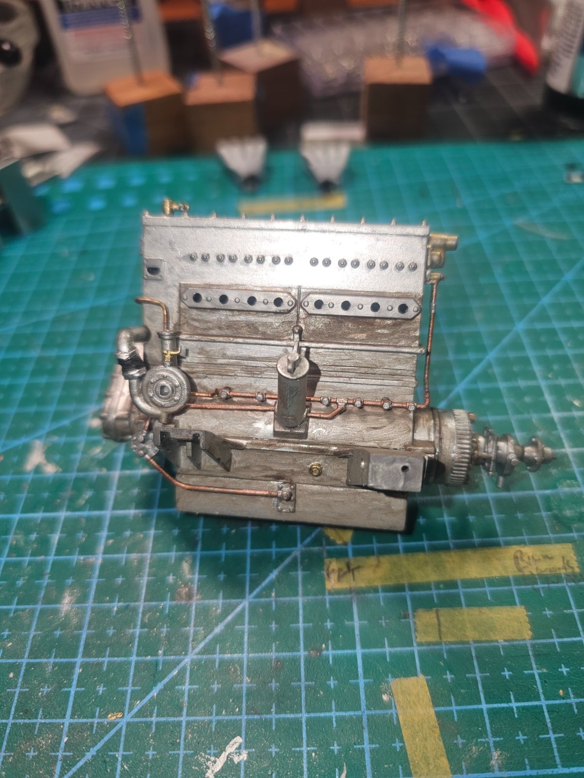

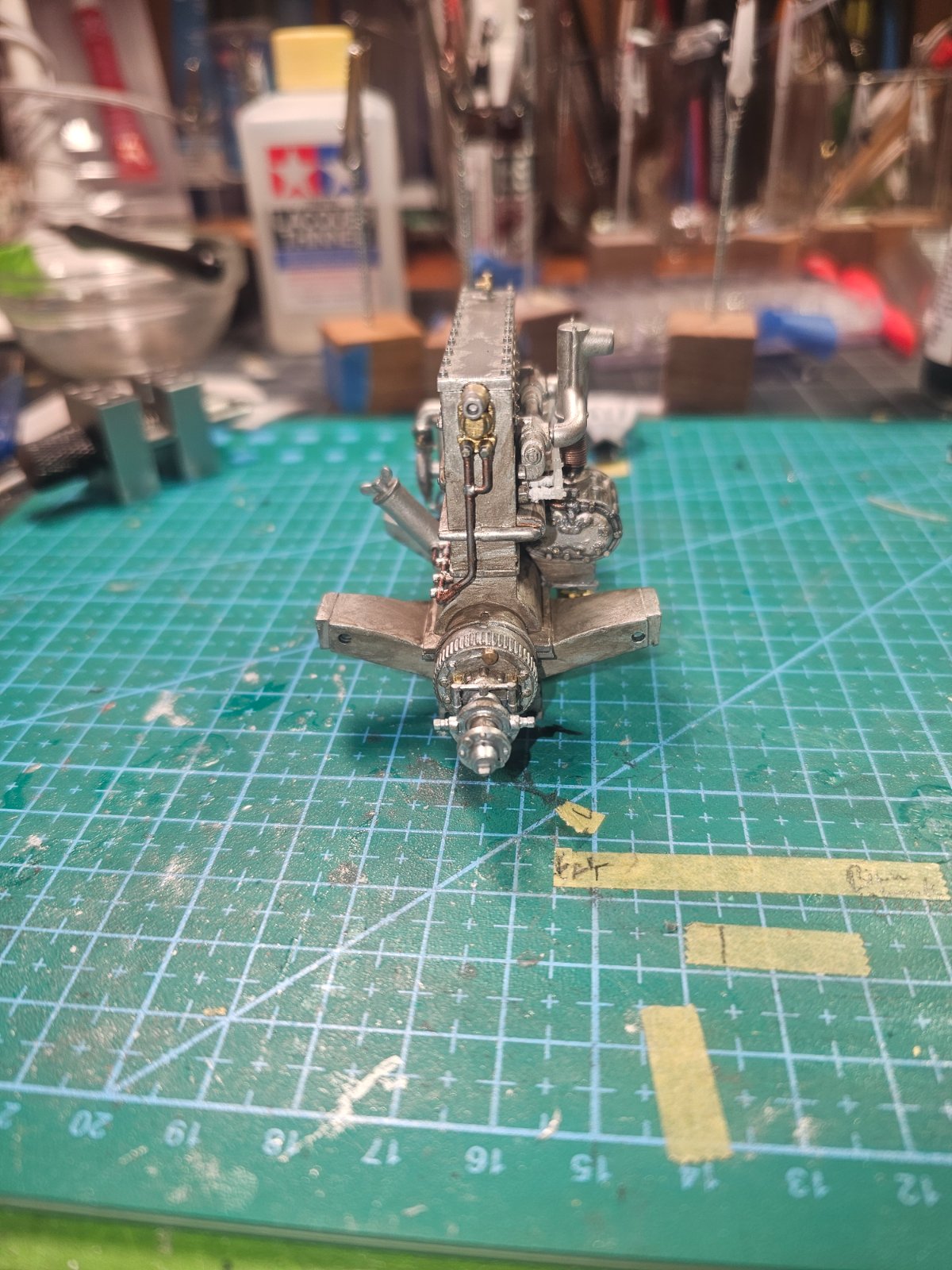

A d the motor for the most part will be seen with both bonnet open.
Worked most of the day on it..still waiting on nuts and bolts for the motor..and the ignition wire.

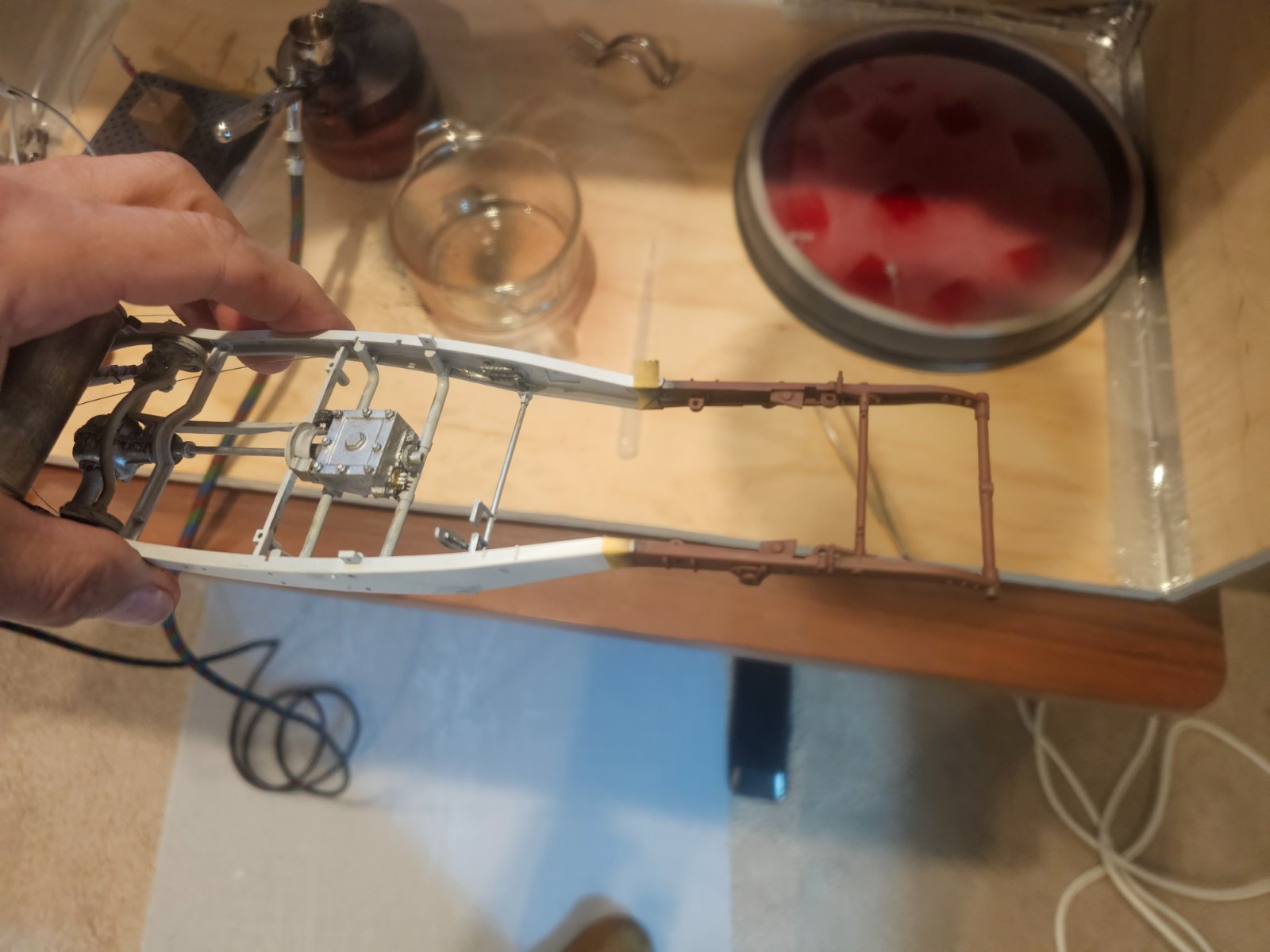

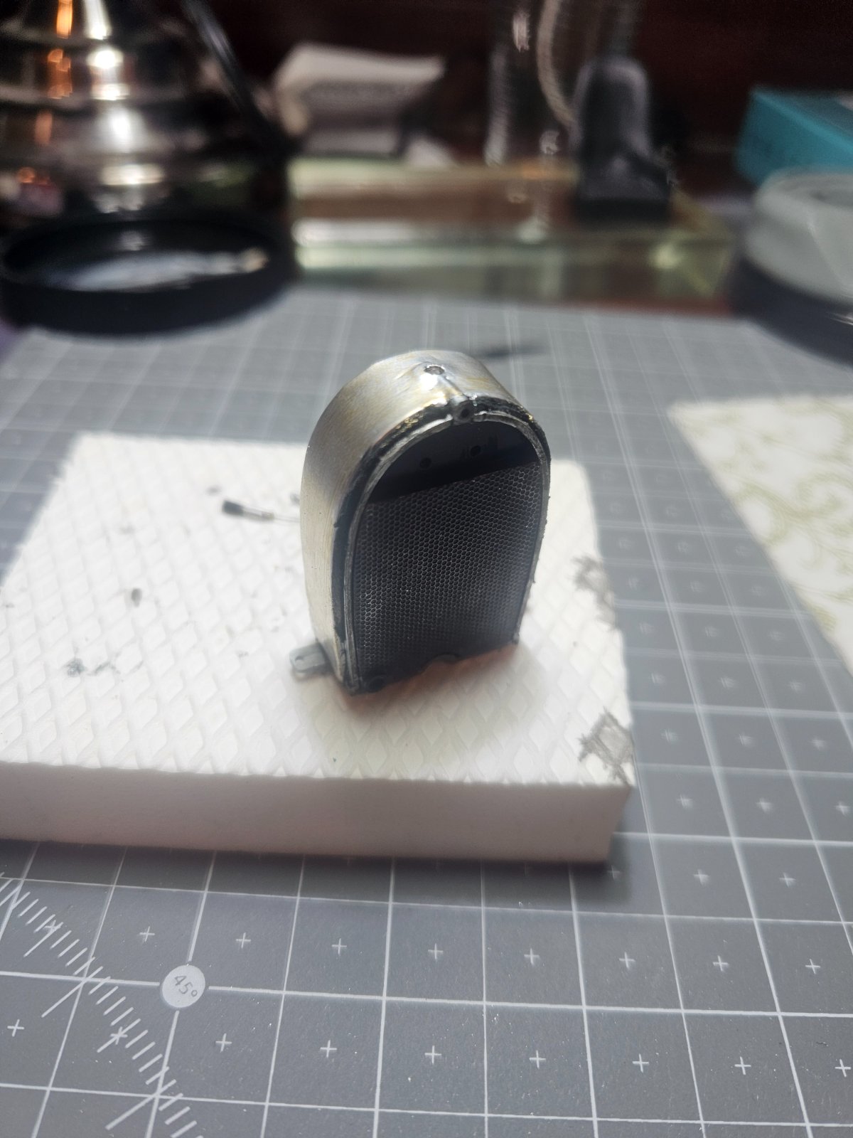

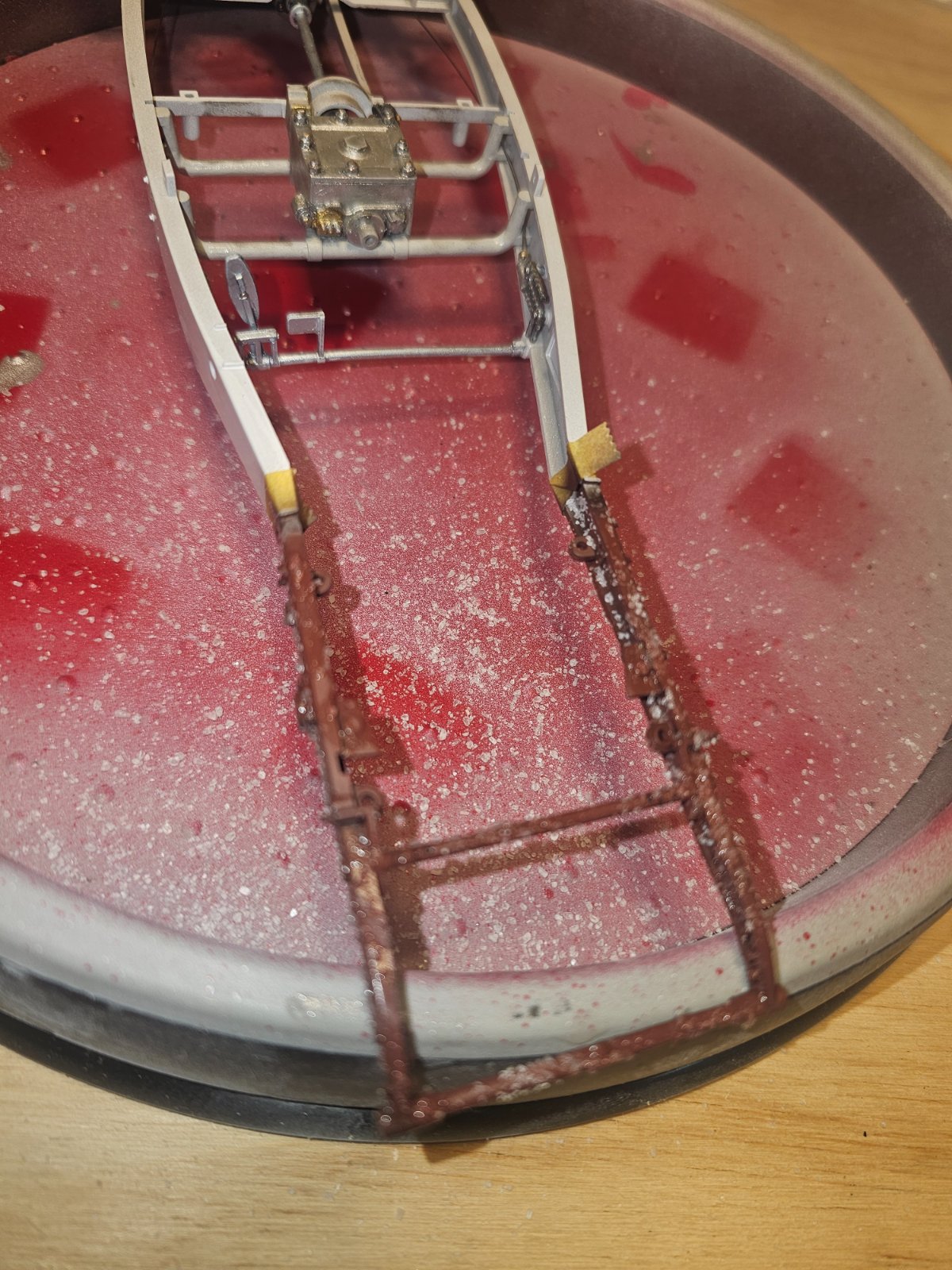

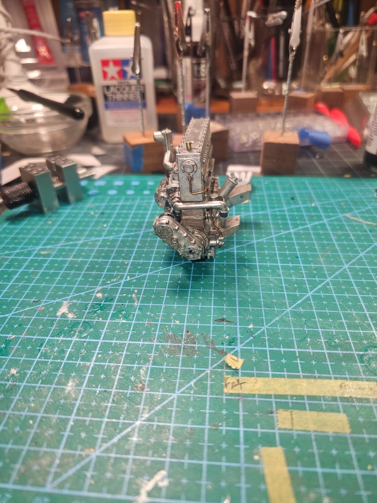

Weathered up the tank..added nuts and bolts to the frame..built the radiator.

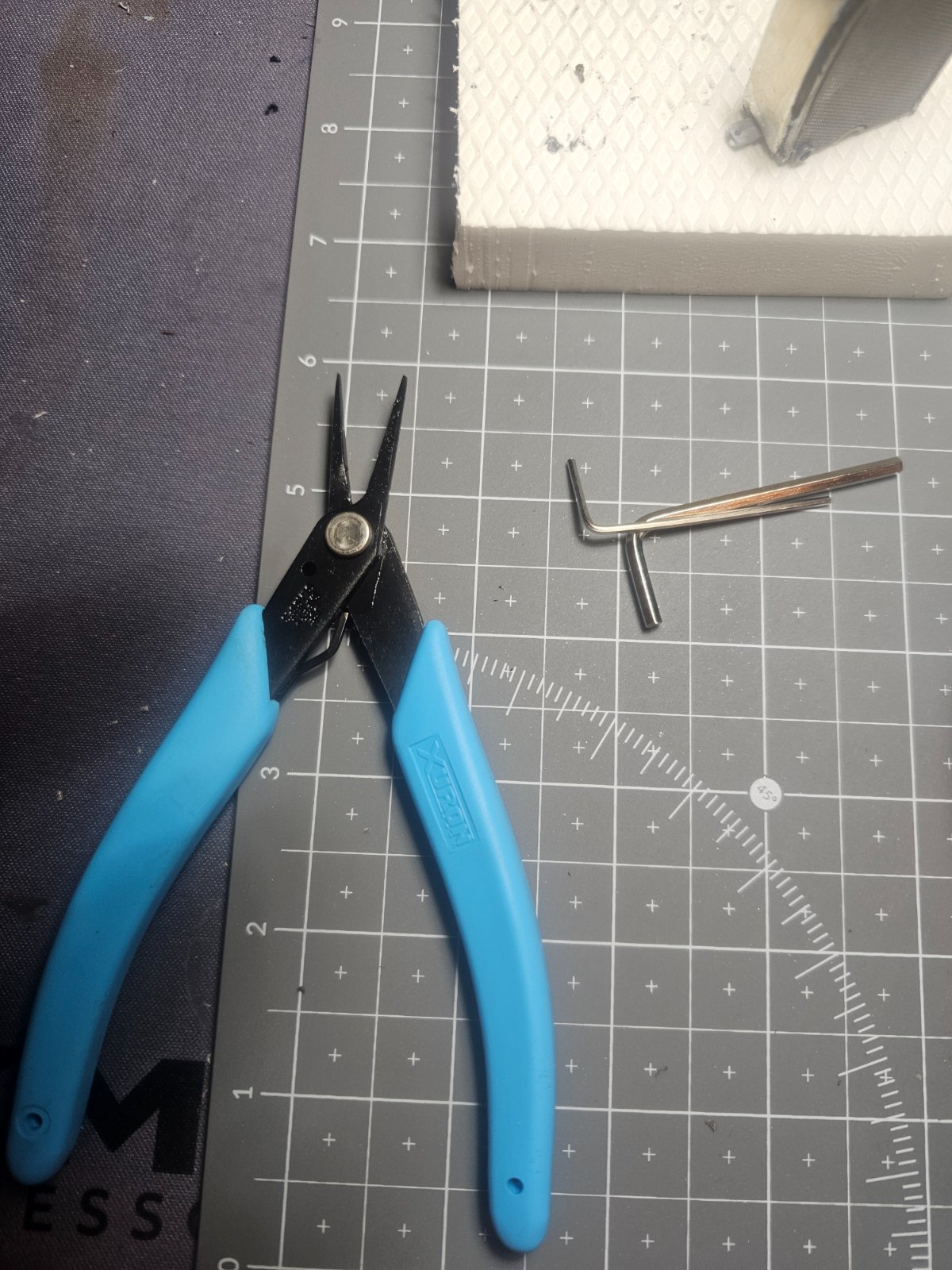

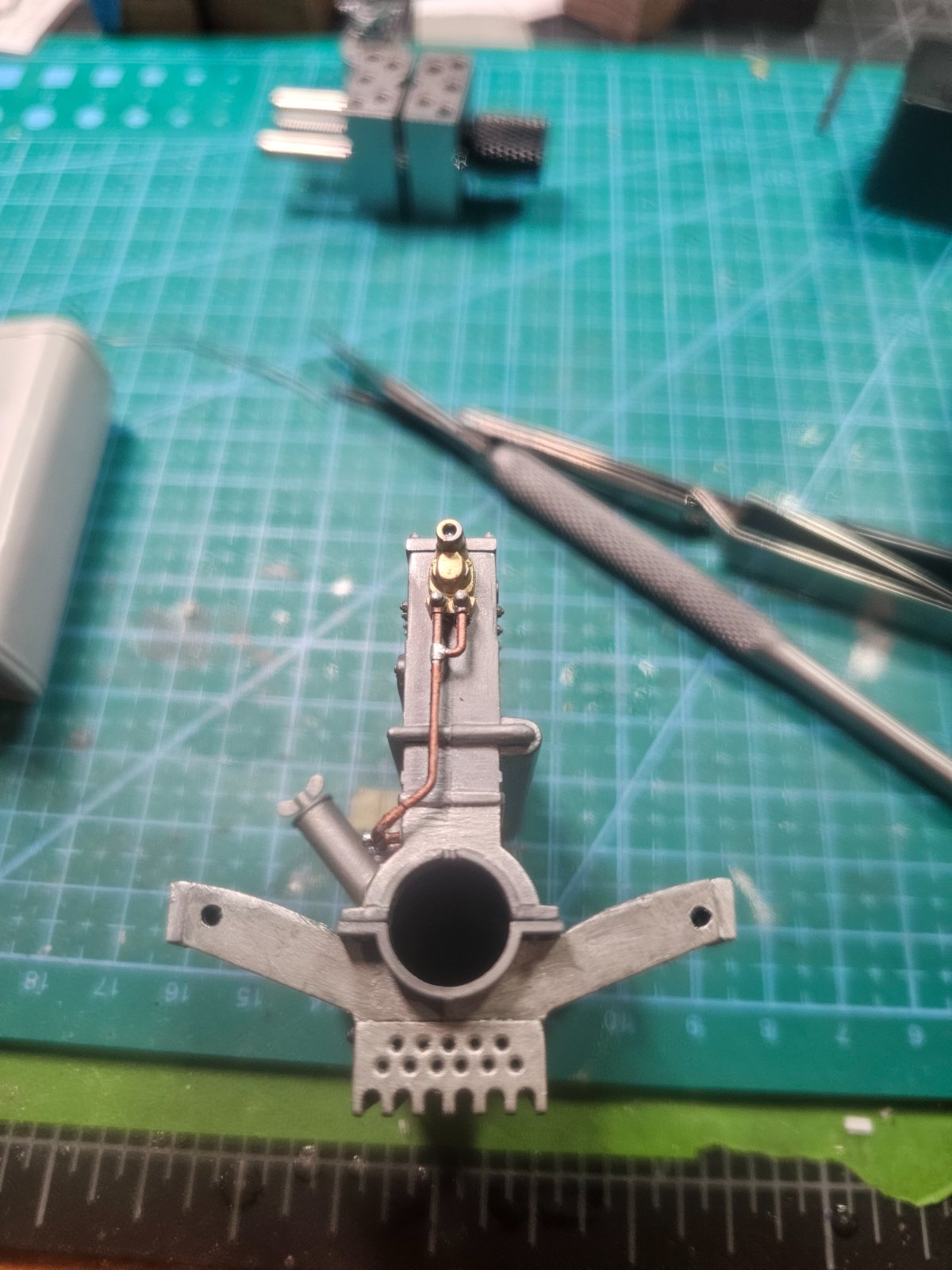

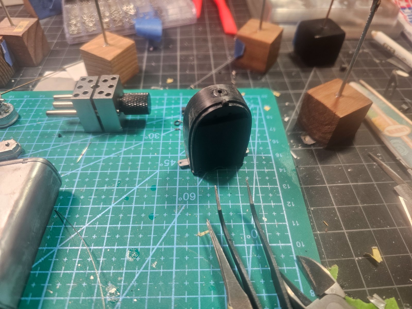

And ordered a whole bunch of better tools..bending the tubes and working with the pe..at this level my old stuff doesn't cut it.
I bought precision needle nose pliers and a bending jig for the pe. .more micro drill bits..a stepped roller for making hose clamps..those are a pain.

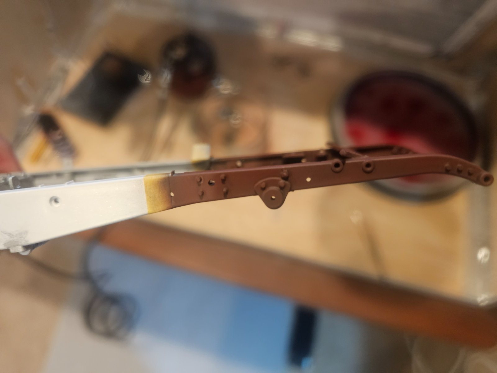

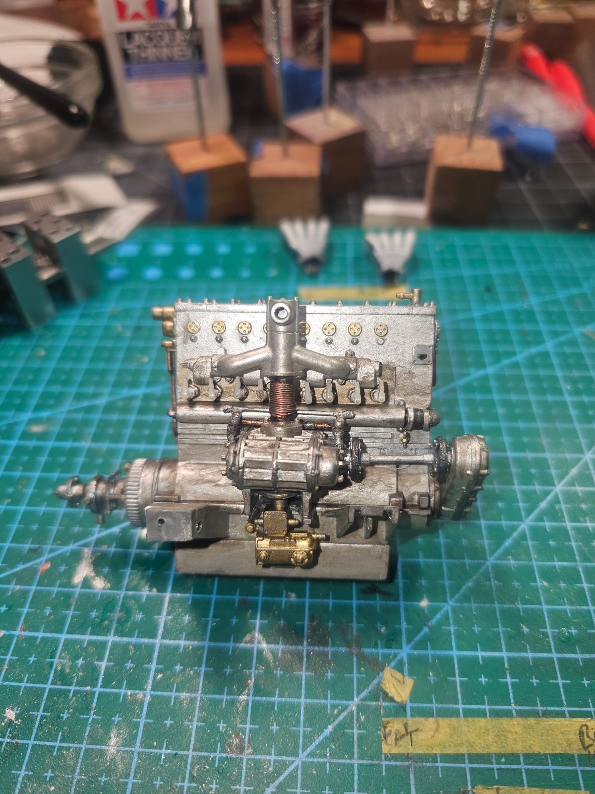

Well..waited 10 days for the nuts to come in..all 60 of them..and they are too big...scrapping putting these on the motor as I cant wait another 10 days for smaller ones..its stalling the whole build.
The ignition wires look good and painting the front of the frame is coming out good..as well as the radiator. The little black band is had to make from microscopic leather..guess it was a cushion fir the hood..

Nice! Those pliers are awesome... I've had mine for several years and they come in handy not just for bending, but also for 'forceful' placement of a part that would just fly off with tweezers; the edges of mine aren't perfectly parallel, so I keep that in mind if l'm bending across the mouth... and I've used tape on outside of jaws to register duplicate repeat bends on multiple parts.

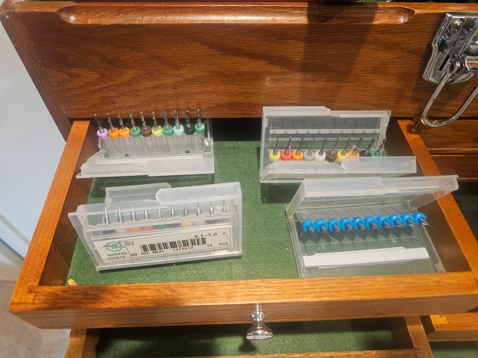

If you haven't used those micro bits, be aware that the smallest ones are super delicate, especially to torsion and the least amount of lateral force, while you are drilling, so you can end up with a snapped tip embedded in your part.

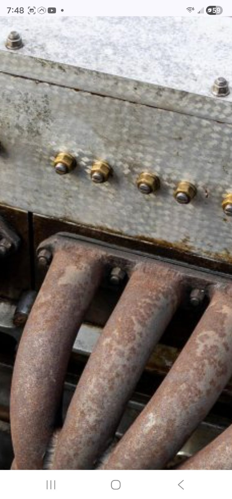

I did get the body bolts to safety wire the whole thing..had to get it from Spain...
Its just for texture..then rust over it.
Sorry but can you explain? I typically use Tamiya putty and will thin it for puttying purposes. I'm assuming you thin this the same way and apply with a brush? Kind of speckle it on?

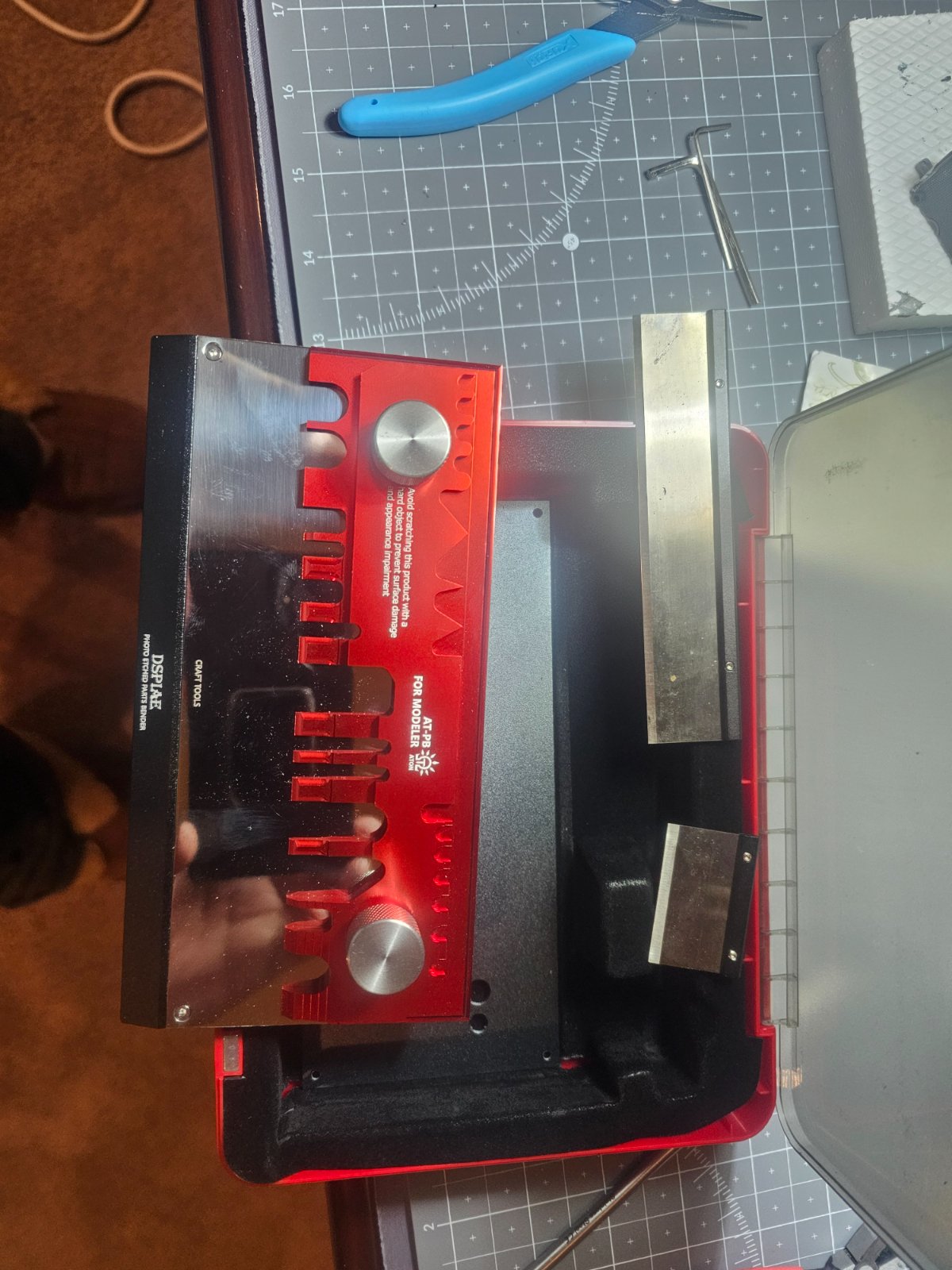

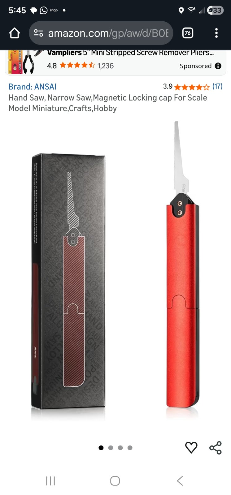

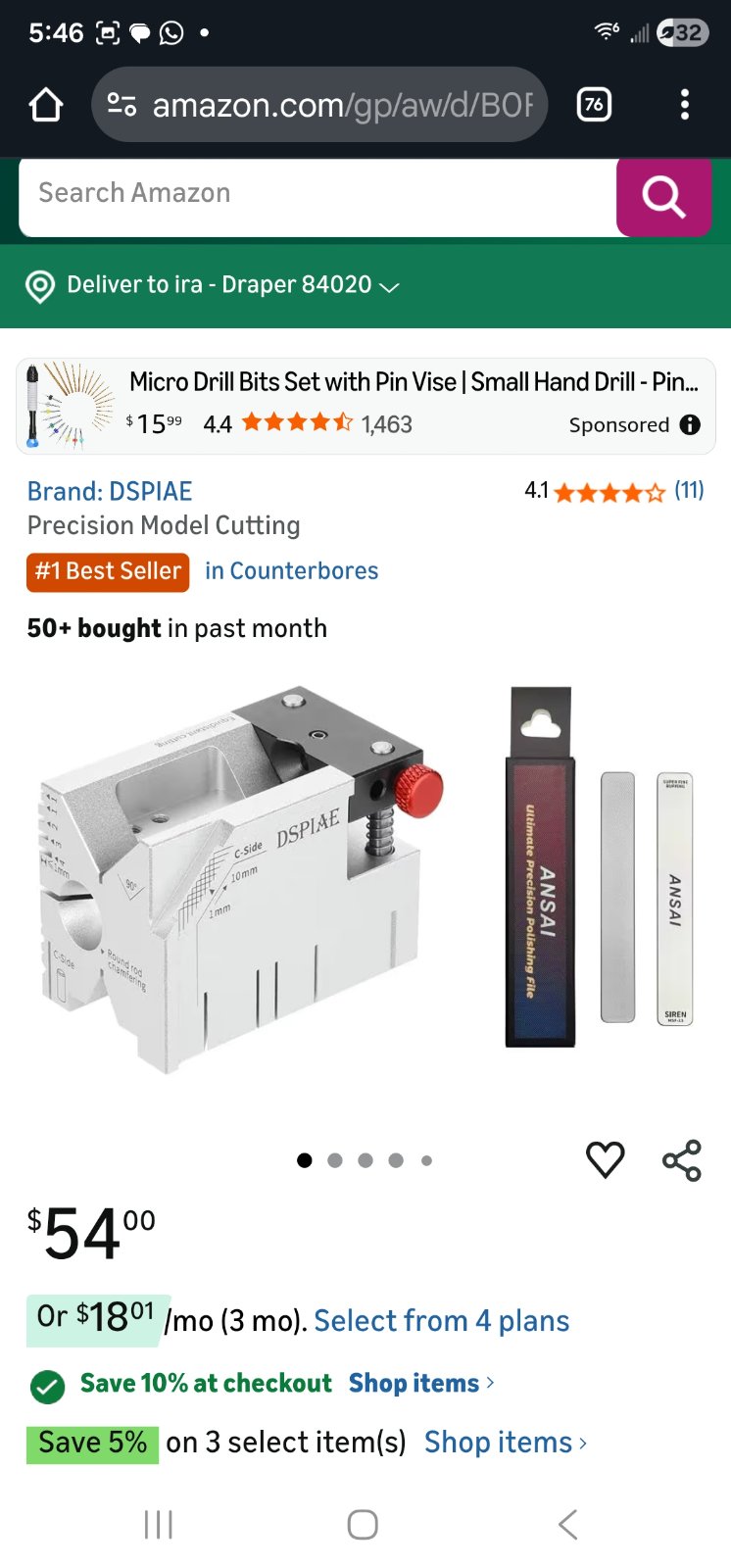

Just arrived on my porch..these should help with scratch building...good for cutting rod and styrene very precise
Also for drilling
