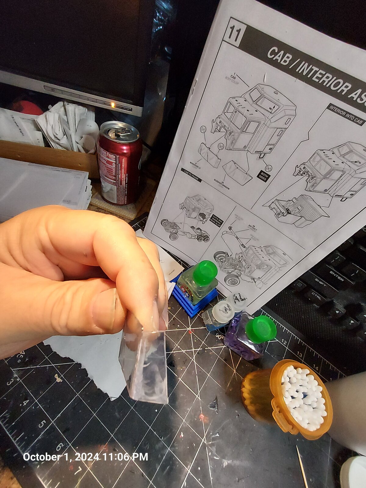

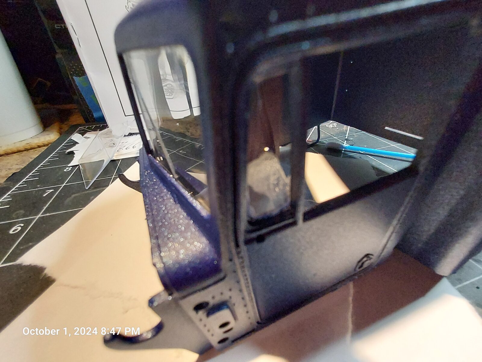

when i glued my windshield in the glue ran onto the clear plastic.
Superclean does not work, should i use my plastic polish

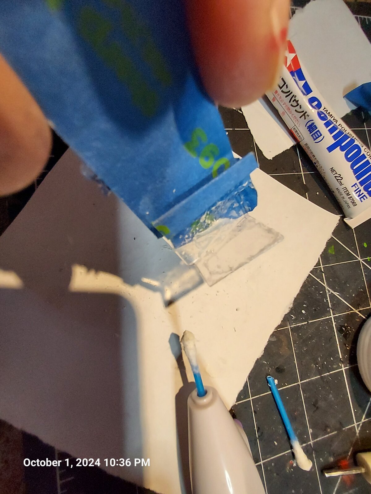

looking better. It also had paint and glue mixed. Most of that came off by scrubbing with qtip with alchohol on it by hand. Once that was off i realized a qtip fits perfect in my tool so that makes things faster.

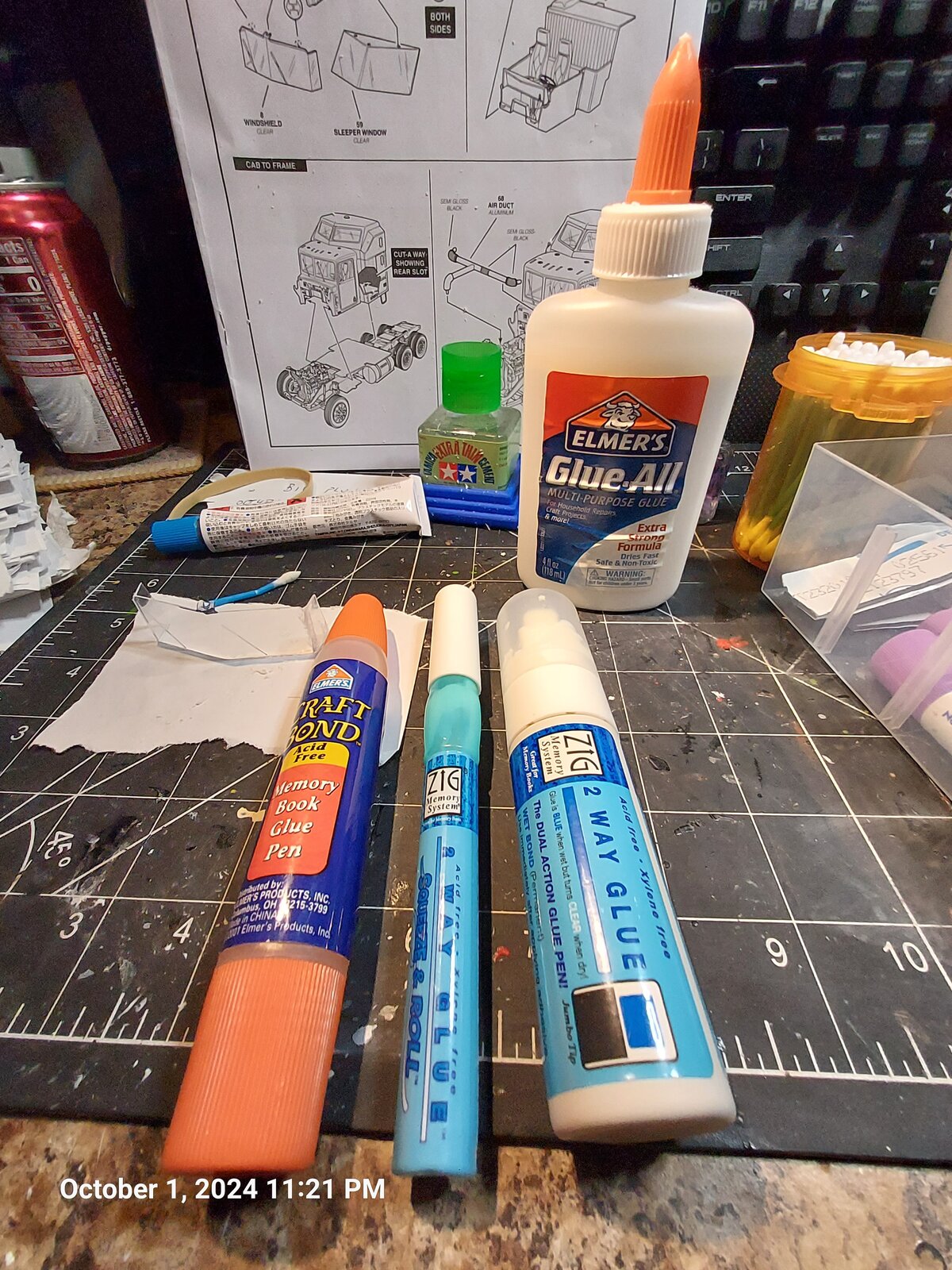

Here are the glues i have in the house. I also have wood glue, gorilla glue, and loctite extreme, shoe goo and similar glues in shop.
My apology but i have never heard of pva glue.
Do not tape the plastic before using solvent glue, if it gets under the tape the mess will be twice as bad. PVA is the better solution or Gorilla clear...
Just a tip for you, dip your clear parts in pledge before masking. Then if you get anything on them you can strip off the pledge and start over. That is if whatever you got on it won't penetrate the pledge, it also helps prevent fogging. So far I've had no issues doing it this way. Now dipping the clear parts is the first step of my build, so I don't forget.
" My apology but i have never heard of pva glue. "
That's the Elmer's Glue All
" polyvinyl acetate "
All the white glues and yellow wood glues are PVA or PVAc , the c being a compound monomer with a vinyl alcohol mixed with the vinyl acetate ( yes , I know , eye glaze )
this is good stuff , dries completely clear and higher adhesion on plastic over Elmer's ,
https://www.scalehobbyist.com/catag...t=2&u=0&pg=2&ppp=48&sb=stocknumber_a&so=d&e=0
It is also a PVAc
