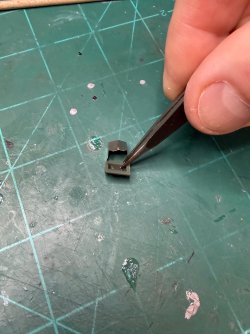

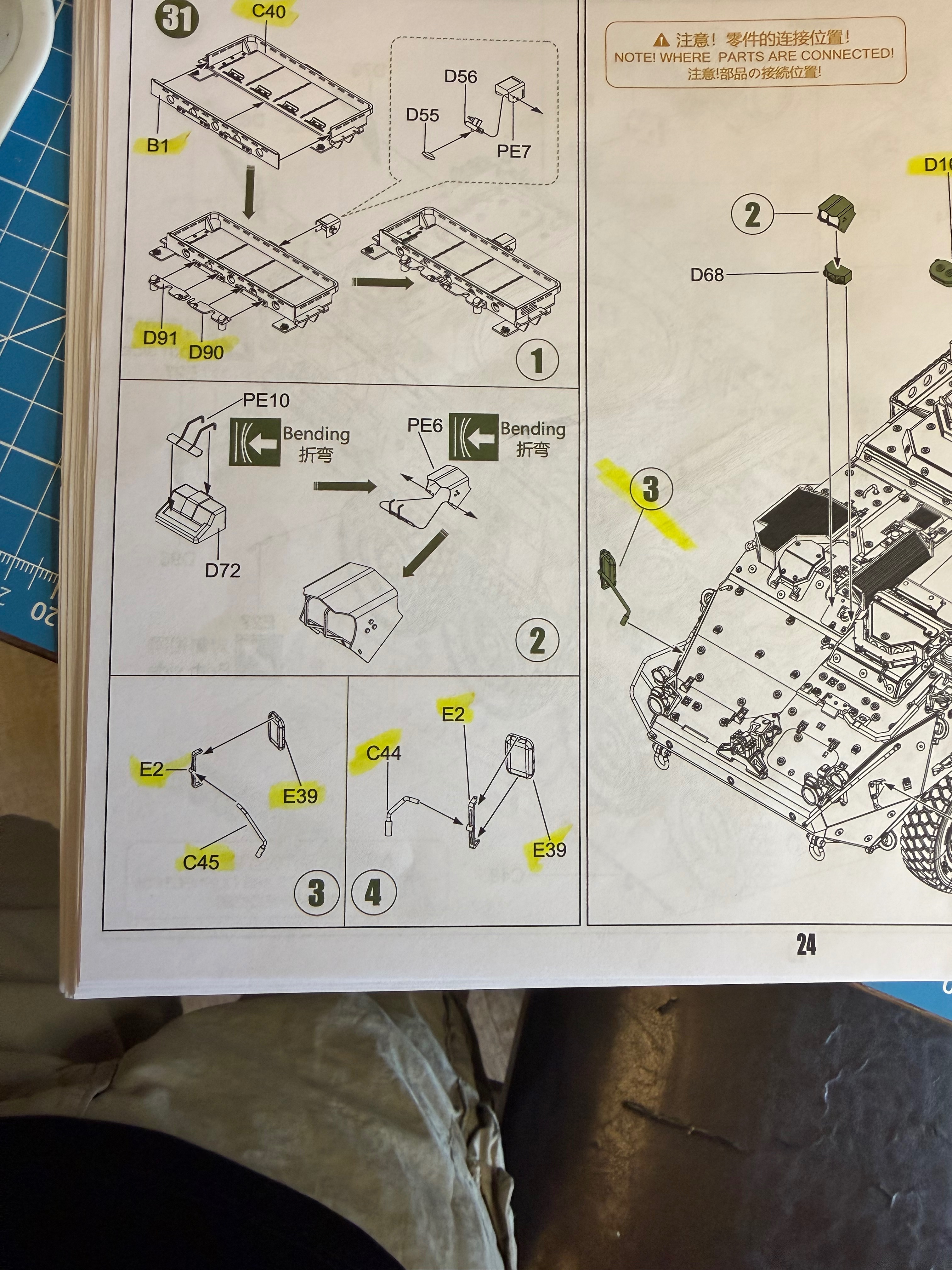

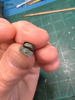

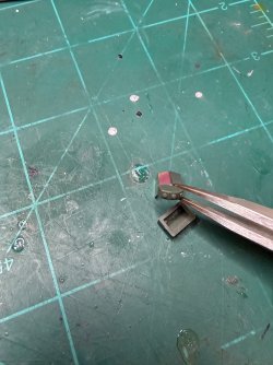

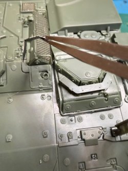

Hi guys. I've been messing with this part for days, researched it, used AI etc. it's driving me nuts. It's for my Zimimodel Stryker 1296 1/35 kit. Directions are awful-obviously. I'm showing pics of the parts and the size of d72 and orientation is what I'm not understanding. Pe is folded into a hood. The shape it is right now the bottom tabs line up with two spots-a slot and a raised line of plastic so it seems this is correct shape and placement for the hood. From the pic I pulled off the internet it looks to me like d72 lies on the sloped plate- slope to slope and then the smaller width plastic piece with the three circles sits on top. The problem is the width of d72. I'm thinking about cutting it down to fit but wanted to see if anyone is catching something obvious that I am having a mental block with.
