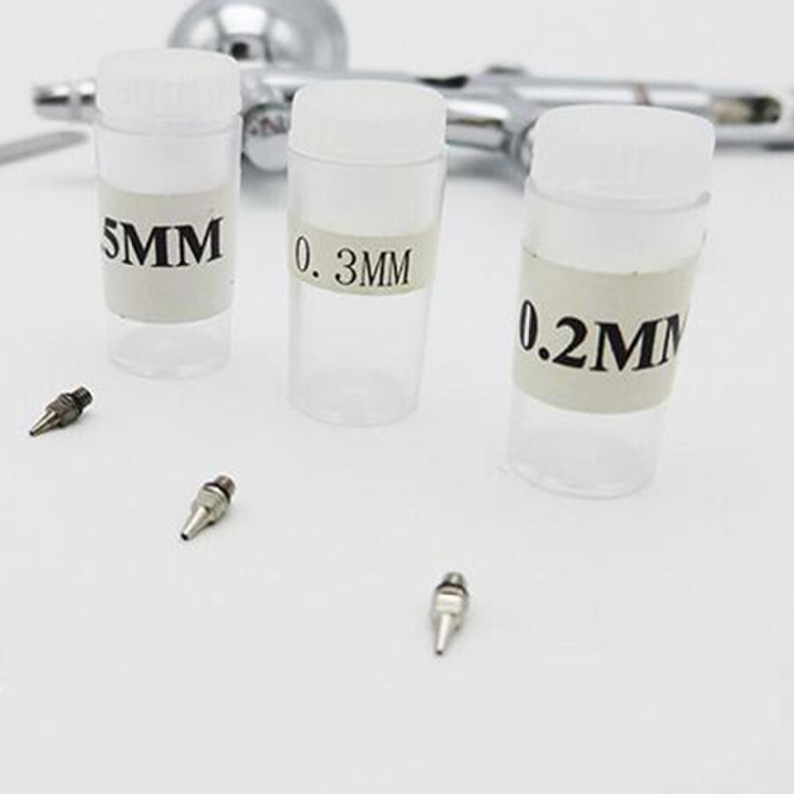

I have three airbrushes, one is badger renegade velocity which i don't like the other two are cheap airbrushes, one has a conical nozzle and doesn't contain o-ring, other one is threaded and has a small o-ring so i'm always worried about using that one with lacquer thinners, do you think that if get rid of that o-ring and apply beeswax or vaseline on threads will work as good as o-ring?

i'm talking about this kind of nozzle, teflon tapes are too thick for it's threads i think
That's called the spray tip .
The air cap goes over that .
crown cap goes atop the end of the air cap .
You should be able to acquire a bunch of those O-rings for cheap .
It might not even be necessary if the threads and the seating surface isn't garbage .
Problem is that they don't sell that miniature o-rings but they sell it with nozzle (you call it as spray tip) as a set. I don't have a problem about air cap's o-ring, that's outside of the liquid flow. I always apply beeswax on it's threads while keeping o-ring.
