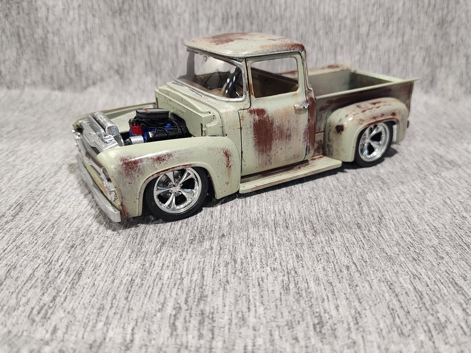

Foose Ford Truck. PATINA!
fantacmet
Aug 15, 2025
97

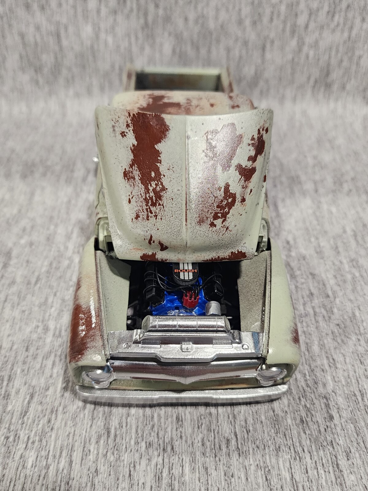

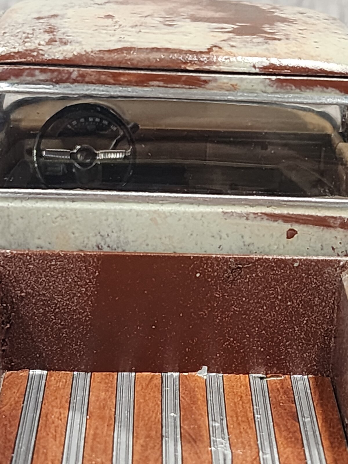

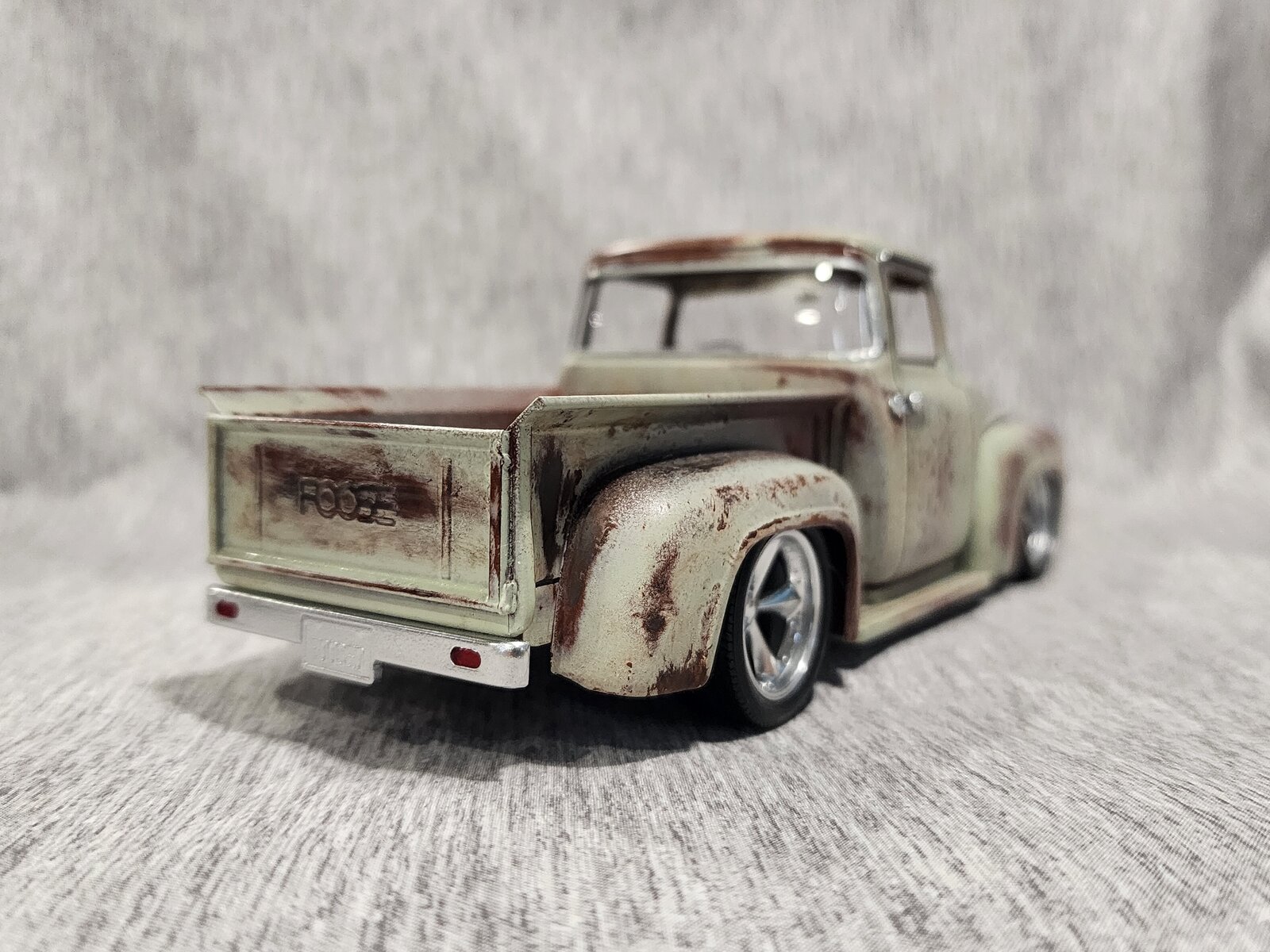

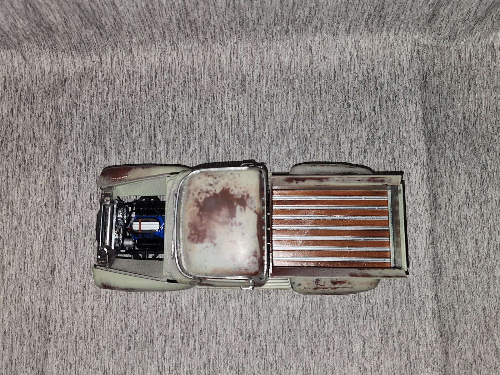

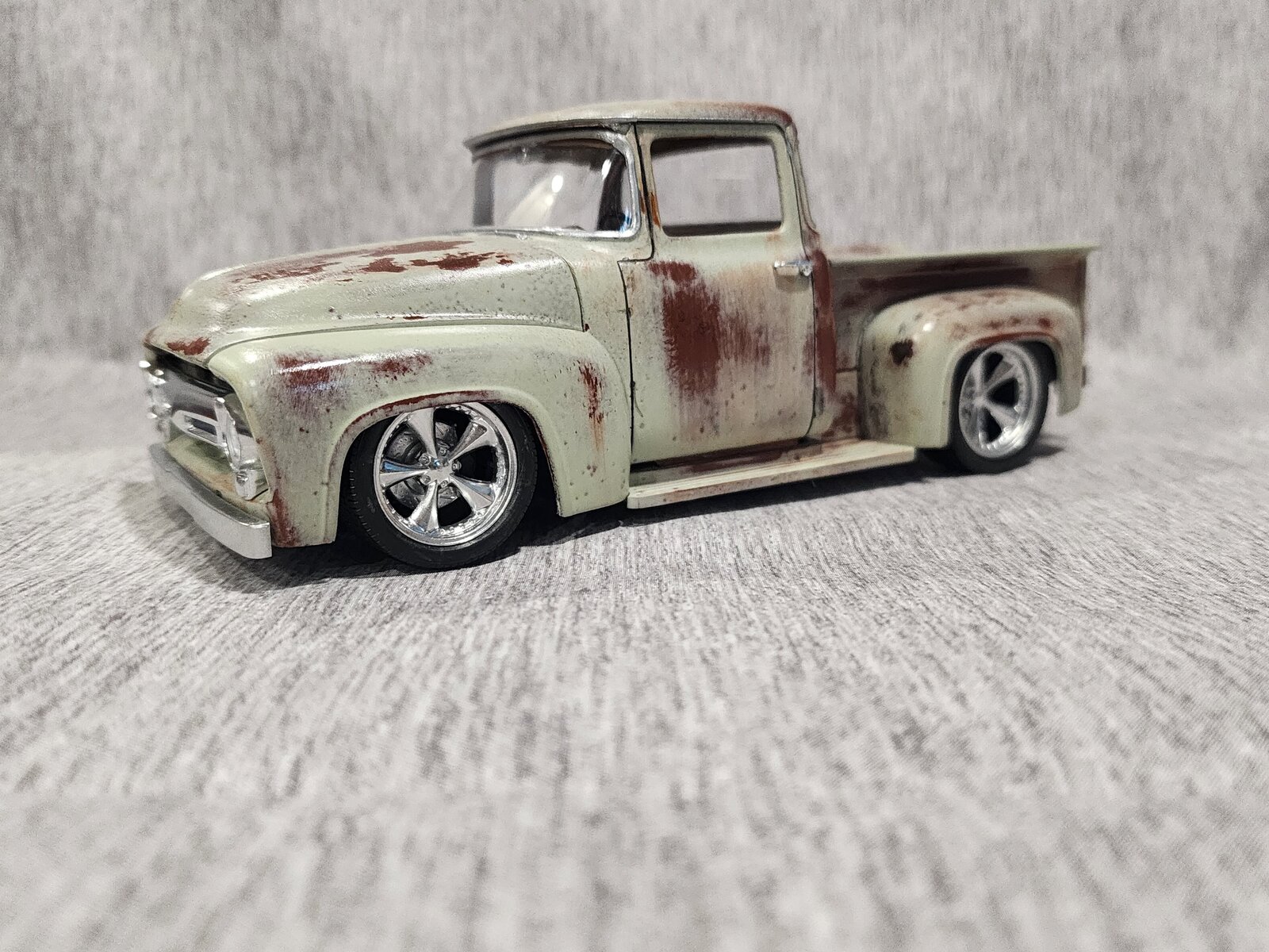

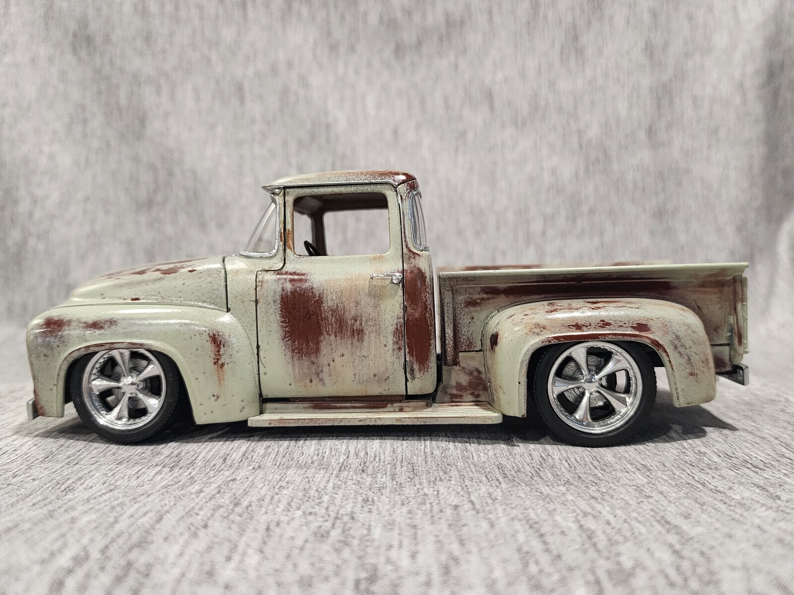

Built this a couple years back for an Instagram Foose Build Off. Lowered a bit from the kit. Chrome stripped and sprayed from molotow. Main color is a Pactra acrylic rattle can. I used Q-Tips dipped in Acetone and rolling back and forth(rather than rubbing) to remove the surface paint. Rusty primer underneath.
That main colour really suits the subject; kinda sad to see it in a bad way...
I honestly had to go that route because the paint got damaged lol. I was trying to remove some paint and save the primer and this was a happy accident
I know its just funny how things turn out sometimes. I think it would have been a great color too, but the paint had other ideas. It fisheyed on me.
