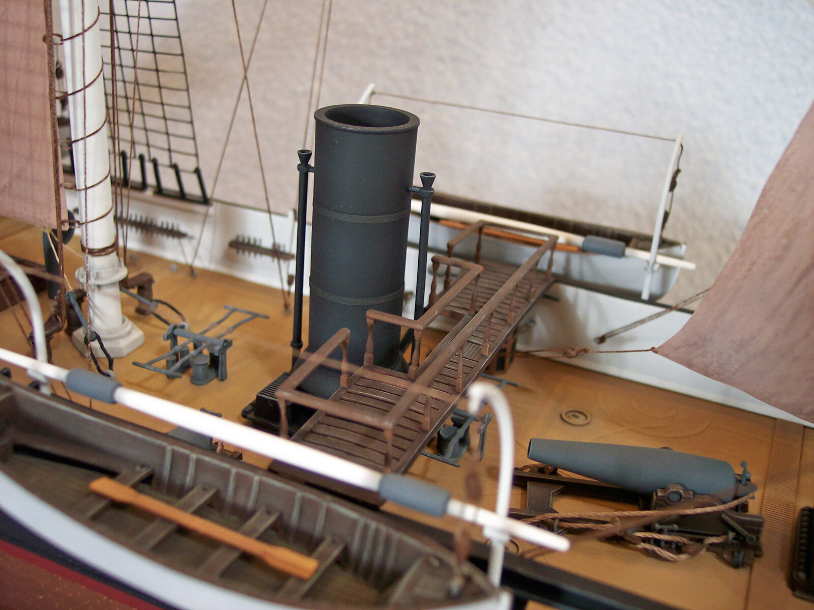

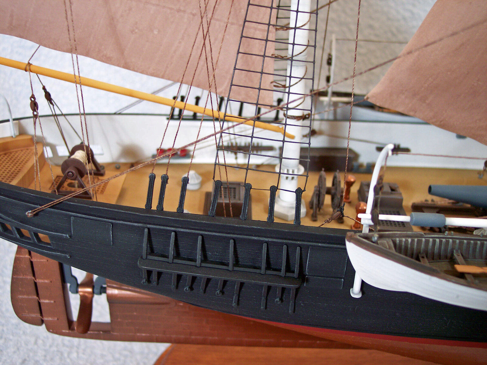

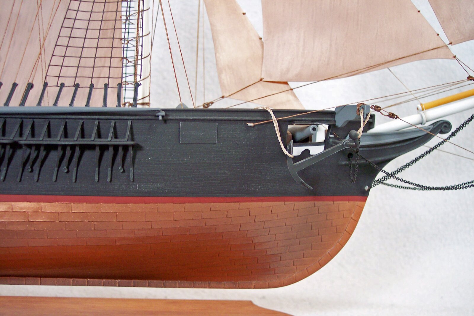

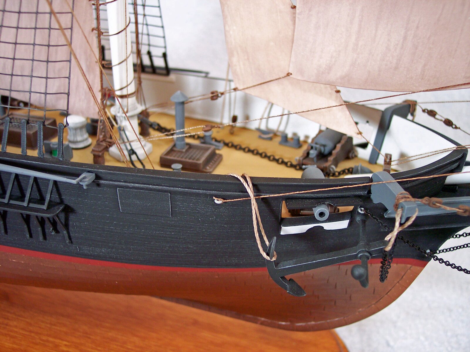

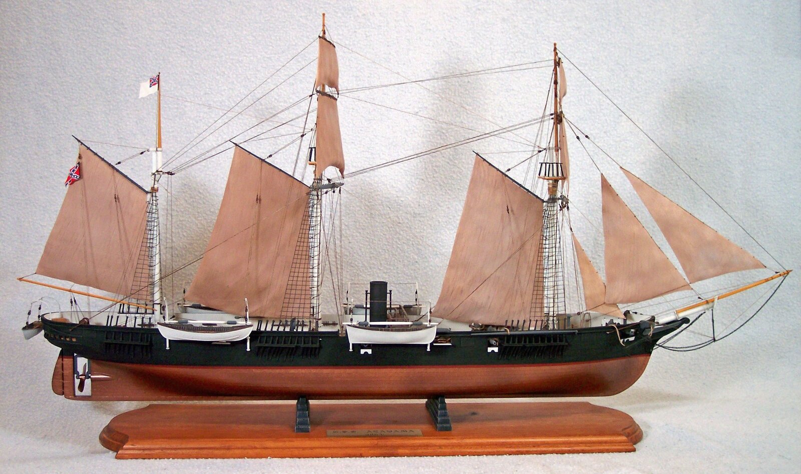

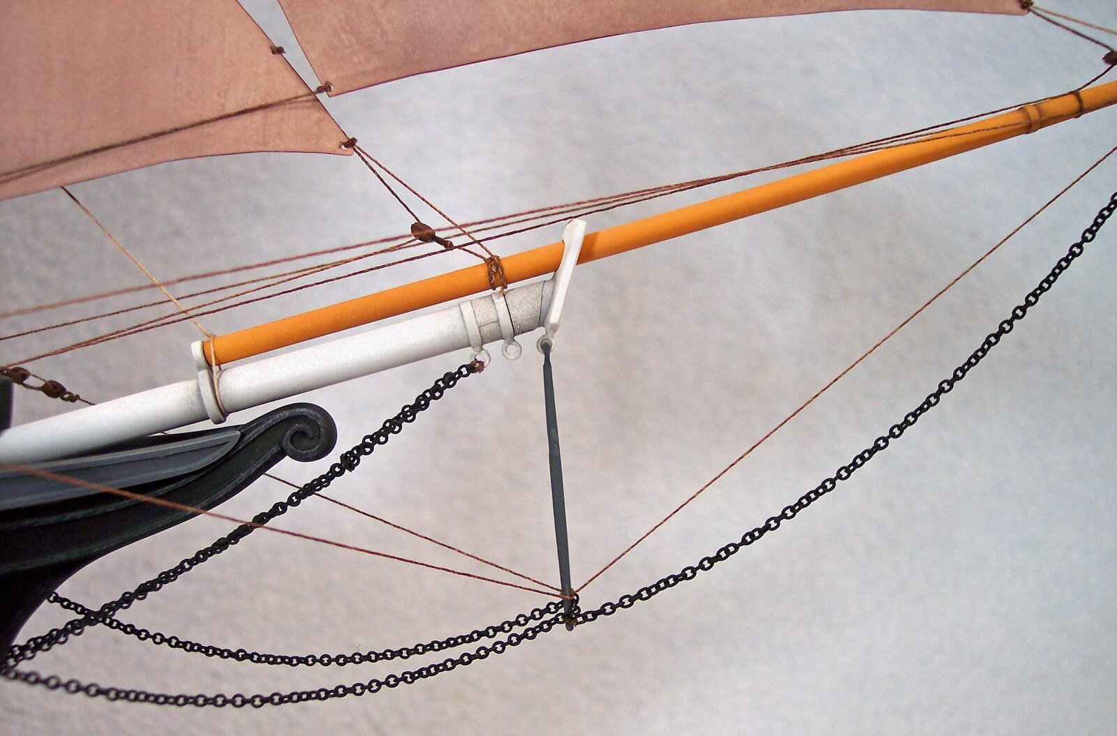

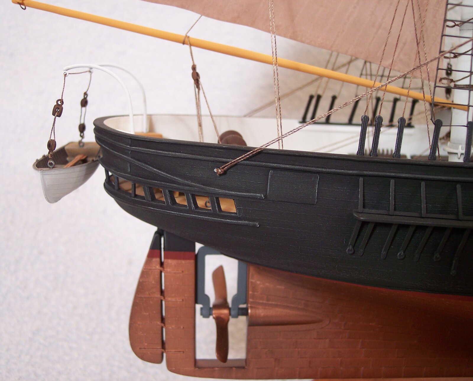

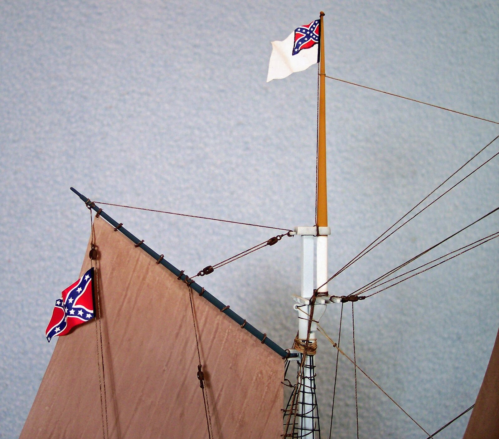

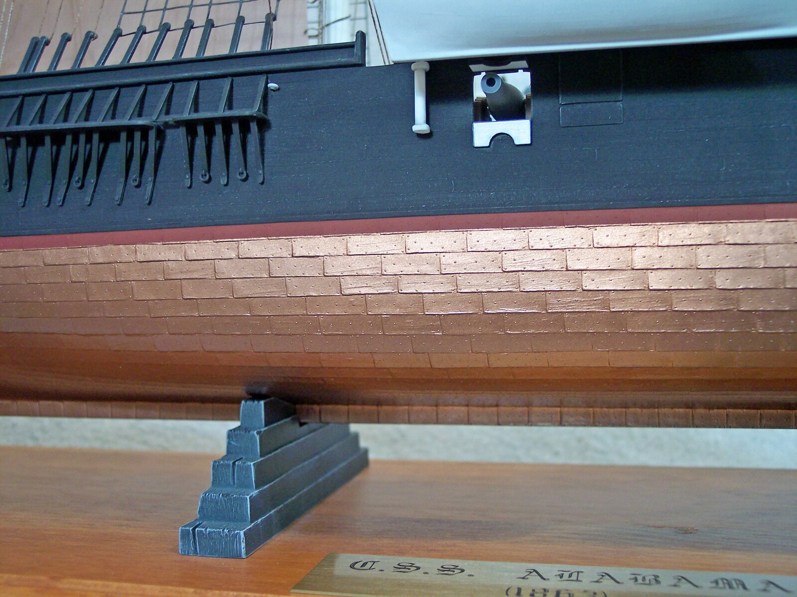

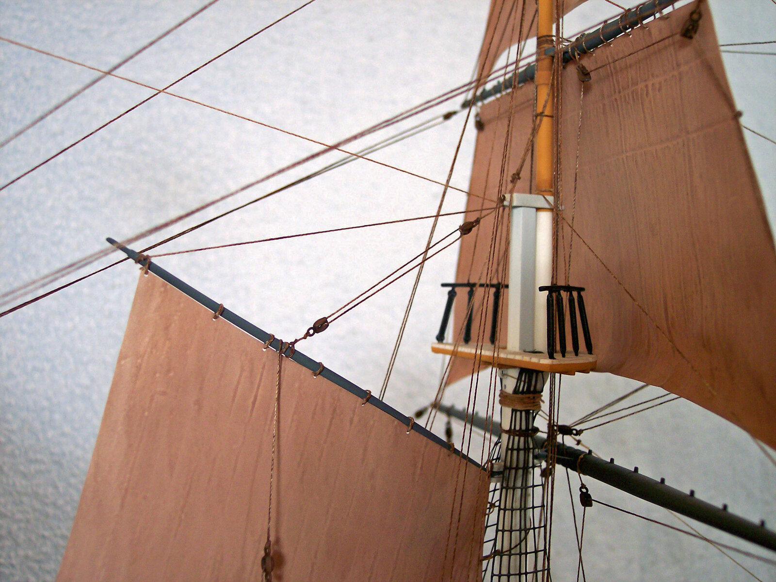

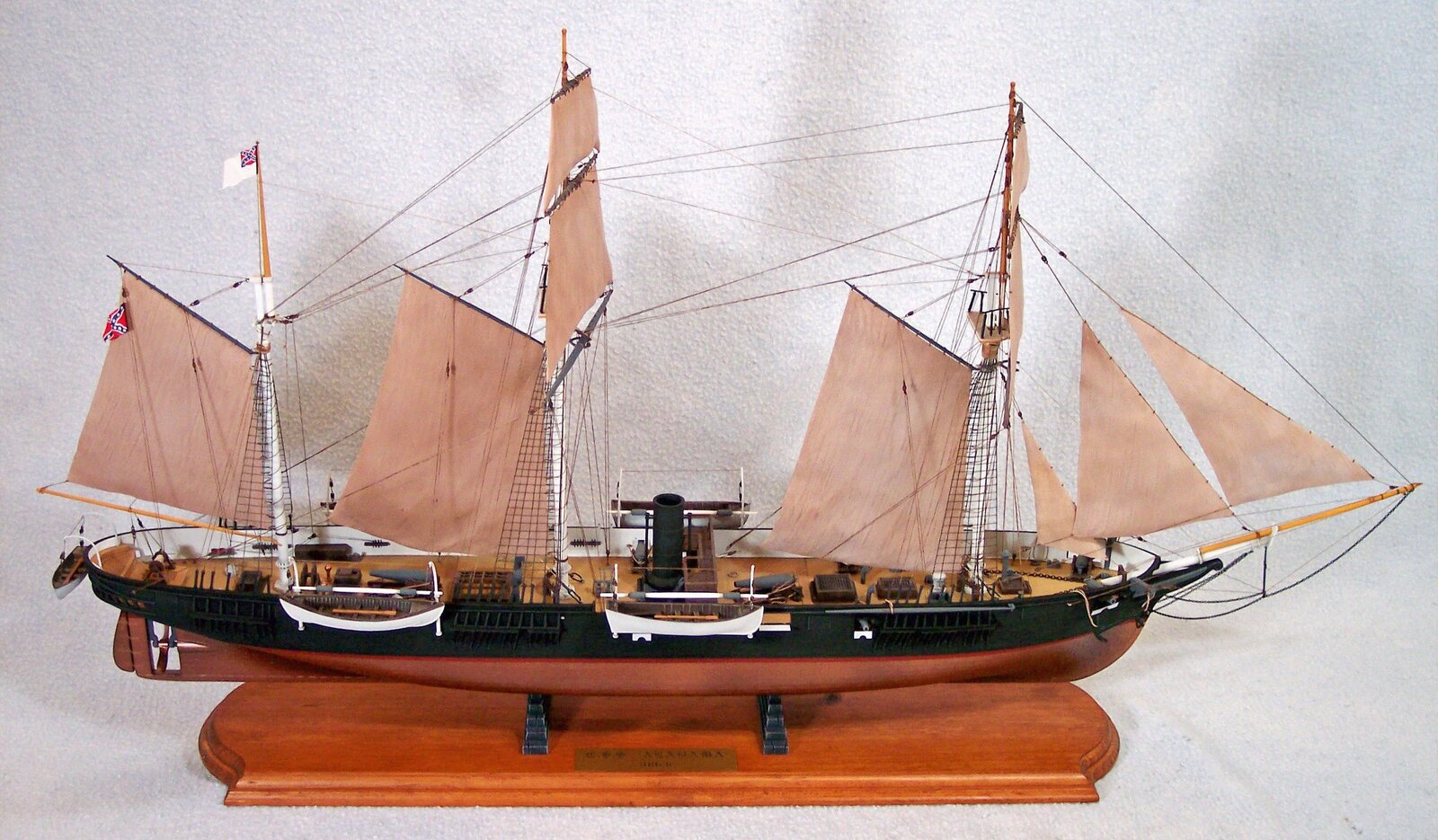

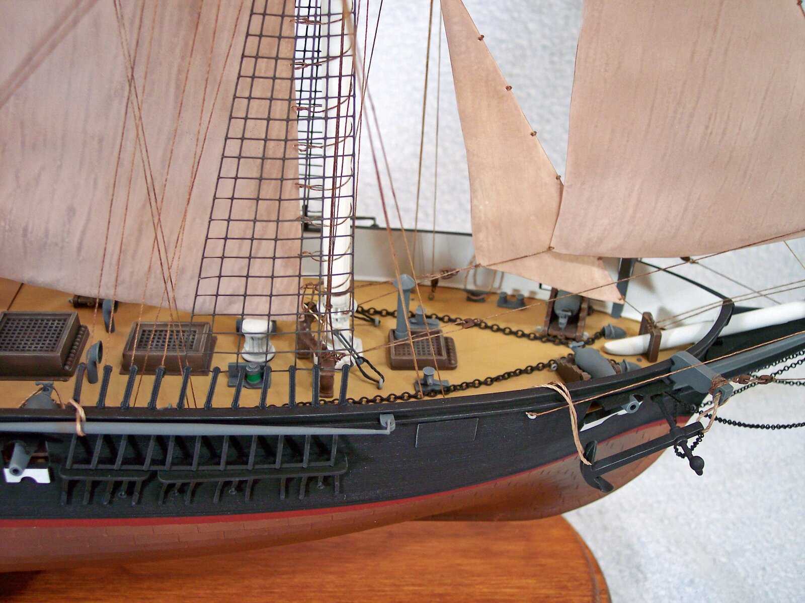

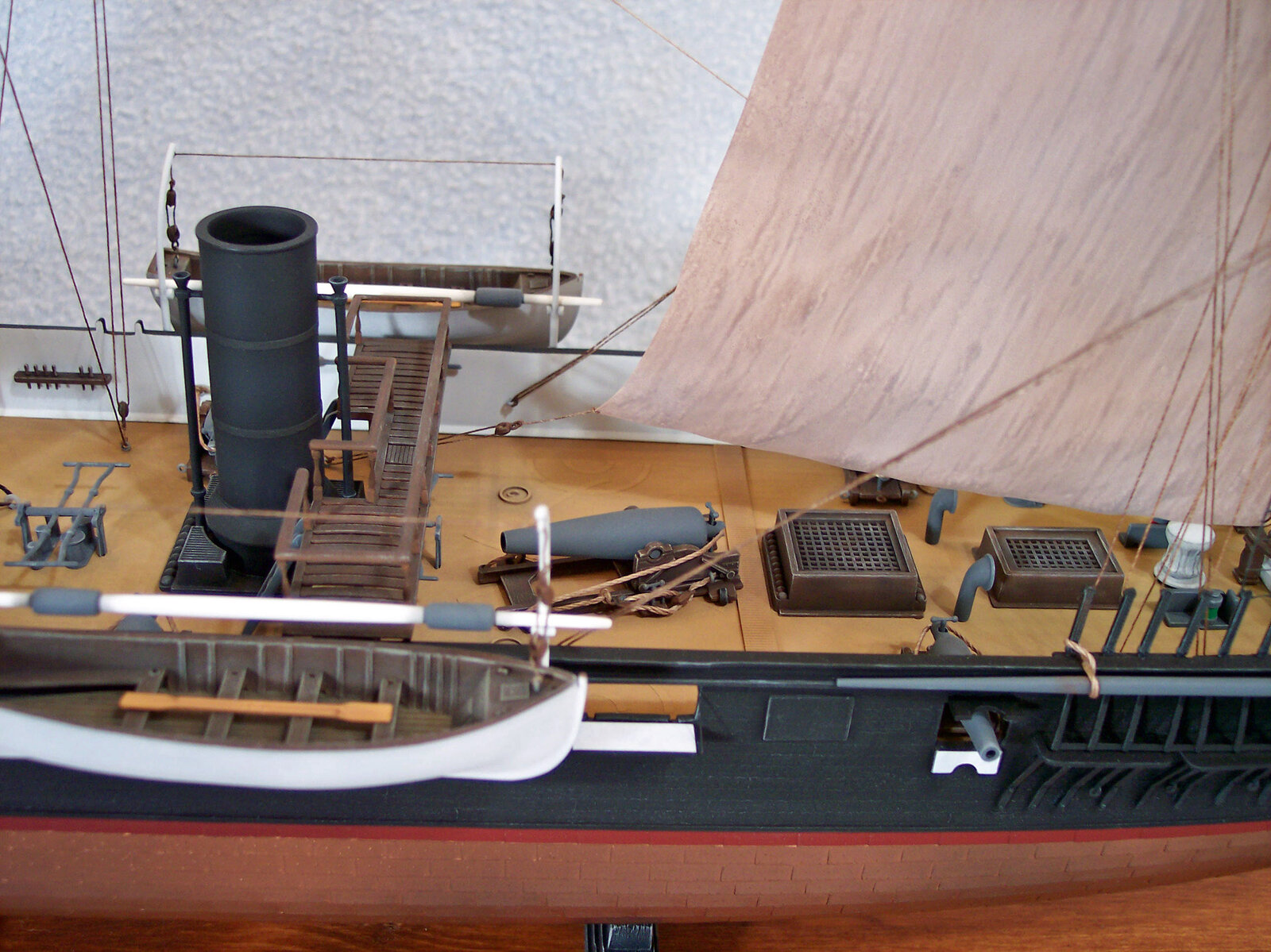

Fellow Modelers,
Below are photos of Revell's 1/96 scale (36" length) C.S.S. Alabama, a Civil War commerce raider built by England and sold to the Confederate States. From 1862 to 1864 the Alabama was able to destroy or capture 65 merchant vessels (and 1 warship) before being sunk by the U.S.S. Kearsage off the coast of France on June 19, 1864. I built this kit in 2000. It was built straight from the box and I pretty much followed the kit's instructions concerning painting. This was my first sailing ship model, and found working with the rigging much harder than I thought it would be. It is a beautiful model, but a great deal of sanding and parts clean-up was required due to the kit's age. Based on Andrew Bowcock's 2002 book "Anatomy of a Confederate raider", just about everything on the deck should have been painted black (lifeboats, cannons, etc.) instead of the colors given in the kit instructions. The sails used are the vac-form parts from the kit. First, I painted them flat white. Next, medium brown pastel powder was applied with a soft, flat brush on each side. A very soft t-shirt was used to burnish the pastel powder into the sails. Doing this produced a multi-color effect, and also highlight all of the recesses and indentations on the sails. Care was taken to not rub on the parts too hard and damage the white paint or the part itself. To get a specific area darker I applied a little more pastel powder. Finally, each sail was airbrushed with Testors Dullcote (50/50 mixture of Dullcote and thinner). This was required since buffing the parts produced a semi-gloss finish. Revell first issued the Alabama and Kearsarge kits in 1961. Both kits were made from the same basic mold with just a few alterations in the details. According to expert ship modelers on the internet, it appears the Kearsarge kit was modeled after what she looked like when she sank in 1894, which is really different from what she looked like in 1864. Also, the Alabama kit has many inaccuracies and requires a significant number of modifications to correct them.

Nicely done! A handsome craft if ever I saw one.
Seeing these beautiful ships tells me there will be some kind of sailing ship in my model building future. I built the Bluenose schooner when I was a teenager, and didn't know what I was getting into! I remember well the tiny nails, the sanding, more sanding, the rigging, varnish and sewing sails on my mom's sewing machine.

Awesome presentation. Fine rigging is taxing but rewarding I have done rigging on biplanes (Wingnut Wings) and it takes a lot of patience. Also if you leave the model as a table top display or fixed to a frame on the wall without a shadow box or clear cover, the rigging can get dust bunnies. Use Q tips and soft brushes and use no spray dusters. The rigging material gets fragile over time. Best to use a cover if left open. Enjoy this great piece of assembly!!!!!
kevin/Tommergun/BarleyBop/Edbert/BOATMAN/moemoe69/scottrc78-Thanks very much for the kind words. They are appreciated.
Edbert-If you do not know about it already, you should try Berkshire Junction EZ Line for your battleship rigging. It has a lot of stretch to it without adding pulling tension. It comes in "fine" and "medium". I think it makes rigging much easier.

Rob-The sails on the model are the vac-form parts supplied with the kit.

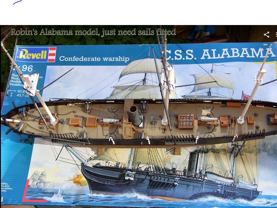

Phillip. Well done better than my model. My Alabama has been in a few 'battles' over the years and needs a rebuild at Cammell Laird, which is just down the Mersey from me. It would have sailed out past from where our house now stands. The museum locally has the actual Laird's makers' model.
robin bird-Thanks for the compliment. You should take the time to refurbish your model. I will make a great looking display!
