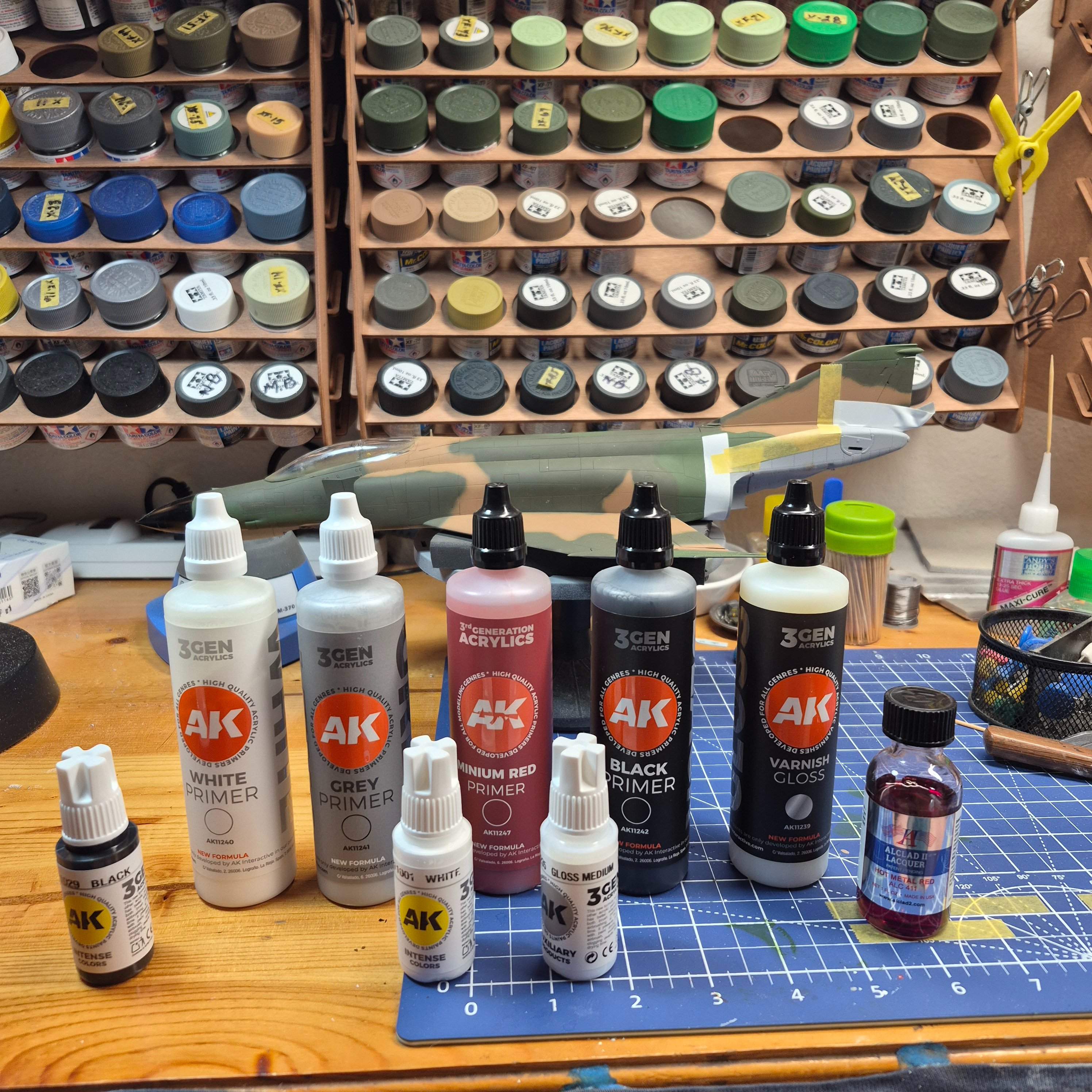

Hey everyone. I usually spray with Tamia paints. However it's getting harder and harder to find the colors that you need regularly. So I was in there this morning and he has the whole line of AK third gen acrylics. It doesn't seem to be selling but I hear it's on the same level as Tamia paints? Meaning it acts kind of like Tamia paints and I can possibly use the same thinners. Hopefully Mr color leveling 400. We will see. I asked the guy there and he goes well I don't think people really know about it. So I decided to try some because he had everything you could possibly need to spray that paint with whatever color you could possibly need the whole line was sitting there untouched 10 bottles deep. So I needed primer and I needed White so I decided to try this stuff. Has anyone tried this? The only thing I probably should have bought to try this out was their thinner but that's just an excuse for me to go back to Andy's someday.
:) I got two of their paint just black and white to try it. And they had this gloss medium. I guess you mix it in with the paint? Makes it a gloss? Hopefully this stuff is good because they just can't keep Tammy a paint stocked up I guess. So if anyone has tried this stuff, let us know.

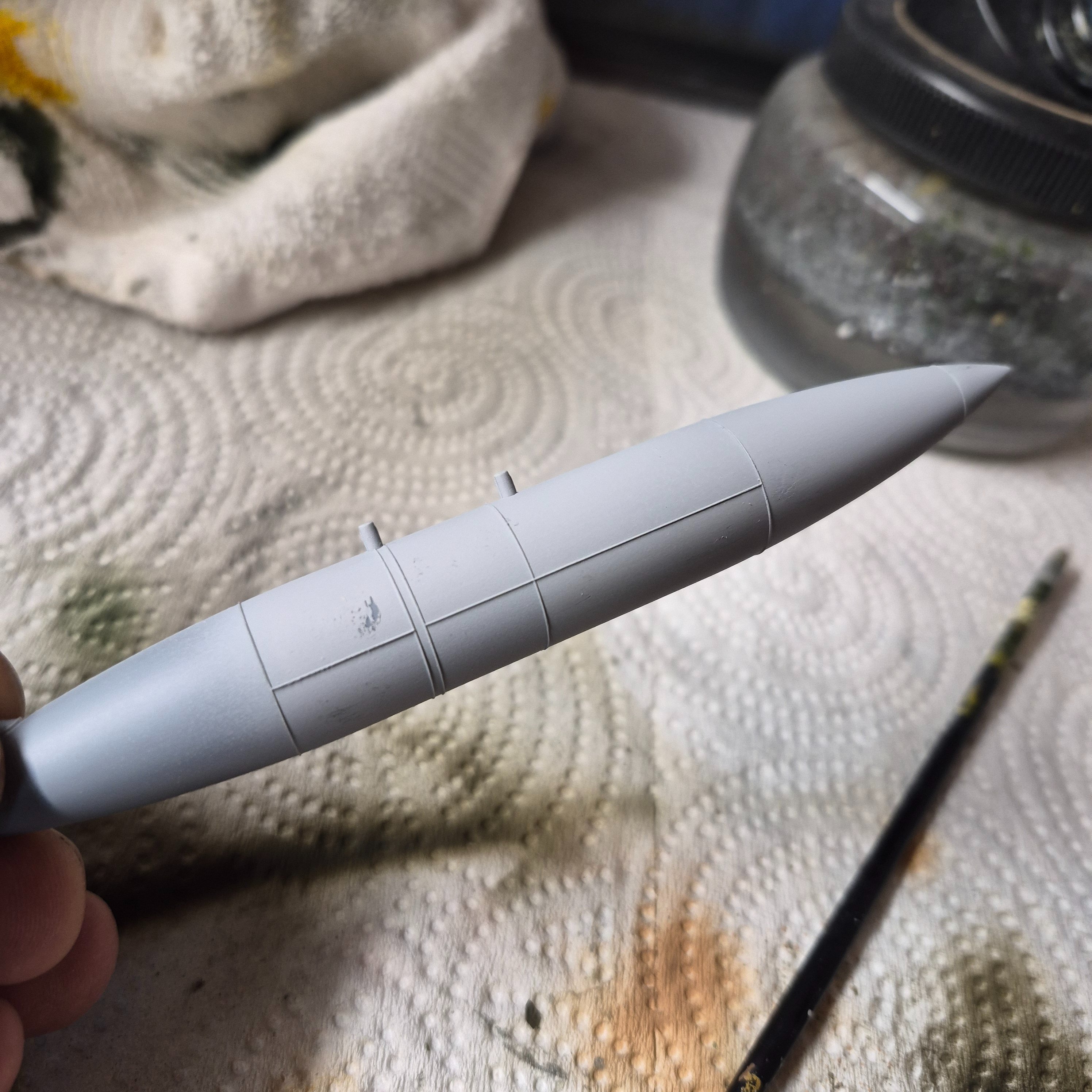

I believe you are right because there is no flammable symbol on the bottles. However. Don't mind the fingerprint I was testing to see how long it took to dry but I sprayed the gray primer on this test subject and I used Mr color leveling thinner 400 half and half. Sprayed beautifully and cleaned up out of my airbrush lickity split. So far the stuff looks promising and once this dries if I can spray X and XF paints on it without it bubbling up or something I call that a win.
