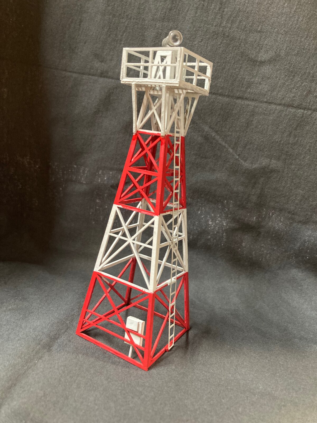

I had a Silhouette for awhile, but I wasn't using it enough so I sold it and bought a laser engraver instead. It is definitely a different beast altogether. The Silhouette could do some things better- if your only need is for cutting masks, the Silhouette is probably the way to go. But I very much prefer my laser, as I'm doing other things with it that the Silhouette couldn't do (like cutting paper and wood parts for various models, scenery, etc. The beacon below is an example, cut mostly from cardstock- too thick for my Silhouette, I think
). A laser is NO GOOD for cutting vinyl or various plastics, though, not only does vinyl release toxic fumes, some plastics will release chlorine gas which destroys the laser lens.
I had a Silhouette for awhile, but I wasn't using it enough so I sold it and bought a laser engraver instead. It is definitely a different beast altogether. The Silhouette could do some things better- if your only need is for cutting masks, the Silhouette is probably the way to go. But I very much prefer my laser, as I'm doing other things with it that the Silhouette couldn't do (like cutting paper and wood parts for various models, scenery, etc. The beacon below is an example, cut mostly from cardstock- too thick for my Silhouette, I thinkView attachment 125085). A laser is NO GOOD for cutting vinyl or various plastics, though, not only does vinyl release toxic fumes, some plastics will release chlorine gas which destroys the laser lens.
