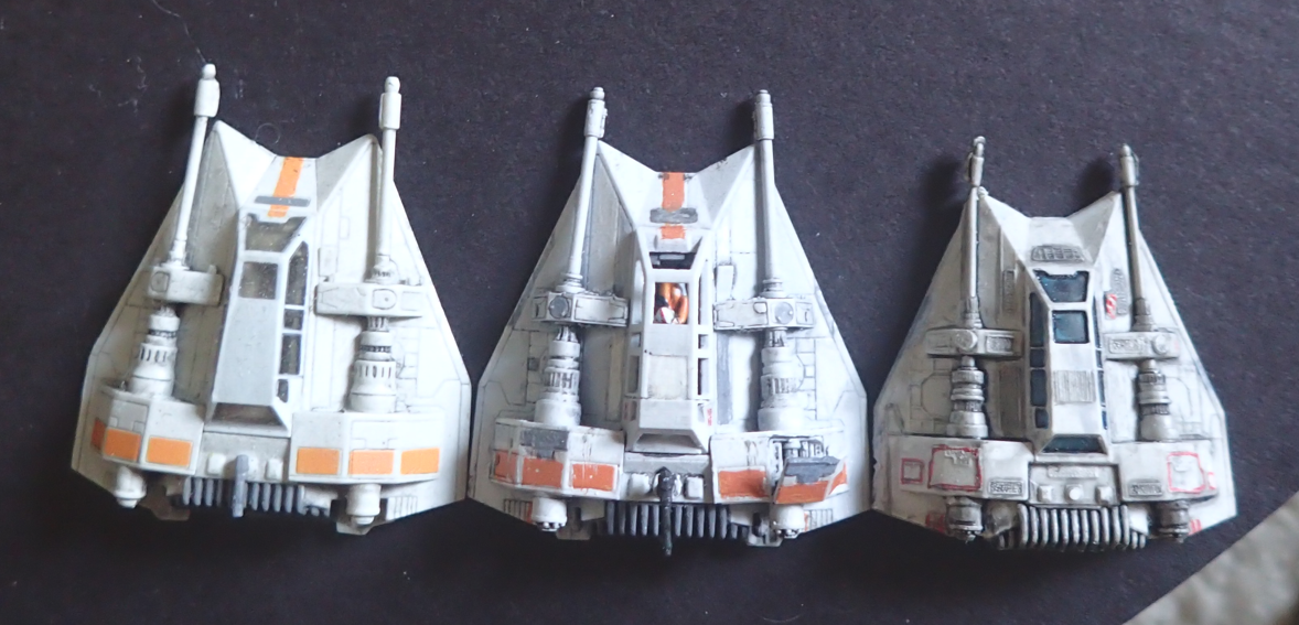

Here is a shot of the Snowspeeder that came in the MPC AT-AT on the right
compared to the larger Bandai mech collection Snowspeeder in the middle
compared to the Fine Molds/F-Toys Snowspeeder on the left which is even slightly larger than the Bandai
The Bandai and F-Toys ones are thought of as 1/144, but I actually think they are both closer to 1/110 or even 1/100. I feel like the MPC one is actually closer to 1/144 than either of them
As far as pairing, my personal opinion is the F-Toys snowspeeder visually feels like a better match for the MPC 1/100ish AT-AT closely followed by the Bandai one as both seem on the larger side for the Bandai 1/144 AT-AT. However details are light years ahead on either of those compared to the MPC one.
However, I think they can look good with either pairing

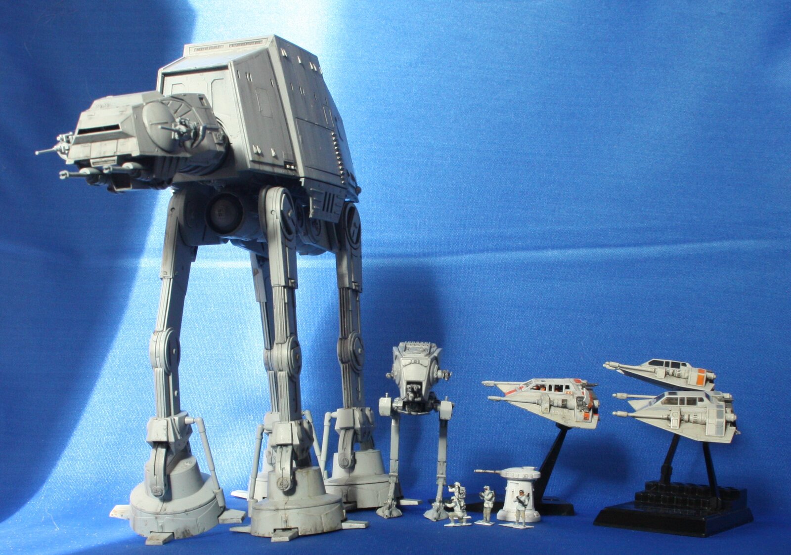

for other reference, here is the Bandai 1/144 with some 1/144 scale figures and the Bandi and F-Toys speeders
