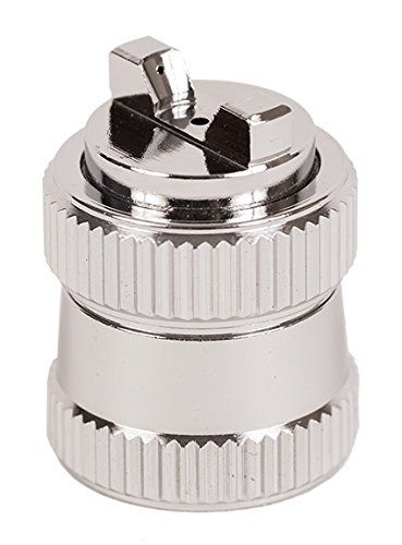

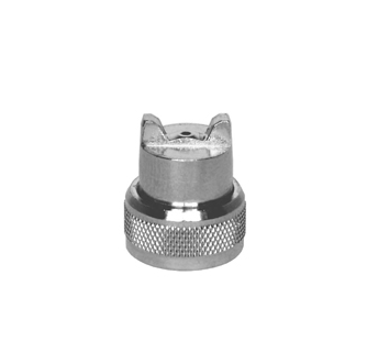

Fan air caps :

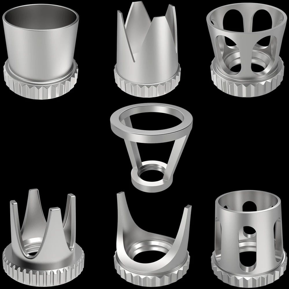

Crown caps are the ones that screw over the top of the air cap .
Their sole purpose is to protect the needle protruding from the air orifice .
They do not attach to fan air caps :

There are different styles of air caps like Fan Air Cap s that create a wide , WIDE , spray pattern .

Fan air caps :
