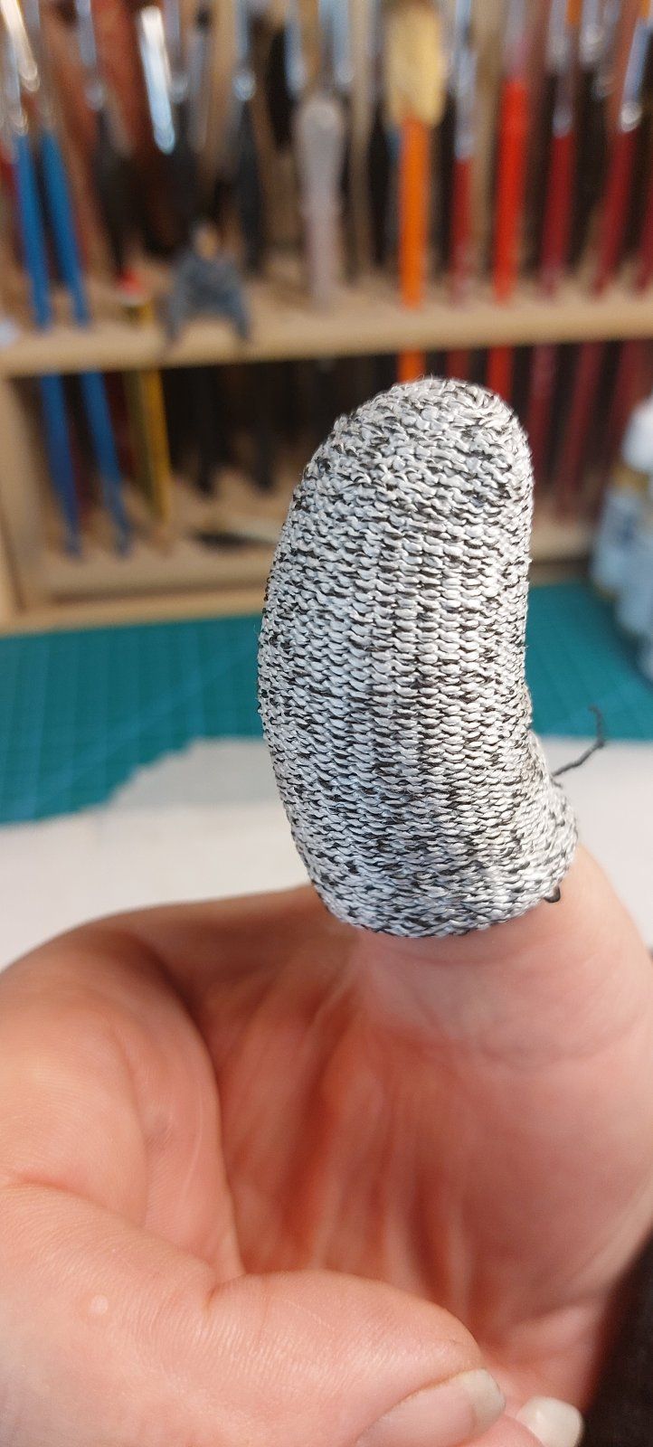

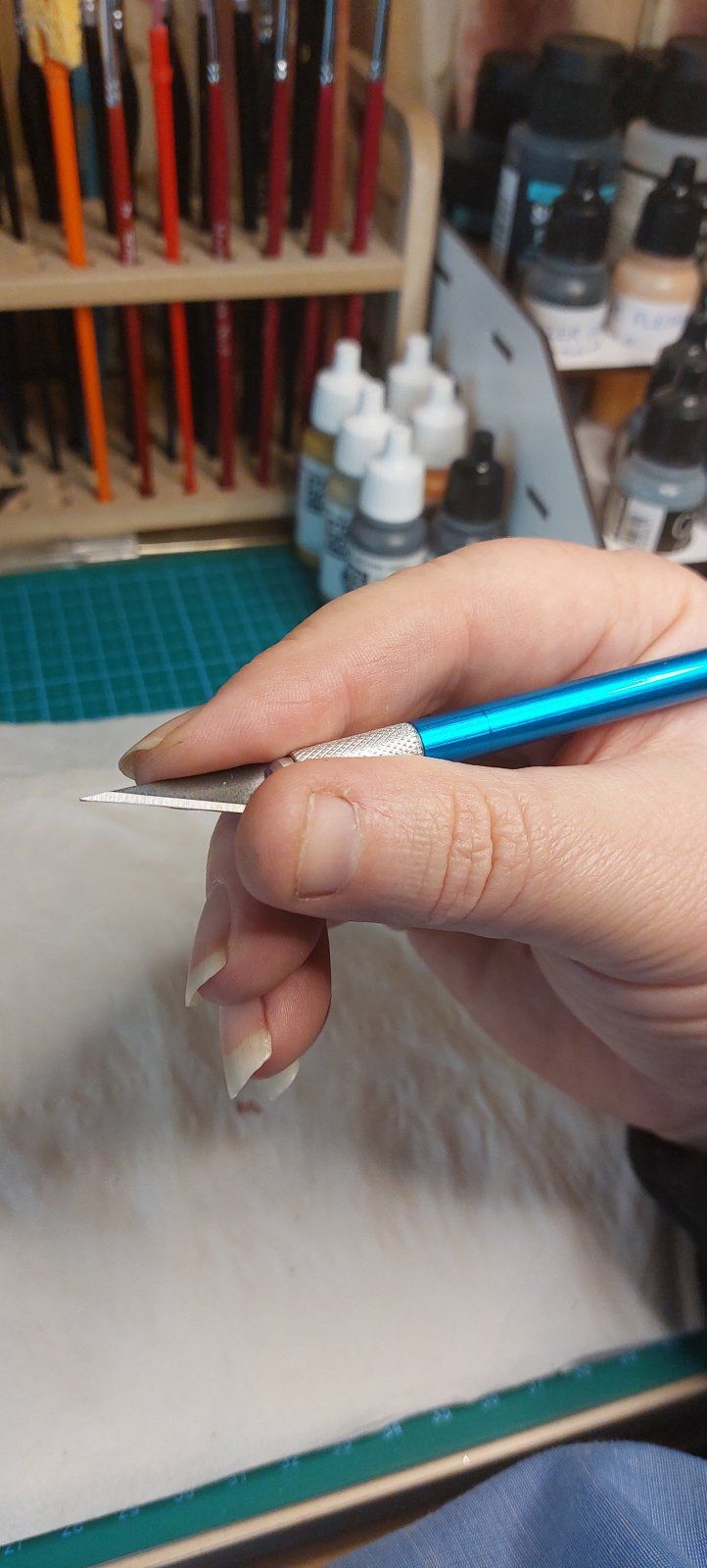

Hi, I have recently found that my thumb is getting increasingly sliced. It has become more apparent lately as I am removing a horrendous amount of flash from a Masterbox motorcycle.
Being our company health and safety manager I quickly found a blade resistant thumb guard online. A very easy fix for future scalpel work.
It got me thinking has anyone else had model building injuries and how did you overcome them?

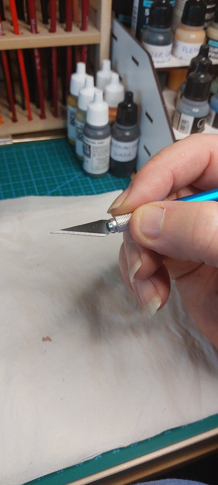

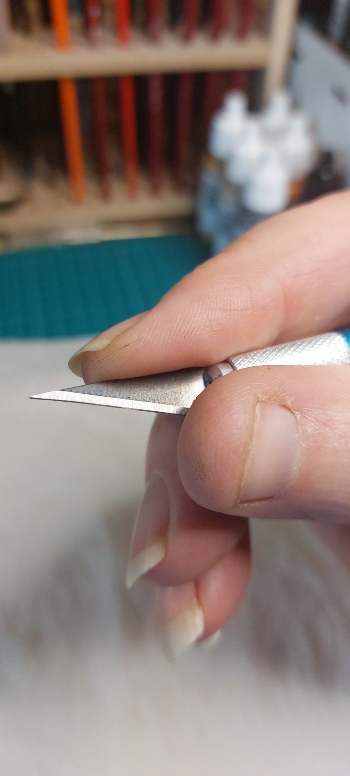

Hi Urumomo, I hadn't realised that I was holding the knife along the back of the blade to get more control of the point instead of holding it further down the knife where I should be holding it.
I start the right way but as I get more into the cutting my brain just takes over and I forget!
So it's a poor work procedure but I'm happy with the thumb guard as it makes it almost idiot proof to get a cut now.
I get a feeling that sentence will come back to haunt me later on.
And before we get a suggestion from a certain member (you know who you are), they didn't sell the guards in pink !

I have to admit that a craftsman as a carpenter is, could use a knife in that manner. Seriously what would you say to an apprentice worker.
The best knife to get practice with for our hobby in knife skills is a good old fashioned Swann Morton Metal Scalpel handle and a selection of blades (10A is good) as this will teach you knife use as handle is designed for finger tip control.
You know that I like to take the mickey but something like hacking through flesh is to be taken seriously. My knee was one example only as I have many scars from my beloved hobby, though carelessness, tiredness, not thinking, blunt blades etc etc. Particularly with scalpel blades eye protection as they can snap with the tip being the worst.
If you keep hacking missing a 'pinky' could become missing Thumb, ring finger................ You can imagine.

I have found my new thumb guard very good and have now hopefully solved the problem.
