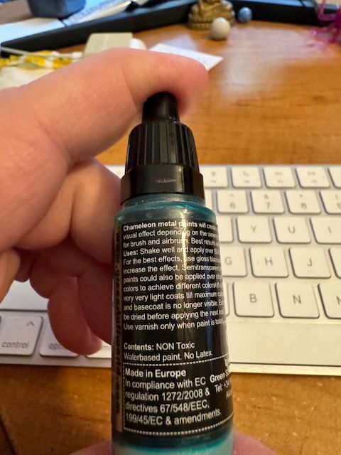

The bottle says water-based. But you never know. haha

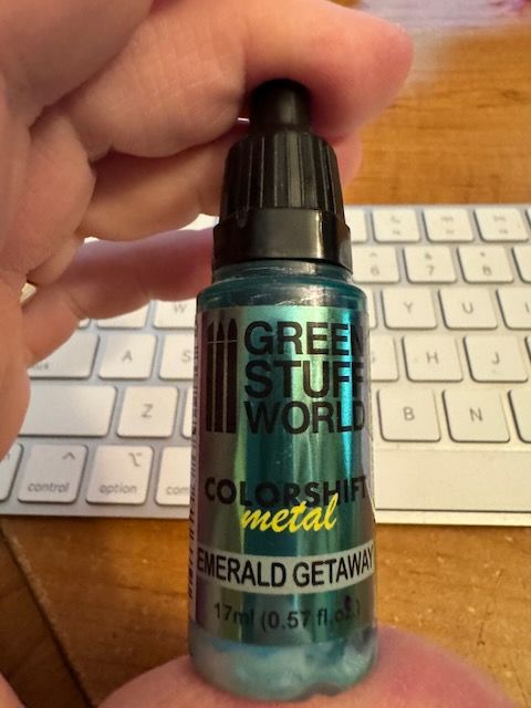

I bought some of their "shifters" just for fun. The label on these paints says "NON Toxic waterbased paint. No Latex"
Yeah, I see that it says water-based. I actually found a bottle that I already had.

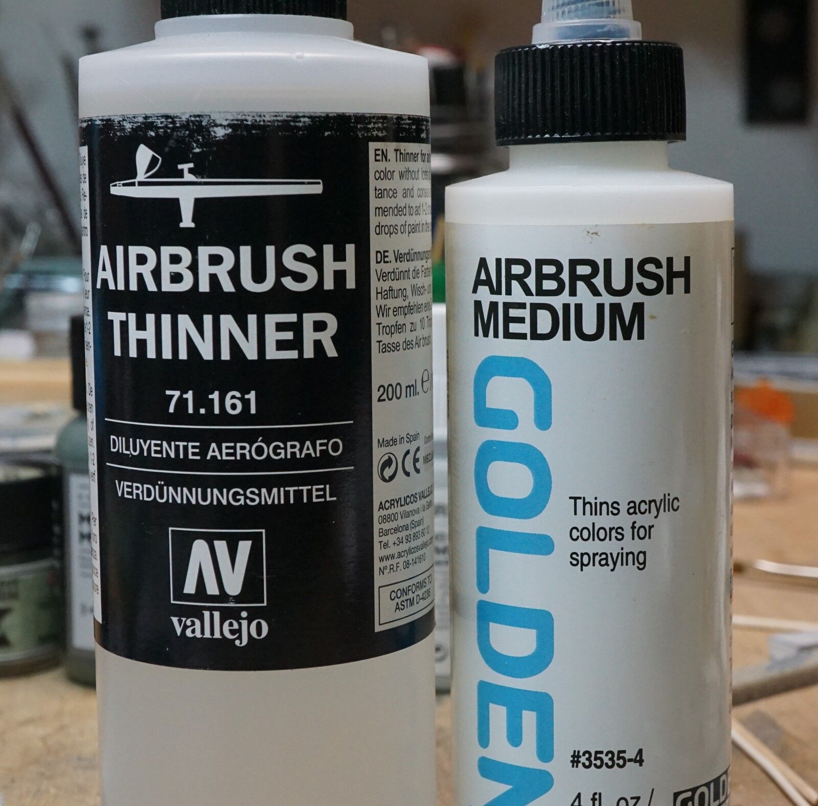

Speaking of Vallejo.
I want to airbrush some of that stuff. Same questions. Can I think it with water? Or what can I use that I might already have? I don't really want to have a million different thinners.
Water alone is fine .
The glycol is mainly to reduce dry-tip , but depending on the environment it's also there for proper leveling .
Water is fine. I use a bit of Vallejo's flow improver. I put two drops in before the paint and it does a good job of preventing dry tip.
