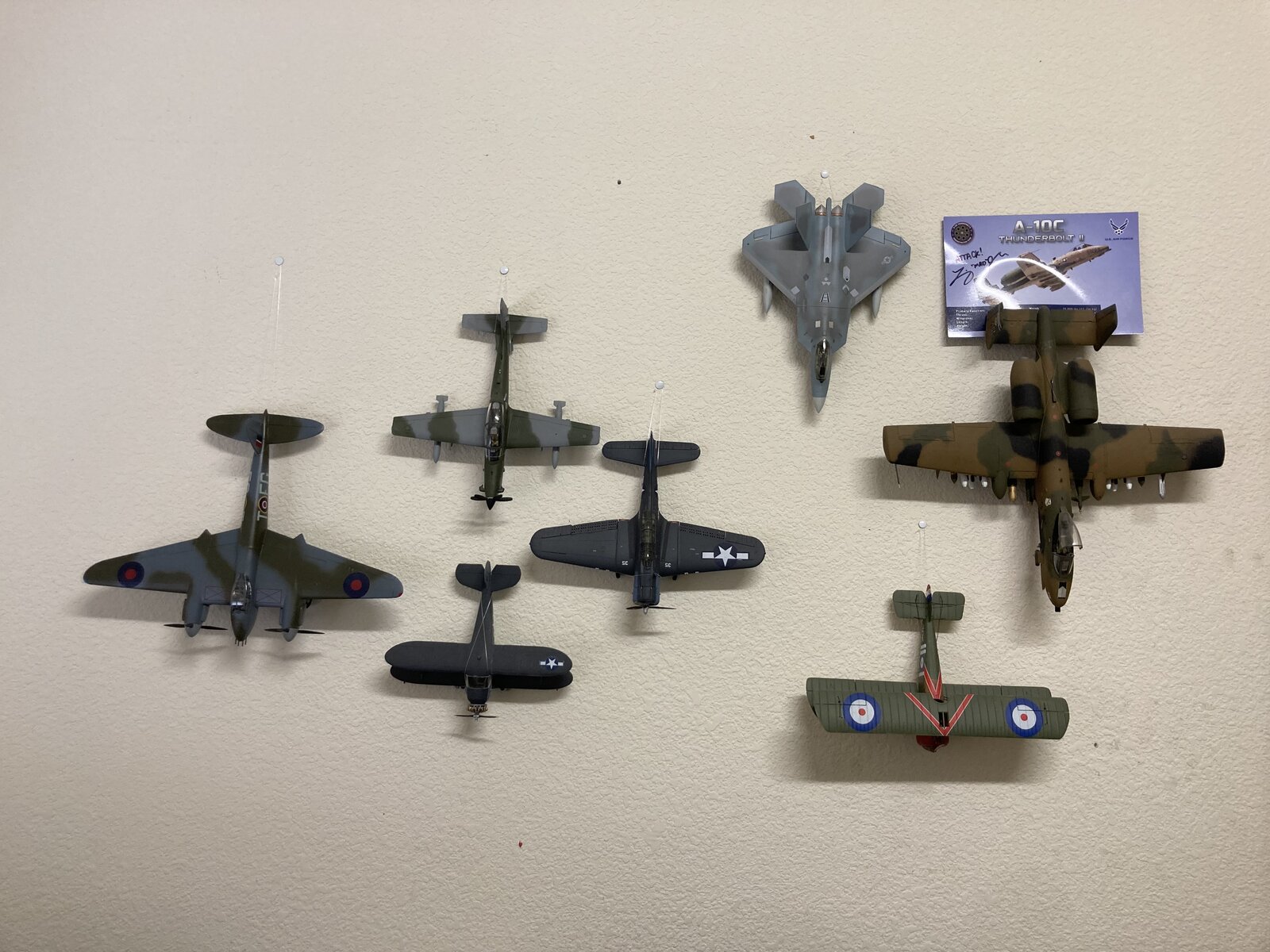

It depends on how you display them, if you build them wheels up and hang them from the ceiling then it doesn't matter. If they're wheels down and sit on a flat surface then add weight to all of them. For me I build wheels down but hang them on the wall ( nose down) so it doesn't matter for me.
