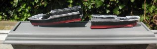

Here's the primed base (notice the tube that holds up the fron of the ship and will feed wiring). Now you can see what area will be filled with resin to simulate the ocean, right up to the deck. Back of the ship will float on the ocean when all is done.
And tried out that sealer trick but probably won't use it as I need quite some volume.
Next up, painting the ship and adding some details.
Barry
