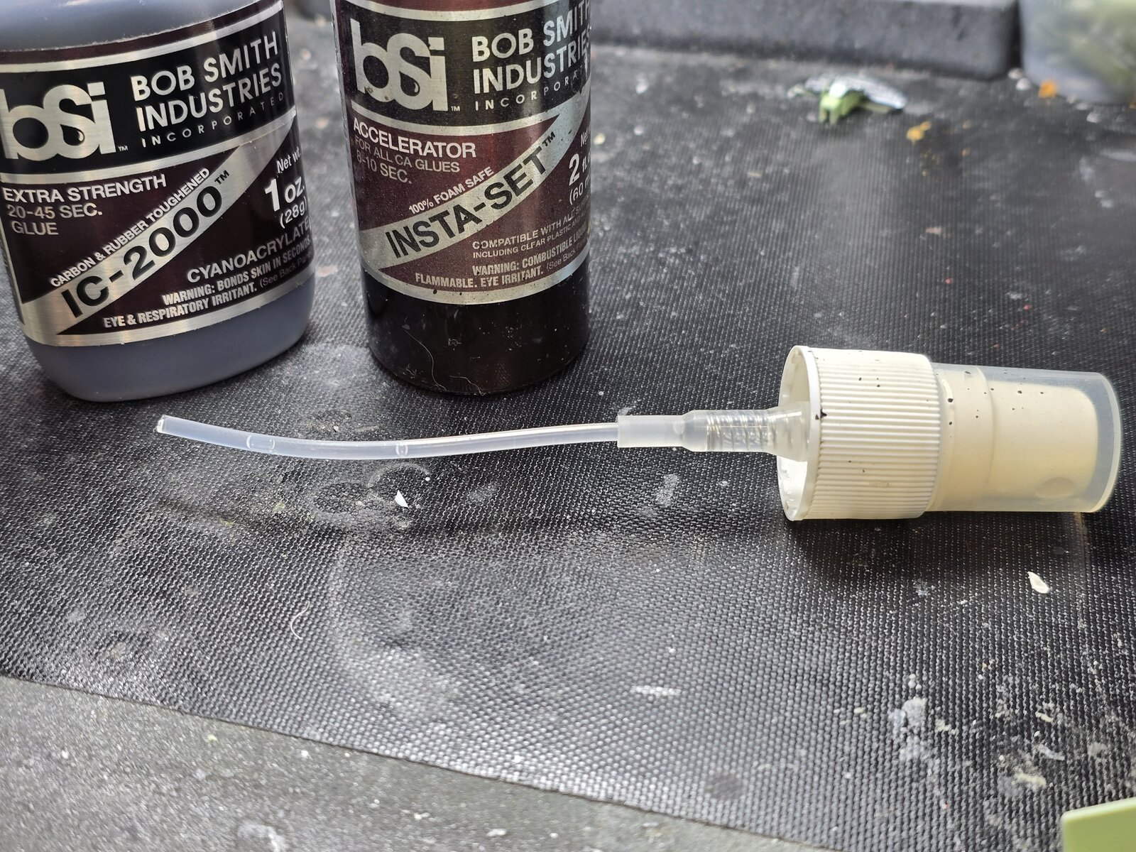

Just in case you might not have used these products, or what is black CA glue?
Bare with me as I try to explain as best as I can...
If I got something wrong or if you have additional information about these products please reply with your experience with these products.

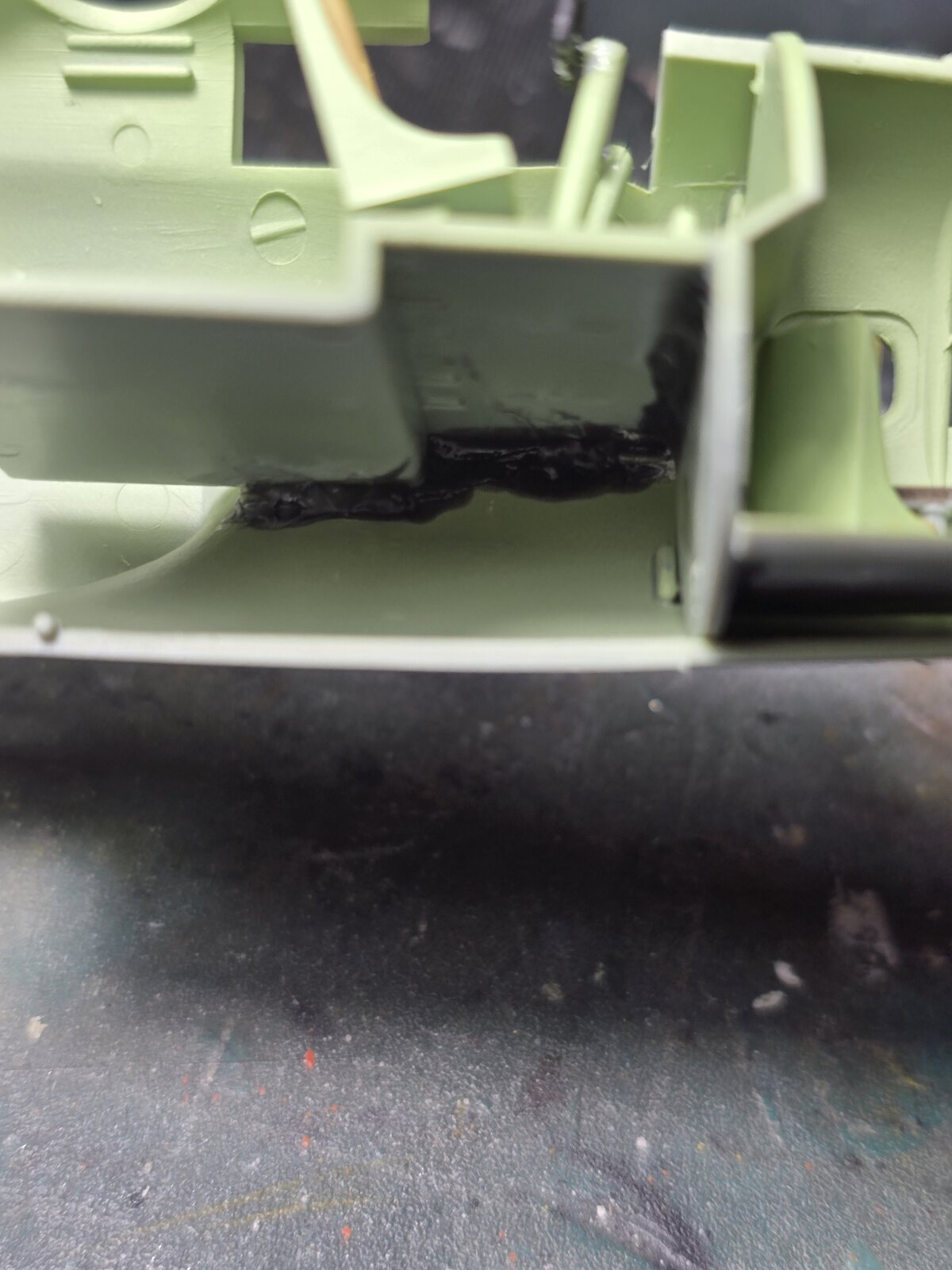

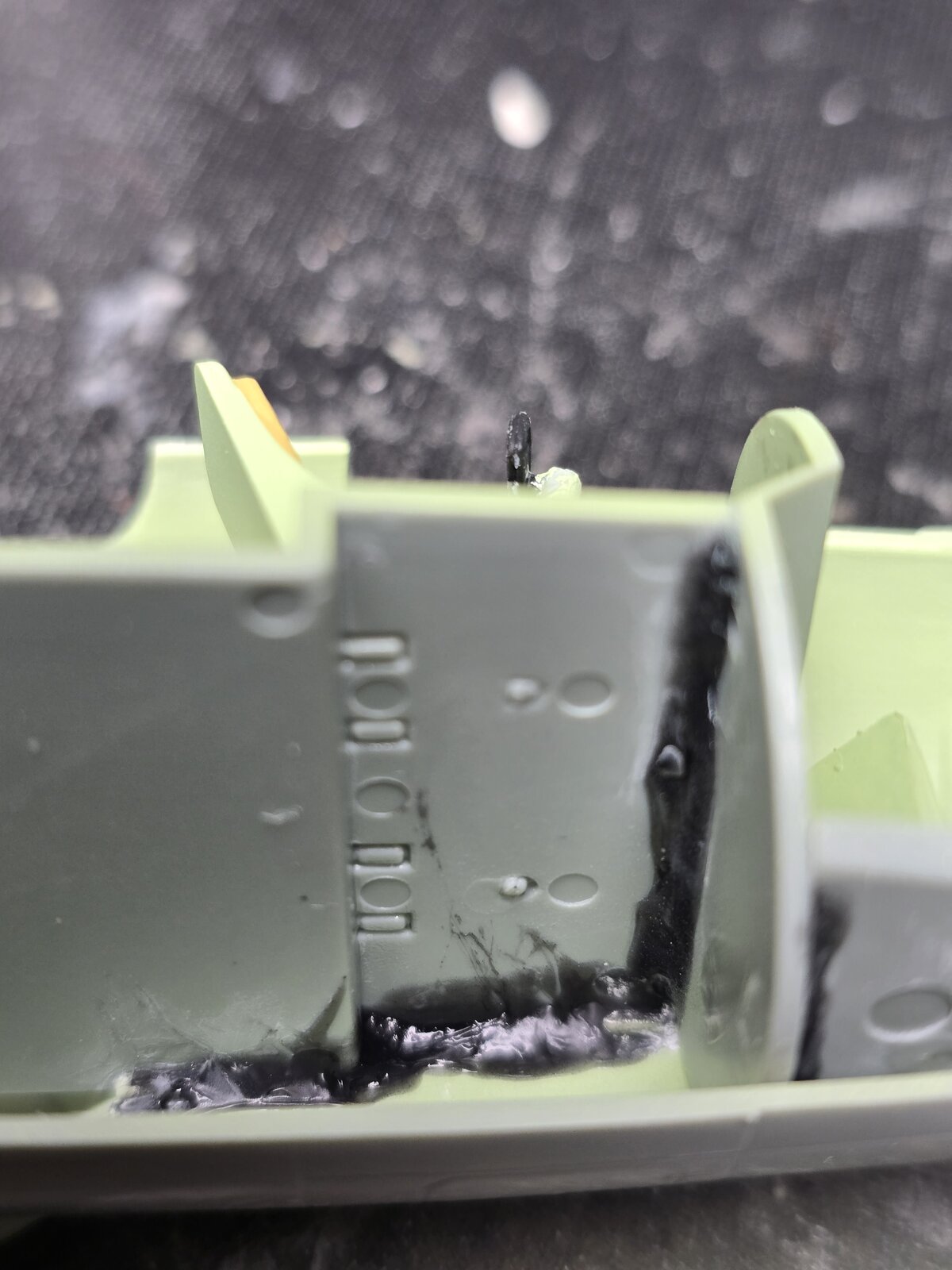

In my opinion, Black CA glue is the best stuff. I have seen and heard about this glue from YouTube and research. I learned that it has a rubber polymer blended in this glue. It works well on parts that have some tension in placing some parts. This glue is very forgiving as it has a slight give to the two parts.
To set this quicker I use the Bob Smith industries (bsi) Insta-Set. For that I simply use the liquid from the siphon tube and drop a little on the CA glue, and voilà the parts are set!
I hope this information is helpful.

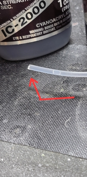

lastly, have been using these 'precision glue micro tips' from I'm-a-loony, they are 4" outta the bag, trim to a length that works for you.
Essentially, I haven't recapped those bottles in months... the tube is so small that once the glue rolls back down inside, there isn't enough of an opening to gum up... maybe I'm losing some essential ingredient through evaporation, but I haven't noticed performance issues. I just sit the cap on the end, can't hurt!
