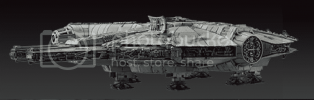

Well,....now that we have had the joy of seeing the future Bandai 1/144 Falcon model & the low of uncertainty that we might ever possess it,.....I thought I'd post some images of what we know so far about the Falcon as we will see her in the future films.
I've gone on about which version of the Falcon ILM have digitised.....(ok,...I'll say it again....the 5 foot studio model),....but apart from the obvious rectangular dish,....there is another notable difference
Although the 5 footer was a huge model & had a crap-load of detail on her,...now that she is digital she has a load more detail in the sidewalls & docking ring doors
I would say that they used the 5 footer to measure up the full scale filming prop, filled the sidewalls & docking rings full of a million pipes & greeblies and then digitised them for the digital element,.....this keeps everything the same
